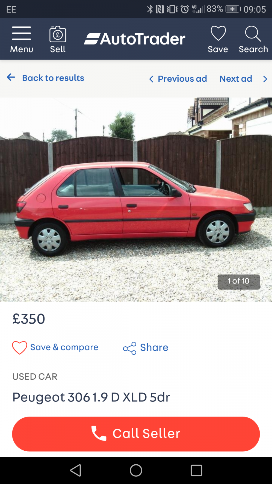

How bad can it be? Peugeot 306
During my car hunting, I keep seeing this, and can't help wondering if it would be a sensible purchase...
I hear good things about Peugeot diesels, but diesel power is witchcraft to me, I wouldn't know where to begin.
Can anyone make any useful/useless remarks about them?

350 or less and you are worried? Never be afraid of coke. Especially if it has a MOT of great longevity.
It looks quite good in the photos with original 90s dealer plates, the engine looks clean and it's had the rear beam bushes/mounts done for the last MOT. GIB.

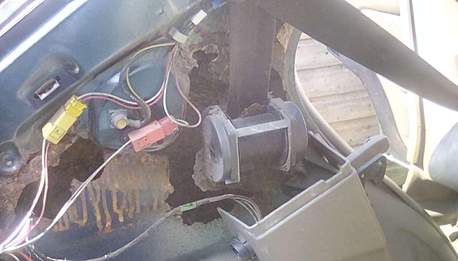

Rot by the N/S/R seatbelt mount can be bad even if the rest of the car is mint. Hard to check for. Lifting boot carpet will reveal a mint boot floor, you need to remove quite a bit of plastic to get to this but it's safe to assume that this area will be rotten. Only as issue if you carry a car full of people. The O/S/R doesn't rot so put kids that side.... MoT man cannot see the rot so don't blame him or twosmoke will get his knickers in a knot.
The killer for these now is for in the front chassis rails and sometimes above the rear axle. Awkward to do and expensive to pay someone to fix. These cars hide rot well so what looks like a minter may not be so good underneath.
Engines are great and will last indefinately but do not take kindly to overheating so check head gasket symptoms but do not worry about high mileage, these cars are tough. Just be aware that the air intake is very low down...I
To check for rampant rear-end inner-wheelarch-and-structural-rot, pull very hard on the rear seatbelt upper mountings. If they move and there's a crunching sound, walk away (unless you fancy getting a bit handy with the welder)

This 306 had 51 weeks mot. No symptoms of rot other that some rust streaks below the plastic mouldings.

Looks a worn out old nail. Get it bought.
Blimey! Never mind a very hard pull on the seatbelt.. I think a mild sneeze in it's general direction would have found that!
Only on here would you need to sit in a specific seat for fear of the seatbelt mounts pulling out the floor when a cat runs into the road.
Looks like the beginnings of a new rag top!
