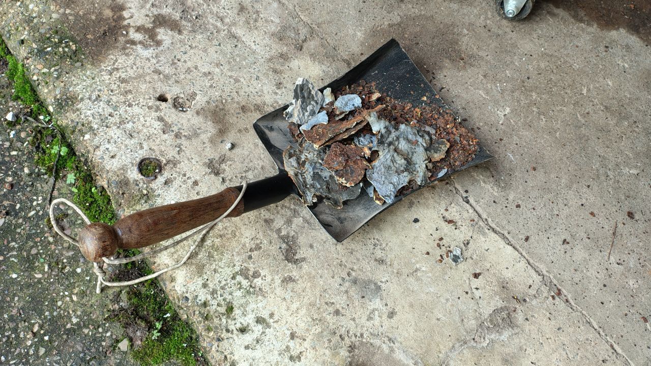

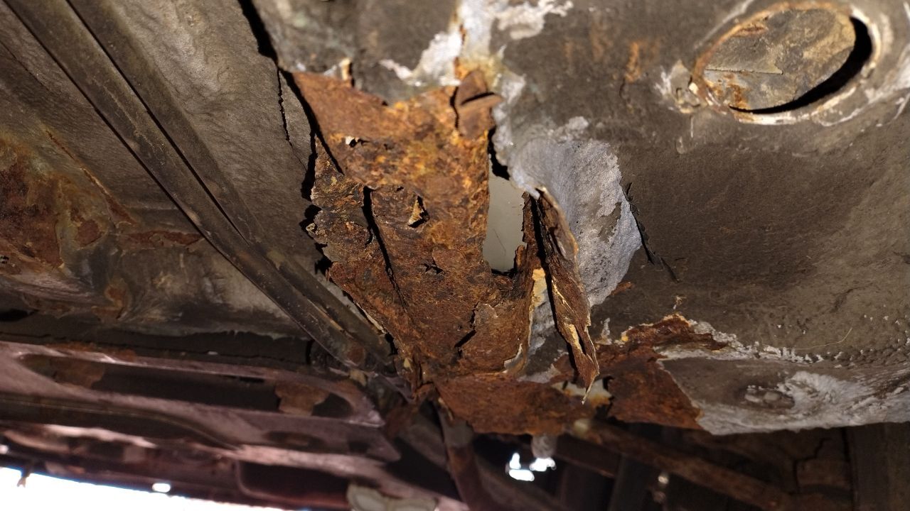

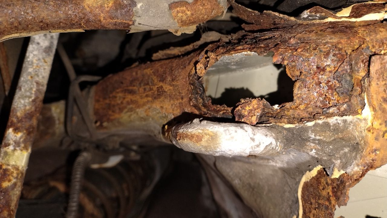

How is your day going? Hopefully better then mine....
The above is the result of me investigating the rust on the 306. When I put my camera underneath I did spot a little bit of crustyness. I was not expecting this!
Basically, it looks like the car has been jacked from the wrong position on both sides. This has damaged the underseal which in turn has resulted in corrosion. There are two 'chassis rails' (yes, I know this is a monocque) which have the consistency of brie. These should be easy to replace. Then there are two big holes under each footwell. It is actually double skinned in this area so I can weld it without setting the interior on fire.
It is beyond econmic repair. But this is AS, phrases like that don't concern us!
What does concern me is that it is going to be quite fiddly to do; I'm going to have to spend a lot of type under the car grinding and cleaning. I think that it is savebale and I'm feeling more positive about this than I was this morning. But my plans to get this on the road by spring may have gone out the window.....

After the discovery of the extensive rust I decided that there was no harm in cutting it out to see how bad it was. It actually wasn't that bad, essentially a pressed steel channel had completely rusted away. I came up with a cunning plan to cut it out and replace it with steel box section. This is no doubt much stronger than the original pressing and saved me an awful lot of fabrication time.
Last Friday I had a bit of a weldathon and cracked on with replacing the rot with steel. I'm really pleased with the result; I still have more work to do on the passenger side but this is realtively easy in comparision with only a few plates needed.

It's the corrosion that's led to the jacking damage, if it's owt like my ZX, water runs down inside the leg but has no way to leak out...
That reminds me, I was going to drill a hole in the channel for drainage and also for cavity wax application. I'll add it to my to do list.
