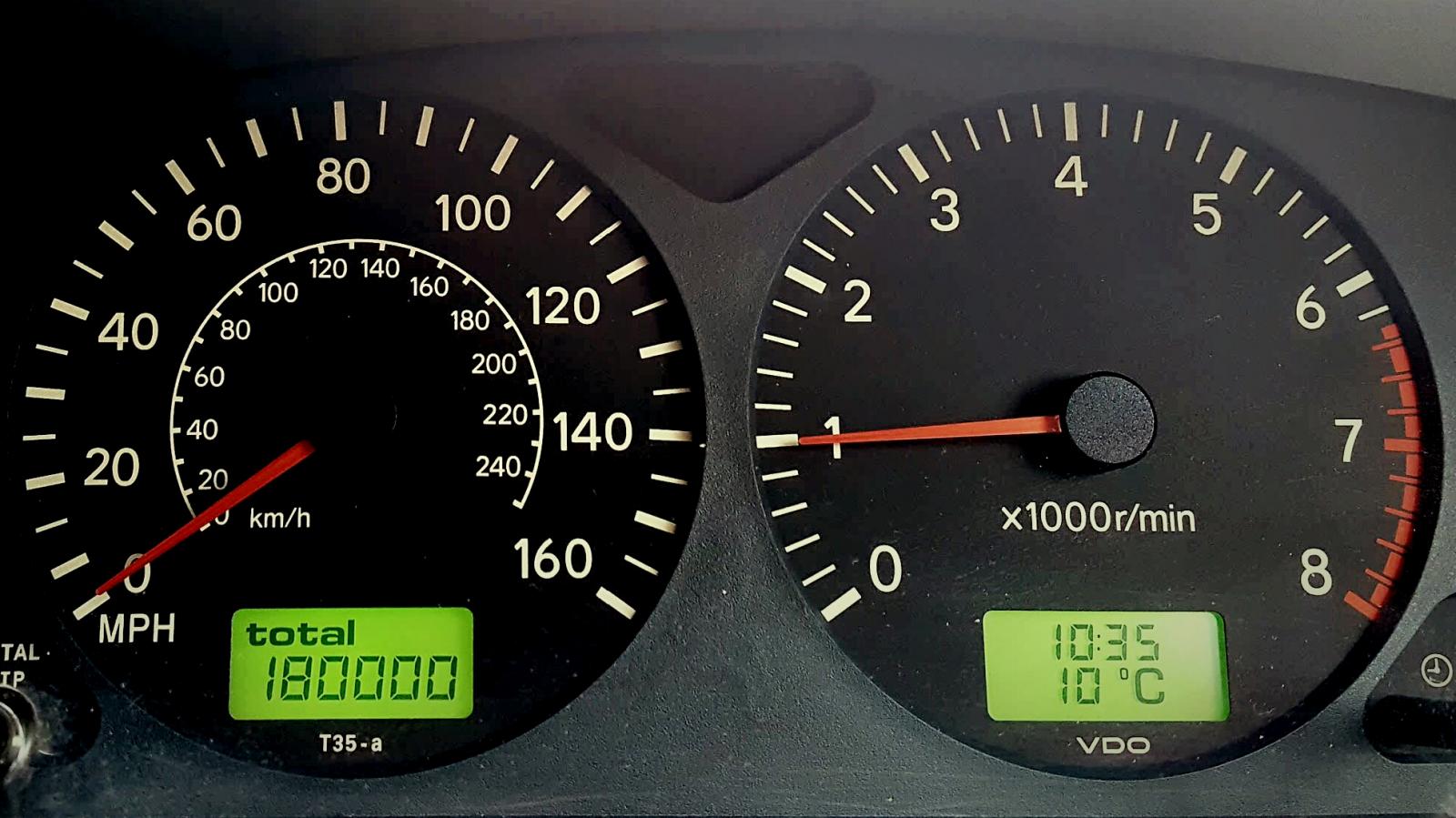

Today's news, used my mr2 as I'm trying to use it once a week at least when the weather's nice. Came off the motorway and the revs stayed at 2.5/3k. Pulled over to have a look and found a rubber grommet had come loose and was getting caught in the mechanism. Put grommet back where it should be, easy fix!

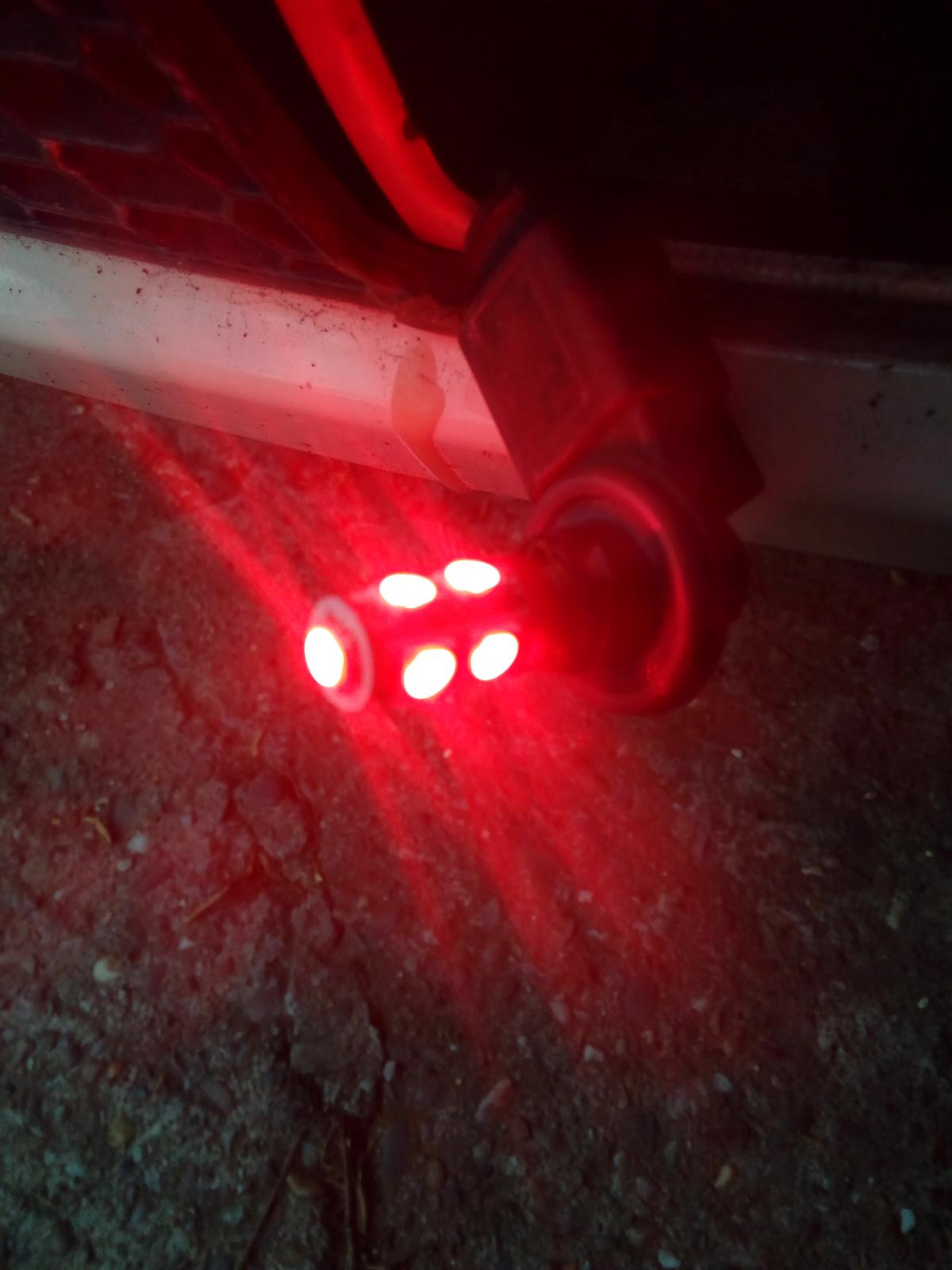

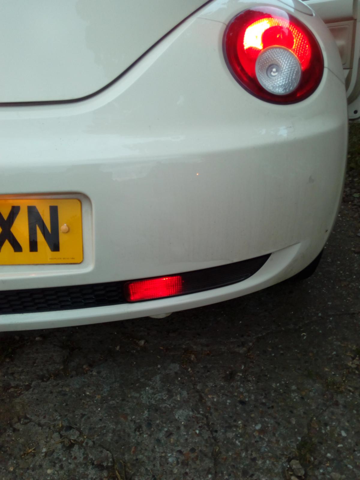

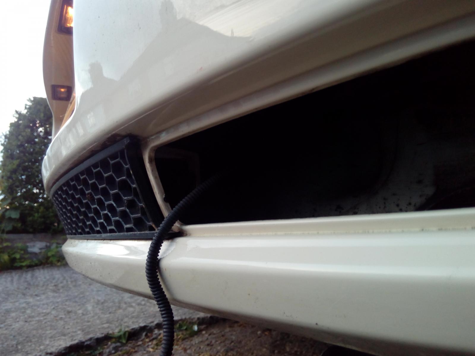

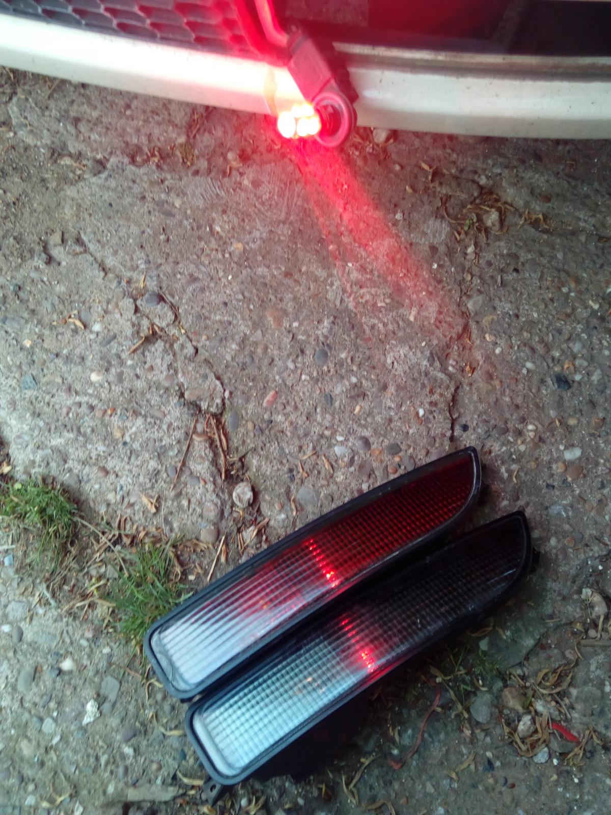

Girlfriend told me someone advised her a brake light wasn't working on her car, last week! OK, couldn't for the life of me see how to get to the bulb on a new beetle but one YouTube video later, all sorted. On to the next job... The bracket on the rear fog lamp has been broken for some time which results in it hanging a bit loose. I have a replacement lamp but it's off a left-hand drive car so the lens is clear. Recently found some red led bulbs of the correct size, £3.24 delivered from Hong Kong for two of them. Fitted the new bulbs and replacement lamp. All good apart from I don't think it's bright enough. It will do for now. In the meantime I used some gorilla glue on the old lamp to see if I can fix it. It's strange stuff. Needs water to work and them swells up. I've left it overnight so i'll see if it's worked in the morning.

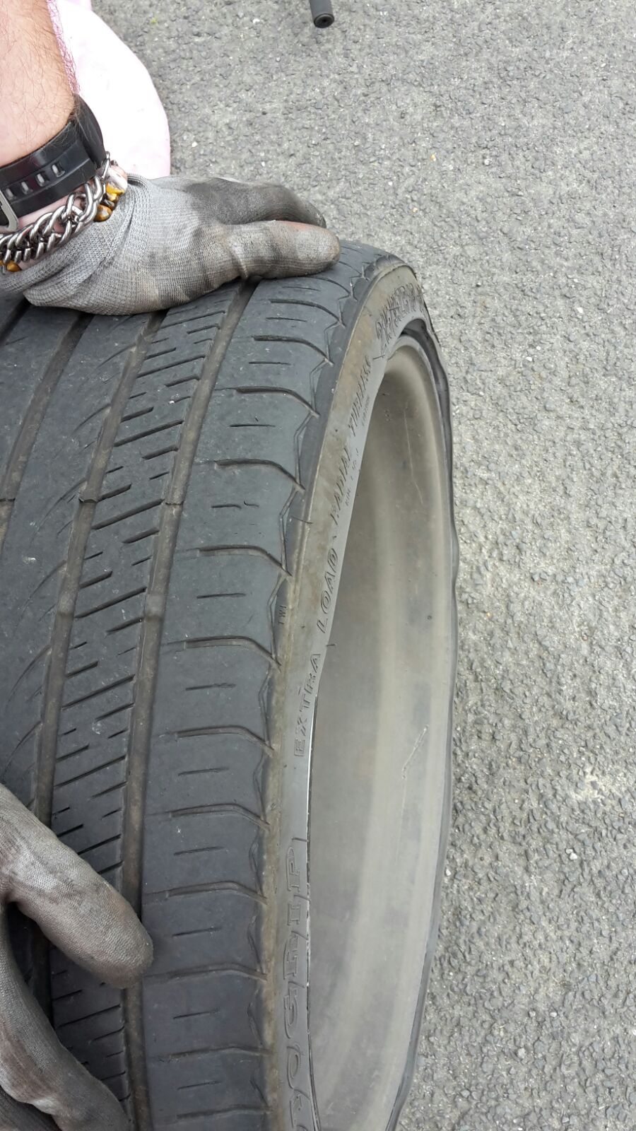

Not all that long ago, Wuvvum was complaining about wheels that wouldn't come off. "Odd," thought I. "I've never had that happen." Until today! The rears on the RAV are seriously stuck.
Put the wheel nuts back on loosely and went for a drive. Not a sausage. Went down a bumpy track. Nope. Visited the hotel car park and pulled a few handbrake turns. Bang! One of them freed off. The other is resolutely stuck. Oh well. I'll check the side I can check - drums need to come off for an inspection.
