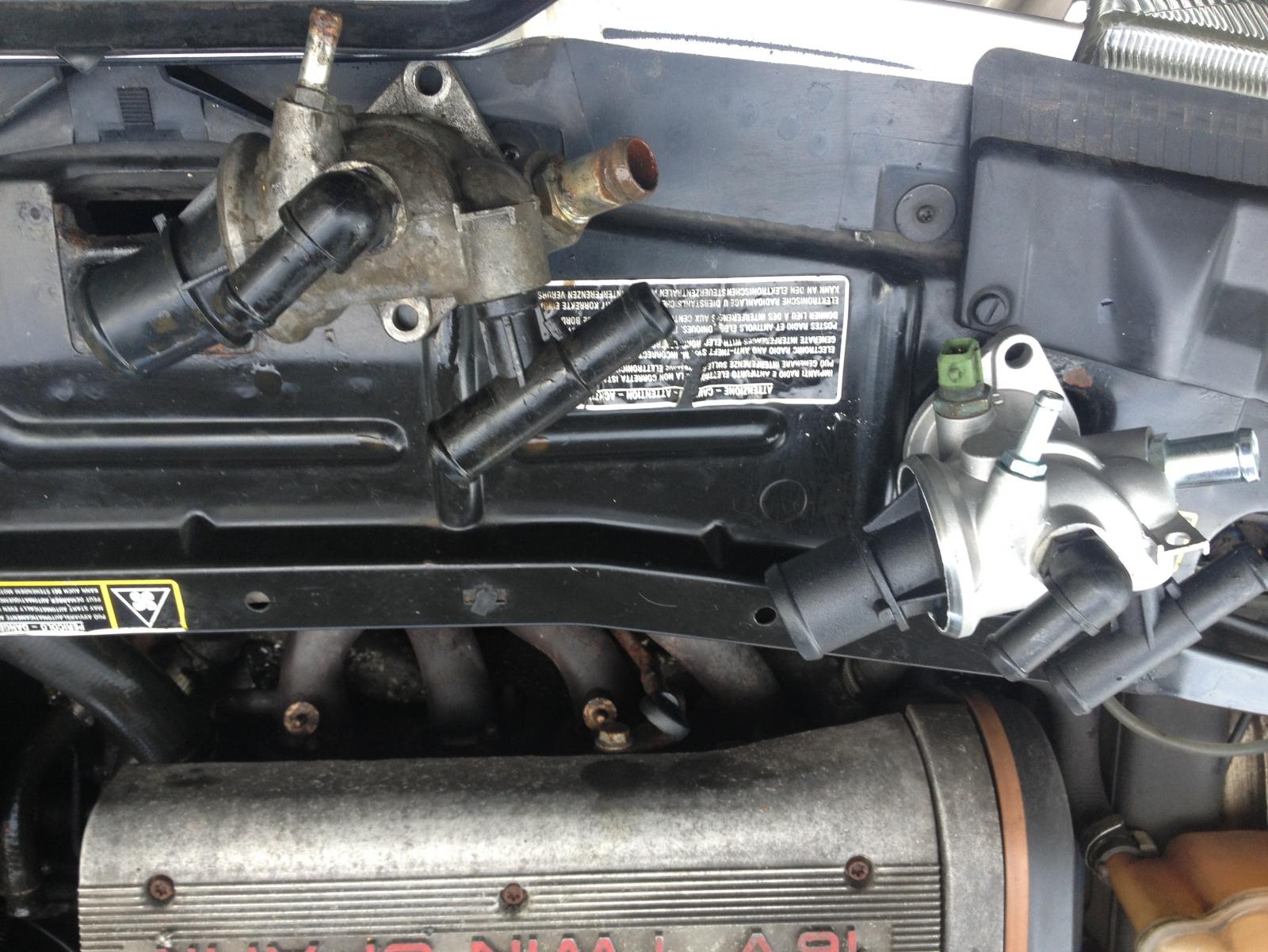

Alfa 155- over cooling sorted with a replacement thermostat, sits bang on at 90 rather than never passing 70; whilst I was messing about with the cooling system I flushed and replaced it, rusty water out and the good stuff back in.

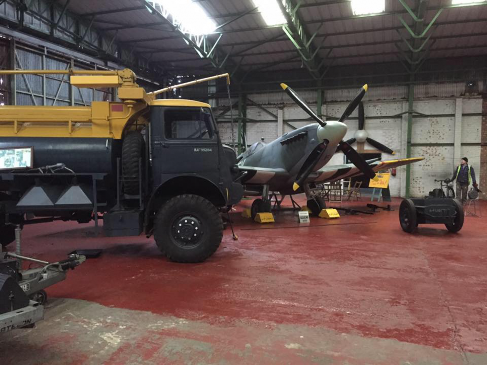

Have volunteered to do some electrical work in Hangar 42 at Blackpool airport. Home of the Lytham Spitfire team. This morning I was mostly gazing in awe at this lot:
Even got the chance to get inside the cockpit. To think that these were flown in battle by 18 year old lads was a humbling experience. Tiny cockpit with extremely limited forward vision on the ground. Amazing.
