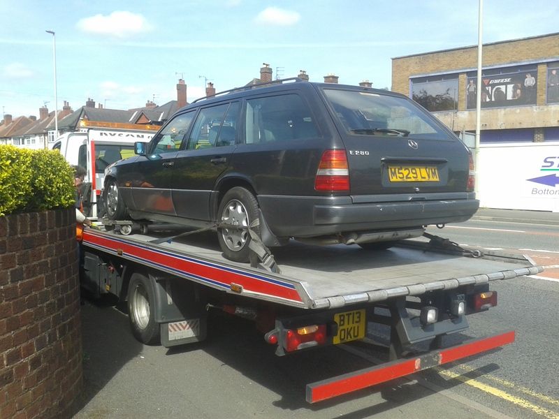

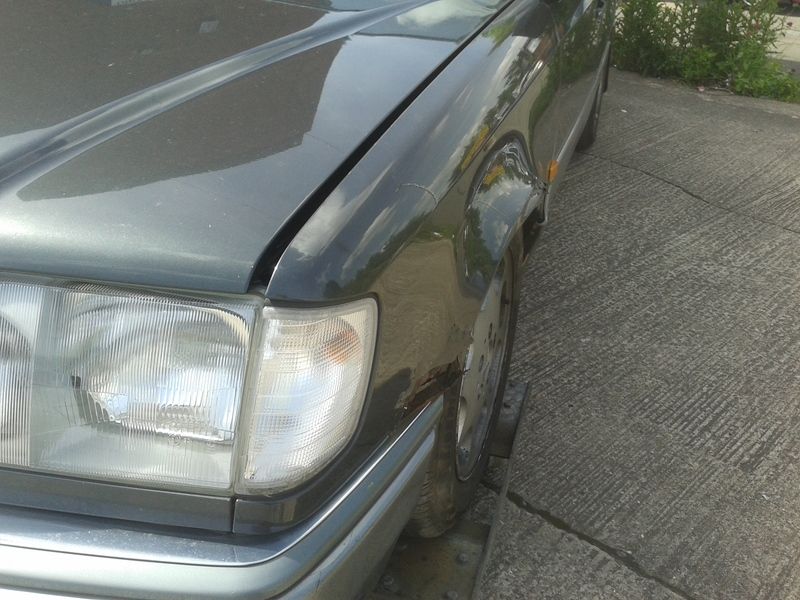

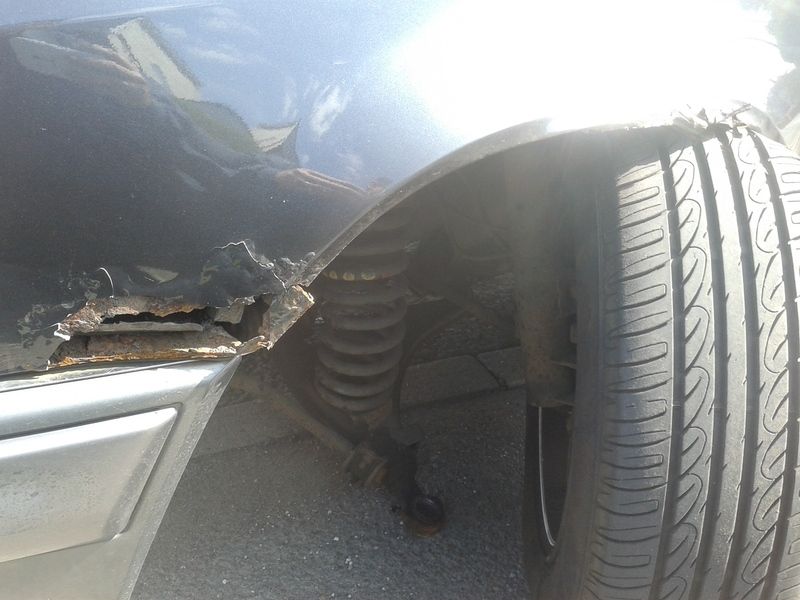

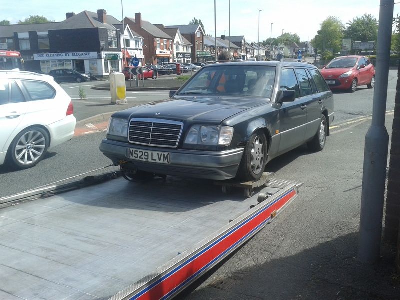

Well, this happened this morning on the way to work:
It did a "Beko1987 Citroen ZX" on me. Thankfully it happened at low speed as I was going around the roundabout. I went all the way around to avoid a line of traffic that was taking the same road I was heading which was first exit, as I went around the rouandabout I hear a massive CLUNK and the car dropping slightly, I then came to a halt. But as I was still in the middle of the roundabout I accelerated towards the nearest exit and pulled up onto a pavement to avoid being in the way.
Upon inspection the the balljoint had given away which now explains why the car felt so wallowy in the last few weeks. Whenever I turned the steering wheel there was never any positive feel in straightening the wheel and it would randomly wander and it got worse.
The Merc has been recovered to my mates garage, I have asked him to change the balljoints and arms on both sides, the P/S fluid will also get changed.
This also means I'll be on the search for a new wing, it's not noticeably damaged but it has taken out a chunk out where there was rust bubbles. I'll need to try and contact the chap who sold me the diesel wing as I stand a better chance of matching paintwork up. this will also be on top of a new bonnet and hinges as they were wrecked by carelessness.
Sigh... :neutral:

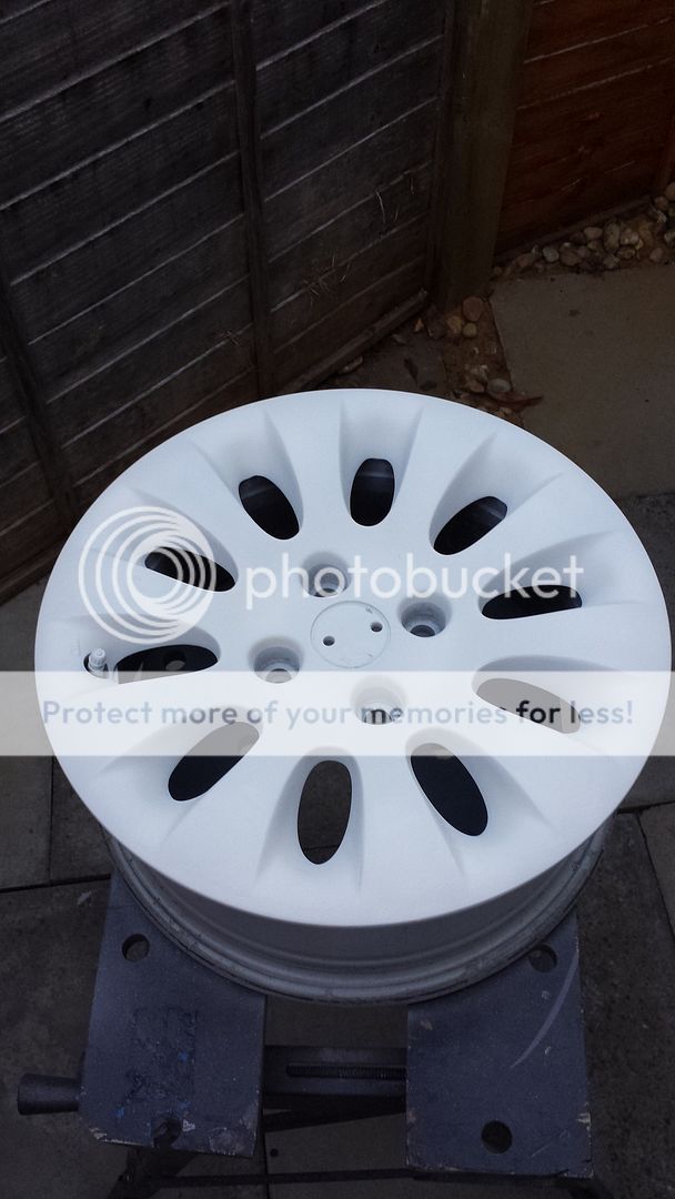

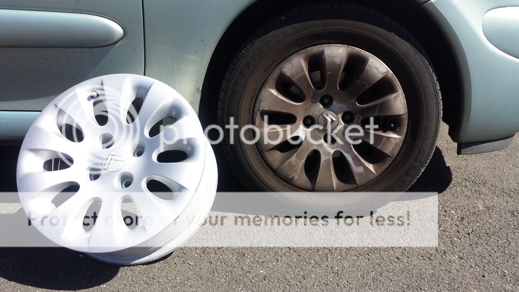

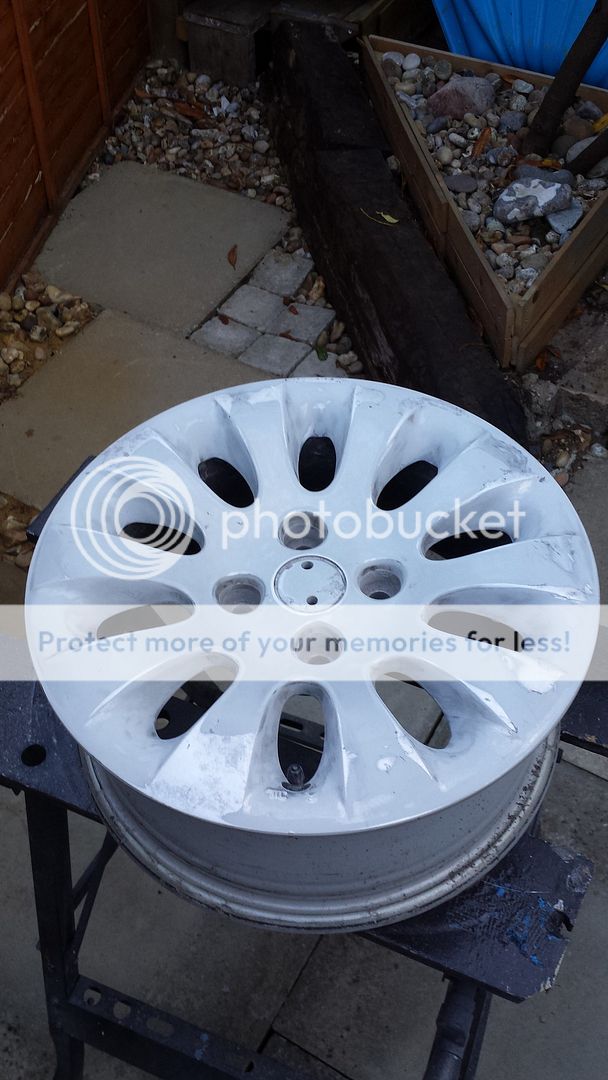

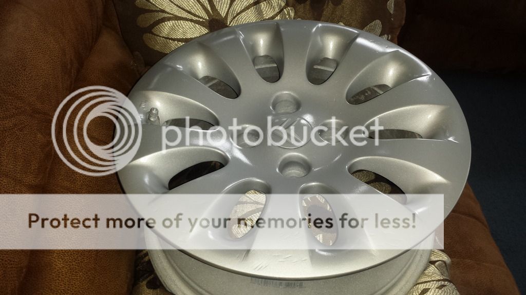

my mate asked me too tidy up a spare alloy he picked up for his missus shitreon piccashole

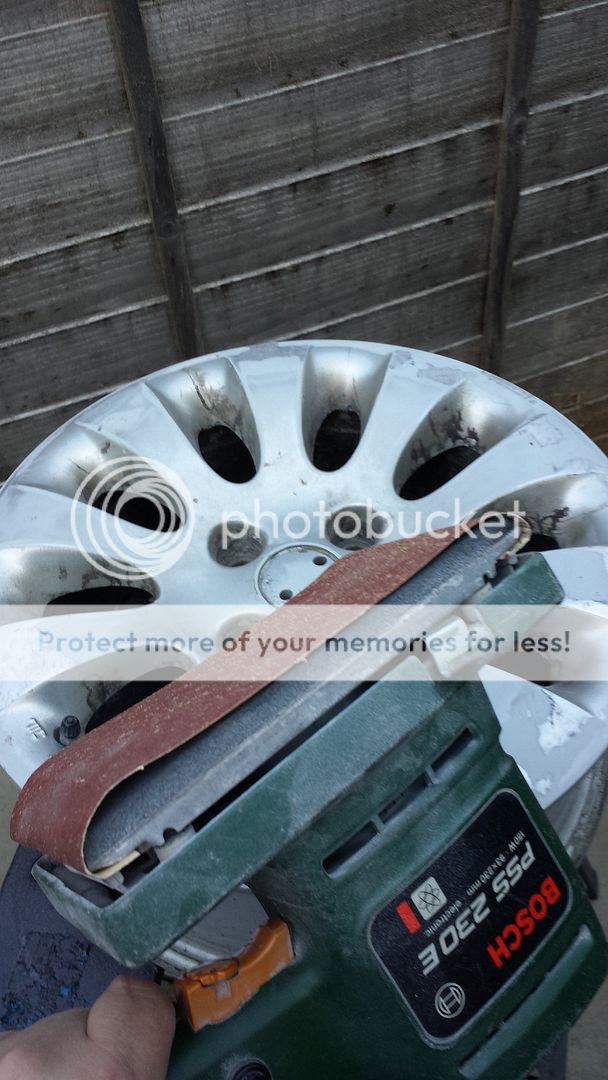

sander just took too long..so whipped out my favourite tool..
then got the sander back out..

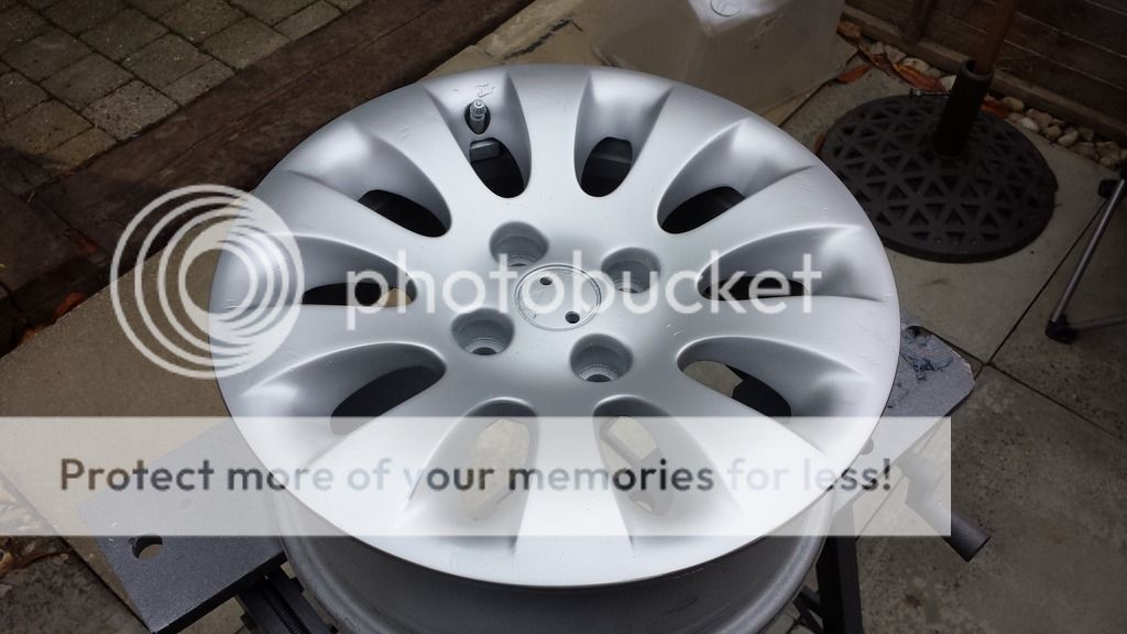

some primer
paint

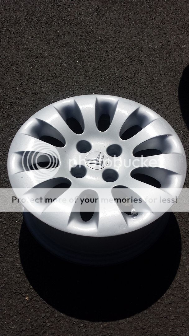

lacquer
in sun..
and next to the other wheels

Lord Sterling, this happened to my mate with the diesel coupe, on a roundabout at 20-ish. Amazingly, his wing survived with only a tiny crease. Plod who arrived said be grateful traffic plod wasn't anywhere near!  Somewhere there's a pic of a German who had this happen at hundreds of kilos an hour - he survived, just.
I always wonder whenever I see an approaching 124 if it's being run on a budget, especially when in a little car! England's roads aren't what they used to be, etc...  Glad it wasn't any worse.
Rescued a team mate who broke herself playing sports by driving her back home, any other cars have what amounts to a button for a clutch like the Mazda 2 (07-64) does?!
I've seen a few  older Merc's over the year with a prolapsed ball joint. More than any other car I can remember seeing it happening on.
I had a wishbone snap on my Passat. That was fun.
The 190's suffer the same problem. It's recommended as the first thing to change when you buy one if there's no evidence of it being done.
Germans in poor (dangerous ) design shocker !!
How about designing a balljoint that is pushed together by the weight of the car so its fail-safe
