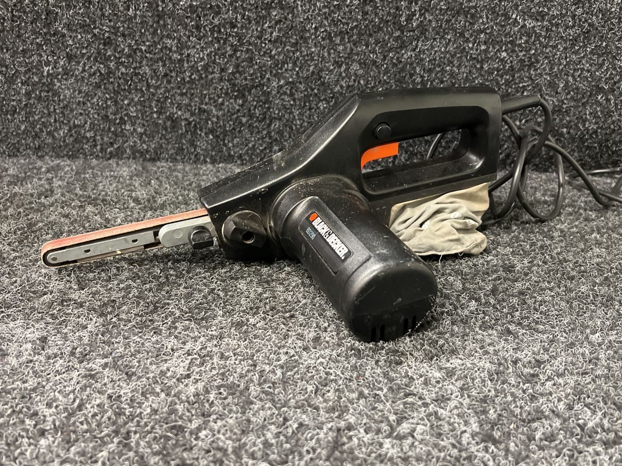

5 hours ago, SiC said:
The replacement belts from Screwfix/Toolstation are pretty shit though and don't last very long.
Even with good belts, I tend to save it for awkward areas as they don't last anywhere near as long as a flap or grinding disc.
The trick is to buy the full size belts and cut them down into approx 1-1.5cm strips. Not only do they seem to last longer, it's a much cheaper way to get them.  If you have a guillotine you can get nice straight belts but a strong pair of scissors is enough to get something perfectly usable.
I agree though that finger sanders / aka power files are one of the best things.
Only thing to watch is to never put too much pressure on it, let the belt do the work.  The bearing on the tip of the sander overheats and fails mega quickly if you lean on it for more than a few seconds.
I've been through a few..

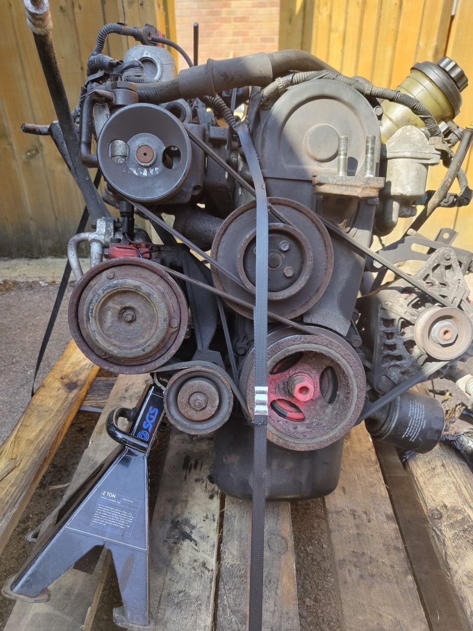

Next job on the list, changing the engine on a 2004 Hyundai Getz 1.3. Used engine delivered today. It's my son's car and he's doing the work.
Engine looks nice and dry. Hope the swap goes smoothly!

Finally got around to ordering myself a finger sander (not for sanding fingers, I hasten to add) so I can have an easier time of some of the bodywork repairs on the Princess.  Couldn't afford a big name one so just got the Titan brand one from Screwfix and hopefully it'll be at least as good as anything I'd get out of the Midl of Lidl.
The FiL bought a cordless one from aldl/lidl said do i want his old one, but wasnt cordless, did i still want it, ermm yeah, free tools always welcomed

My son's going to do most of the work. It's good practice for him. He's got his test this week.
It's a free car he was given by his mum's partner's ex wife. Modern families hey! It is a bit ropey in places, rusty coolant and had been radwelded, no working front windows, inoperative heater and fan, and a cracked rear bumper. Engine was a bit smokey or steamy, I can't remember. My son went straight in, replacing the water pump and cambelt. I left him to it and he managed to put the cambelt on incorrectly. He was a bit gutted. The car's sat for a while but I've encouraged him to fix it as he's just finished college and trying to get an apprenticeship as an electrician. His first year was level 2 engineering.
It does look good and it came with all the anvilkiaries.Its from an auto so he needs to remove the flywheel bolts apparently. He's already stripped the old engine. Cost me £290. Maybe not economically viable as it also needs a windscreen and the other issues fixing. The good thing is he already bought all the service parts, water pump, and the cambelt!
