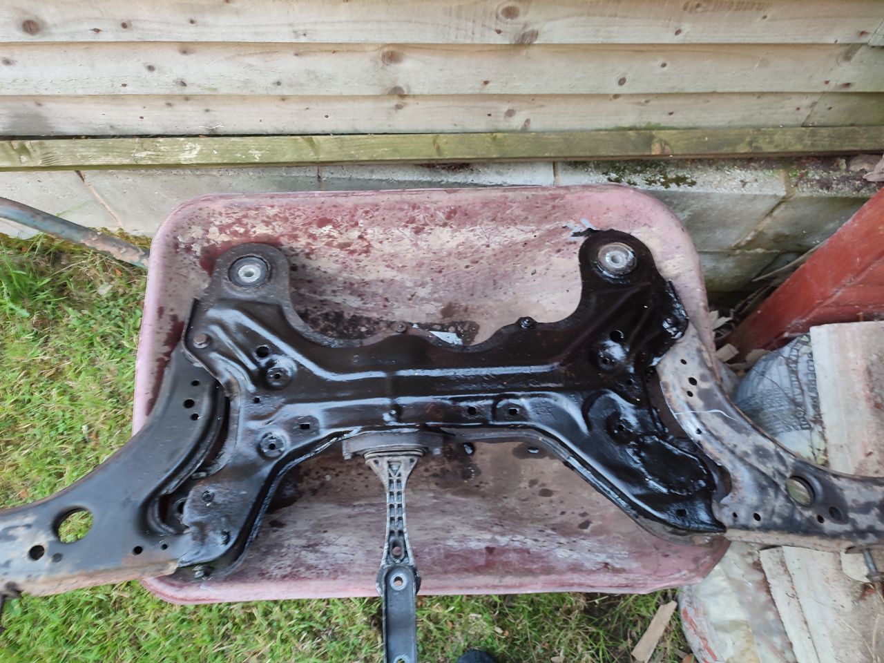

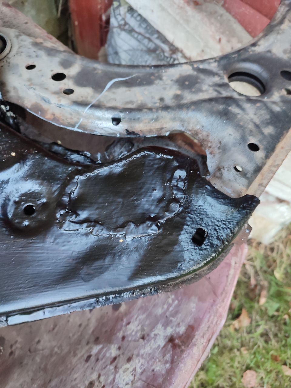

Jacked the front of the Leaf up and removed the arch liner so I could put a bolt through the end of the bumper to hold it onto the wing - so with the new bracket as well it's as properly fitted as it's going to be.  I didn't get around to investigating the knocking from the nearside, that's a job for another day.
Backed the i-Miev up onto the ramps, gave the rear inner sills a jet wash and a wire brush then sprayed them with anti-corrosion wax - they were the one advisory on the MOT, still very much only surface rust but i-Mievs are somewhat rust prone so I didn't want to give it a chance to get any worse.

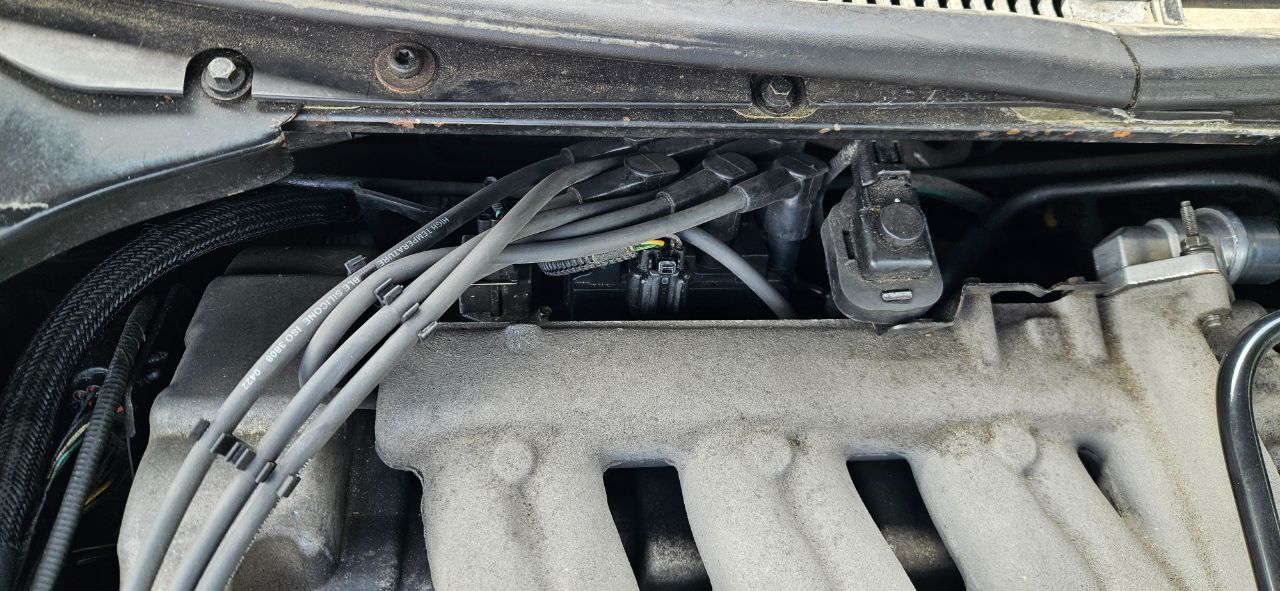

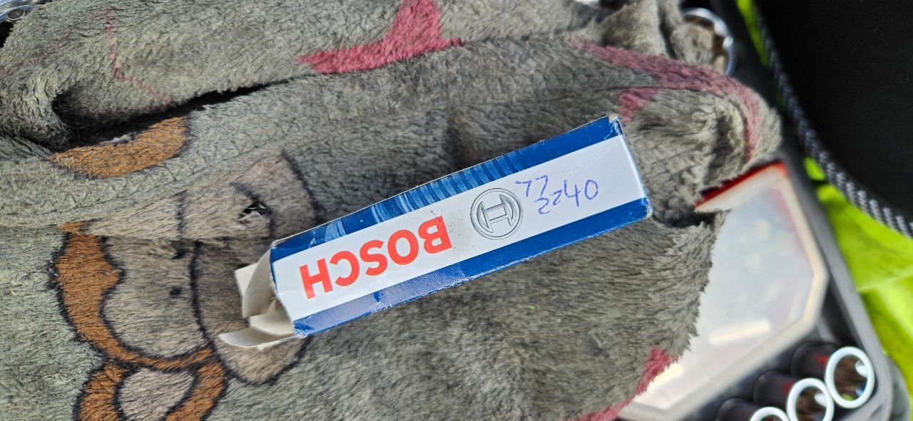

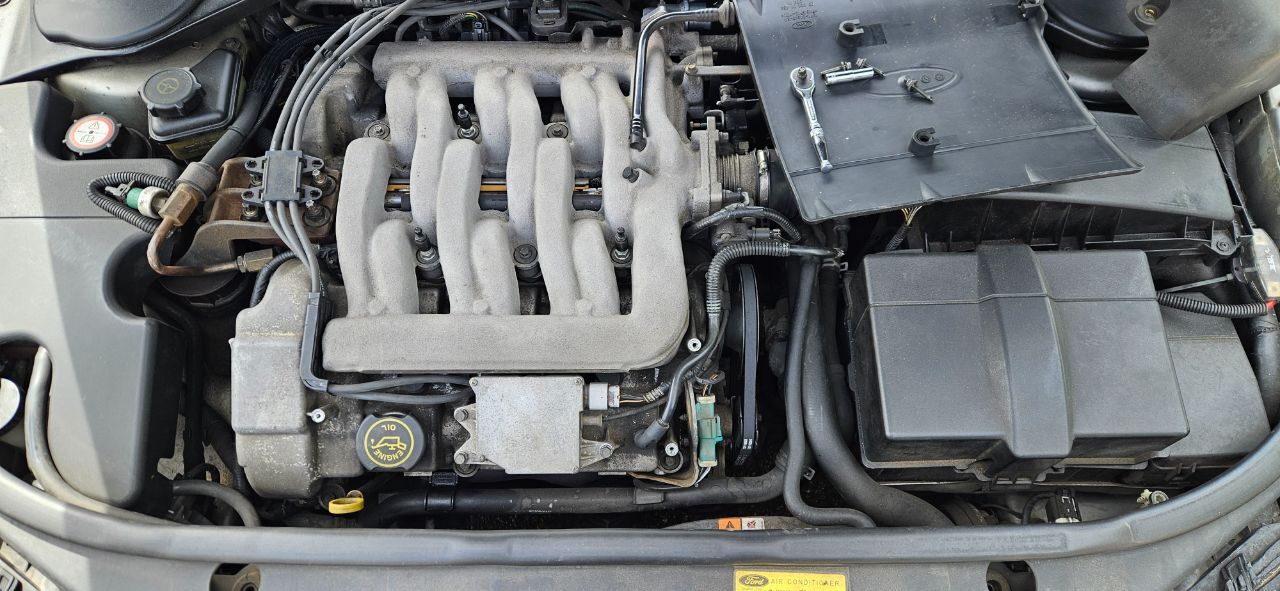

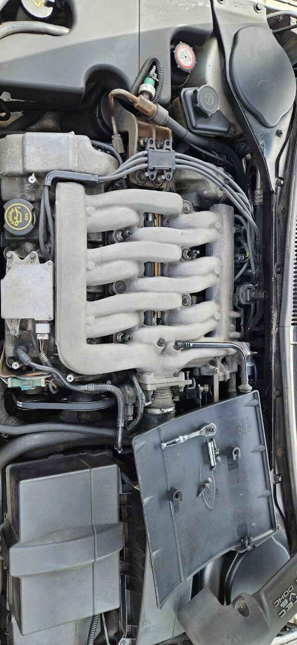

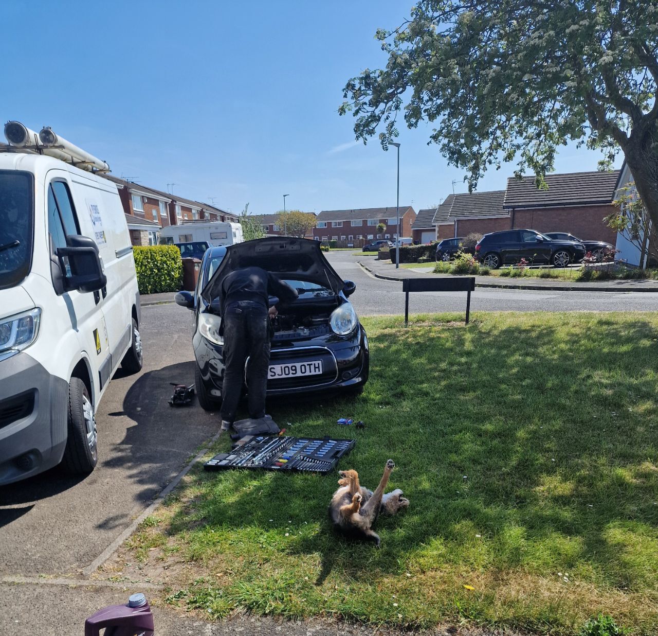

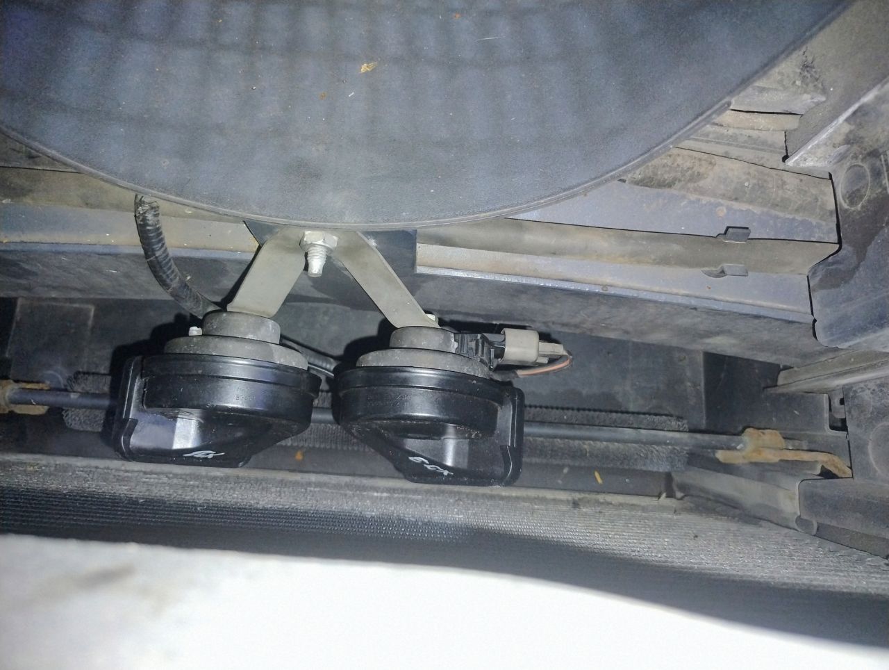

The horn on my Jaguar S type has always been feeble. It stopped working completely last week.
I got my son, who's car mad and training to be an electrician, to check all the connections and he confirmed the relay was working. I bought replacement horns from an XJ which are going on today. My son opened up the old horns and this is how they looked. Hoping for quite an improvement!

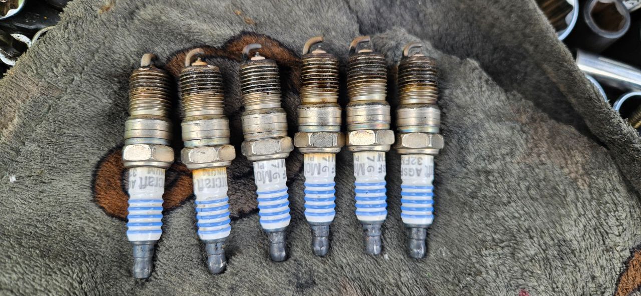

I fittwd a powerlite starter to the SD1 at the end of March but I had urgent jobs around the house so it had'nt been touched for about ten weeks.
The oil pump on the Rover V8 can empty if left too long - starting ones of these that has been left standing can be risky.
So off come the rocker covers. No 1 cylinder/ piston needs to be TDC with the two valves closed. Mark the dizzy - or take photographs.
Then the distributor clamp can be removed. Then the distributor.
Years ago I made a tool that fits an an electric drill - it has a slot in it to locate in the male end of the oil pump drive.
As the drill spins it will slow as the oil pressure begins to build -
Once you have got oil pressure you will start to see oil at the rockers.
Now I need to refit everything and fire it up. I dont enjoy doing this because the plugs are usually piss wet through from all the cranking.

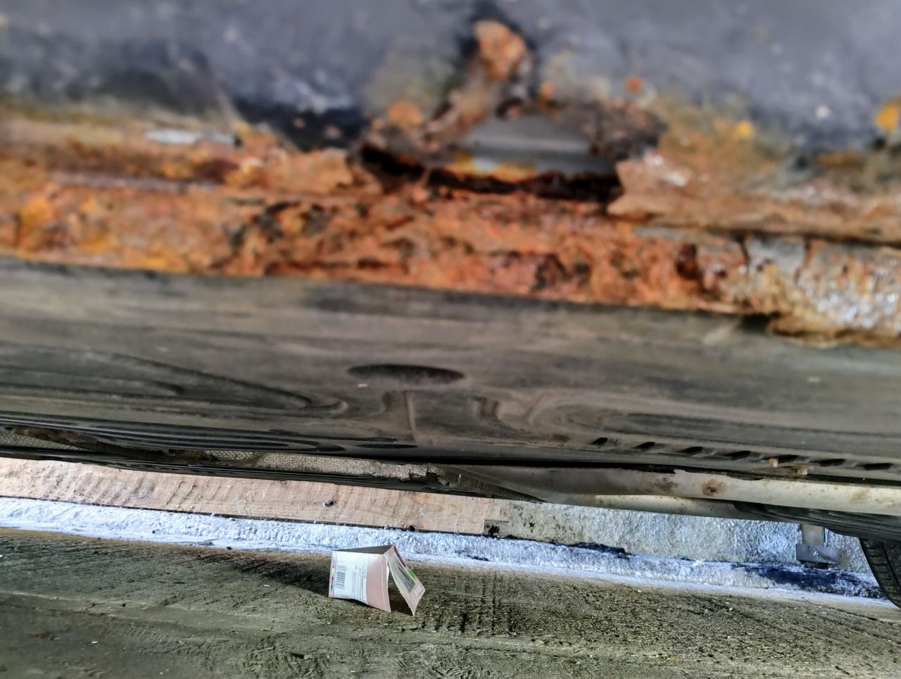

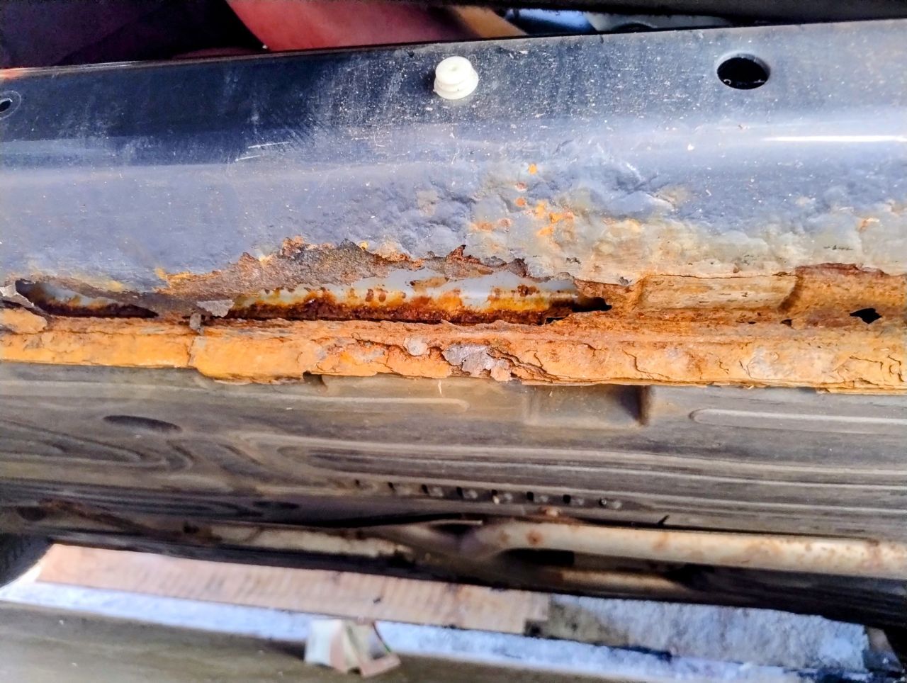

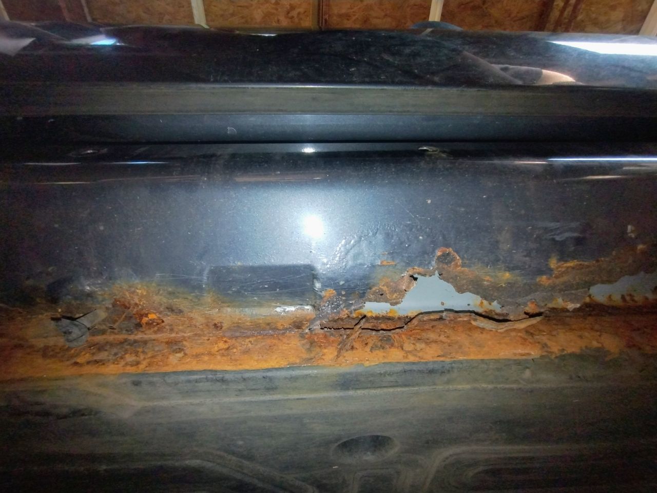

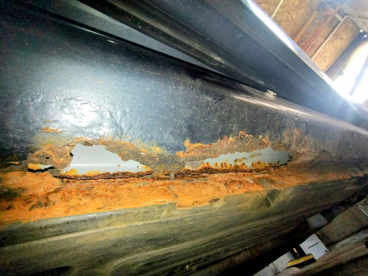

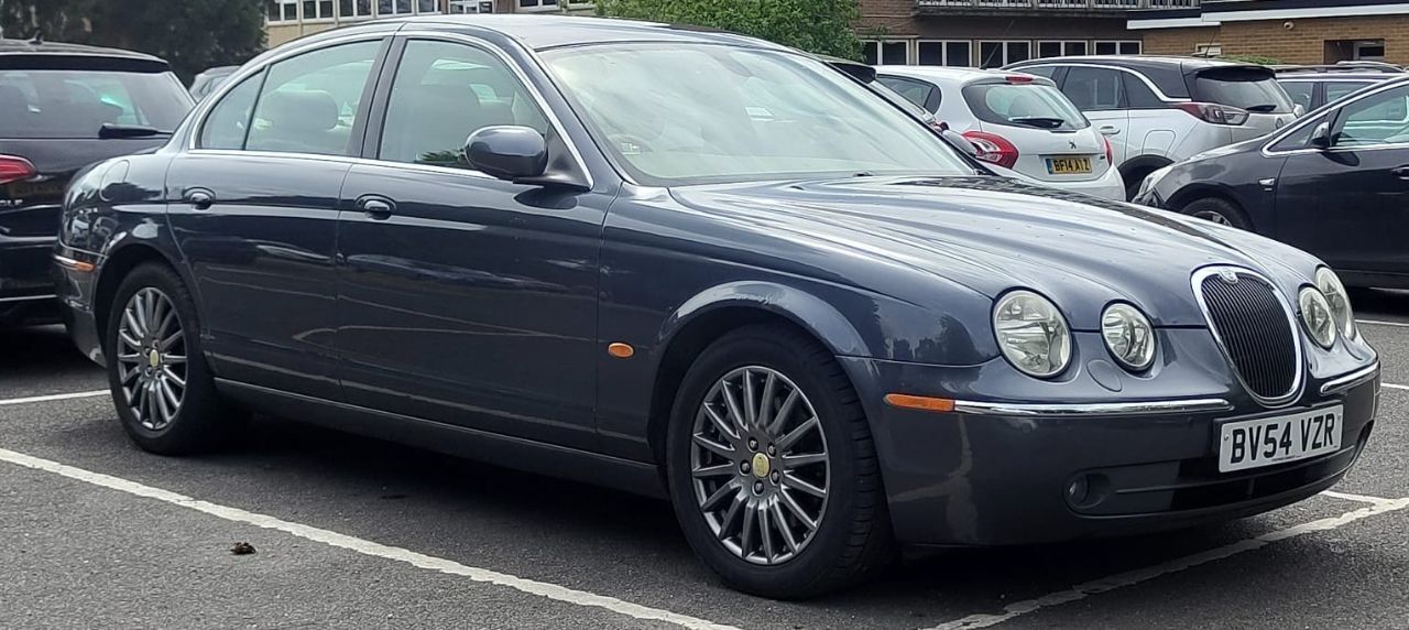

Horn fixed, replacement brake servo fitted, and drivers side sill cover removed on the S type by my 18 year old son. Can anyone spot any issues? Clue, it's not the horn or the brakes.
It's crusty all along it's length. I doubt the nearside is any better.
Good old Jaguar. I don't think there's a single S-Type out there that's any better.

It's a shame as other than a few scratches on the bodywork it looks mint. It's been through many MOT's like this due to those plastic covers.
Time to put it to rest although I may pootle about in it for a bit longer as it's MOT'd until December :sad:
It doesn't look too bad for someone to weld up.
The problem would be finding someone to do it though.
