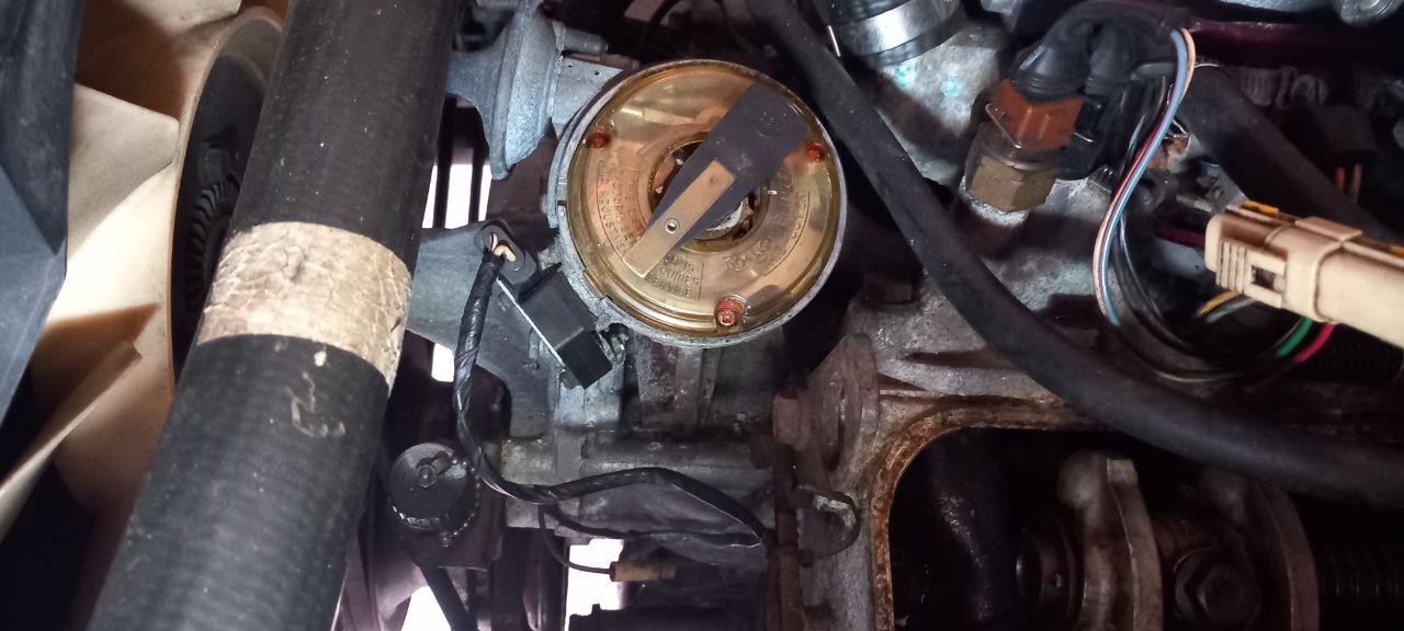

I fittwd a powerlite starter to the SD1 at the end of March but I had urgent jobs around the house so it had'nt been touched for about ten weeks.
The oil pump on the Rover V8 can empty if left too long - starting ones of these that has been left standing can be risky.
So off come the rocker covers. No 1 cylinder/ piston needs to be TDC with the two valves closed. Mark the dizzy - or take photographs.
Then the distributor clamp can be removed. Then the distributor.
Years ago I made a tool that fits an an electric drill - it has a slot in it to locate in the male end of the oil pump drive.
As the drill spins it will slow as the oil pressure begins to build -
Once you have got oil pressure you will start to see oil at the rockers.
Now I need to refit everything and fire it up. I dont enjoy doing this because the plugs are usually piss wet through from all the cranking.
