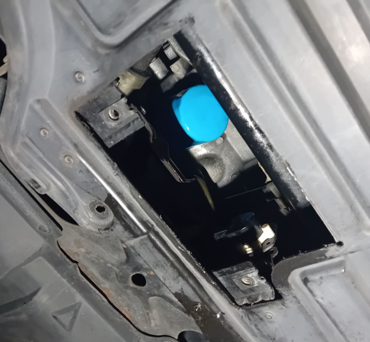

Nice big 3.5 litre engine has the tiniest oil filter!
Which you have to get too through a letterbox.

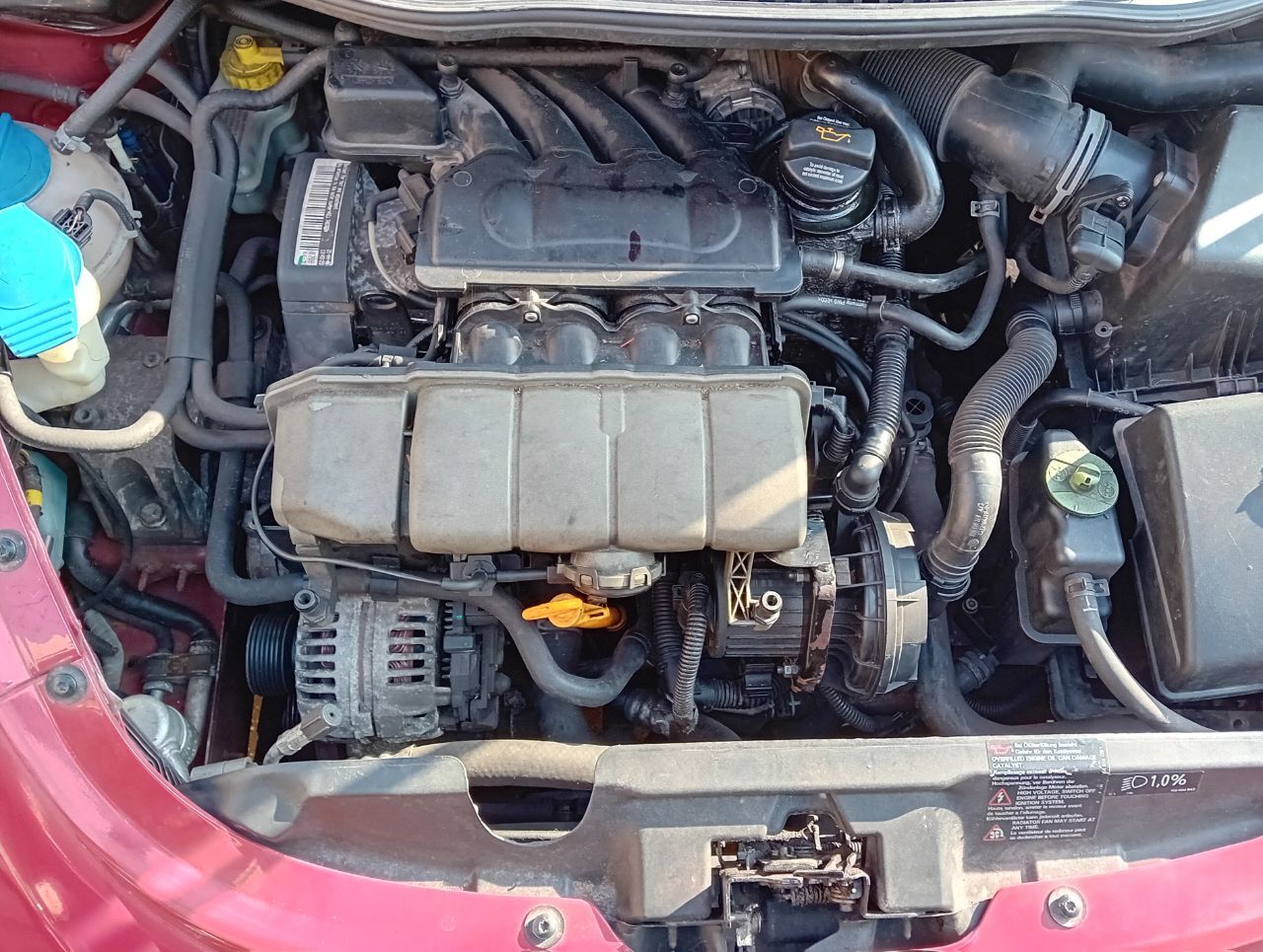

So three down, one more to go - our Beetle was running like shit, misfire on cylinder 4, I assumed coil pack even though I changed it about 18 months ago.
To the right of the inlet manifold, beneath a lot of stuff, lies the coil pack. Upon closer inspection I could see a spark jumping from number 4 lead to the bracket on that big round thing. Had a closer look and the lead was damaged. I changed these 18 months ago with the coil pack. Managed to find the old ones, popped it on, running sweet as a nut again. Really not sure how it got damaged, but classing that as a nice easy win.

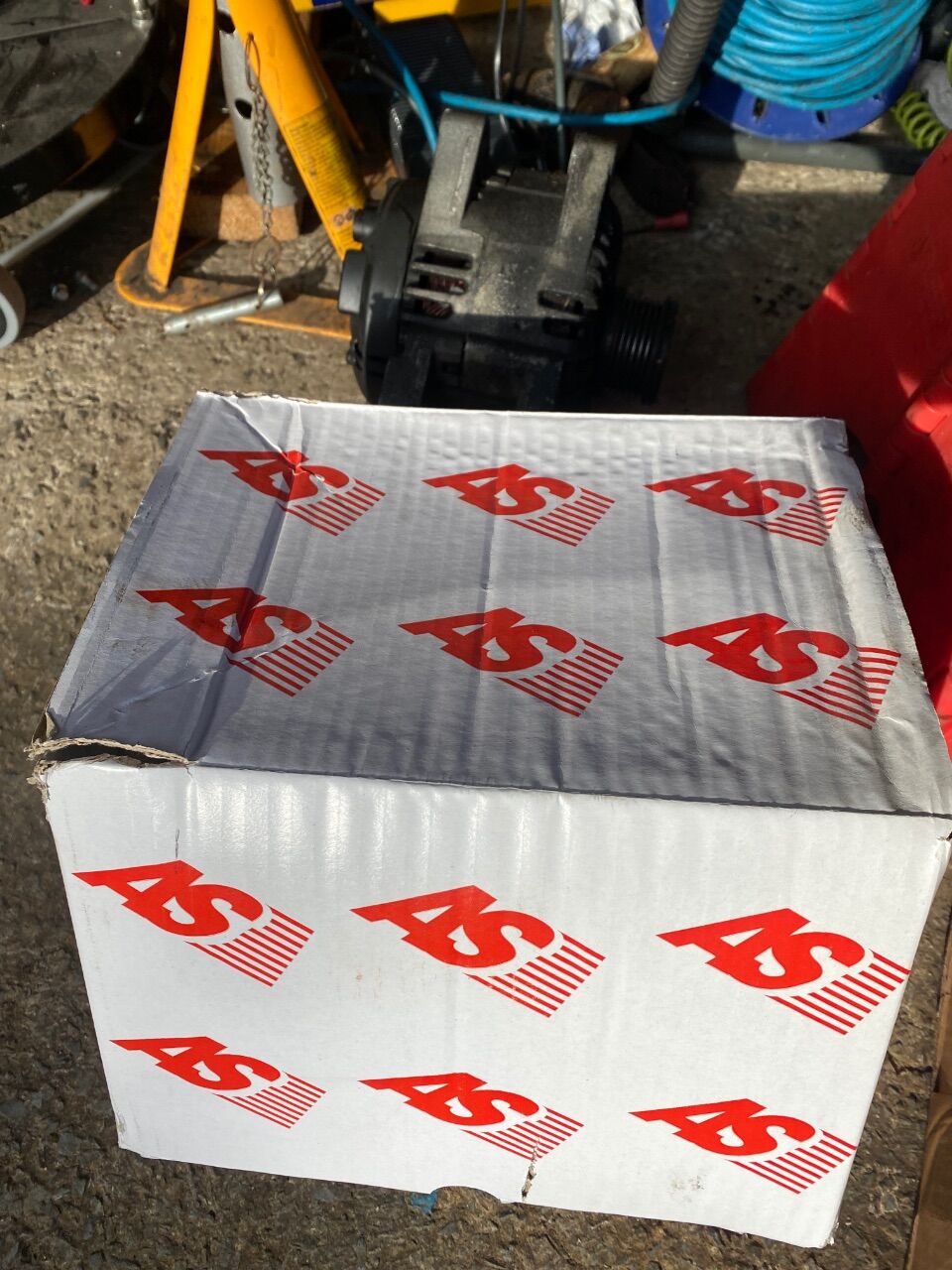

Our Trigger's broom Indesit condenser dryer had another FTP last night. No burning smell, motor is working, plenty heat but drum wasn't turning. I suspected the belt had slipped off but how?
Tensioner bearing completely shot and wobbling about allowing the belt to slip off.
New one ordered from Espares, should be here tomorrow. Another £300 odd saved!
Nice when you manage to save something from the tip, but IME manufacturers are actively making stuff to stop you, hence washing machines with welded drums etc.

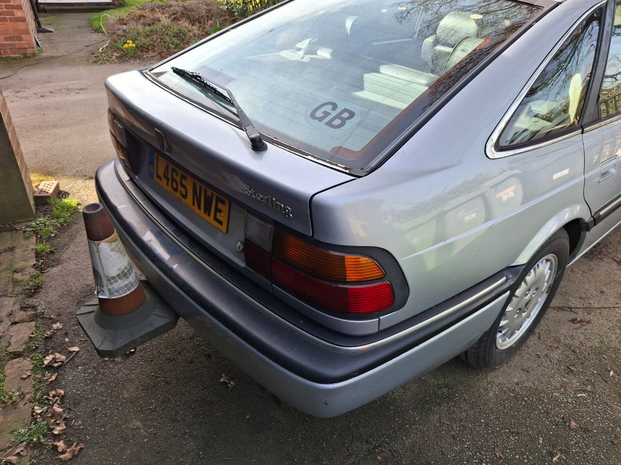

Got the handbrake adjusted up as best I could on the Rover.  Hopefully it'll be good enough for a pass, it's still rubbish but does feel a bit better than it was before, and it was only 1% off the minimum requirements anyway.
