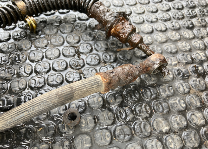

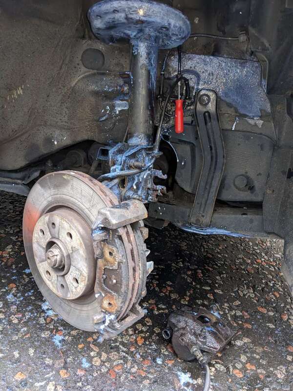

Front flexis on a FreeLander 1 - just what size is the flats on that union? 3/8"?
Nevermind, all the steel bits are shagged so, off they come - the grumpy bit is the nearside one (not shown) rust goes all the way up through a funnel shaped grommet and comes out under the battery and ECU box - that'll be a twenty minute job taking two hours tomorrow then :-( (assuming Craddocks get their fingers out and send the parts).
MoT expires 14th Feb .......

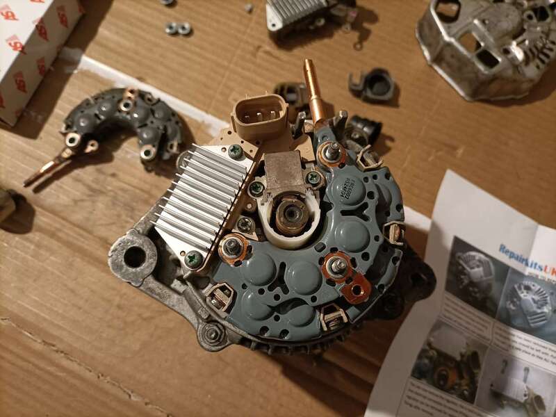

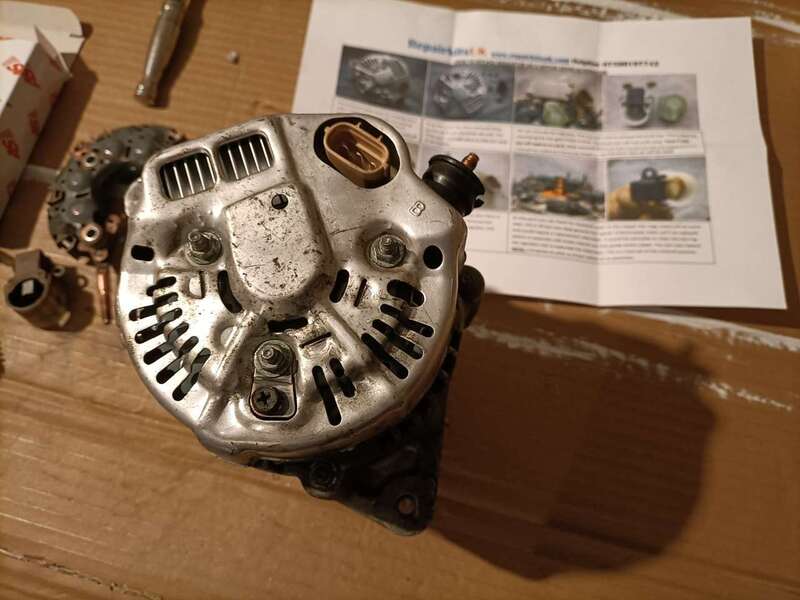

My Granvia after sitting since Xmas has decided not to charge it's batteries anymore.
Its original alternator started draining the electrical system and getting smelly back in the summer and I found a nearly new recon one on the internet and once fitted I found the charge warning light wasn't coming on but fortunately it was self exciting and charging fine until the other day.
I checked the alt multi plug and warning lamp circuit which was all good.
The cheapest 'recon' unit I could find was £149 far to salty for me so went for plan B.
Rectifier,regulator and brush pack for £56.
Annoyingly the positive post on the rectifier was misaligned stopping me fitting the nylon insolation collar over it. I didn't want to try bending it straight so I cut a bit of alternator body away instead.
I'll bung it back on later and hopefully get it back on the road.
I've used this guy before when i fitted new solenoid contacts to the Granvia starter motor he has a decent eBay shop and delivery is quick too.

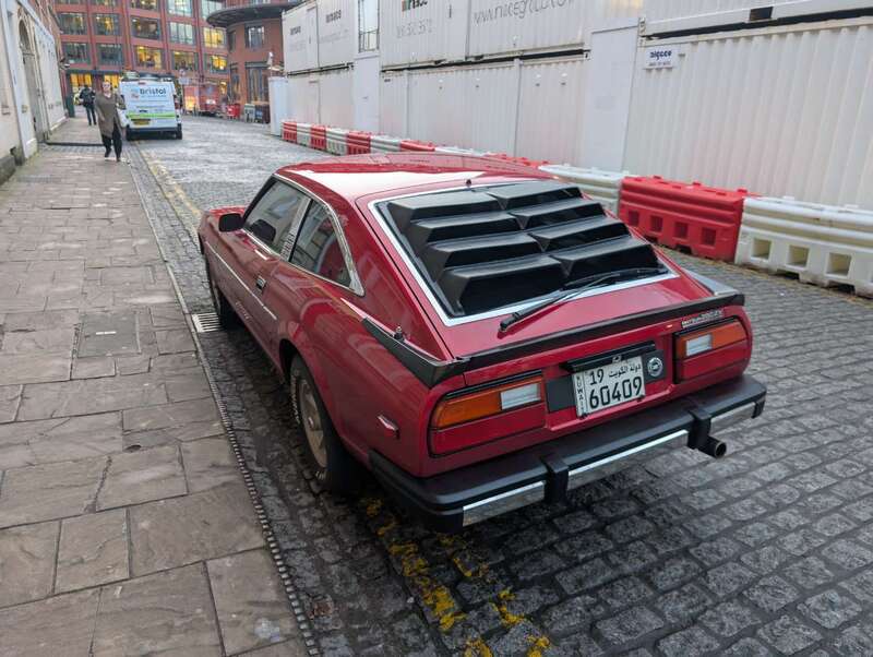

18 hours ago, SiC said:
Spotted this near the Bristol BBC wildlife and old top gear offices on the way to the train station.
What is a Kuwait registered mildly customised 80's Nissan 280ZX doing parked on double yellow lines in Bristol of a February afternoon?
Has there been some rupture in the space time continuum?
Very odd spot.
They sold quite well in the UK but really rusted - and most long gone.

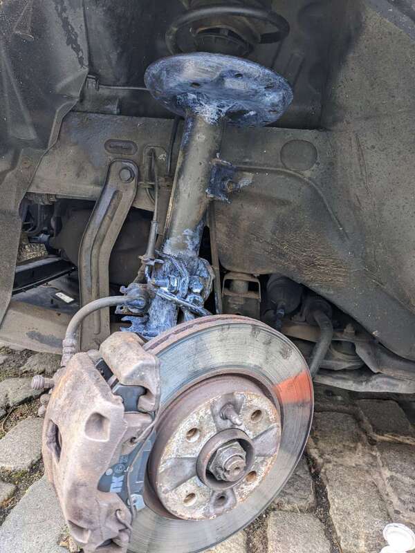

Wife's Ypsilon failed MOT on a leak where hose meets caliper (had somehow got unscrewed) and an indicator bulb that wasn't orange enough. Central Edinburgh MOT garage (i.e. the chancer at the reception desk) was keen to supply a new hose, caliper and bulb for at a cost including the MOT of £705 - SEVEN HUNDRED AND FIVE POUNDS! 3 HOURS labour and £220+VAT for a caliper wtf. Needless to say I told them to fuck off. £80 for new caliper, hose and bulb on fleabay and Amazon plus some new pads because why not. Fail side took me 40 minutes and other side pads 20 minutes and about 15 minutes for a spot of preventitive rustprofing, old caliper & pads were shite. Weren't too friendly when I took it back for retest and I'm tempted to copy this to the grumpy forum - so glad I'm a spannerer as can't imagine how stressful it would be to be at the mercy of commercial repair places.
