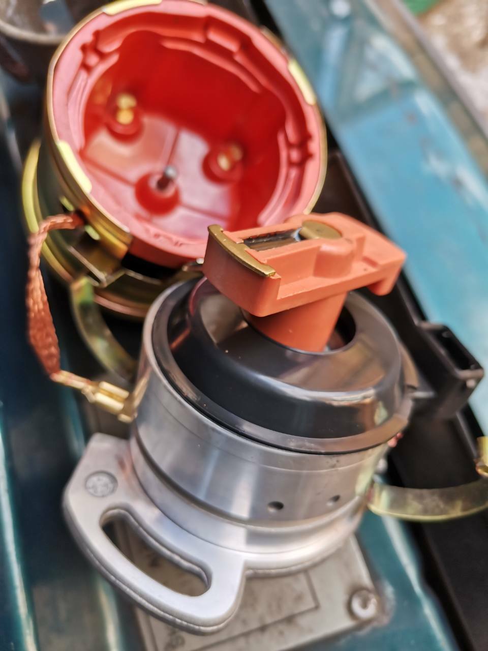

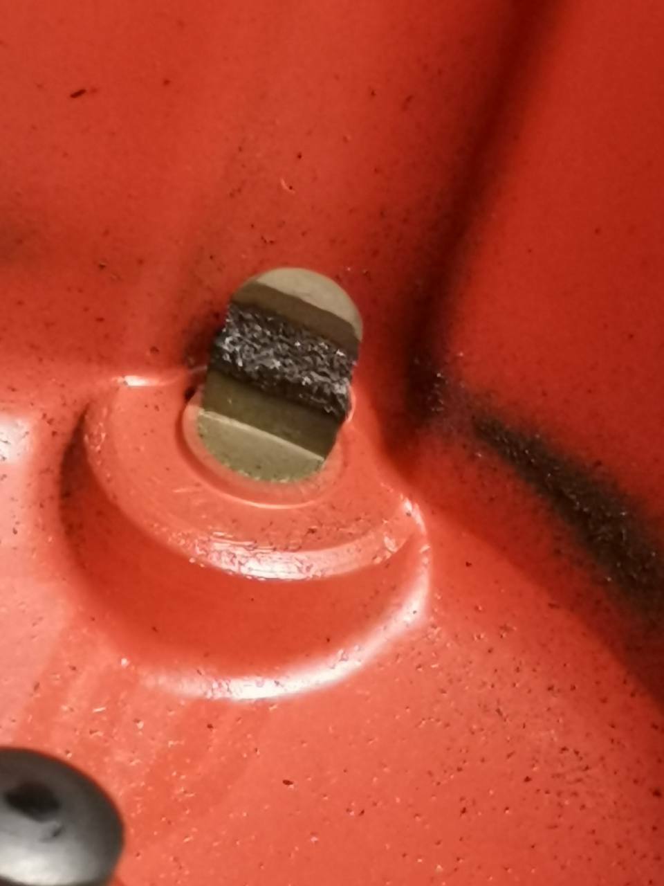

Once I got it home I have confirmed there is no spark. The rotor arm and dizzy cap don't look great but I wouldn't have thought they would cause sudden and immediate FTP. My guess would be the coil. I've already had to replace that once, about seven years ago, but it's kind of expected these days that replacement parts are shit and never last as long as the originals.
Anybody have any other ideas of what causes sudden loss of spark? Is there anything obvious I'm overlooking.
My money is on the crank sensor if it were a game of parts darts - I've replaced this on my Favorit twice now under similar circumstances. See if it turns on when cold, in the early stage of failure the sensor seems to stop sending a signal once it gets hot. This is all under the assumption that this is a 1.3 mpi and not a VW motor in it.
Ignition switch ? Pretty common 1990s VW problem, they fail without much notice and result in a "turns over but won't start" fault.

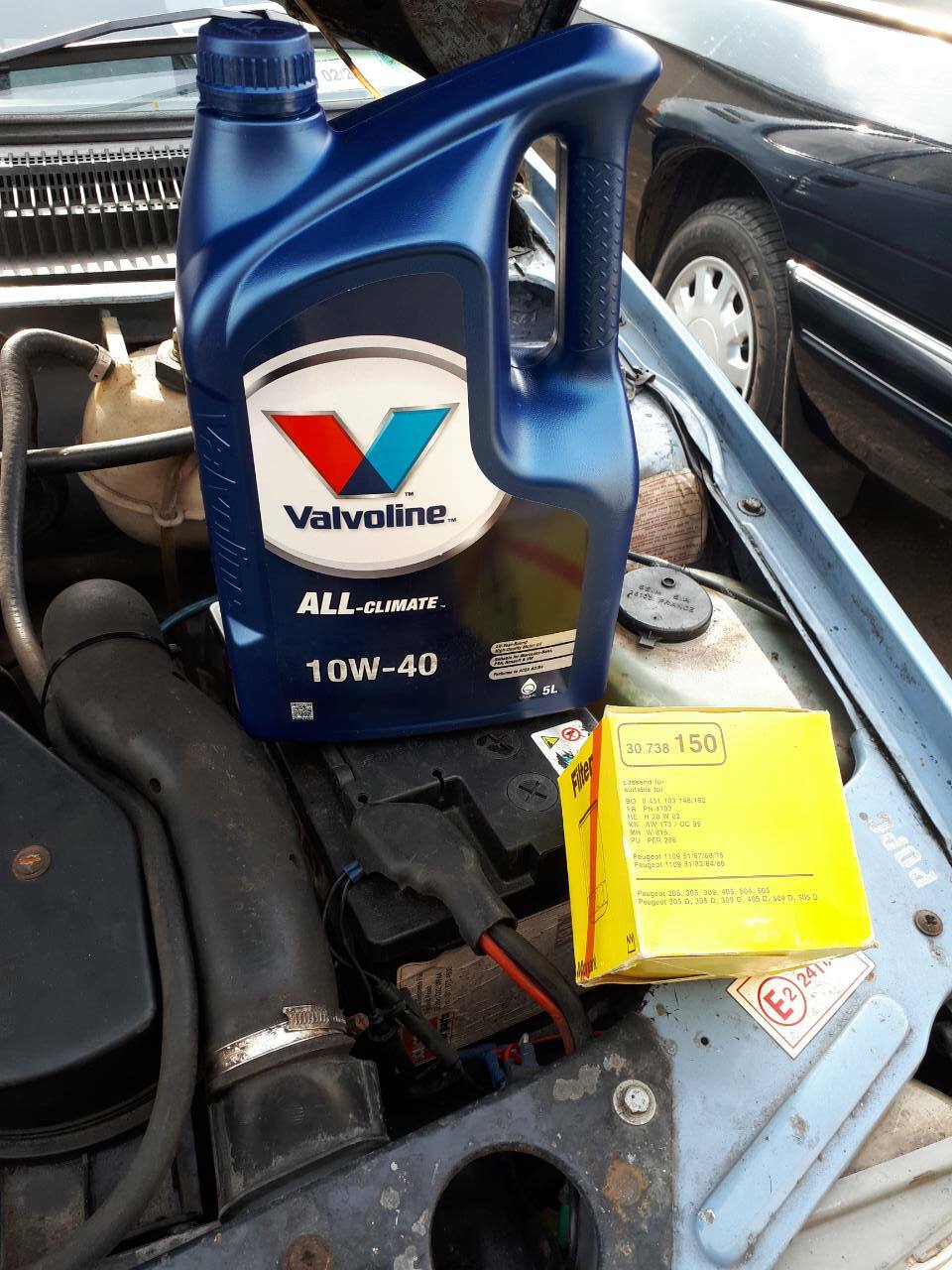

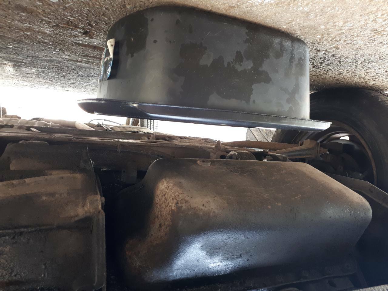

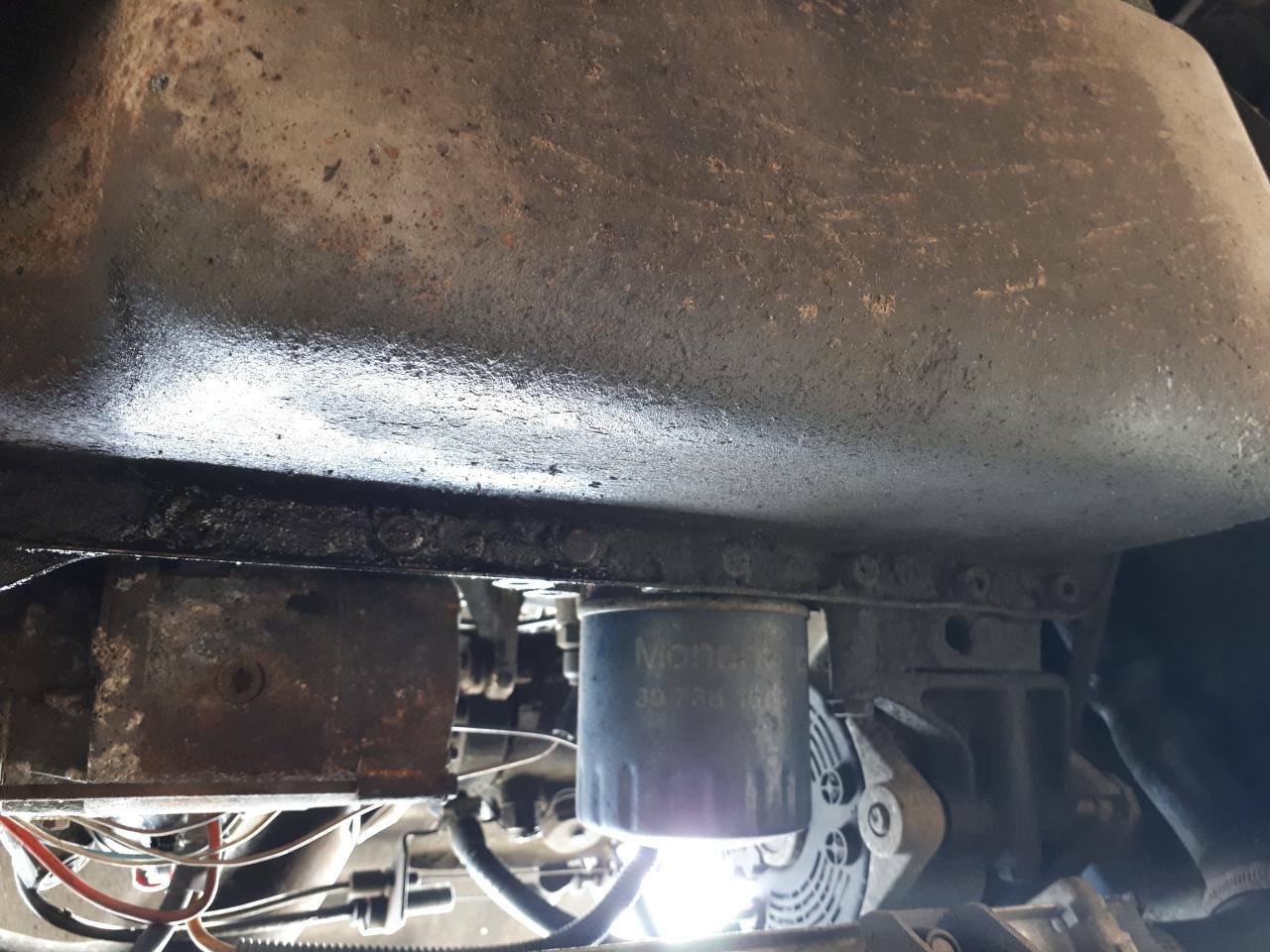

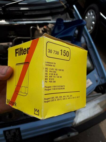

Oil change time for the 205.
My second to last oil filter that I have in stock,these came from a place I worked in when it closed in 2007.
Great ground clearance,don't even have to Jack it up or wrestle with an undertray.
Oil filter is easy to reach too.
All told about 15mins of unhurried spannering got the oil change completed.

if these are anything like the Favorit if its not the coil its very likely the crank position sensor
It is indeed the VW 1.6 AEE engine but it could still be the crank position sensor. Although I'd have thought that might be picked up by a code reader and it's had two of those plugged in to it, my cheap one and the recovery man's rather more professional looking one.
A new switch is really cheap to buy, but a complete bugger to replace.
Hadn't thought of that. So it could be the immobiliser, but again no fault codes found.
The rotor arm and dizzy cap both look shit. They didn't look like this last time I looked, though I can't remember when that was.
You would have thought this would give a more gradual deterioration rather than just stopping dead. So these definitely need replacing whether they are the cause or not.
Looked on ebay and prices vary wildly but a tenner each seems normal and yet you can buy a whole distributor complete with dizzy cap and, I assume, a rotor arm for £25. It's probably a cheap Chinese copy but at that price it's worth a try.
Especially as when I took the cap off mine there were pieces of a small plastic or fibre washer inside. I don't really know how these distributors work. Obviously it's electronic ignition so it is much simpler inside than an old Lucas one like my Triumph. But if that washer was isolating something from something else then it could be the problem.
So I have ordered a dizzy and a coil and am waiting for them to arrive before I can do any more. Crank sensor after that I guess.
If the crank sensor fails on a lot of engines it won't log a code as in the absence of a signal the ECU just assumes the engine isn't spinning.  It's that signal to which virtually everything else the ECU controls is slaved.  No crank sensor pulse = no fuel and very likely no spark.
Okay, cheers. I've already ordered the dizzy and coil so I'll wait for those but the crank sensor is definitely next on the list.
On a mk2 cavalier, the same problem was an ignition module.
You can check the  starter by jump wiring the starter solenoid. Ran a golf like that for months until I could be bothered to replace the ignition switch insides.

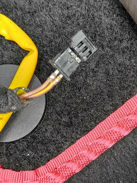

If I'm honest, it's not looking good for this car.
I tried all afternoon trying to sort this.
The loom that came in the post is of course different as the one on the car has more wires coming out of the plug under the seat and going elsewhere, whereas the loom part I have is isolated with just 2 wires and not integrated with the rest of the wiring harness under the seat.
The plug was correct though and I spent ages splicing it into the loom and then resplicing it a different way when that didn't work. As the old plug had been ripped out I had no frame of reference.
Unfortunately the MOT is due next month and it obviously won't pass like this. It seems so silly just because of a little plug and although I do have the patience, I have so little invested financially in this car, I already have another, better example on fleet and I have a hankering for something 90s again. This means that the generous offer of £350 from CTB makes sense.
Sorry, Saab.
  • Sad 2
Can you not use the new one as a reference or is it completely different?
Weirdly, the new one has 1 brown wire and 1 brown and yellow, the loom on the car has one brown and one blue.  Plus where it plugs into the connection under the seat, there's 2 extra wires that go somewhere else.
I tried both formats but neither worked, unless you need Tech 2 to the lamp off again. That's where the 75 is great as the airbag light goes off as soon as you've fixed the fault (squeezed the connectors together under the seat 😅)

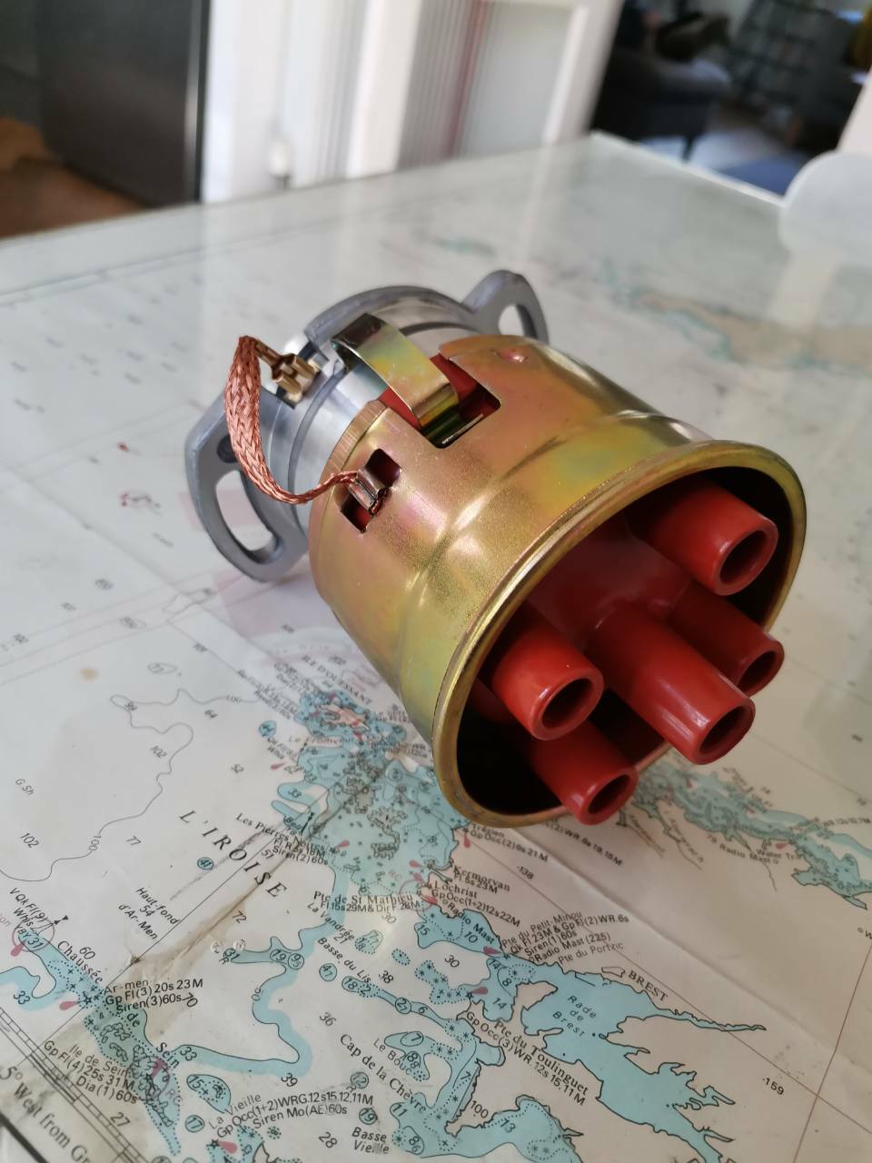

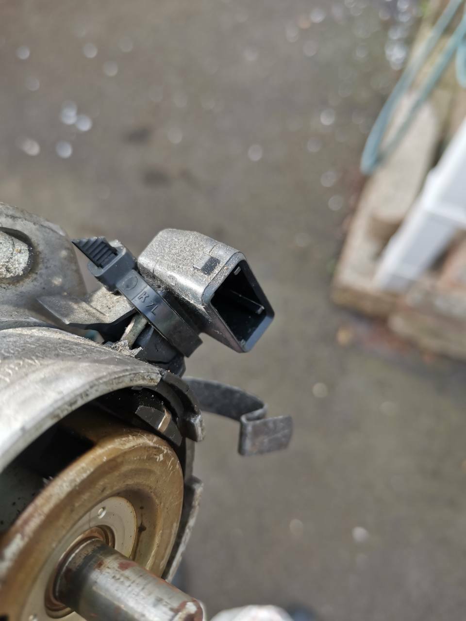

The new coil and distributor arrived today. How do they make a whole distributor for £25?
Complete with distributor cap and rotor arm.

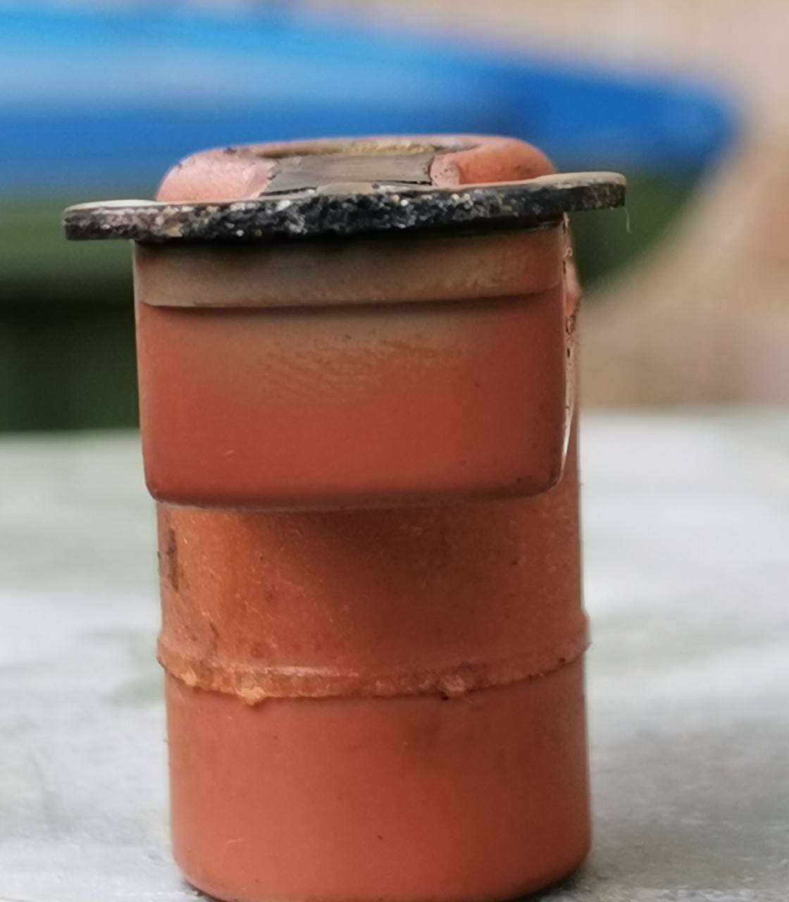

Admittedly, having had a dig around inside the old one, the innards appear to be a cylindrical piece of metal with four holes in to act as a chopper.
Also found the plug on the old one was broken and held together with a cable tie. That can't have helped.
And the rotor arm was definitely shagged.
IMG_20220401_171718_edit_946445320864436.thumb.jpg.97b1c5f355dd3a7d2825232d8d63fdfd.jpg
IMG_20220401_171706_edit_946331606928516.thumb.jpg.3633af9b8f5385519459c1a02fd521fd.jpg
So I changed the distributor first and was disappointed to find it made no difference. Ah well, never mind, there's no doubt the rotor arm and cap needed changing so it's not wasted.
Moved on to the coil. That's pretty simple, two bolts, three wire plug and HT lead. It was at this point I realised I hadn't refitted the HT lead to the distributor cap. Doh. Needless to say it fired first time. So it could have been the distributor after all. Never mind, it works now, I'll leave it at that.
I've not been able to test it properly as it's still in the garage and there are two cars in front of it on the drive and I can't be arsed to switch them all round. That's for tomorrow.
