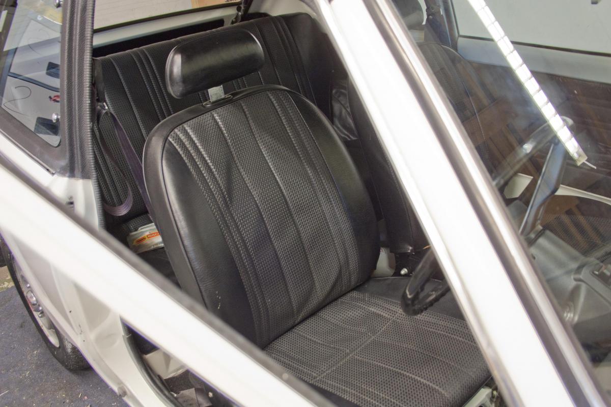

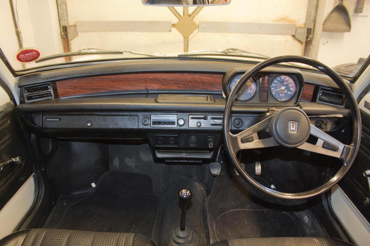

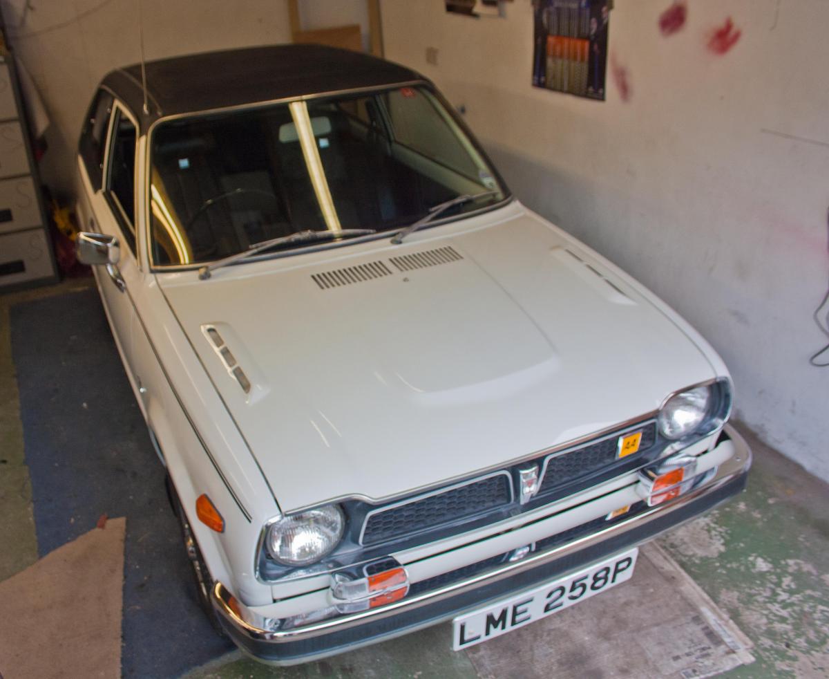

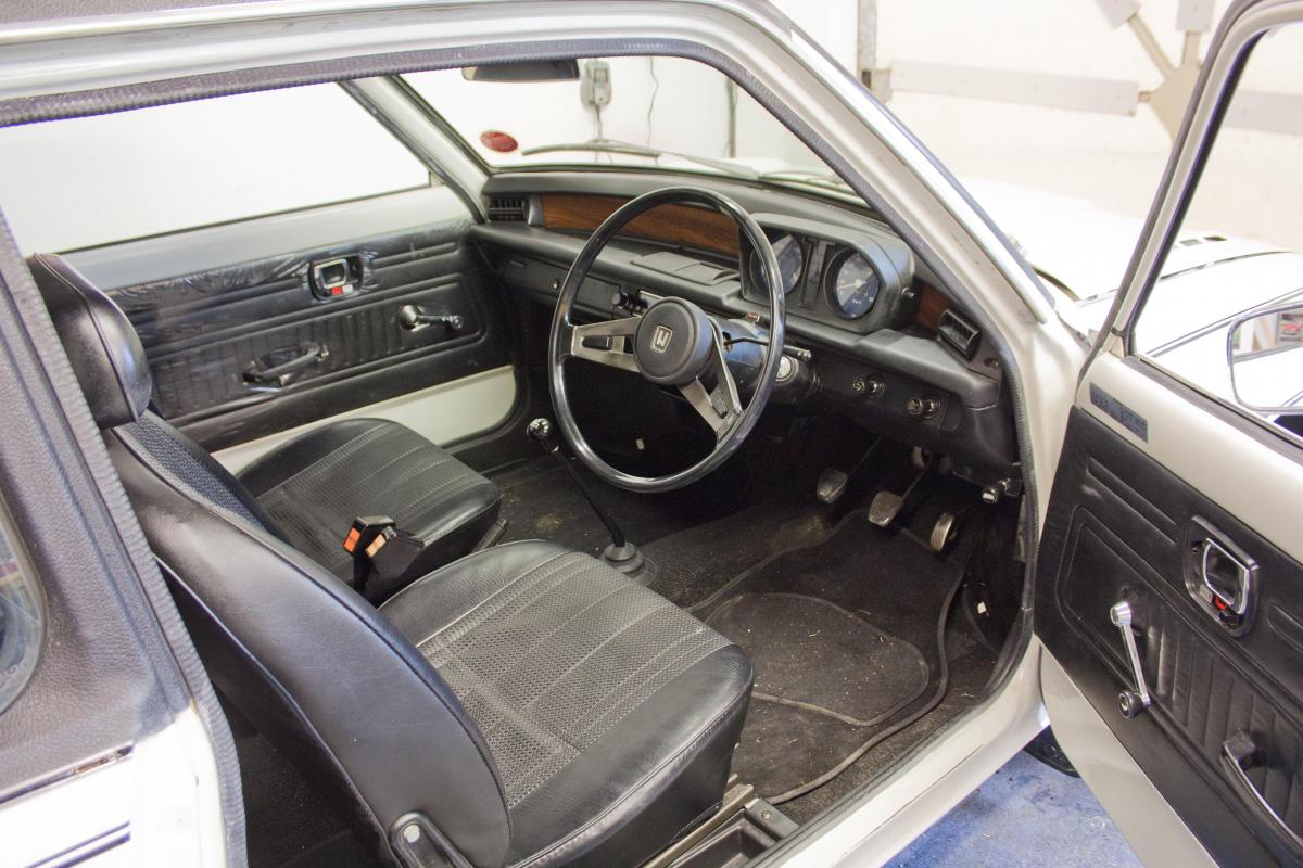

I spent a bit of time today cleaning up the Civic, after it's recent visit to the bodyshop (who's work I'm still not impressed with) it needed a another good polish and clean to remove all the overspray and dust, It's come up looking fantastic now, I suspect it's probably even one of the best early 1st gens left in the UK even now.
This is about as good as I can get with a photo at the moment though as it's blocked in by the Cortina and isn't running very well as the carb gasket has split and I'm waiting for my old man to come over and fit the carb service kit I've bought, I IZ SHITE @ MECHANKIZ.
I dropped the drivers seat off at the local trimmers last week as it had a split near the headrest, £50 later I've got a newly retrimmed middle boaster section and it looks great, it's helped really tidy the interior up now i think too.
I've been asked to display it at the final touring cars race at Brands Hatch in a few weeks on the Honda racing teams stand which induces 2 days free hospitality tickets so I thought i better get it looking all nice!
