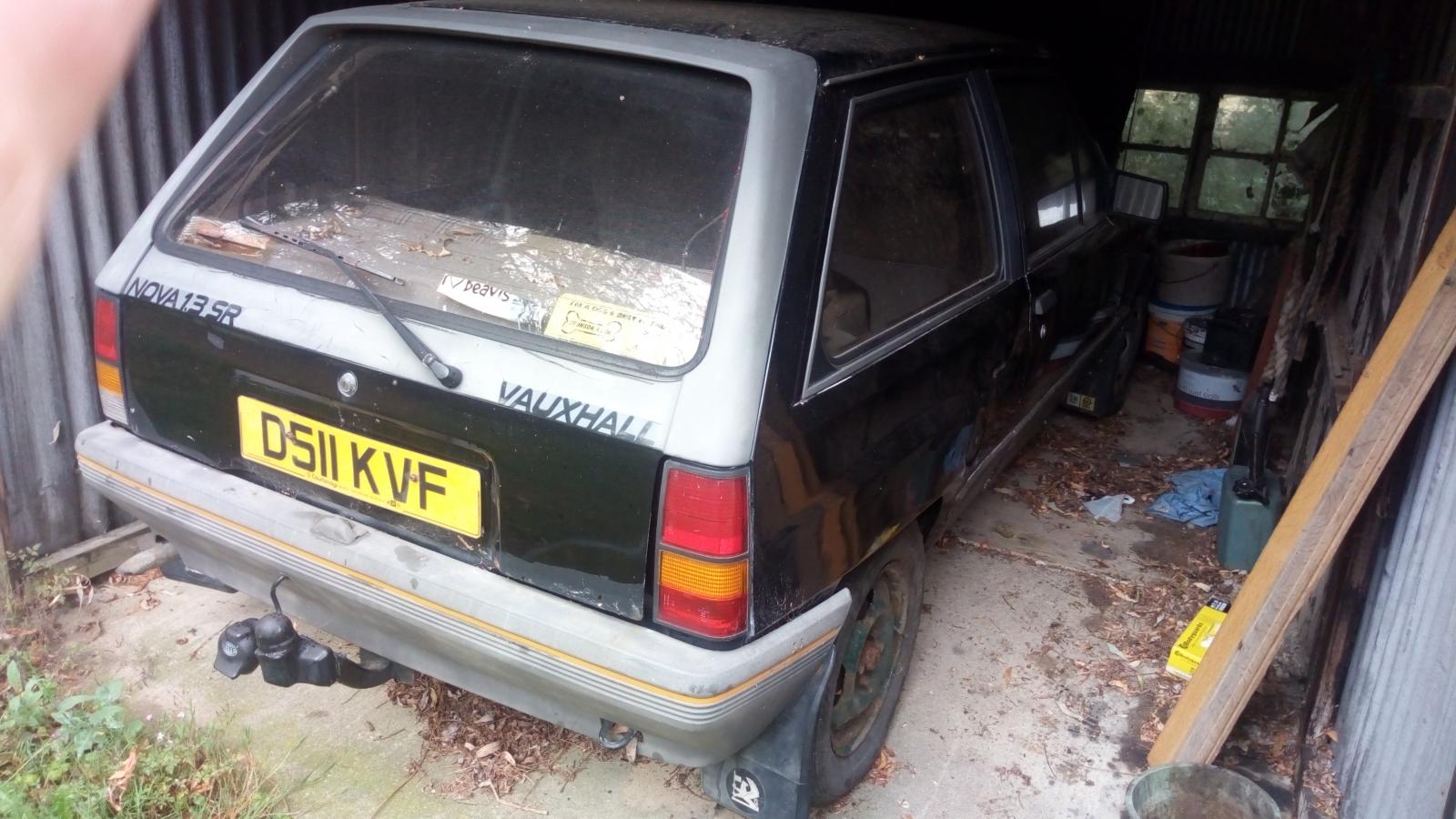

Spent a little time on my neighbour's Nova SR today.
It has been laid up for a few years but had been regularly run to keep things moving. Sadly just after we moved in, Janet lost her husband and so the Nova hasn't had a lot of attention at all.
When it last ran, it was allowed to run out of fuel, and hadn't idled since.
Initially, I topped up the fuel, pulled the king lead and attached a fresh battery.
I span it over on the starter and eventually achieved oil pressure.
I refitted the king lead and attempted to start the engine, it turned over well enough but no attempt to fire. A dash of fuel down the carb had it fire but die quickly.
I removed and cleaned all the plugs which were very sooted up, the next attempt at getting it running was success, but it still refused to idle.
This SR has Pierburg carb fitted and I was lucky enough to find an exploded diagram online and so got to pulling the idle jet out.
Next to the jet is some .8 mig wire I brought with clogged jets in mind. It also represents the only time I have used my mig welder since I bought it. :-(
With a quick broggling and a blast from the maintenance spray, the jet was soon clear and the next attempt had the engine running beautifully.
The plan is to present the car for an not and then put it up for sale.
Janet and her husband have owned the car from new and she wants it to go to someone who will restore and enjoy it.
There is some work to be done, but it is a very original car.

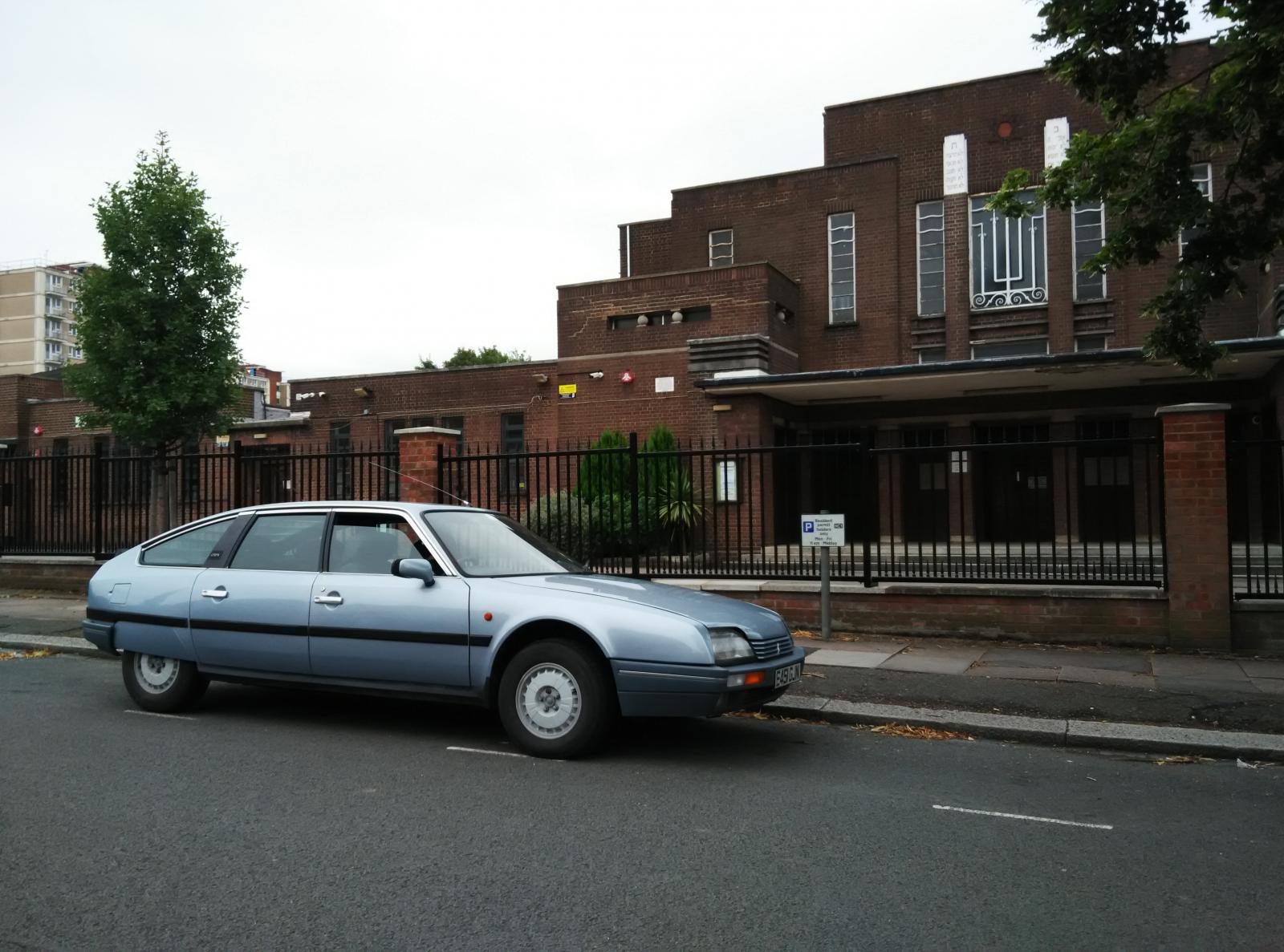

The new battery is in, and the CX starts.

Re: Nova, indeed, and an earlier one like that is mega rare

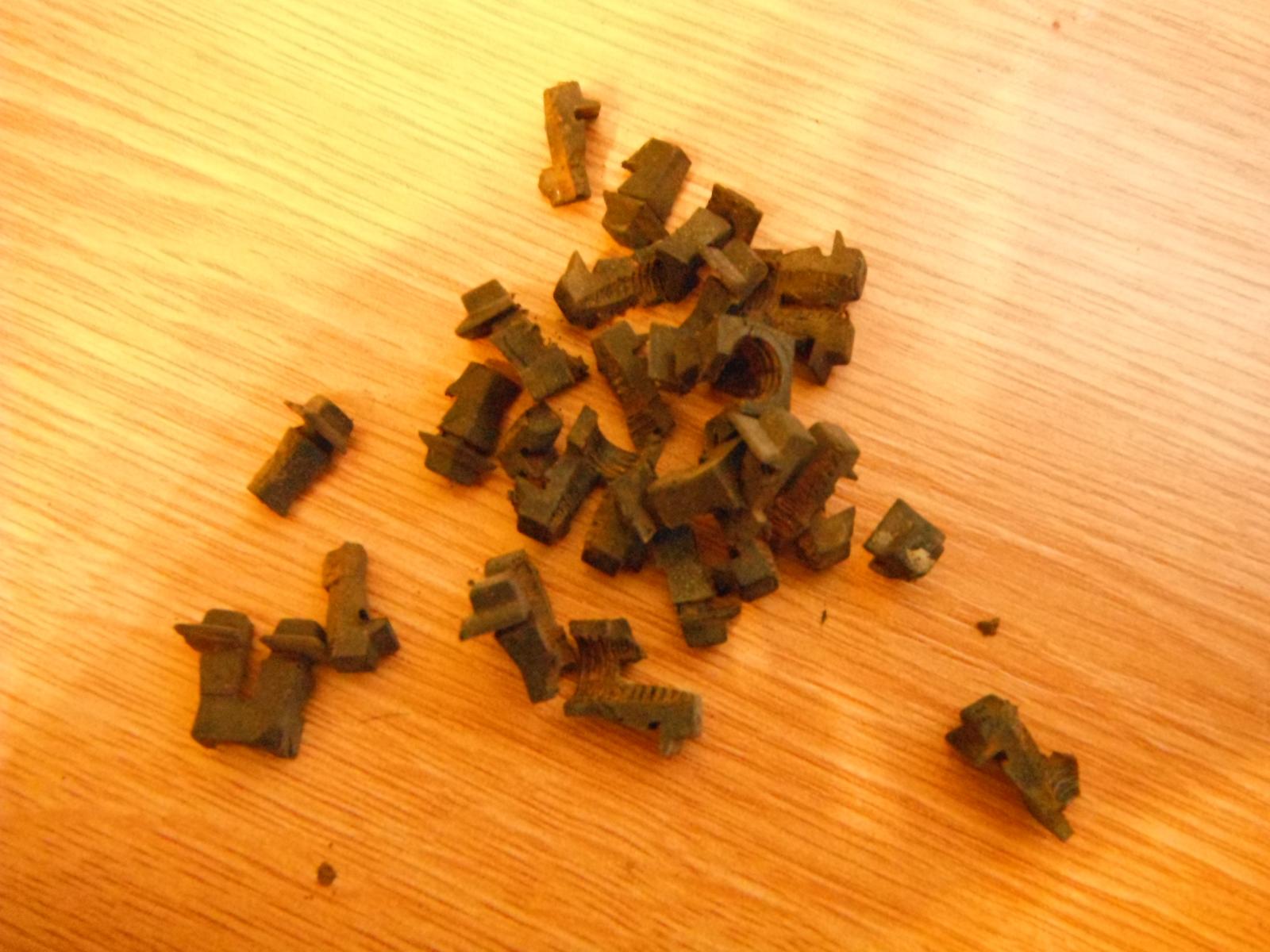

Find the part you need before you break it, kids.  I now need about a dozen plastic plug/clips that go into 1cm square holes and accept a threaded screw all the way through the middle.  I'm sure I'll find something, naturally the original part is NLA.
