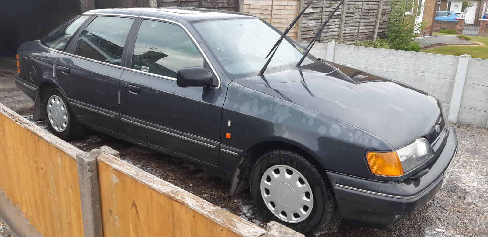

Pulled the granada out of the garage for a wash. Compiling a shopping list of bits that I need to restore it to its former glory - which is stacking up quickly.post-4771-0-76793600-1528481736_thumb.jpg
