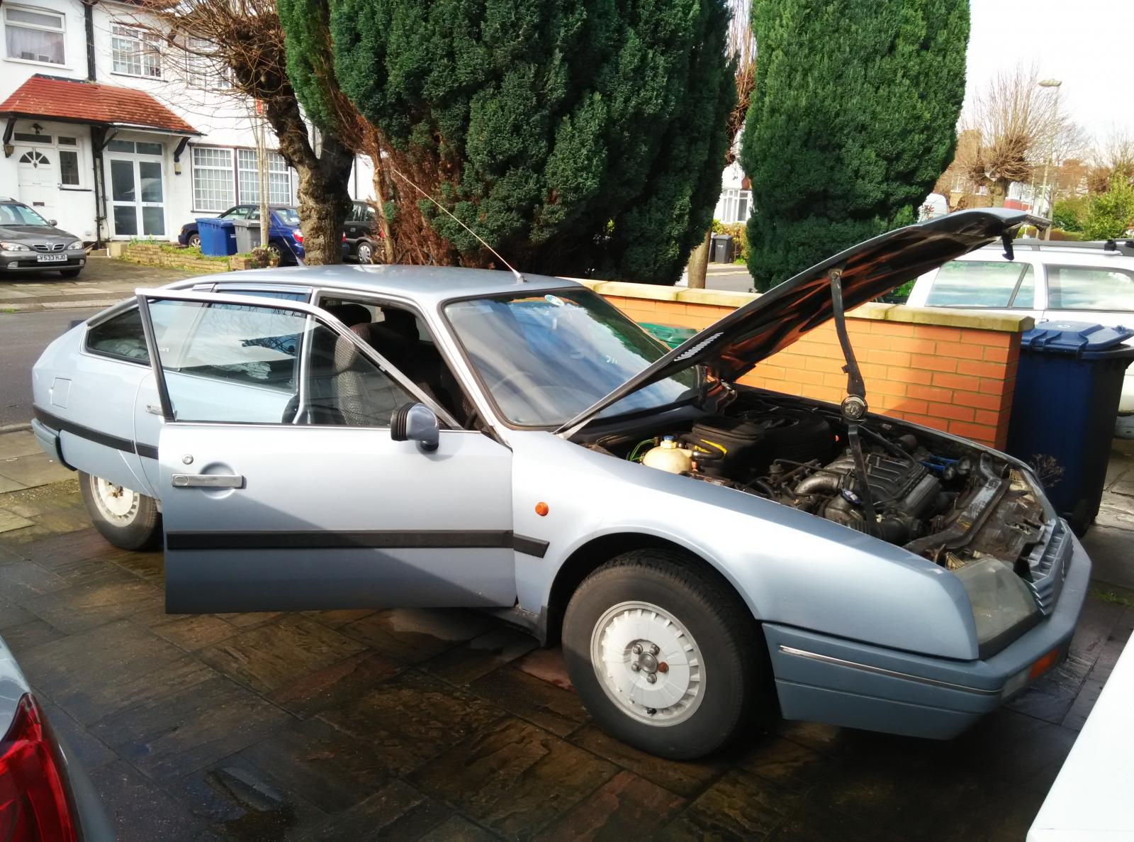

I'll never understand the whims of a French mistress. After last weekend's failure to start, I was fearing an expensive repair session.
This afternoon, I slipped the key in and not only did the CX start first time but fired first time, as if nothing had happened.
It's bizarre. Just bizarre.
Not all good news. A local run has revealed that the auto box is slipping in first. I think a fluid and filter change is overdue.
Oh and the door key won't turn in the lock. So I think that's siezed up solid. The same key in our other Audi jiggles the lock, despite being the wrong key.
If the battery goes flat on this and I don't get it freed, it's going to be an almighty arse of a job to fix.
