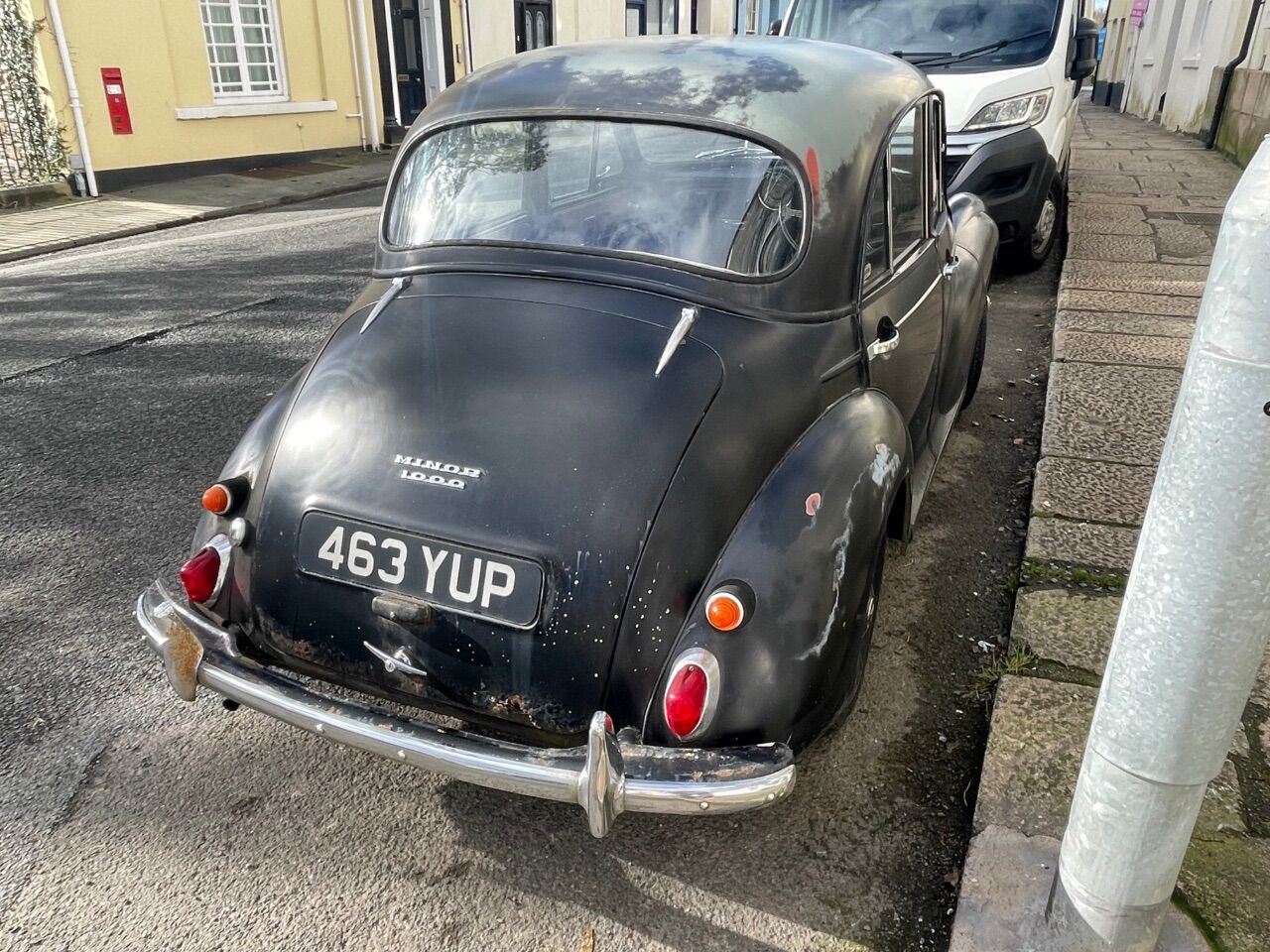

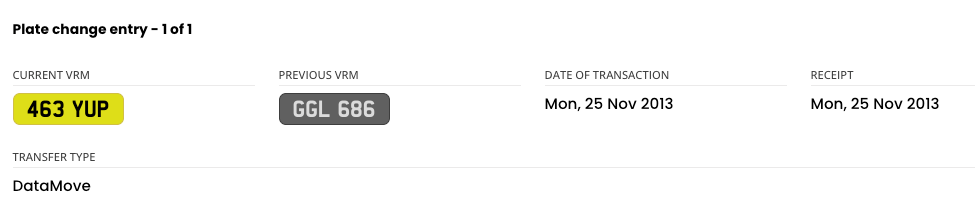

@LightBulbFun is that its original plate?
sadly not, its a 2013 Bristol issue Age relates series, twas originally GGL686
given how it so obviously spells a word, I was always surprised the DVLA issued the xxxYUP series for age related use rather then retain it for select-issue/private plate auctions, interestingly the Bristol block (401-499) was only issued up to 464YUP, so your Morris Minor is one removed from the end of a registration series, after which new age related series where started which where all Centrally issued from the DVLA in Swansea directly, so bit of an end of an era in that regard!

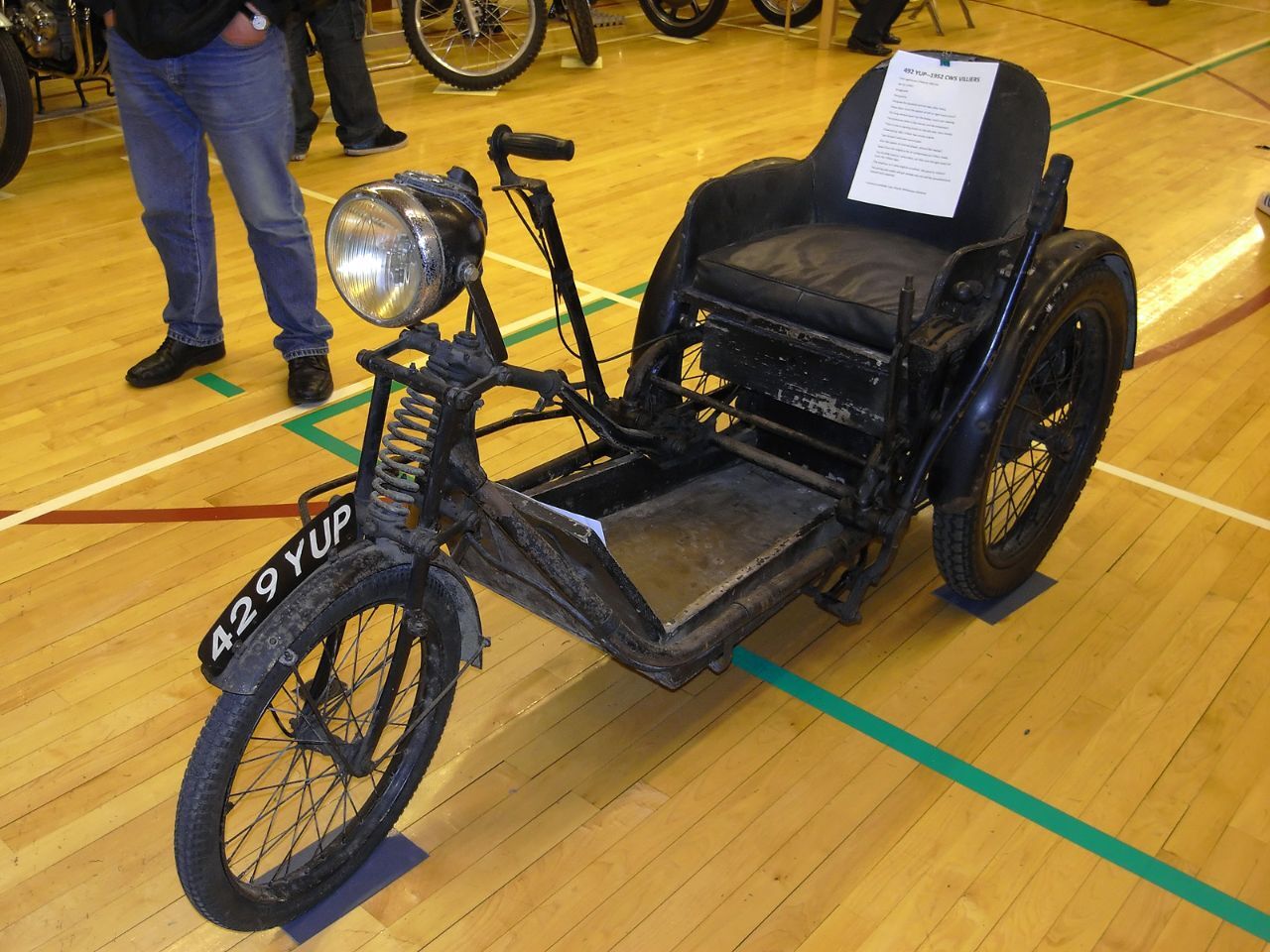

also shares a block with this Tippen Coventry, 429YUP which was originally KDA54
(which should never have been allowed to have been robbed of its number plate as Invalid Carriages are not an MOT'able vehicle type! but we all know the DVLA barely known their head from their arse when it comes to edge cases where the important details actually matter...)
Why might someone want GGL 686? Good Game, Larry?

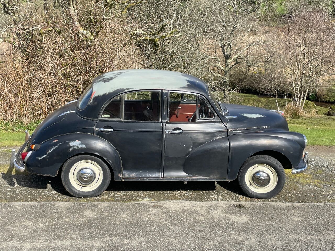

A lovely pair, especially as Minors are one of those cars that only look "right" with plenty of patina !
It's lucky that they are both four-door models, otherwise I could have not resisted asking for dibs.

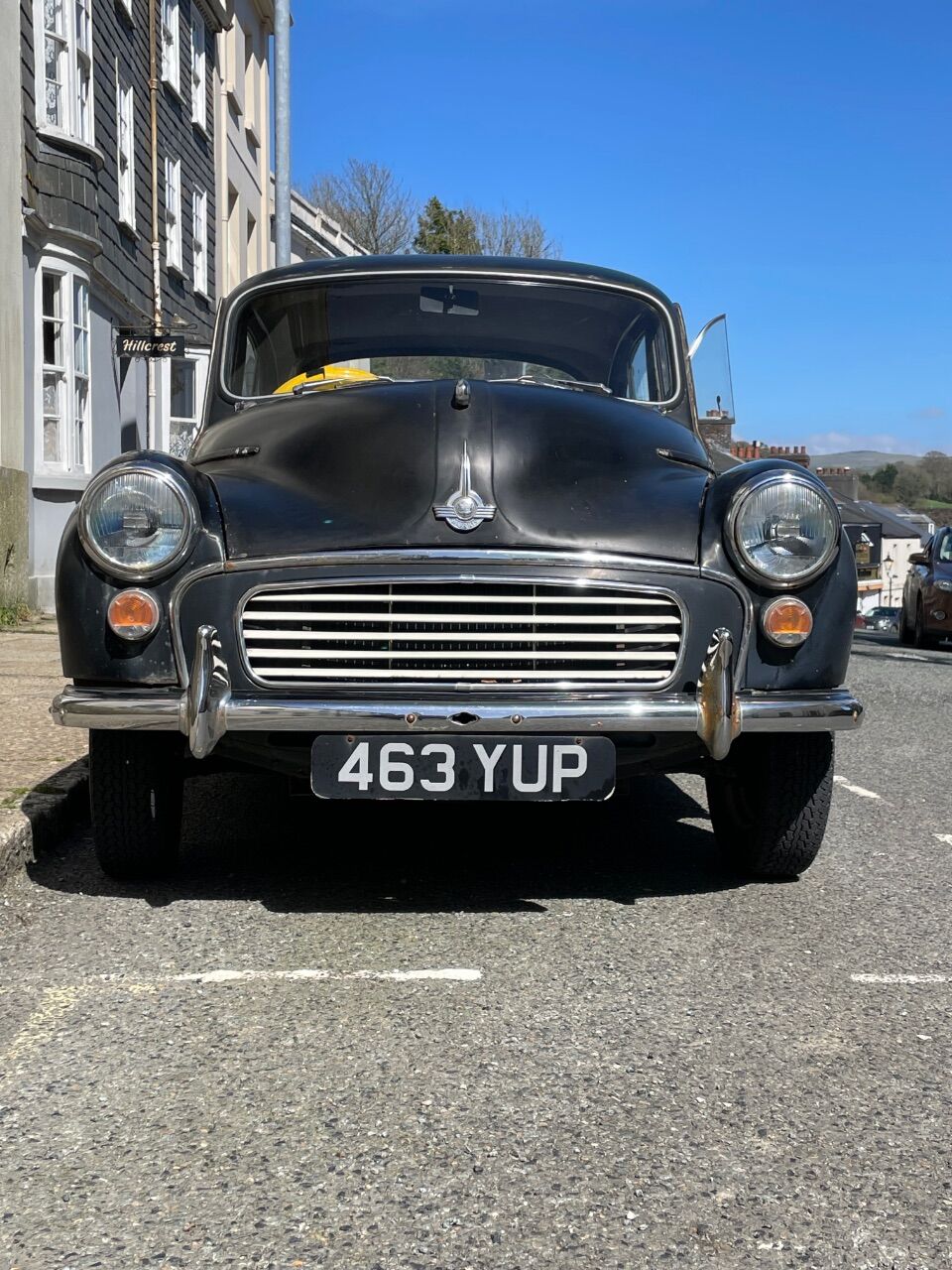

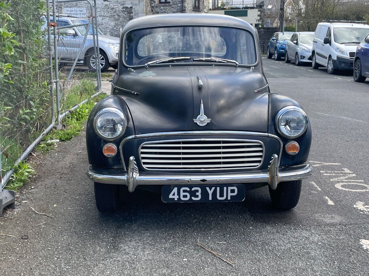

463 YUP.....
Newcastle, yupp 😁

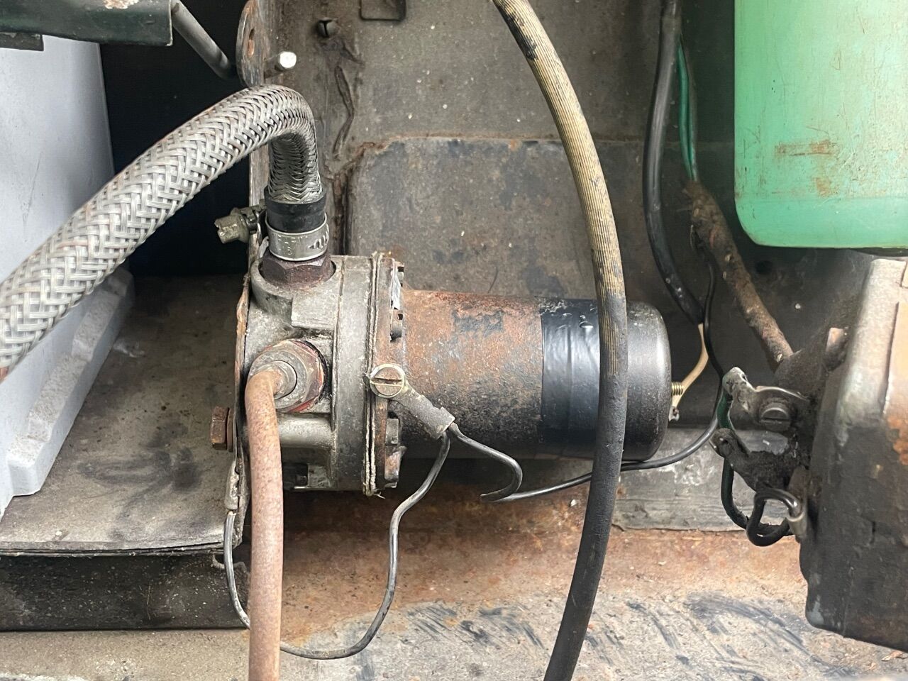

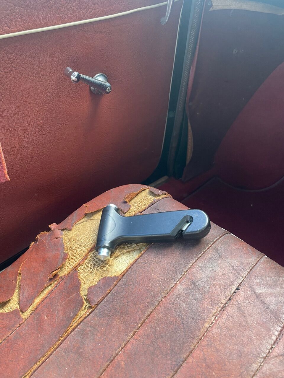

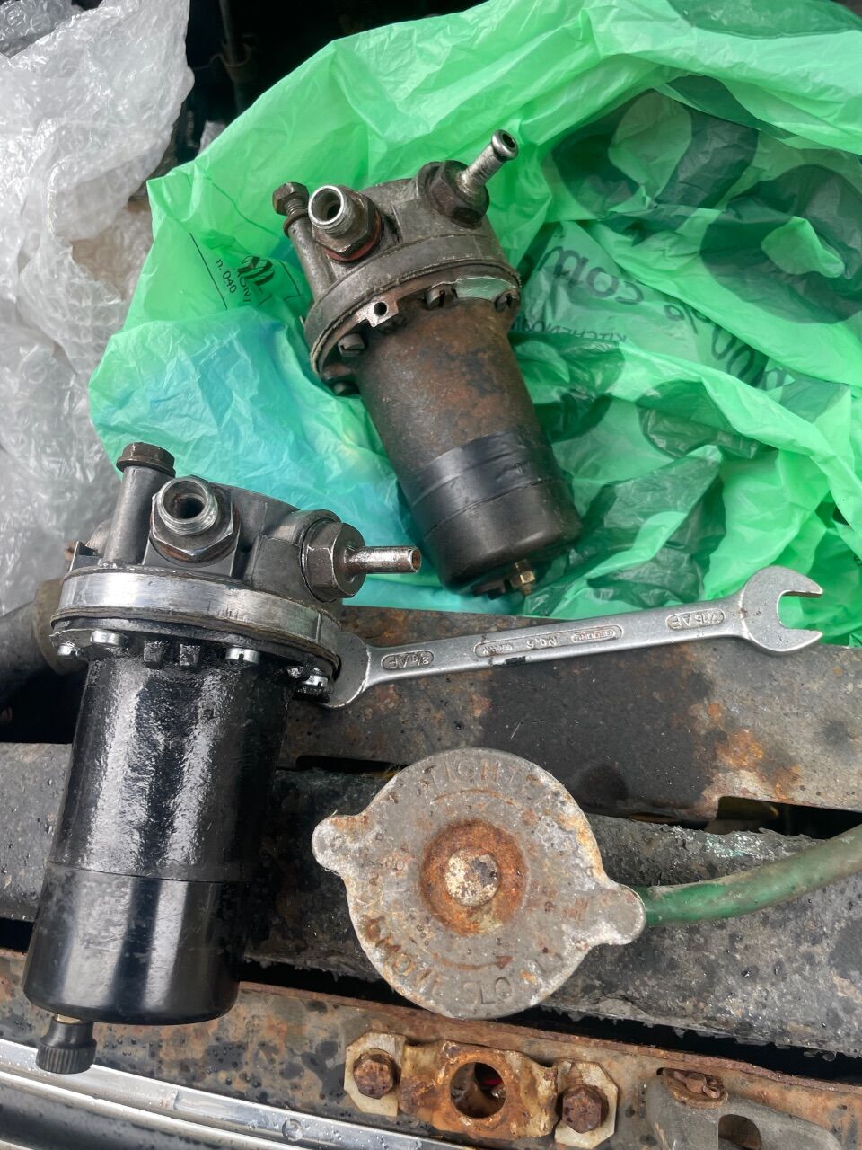

The fuel pump takes a bit of waking up after a cold start to avoid stop/go progress….
my fuel pump tapping tool, earlier.
Requiring internittant coxing into life with a few taps, for the first couple of minutes and then shes good for the rest of the drive. Maybe i need to clean up the fuel pump points?
  • HMC changed the title to HMC MINOR manual fuel pump
Well worth checkin ghtem, anyway. Shame about that seat.

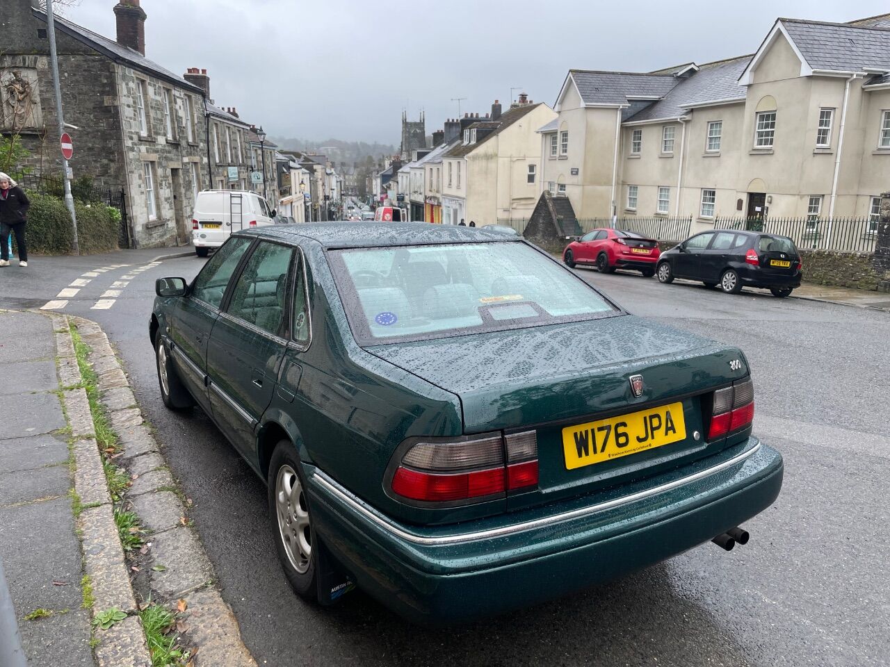

Hi all, with many thanks to @Austin-Rover this fine automobile is my new “modern”
I was very grateful he was able to deliver it down to the westcountry. Its a credit to him, having been rescued from an uncertain future and given lots of attention. Its a wonderful car and am i correct that it came from the same works as its elderly relatives that make up the rest of the fleet?
  • HMC changed the title to HMC Incoming “modern” from Cowley/ Nottingham
Lovely. Saw a nice Rover 800 being driven in Newton Abbot on Friday (I think). I presume just a coincidence... but it made me think of this car... Well bought!

463 YUP.....
Newcastle, yupp 😁
Its Durham
14 minutes ago, primeradoner said:
Its Durham
The irony is that it was originally a Cornish registered car.

A minor update….
Remember the dying duel pump? It did die. I changed the pump for a second hand unit which seemed to be ticking a lot- which indicates its unable to reach the desired throughput pressure. hmmm. Also the car developed quite a bad misfire.
Long story short- i cannibalised the old and replacement pumps to make one good one, and cleaned out the main jet and float chamber of years of crap.
I was working on the basis that replacement pump had a small hole somewhere in the diaphragm, and also swapping the pumps over disturbed sediment from the fuel pipe joints. So much for the theory…..
Result? Back to running on all 4 and the fuel pump neither ticking too much, nor not at all. Great!

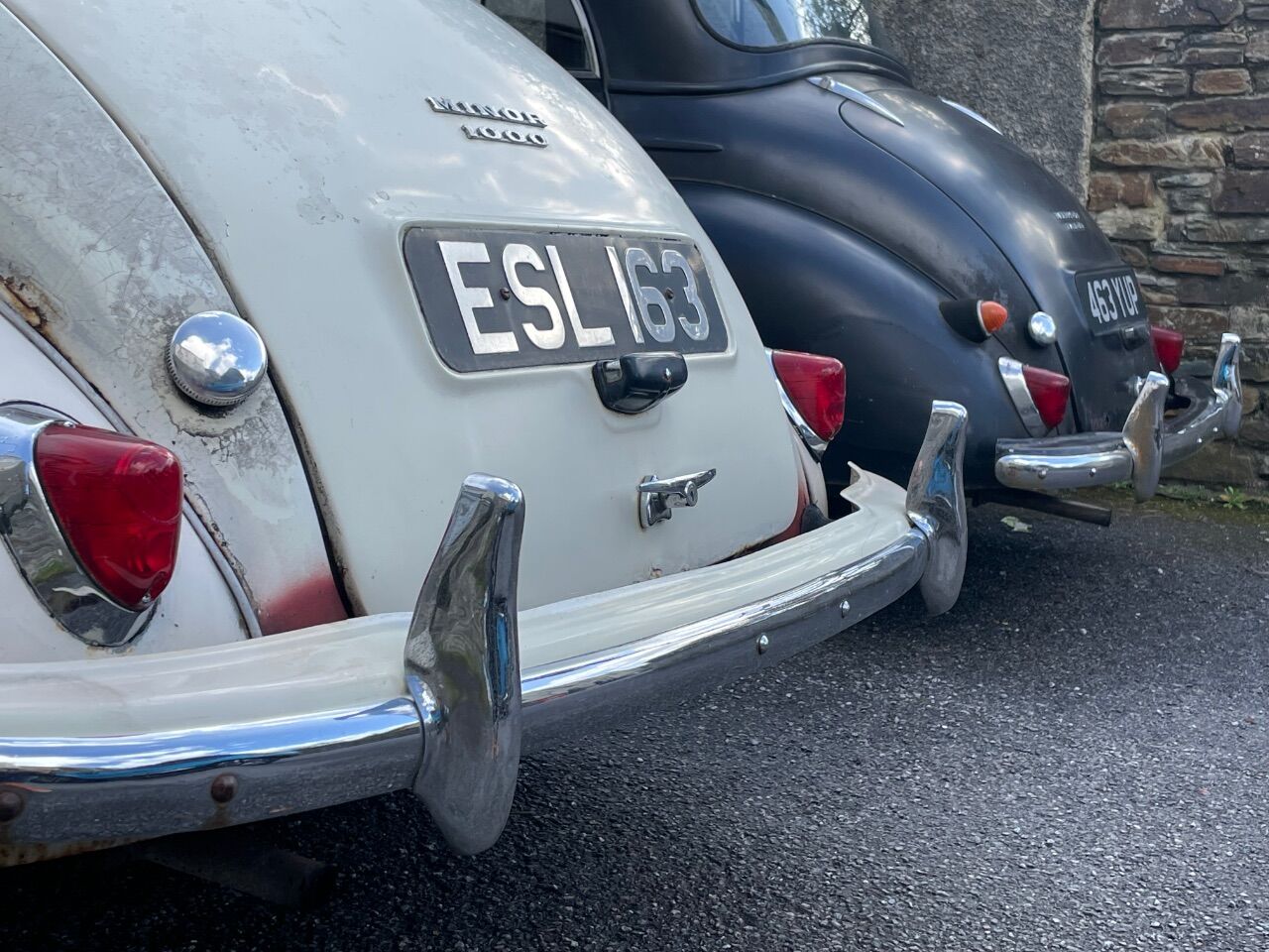

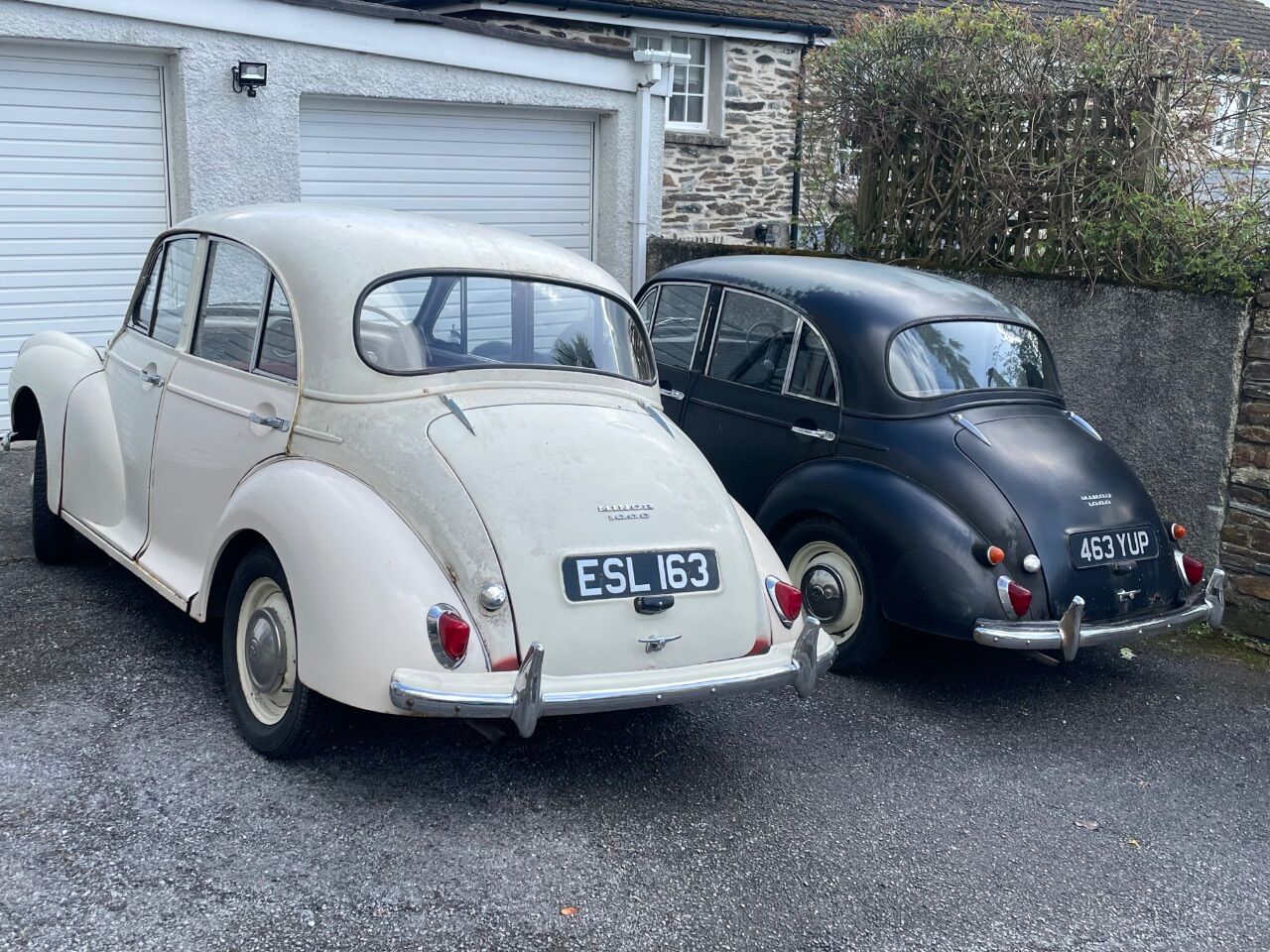

Further minor developments….
The black one has returned to being go to reliable after fuel system woes…
Meanwhile the white one has gone from slight slippage (4 up, climbing in 3rd) to most of the time slippage -so much so ive avoided climbing the hills out of tavistock with it even solo. Had a look at adjusting it but i think its just worn .
