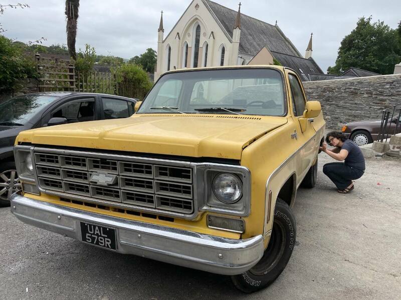

On 6/18/2022 at 6:26 PM, HMC said:
Been using the pickup and marvelling at how  Un rotten it is. Minimal rustproofing and paint , and in quite a few places no seam sealer even.
45 Californian years have helped a lot. The British climate is a force to be reckoned with and would soon start dissolving the body.
I cleaned up things with a wire brush and as it is all so clean I decided to take inspiration from the underbody prep that @TripleRich did on his Granada. After wire brushing and panel wiping I painted some por 15 over the panels. Where there is no seam sealer I will apply some tiger seal with a scotchbrite pad and then after preparing the surface use some upol gravitex stone guard and pump the box sections with wax.
I’m doing it in sections, Its a slow steady process but it’s very therapeutic!
