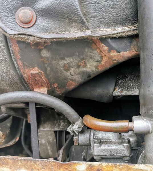

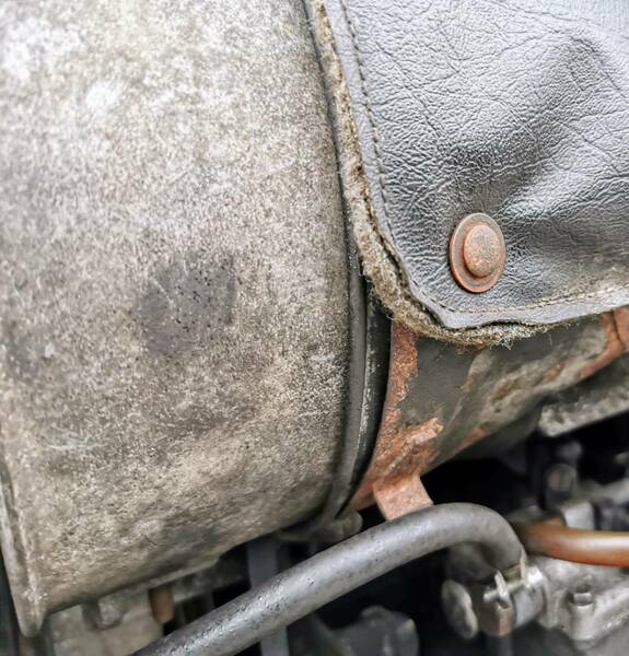

Have you still got the wee rubber pipe that goes from the cowl to the exhaust manifold jacket?  It goes brittle and can easily be lost when removing the cowl (also can be awkward to fit)?
I couldn't see it in your pics, but it makes a huge difference to cabin heating... you probably know this as you say the heater works well, but thought I'd mention it as mine was in poor condition when I first got it.
Good work again, it'll go a bit better after this job!
Originally no, though I had wedged a bit of pipe that kinda sorta almost fit in there.  I do now have a replacement that's the correct size which will go back in along with the cowl.  Fitting it along with that sounds far easier than trying to wrangle it into the tiny space available with everything bolted in place.

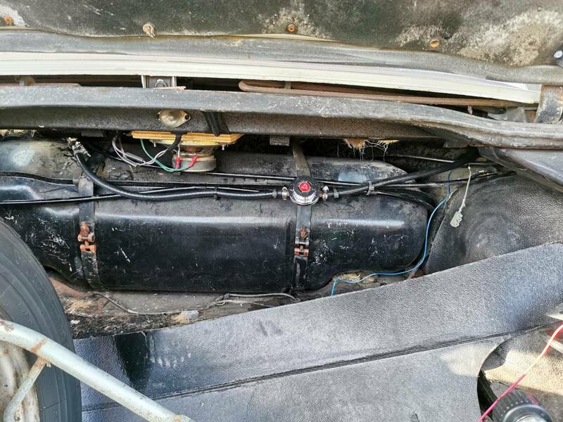

When I piped up the fuel pump on the Rover a while back, I failed to notice that the hose clip on the output side of that filter had bound up rather than tightening on the hose properly.  This remained unnoticed until this morning when I discovered that the hose had come loose (imagine I probably disturbed it yesterday) and had at some point during the night started to drip fuel onto the driveway.  This continued for several hours until I woke up wondering why the heck the entire house reeked of petrol.  Of course our driveway drains towards the house, so the fuel had run that way (assisted no doubt by the rain last night).  We've had the windows open all day and it's better, but the smell is absolutely still here.
I am really, really, really annoyed with myself for missing that.  Especially on a safety critical component like the fuel system.  Everything should have been double checked.
In better news, the prototype fuel return line seems to be working just fine.  I had the car run fully up to temperature today without any signs of fuel vaporisation problems as we would usually have been seeing.
I suspect I am going to have to add a pressure regulator though.  The original return line features a tiny orifice in the fitting where it feeds back into the tank (probably where the line is clogged), so I'll need to emulate that, as without a restriction on the return line it does cause the car to run lean.  Hardly the end of the world, and I had kind of expected as much.
The biggest headache with this setup actually was trying to find a suitable way to get a line from under the car into the boot where my return line goes into the tank.  None of the holes in the boot floor actually go all the way through, just into double skinned sections.  Eventually though I found a way to get there via a wiring pass through into the cabin, and then via a grommet under the rear seat.
This is well clear of the seat base when it's in place.  Hard to see in the photo, but there is a grommet protecting the pipe where it passes through the floor pan too.
I will be re-making this in proper fuel line if this is proven to work, I just don't have enough in stock at the moment so wanted to test the theory with what materials I had to hand and I've been tripping over that spool of brake pipe for about a year and a half now.  It was basically chosen because it was the easiest thing I could find to join to the existing nylon line exiting the carb fuel feed.
Given that this isn't intended to be a long term solution, I didn't want to go drilling holes in anything for this.  The fuel gauge sender/feed/return assembly in the tank will be getting replaced when I have the time and inclination to pull the tank, but that's not today's problem and I'd really like to resume the shakedown period in the interim.

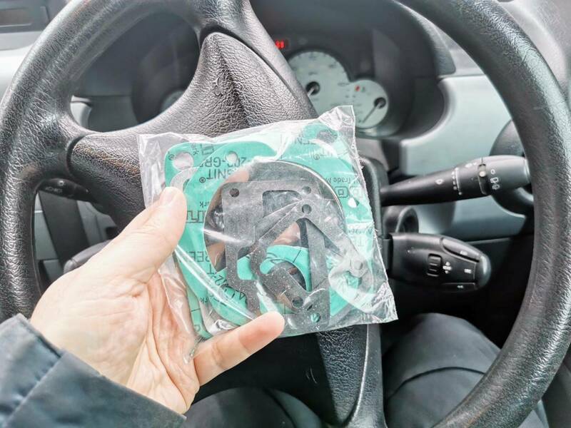

eBay seller still hasn't dispatched the head gaskets for the Trabant I ordered on Wednesday afternoon.  I am not amused.  Main reason I ordered from them rather than abroad was so they'd get here quicker.  If I'd ordered from Trabantwelt the parts would be in my hands by now.  Yes I'd have paid through the nose for postage, but this is one of those cases where it doesn't matter whether I'm paying £5 or £50, without the parts I can't fix the car!

Still no sign of the gaskets ordered from eBay.

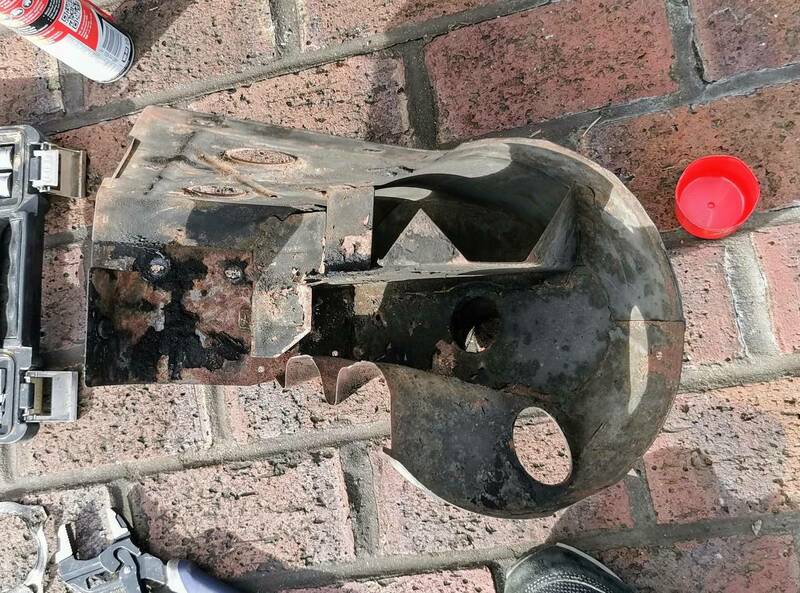

Thankfully, a member of the owner's club just half an hour up the road bailed me out with a full engine gasket set they had going spare.  Cheers for that if you're reading this!
Then was a matter of about 20 minutes to get everything put back together.
The fan shroud to manifold cowling hose is now correctly in place.
As is the rubber seal between the shroud and the fan body.

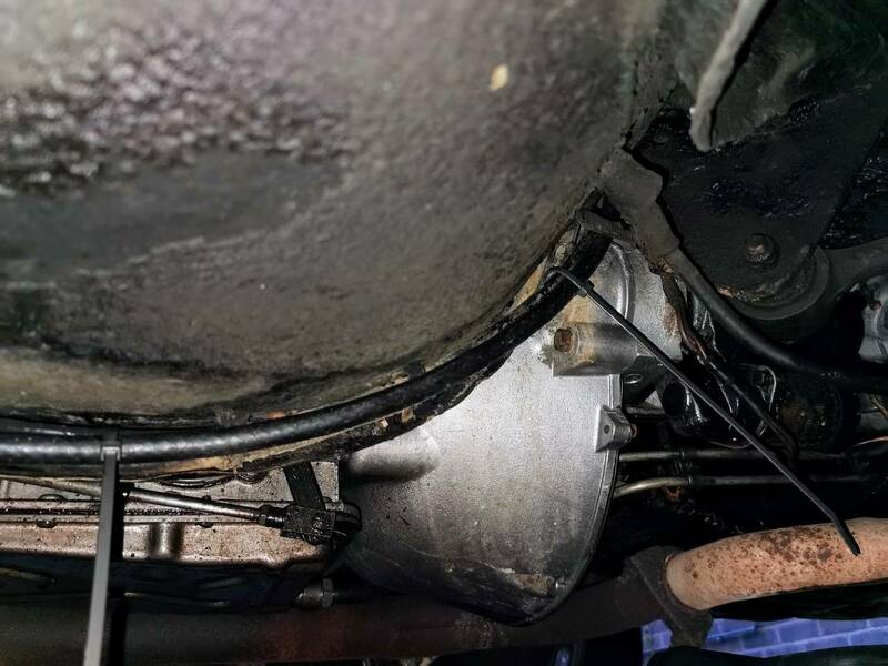

Having successfully proved that my idea for the fuel return system worked I decided that as the weather was dry it was time to get it put together in a less shonky way.  I'd thrown it together using some 3/8" copper brake line originally as it was what I had to hand and I didn't have enough actual hose in stock.
It was never intended to see the road like that though, it was just to see if it worked.  It was time to do it "properly" though.
We picked up the return from the factory T on the carb feed line.
The original return line has been capped off for safety's sake. I don't think there's any chance of it suddenly starting to spill fuel back to the engine bay, but I just don't want to take the chance.
Hose clips obviously still had to be added here.
That bolt is only half threaded so there's a nice smooth area to seal to the hose, and the bit of hose is a snug fit on both the bolt and the nylon line.
The line follows the route of the factory fuel lines down the back of the engine bay.
Then follows the main bundle of pipework and cabling along the underside of the car.
Up into the car through the bung I'd found in the floor under the rear seat (with a suitable grommet to protect the hose).
Then joins the loom of cables and pipework that runs through into the boot through a grommet behind the backrest of the rear seat.
Then around the tank and onto our former vent port that's now our return spill port.
Couple of additional hose clips needed here in the photo.
What you can't actually see is that there's a piece of copper line inside there that runs right down into the tank - that rubber boot isn't actually involved in fuel handling, it's just providing a vapour seal.
This should have us most of the way towards having a working fuel system. Though the car was still running a bit lean it seemed (as it demonstrated to me a week or so back when I had the air cleaner off and blipped the throttle, resulting in a cough and then proper shotgun like report out of the left hand carb which left my ears ringing for about an hour). This didn't surprise me really as I know the original return line had a restriction in it to act as a crude pressure regulator. I have picked up a cheap regulator, though I don't have huge hopes for that (because...well...cheap parts). If it doesn't work I've an idea to make my own crude version using an adjustable clamp on the line.  Doesn't really make sense paying good money for a quality regulator though, especially as I don't imagine the actual pressure here is all that critical either, we just need enough of a restriction to ensure that the carb bowls fill properly.
I have however ensured it's installed in the boot rather than the engine bay just in case it does leak. Yes, because I trust it about as far as I can throw it.
Guess what happened after I'd been driving around for about 20 minutes? The engine cut out and wouldn't restart. Guess why...no fuel being delivered.  I called the car some really unpleasant things about then.  Albeit slightly tempered by the fact that it died on the drive this time rather than at a junction.
Initial suspicion fell on that cheap regulator...which when removed revealed no fuel coming down the return line. Cue much poking and prodding and swearing at everything I'd done yesterday as I assumed I must have crimped a line or something somewhere.
That fuel pump, which I bought from a marque specialist...yep, it's dead. Well it's kind of dead...it pumps just fine until you present it with anything resembling a pressure head to pump against, at which point it stops pumping until it's power cycled an indeterminate number of times. It has always been horrifically noisy so I'm not hugely surprised, but it's disappointing as it wasn't cheap.
Tried to switch over to the spare Hardi pump I've been kindly provided with by a reader of my blogs. That apparently needs a service.  More fuel came peeing out from around failed seals on that under gravity than I was getting out of the previous pump outlet when it was running. Guess I'll need to order a service kit for that then.  I don't begrudge the pump that, it's entirely likely as old as I am and I really ought to have just serviced it when it landed here.
For now I've borrowed TPA's pump again as I know that works properly.
Sure enough, turning the dial on the regulator now does alter the speed at which the pump clicks, so we are correctly modulating the fuel return flow.
Haven't had the opportunity to investigate whether this has improved things though as today I have been busy all day.
Will it actually work for more than 20 minutes now?  I guess we'll find out sometime in the next few days.
