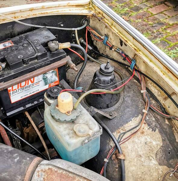

The windscreen washers now work correctly from the control again.

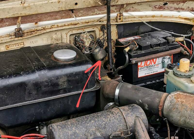

Under the dash I had spotted a couple of holes in the bulkhead through which I could see daylight, so found a couple of trim clips to fill those - I put a blob of grease behind them to discourage any water or fumes from using it as a way to enter the cabin.
Sure there are probably plenty more of those, and the grommet the wiring loom goes through there has an opening I can easily fit my thumb through, but I've tried at least!

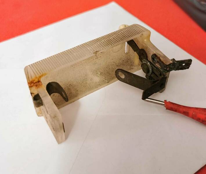

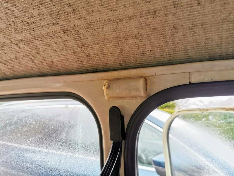

I've set about trying to epoxy the interior light back together this evening.
The contacts are quite corroded so I'm honestly not sure if it will ever work again - but getting it to a point where it doesn't fall out of it's location above the B pillar every time you close a door would be an improvement.

The repair to the interior light appears to have worked.
It hasn't fallen out again so far anyway.  Unfortunately it also doesn't seem to work, though I've yet to ascertain if we have power to it yet and couldn't summon the enthusiasm to go all the way back inside and upstairs to retrieve a meter today.

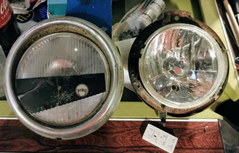

Had a nose at the lights today.  Opinions online seem divided as to whether the generic 7" units will fit without modification.  Helpfully I have both a couple of spare headlight baskets off the car, and a set of random cheapy 7" headlights I bought years and years ago.  They briefly appeared on TPA when she was first returned to the road before I got something that looked more period appropriate.
Looks like they fit absolutely fine.
The locating tabs all line up properly and the unit is clocked correctly.  So I'll get something ordered up shortly to hopefully get the headlights converted properly to RHD spec.
This mounting arrangement looks different to one of the spare bowls I have which looks to have the mounting lugs clocked differently, so I wonder if that is something which changed during production at some point.
IIRC the headlamps did change to H4 bulbs (in 1984 I think maybe?) so perhaps that could account for the different types of head lamps and maybe the differing reports on 7 inch lamps fitting or not fitting?

That's my thinking.  The lamp housing which fits has a H4 stamping in the lens, so my money is on the change happening when they switched over to H4 lamps.  Which I imagine a fair few people would be surprised they even did.  Just does show that they did continue to make incremental improvements through the life of the car where they were actually useful changes.
My first Metro which was on a 1986 D plate didn't have H4 headlights.  Neither did my folks Fiat Panda...and that was from 1993.
Lights have now been ordered, exactly the same Autopal ones I put on TPA it looks like from the listing.  I've no complaints about those so reckon they'll do the job just fine.  This isn't going to be a car that's used for late night commuting anyway, so all I'm asking for is the lights to work acceptably, without needing bits of tape stuck all over them that will make my teeth itch every time I walk past the car.

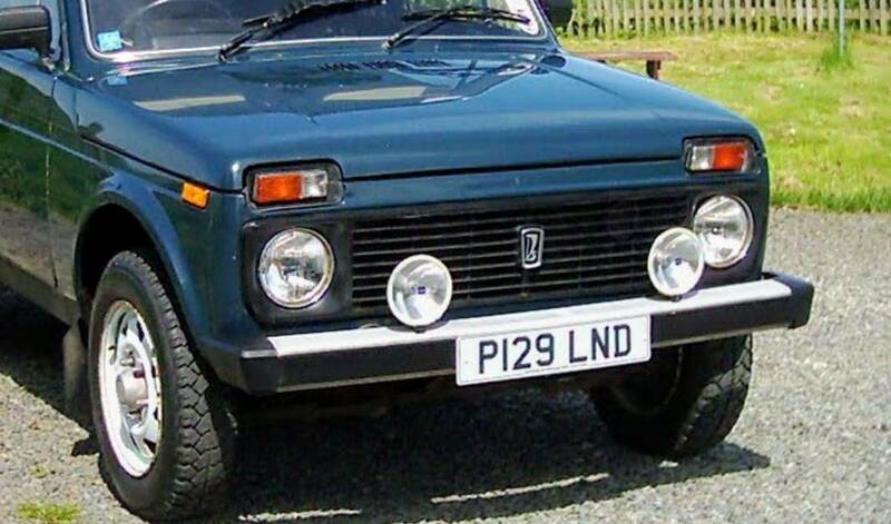

I used to have somewhere around 300W of halogen spotlights on the front bumper of my Lada Niva which were tied in to come on along with main beam.  That was exceptionally effective at getting oncoming vehicles who had decided it was beneath them to dip their headlights to change their mind very rapidly!
Didn't look even slightly out of place either.
They were aimed pretty high and slightly out towards the edges of the roads - primarily to help me spot deer as there's a spot I used to go through twice a day where they were an absolute menace.

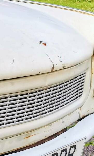

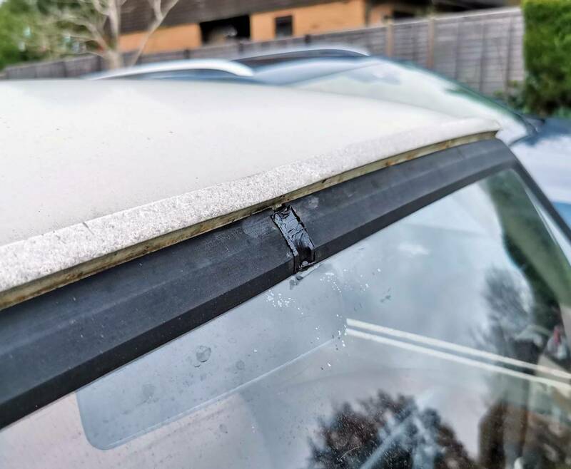

Had very little time available today but still managed to get something ticked off.

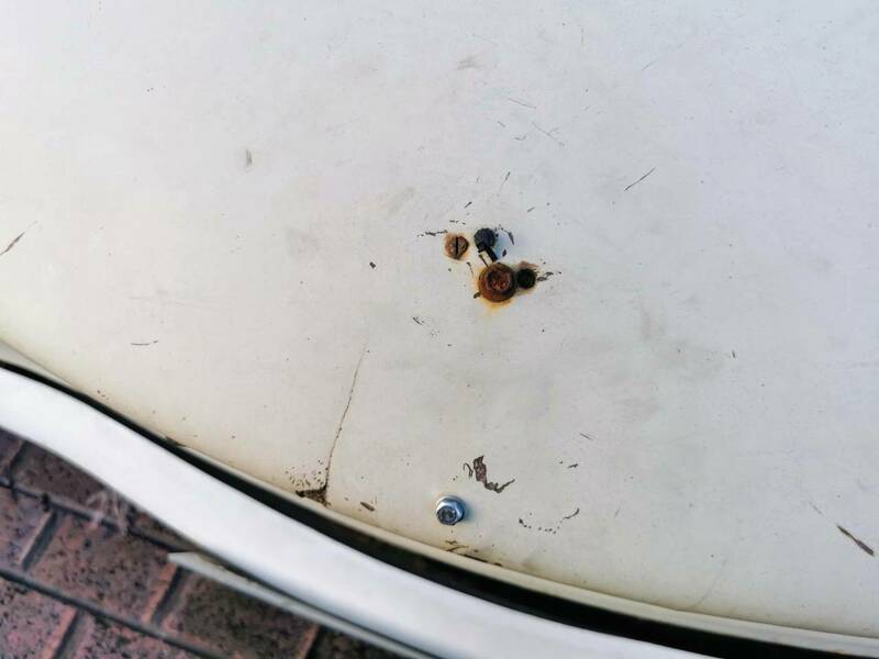

If you look at the front of the Trabant it's obviously taken a minor knock to the front at some point.  Nothing major, I'm talking a parking mishap rather than a crash.  The visible evidence of that is a crack in the bonnet and a ding in the front panel (aka radiator grill which isn't actually a grill).
I'm guessing the badge pinged off into oblivion at the same time.
Underneath the bonnet there was some further damage in that the catch assembly which is normally bonded to the underneath of the bonnet moulding had come adrift.
That had sort of been "fixed" with a bolt at the leading edge - and a bundle of tiny zip ties through one the badge mounting holes.
I've reverted this to a more similar arrangement to what the factory would have used, "gluing" the latch assembly back to the underside of the bonnet using PU adhesive.
Reckon this should be more than strong enough for this, I made sure the surfaces were clean beforehand and roughed up so it should have a plenty strong bond.  Better than the 1/32" of the edge of the washer on that one bolt that was basically holding it together before that's for sure.  That bolt (and a larger washer so it actually does something) has been put back in for now, keeping things squeezed together while the adhesive sets.  After that I'll remove it and fill in the holes that shouldn't be there.  I do have a replacement badge on the way.  I have picked up some paint which may or may not be a vaguely close match, I've not checked yet.
While I had the adhesive out I took the opportunity to fill in the 3/4" gap in the top of the windscreen seal.  I know I've got a replacement on the way but I don't know when I'll have the opportunity to actually fit that, and a gap that big definitely wouldn't be doing us any favours.
It was dark by the time it had set up so I could remove the tape, so no photo of that.  At least there's not a visible gap to the outside world behind the rear view mirror now.
So nothing ground breaking, but one more thing ticked off hopefully.

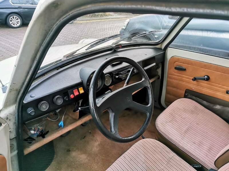

Next up is hopefully fixing some of the slop in the wiper mechanism.  Apparently I'm blind as it took me until day before yesterday to realise that the wiper motor was staring me in the face under the bonnet.
Which is wobbling around comically.  I'm guessing it's meant to be sitting on rubber bushings which have disintegrated.  Hopefully will get a chance to look into that tomorrow.
  • Zelandeth changed the title to Zel's Motoring Adventures...Renault, Rover, Trabant, AC Model 70 & A Sinclair C5 - 17/12 - General tinkering...
Not the tidiest job, but better than a gaping hole.
Having glued the bonnet latch back together has vastly reduced the magnitude to which the bonnet flaps around while driving now.  It still wobbles about a bit, but nowhere near as alarming as it used to be.
