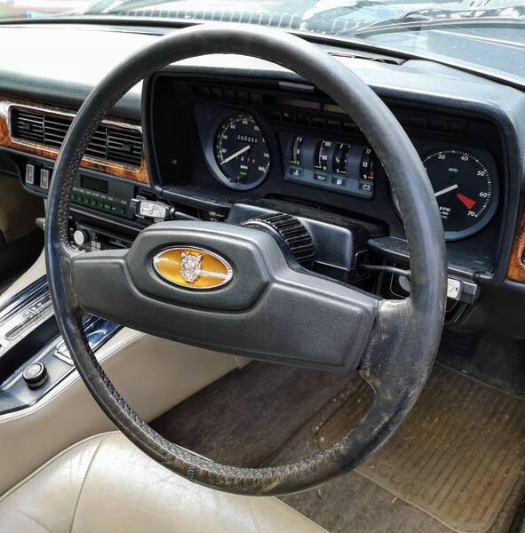

Something which has always let the interior down was the steering wheel.
Finally got around to throwing some leather dye at it today.
That looks a thousand times better I reckon.
