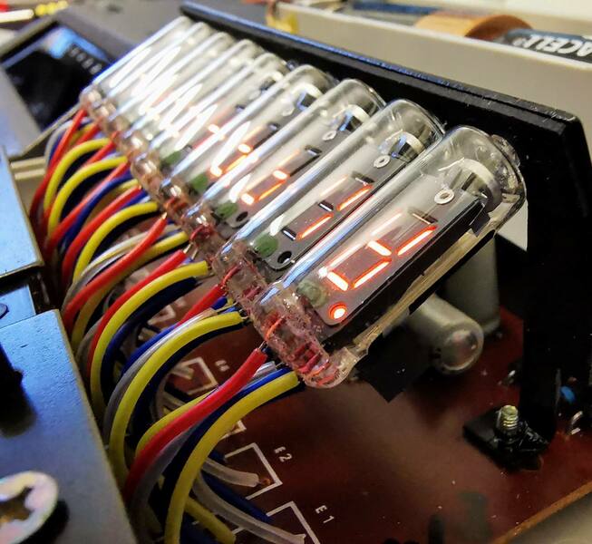

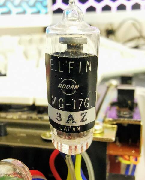

interesting, looks like separate tubes
one of these? (the 8th/11 is the digit hight in Mm if it helps)
http://www.jb-electronics.de/html/elektronik/nixies/n_zm1412.htm?lang=en
http://www.jb-electronics.de/html/elektronik/nixies/n_mg17g.htm?lang=en
Yeah, something along those lines, basically a single digit version of the Panaplax setup for all intents and purposes.  Don't think it's an amber VFD looking closer (aside from them being bloody rare), the digits don't look sharp enough.

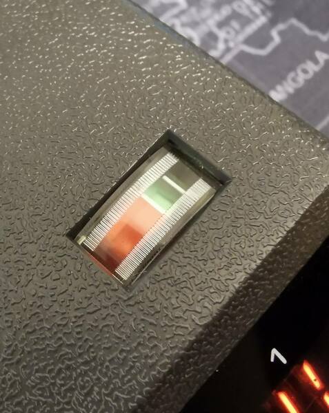

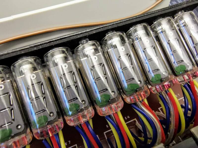

In other news the latest addition to the collection of obsolete technology arrived today.
Aside from the one dead line on the display (which I'm guessing is probably a dead transistor which is responsible for that segment on all the digits via multiplexing) it's absolutely immaculate.
Definitely no VFD display here...these are proper neon display tubes.
Tried to better capture the colour of the display here, but it's always going to be a struggle with a digital camera.
The little battery gauge is a nice touch.
*Just about* qualifies as hand-held!
Yeah...maybe not.  Think "portable desktop" will be the stated form factor when I put together a page for it.  Weighs a tonne even without 4 C-cells fitted for power!
Definitely happy to have that one in the collection, especially for what I paid for it.  One of the rarer display technologies for sure, given things generally jumped pretty much from Nixies to VFDs/LEDs before LCD took over.  Seven segment neon was never widely used, and most examples I've seen have been Panaplax style setups using flat glass packages with multiple digits in one assembly... can't say I've seen a calculator with individual tubes for each digit like this before.  In VFD form yes, but not with this style.

18 minutes ago, PhilA said:
Would recommend MPSA42 (npn) or MPSA92 (pnp) for switching of neon.
Phil
ah the joys of soldering about a million of those in an nixie tube clock kit I was building with someone about 10 years ago and discovering you soldered one of the wrong ones in etc
I never did actually complete said nixie tube clock kit sadly, would love to have a bash at one, and I had one waiting at one point but traded it with a fellow collector for a 60W SLI/H lamp (which I then in the end sent/traded to a friend in the US, do wish I kept said 60W SLI/H lamp tbh!)
now that I have some much better soldering equipment, I really must have a bash at another kit (probably an IN12 based one as I have about 20 IN12B tubes kicking around as you do...)

thats very cool! also much larger then the pictures made it look hence why I was somewhat surprised when you first posted it to see what looked like individual tubes as they would have been very small (as I thought it was a hand held machine), but now it makes a lot more sense
looks like I was spot on with the tube type in the end :)
