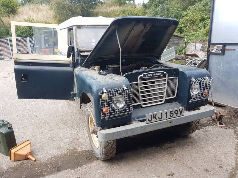

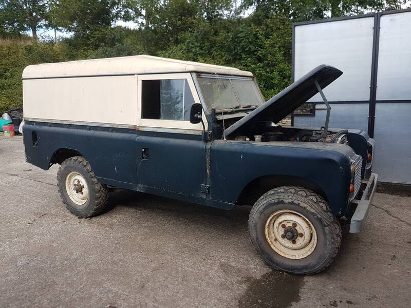

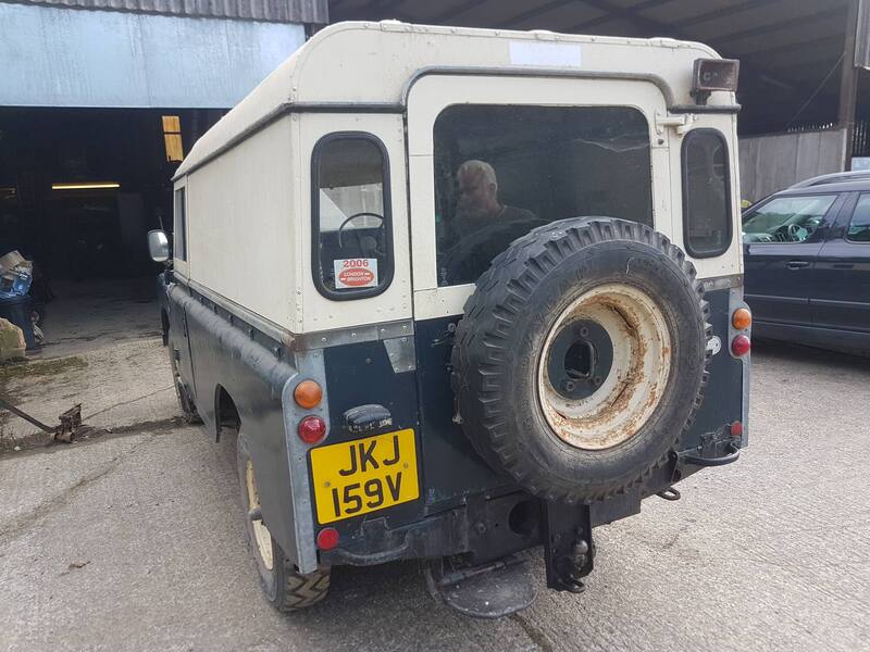

Fatha thestag accidently snapped this up from a chap at the pub for a bargain price that we are both delighted with :) (i would have bought it but am borasic at the moment + Mrs thestag who just doesn't understand these things would cut me balls orf)
very together 109 s3 2.25 pez. needs smoll work to bulkhead, chassis looks* sound, starts and runs. no clutch. All in and delivered for a bag.
Last on road 2 years ago wcpgw,
Looks fucking lovely that. Steal of a price nowadays?

That's got to be a bargain given what Series Land Rovers are going for these days.

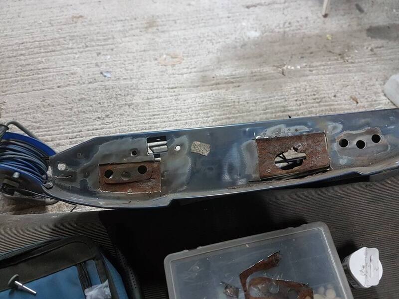

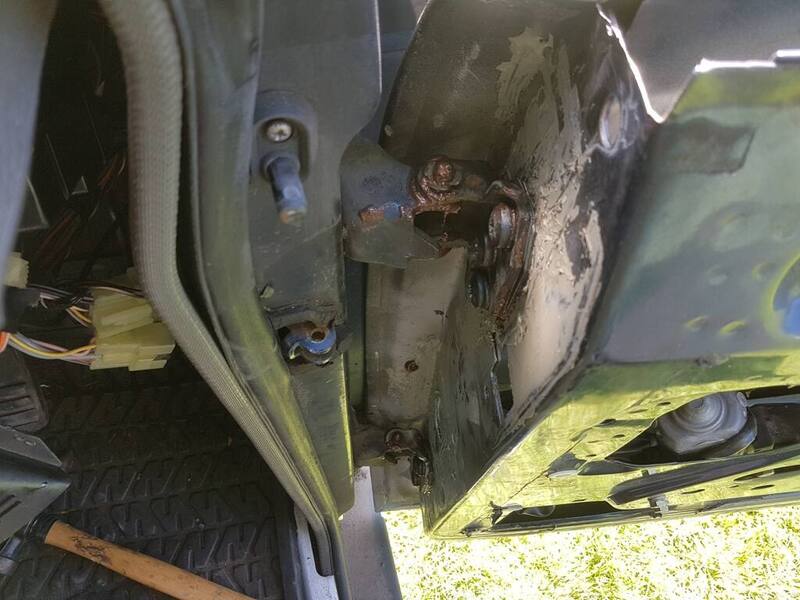

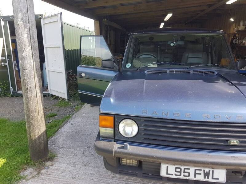

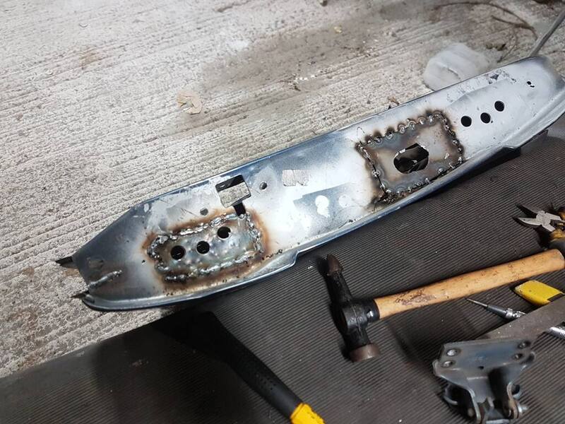

in other news, the daily needs my attention. The drivers door top hinge has worn so bad that the top edge of the window frame clatters the b-post when I close the door. Been like it for over a year, time to do something about it
Door is easy to strip and remove, root cause was kind of opbvious

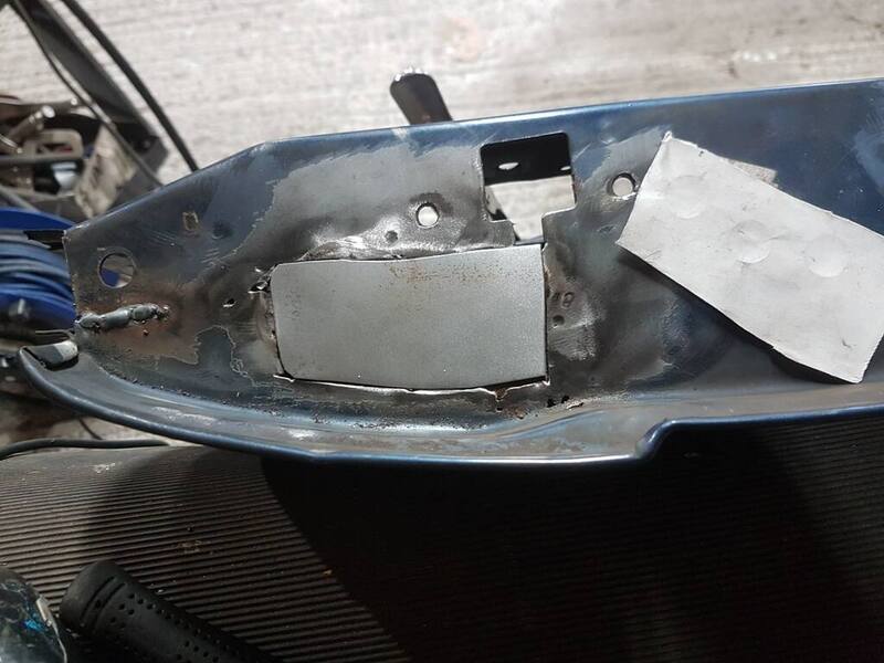

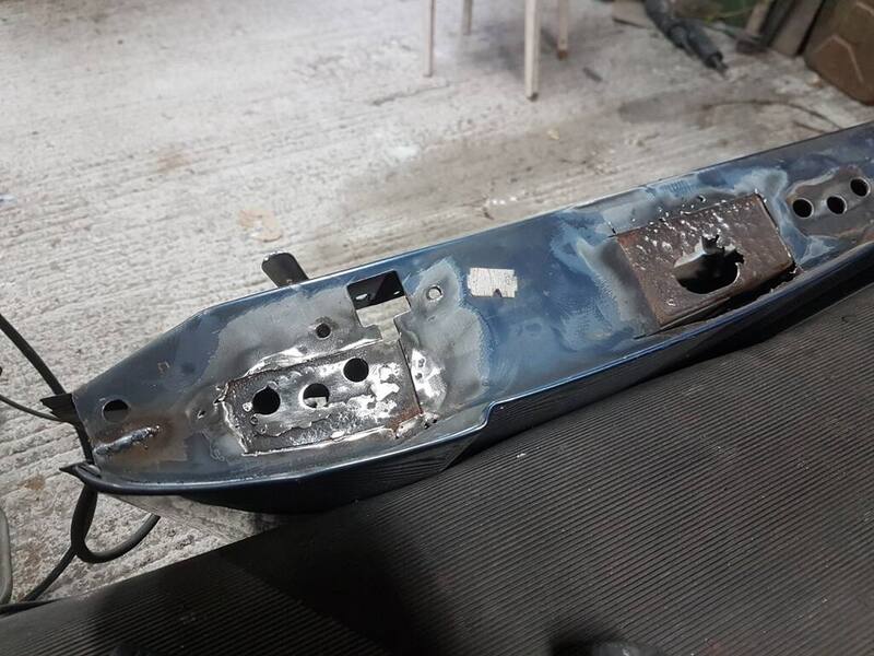

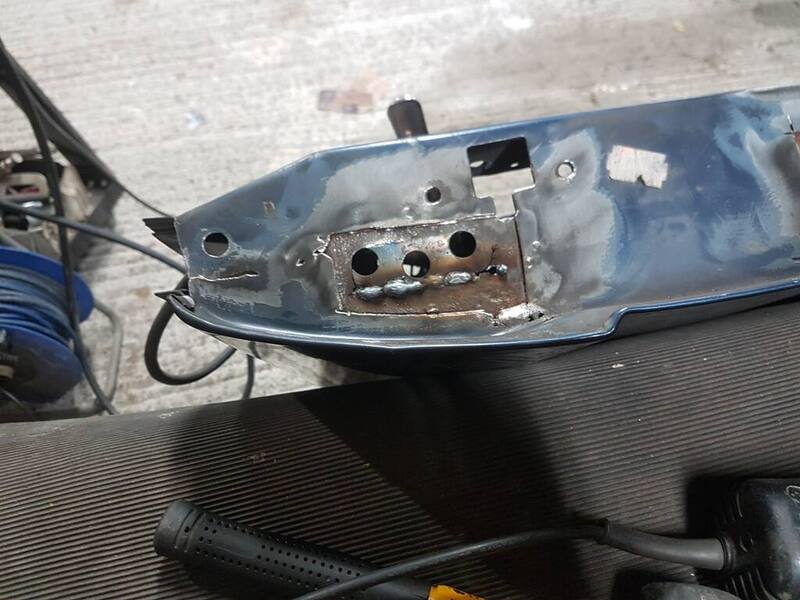

Stripped all the bad areas back, top hinge is on right of the following photo. There is a fracture through skin and panel underneath
skin came off with mr dremel and mr chisel. Obviously there is no paint between these two layers at all
cut  1mm slot down the fracture on the inner layer and welded it back together,
repeated on other side and flapped the fuck out of it.
made up a template for the outer skin, bit of paper helps here
welded in, piece of piss, not bothered about the section in the middle that the loom goes through. hence tags rather than seems. Being v careful of proximity to outer door skin

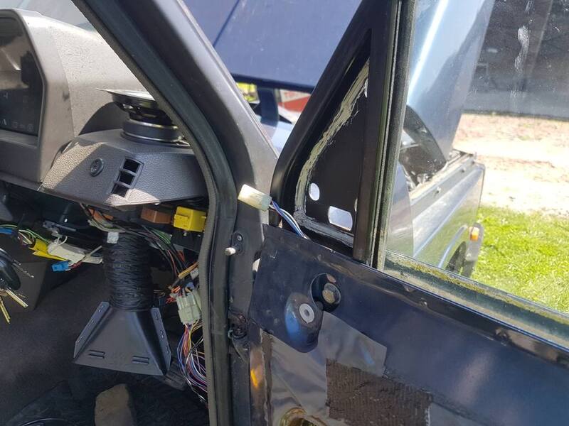

Then grinder packed up, £2.99 of brushes ordered but had to wait until next day to get another cheapo grinder to finish the job this weekend
sealed, hinge in place and spacers added to allow for ker-lunk door closage
when/if you ever do this make sure the mirror electrics are in place before you assemble the whole damned thing. else it needs to come apart again

Series 109 work will continue around that project.

This is going to be a quick turn around, new brakes and welded up bulkhead. may or may not paint it
