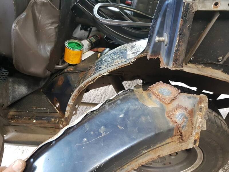

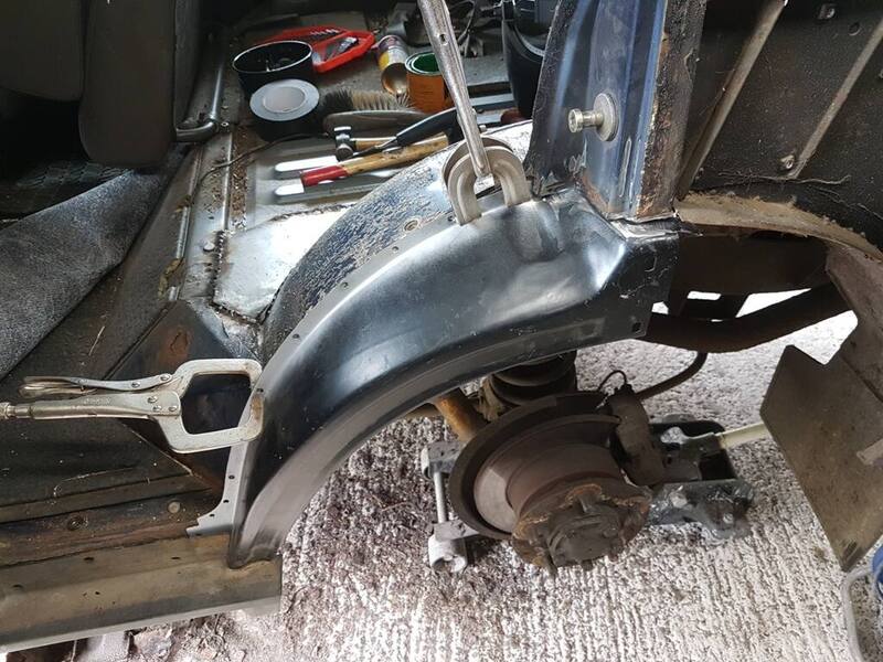

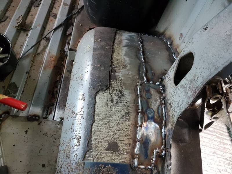

the hole was passenger side under the c post on the arch, didnt take a lot of poking around to find lots of fresh air
As the outer arch was already fucked and patched and I had another new unit, it was first off
flange is tidy enough but behind the c post against the inner wheelarch is a world of space, to depressed to take a piccy,

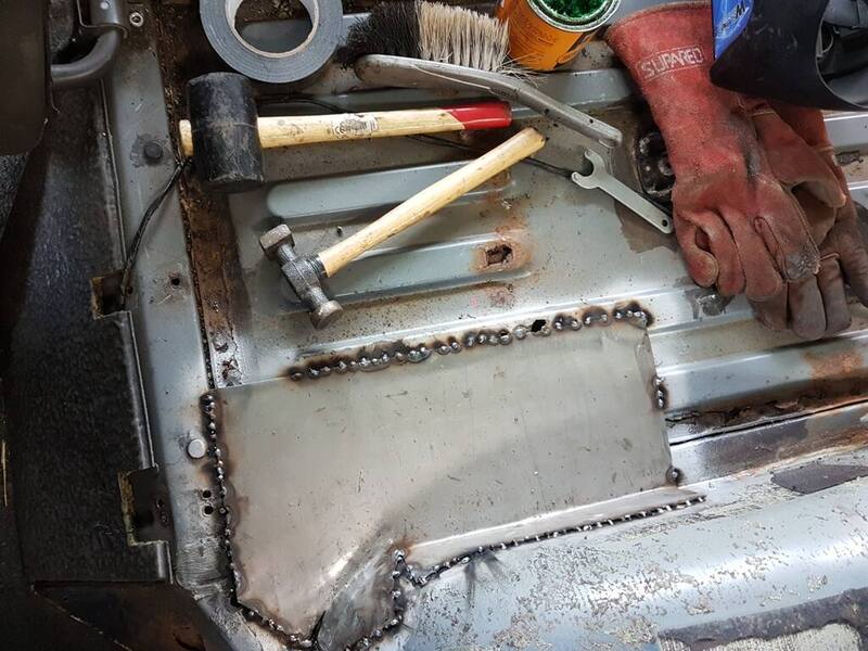

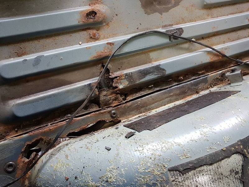

I pulled back the carpet to save it catching fire and found this load of fun, boot floor up against the wheel arch, you canimagine how much was left after I gently prodded it.
New boot sides, arches and boot floor are going in very soon. Shame I didnt have the bits already because it would have been a good place to start.
Cut a big chunk out and welding in a huge patch, boot floor no longer flexes
Next up I lined up the new arch and ragged it into place
Then started on the inner arch sections behind the c-post
That rust extended it's way nearly all the way down to the lpg tank which sits in the spare wheel well.
A-hem yes that is it still there, I simply could not be arsed to remove it, no smell of gas and tbh the plastic petrol tank is just to the left under the boot floor.

The last two holes, one right above the body mounting, and just beside the seat mounting
Ran out of fucking welding wire. I did have some more but ran out of patience, finished the job on Saturday

Where do you get your wheel arch panels from?
The ones I've been able to find are pressed out of much thinner metal than they should be
- or are you just working around the thin metal problem?
pretty sure there is only one manufacturer is pressing these, I bought them from YRM solutions
https://yrmit.co.uk/product-category/range-rover-classic-lse/body-range-rover-classic-lse/
They are thin but not so much that I blow through them
Ta!, I got mine from Paddock.
I'd doubt I be blowing through as I'll be spot and mig puddling them on.

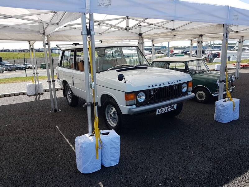

Auction happened, car didn't sell, I was very disappointed. I struggled not to take this as a personal kick in the teeth, yeah I know etc etc it is just me
Lots of discussion with auction house and other dealers to understand why.

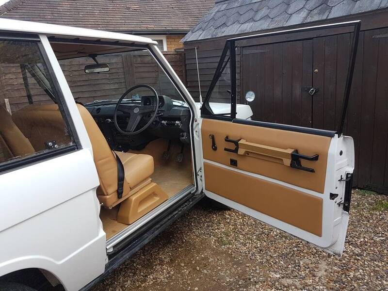

Interior I was/am really happy with
MW/LW radiomobile set I am really happy with. looks the part too.

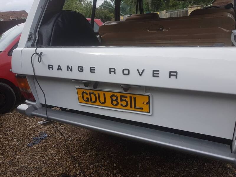

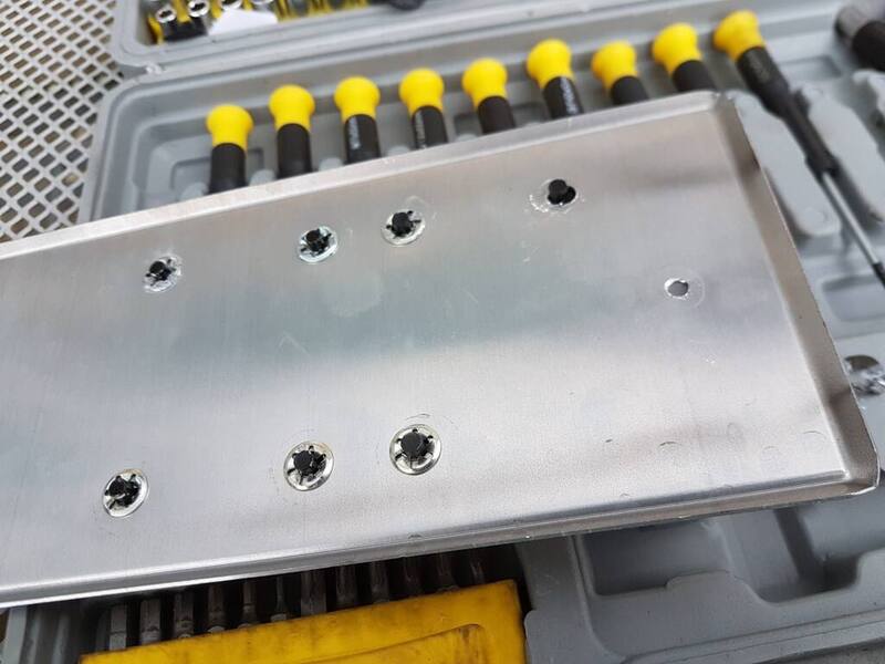

Brave pills taken and marked up to position the rear letters. needs 20 3.5mm holes to be drilled in exactly the correct location.
#2 son buggered the rear number plate with a pressure washer, I asked him to do under the car and somehow he thought that included the rear number plate. £50 down the toilet and no time to reorder before auction. bugger
started out well
here the letters are hanging in the holes with no inserts. the O however has fatter legs and needs no inserts. It was wonky and that irritated me. I tried to elongate the hole with a drill, which predicable broke because I was being a fool. and stuck a nice 2" scratch across my new paint!!!!

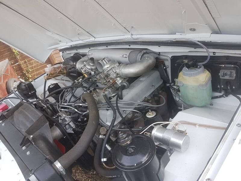

Engine was serviced, first service for running in.
Wednesday before auction and looking gorgeous. cleaned, waxed, stickered up, running perfectly

Maybe a bad day for the auction, It went up at 4.10 on Sunday afternoon, Saturdays auction had good results for classic cars but poor for sports cars. My son and Wife went up to watch, I couldn't face it. My lad videoed it from the balcony, nobody on the phones, limited interest from the dozen or so on the floor. It went to £38k which I might have been inclined to snap at but it was my bid due to the reserve. Auctioneer faced with apathy as with lots of items that afternoon quickly moved on. double duck farts. I consumed lots of alcohol which was probably not the best thing to do.
Next morning analysis found that 28 lots out of 66 on Sunday sold. Only 8 achieved the lower estimate. just one breached the upper estimate. I set off bruised and emotionally beaten to go collect the car with Mrs Thestag.
The chaps at the auction including the MD gave me some really interesting feedback. There was quite a bit of interest in the car Friday and Saturday but one by one that interest evaporated by 4pm Sunday. Just my luck. Bodywork and paintwork was root cause, I can understand that. Many of the other cars here are investment / wrap em up and hide them in a barn type vehicles. My car is a useable classic. It is hard to justify a £10k paint job really but that is what the punters were looking for. Buyers can be fickle.
Reserve also hampered the team in getting interest in the car, I could have lost my shirt on this but there are ways around that I found out after the event.
I found that original, unobtainium features for this car that were showing their age actually hindered the interest. plastic mats and basic headlining did not help those who just didn't know what these cars were like in 1972. They would much rather see later window trim, available new, looking fantastic but obviously not period correct. Patina would appear to be a dirty word to many. This surprised me, a lot! This view has been backed up by specialists and dealers I have spoken to since.
So originality and Patina are out, looking fabulous and a £10k mirror finish paint job are in :D Somewhat paradoxically not having the correct age of engine, even though the engine fitted is dressed to look period and runs perfectly caused significant damage to the interest. Go figure, you could not make this up, but like I have been told buyers are fickle.
Ultimately it came down to wrong day in the wrong auction.
I am feeling less sorry for myself and moving forwards wiser and better prepared for this now, I have to thank the auction team for that, they really were very good at helping post auction.

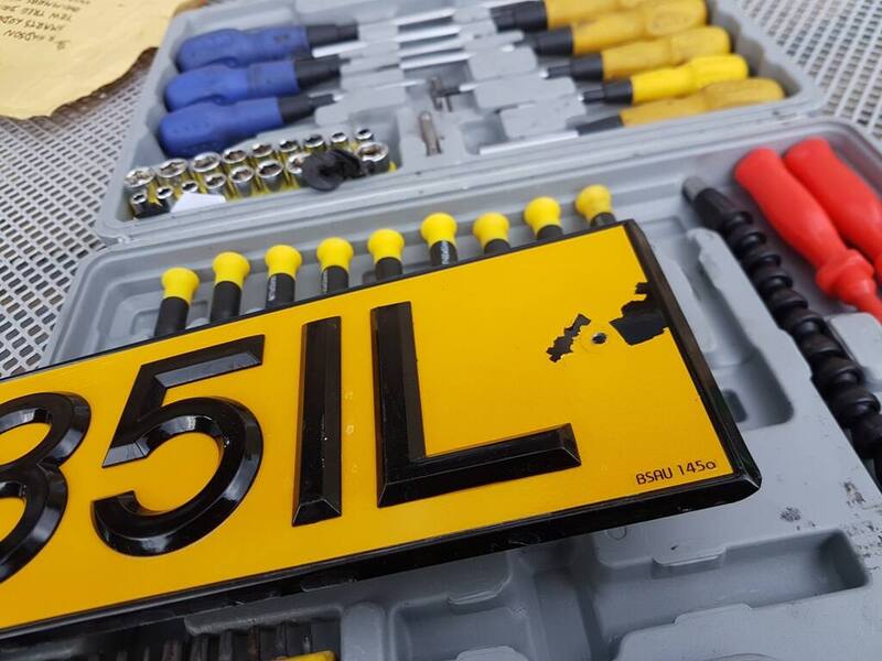

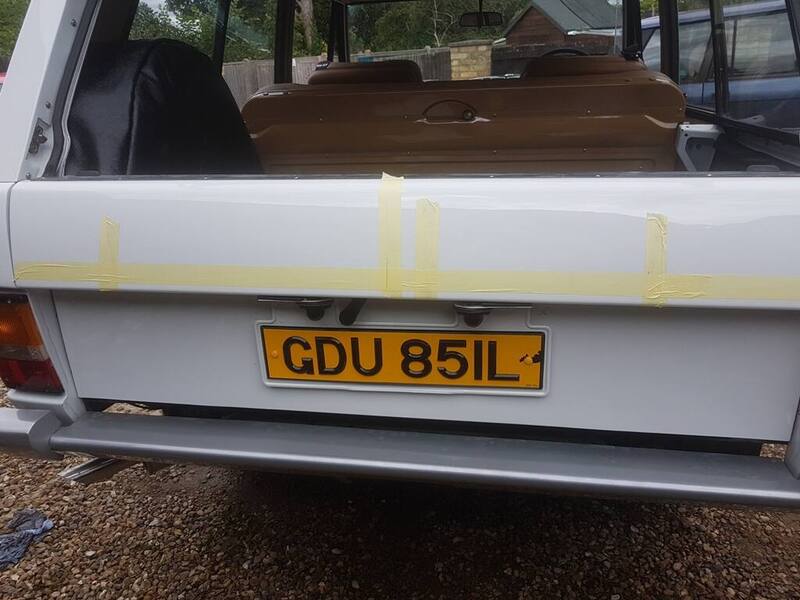

Numberplate next, bought a BSAU MoT compliant sticker
removered the letters

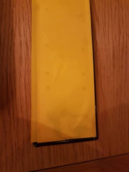

applied the sticker and found it A. see through ffs and B. unlikely it is of a BSAU standard. sent back with a cat turd in the jiffy bag
Got onto the original supplier of the plates, "no you will need to buy another plate complete" when I asked if I could just buy a blank! ok see ya
Found another supplier who is prepared to sell me a blank so will report back next week on success,

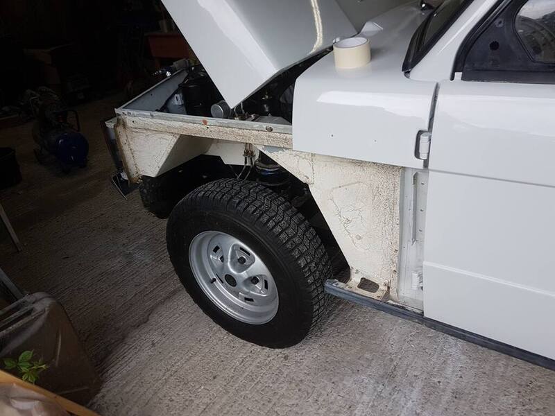

Paint in the inner wheel arch is schutz, I left the car relatively bare underneath so folk could see the extent and quality of repairs, again i was rong! it will be plastered with inch thick underseal before next auction

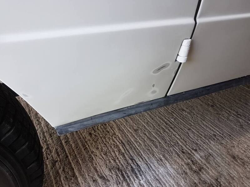

After the auction and having driven nearly 1000 miles in it I found two metal defects one on each of the front wings where the mud guard has resonated against the birmabrite panel. gah. Here has split the nearside panel. Had to flat it right back, fix the underlaying issue, fill and paint again
Fixed the dent and alignment issues at the top of the drivers door
found that the door an rear wing were a fraction of a shade different, so need to be painted to make them the same, ffs

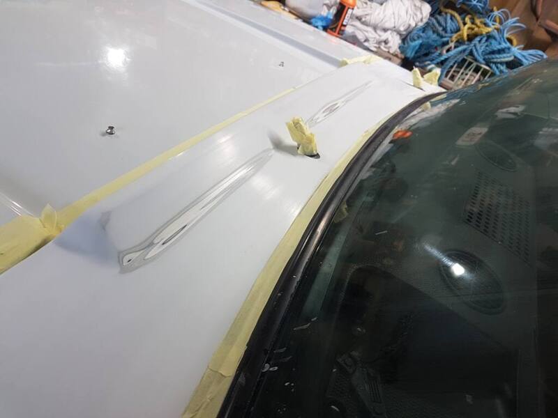

polished the deck panel back but really unhappy with existing paint shrink and micro blisters. which you can see when you get close.

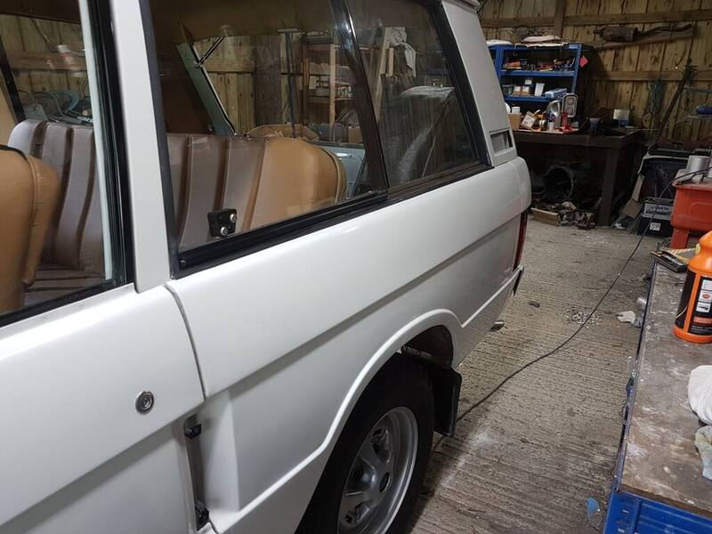

decided to paint nearside end to end, not as dramatic as it sounds but at least with a flat base, 2 coats should do it and it will be perfect, front wing came off for some reason that I am not sure I fully understand now
all back together and polished it looks gr9, I still need to sort the sill trim so don't panic. That is in phase 2 detailing

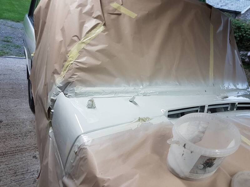

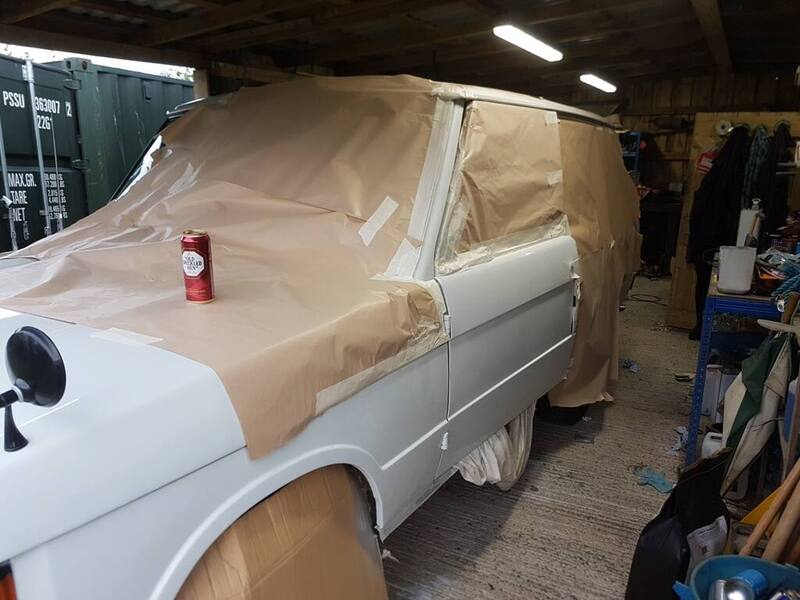

gave up thinking about the deck and masked it up Thursday night, huge storm due to hit South west early evening but I needed to get photos for the auction.
Flatted it right back to remove any shrinkage
Threw 6 coats on, while guarding against the House Martins who are about to fly the nest
about 1h before the storm, the paint is curing fast. It was kind of a race against time, should have waited really but I think I got away with it.

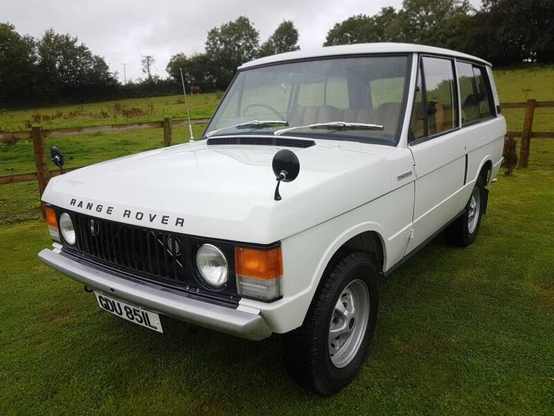

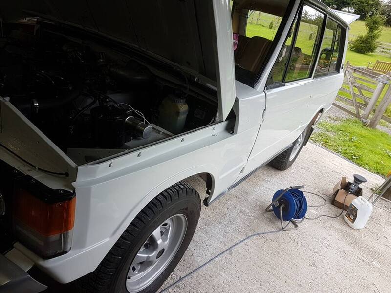

Polished the bonnet and tried to capture some images that show the quality of the shine and panel alignment. I still need to black the sill trims so photoshopped the image that went to the auction house. I will send more next week when I get back onto it. Heading back to Devon this afternoon, have to be home Wednesday night for A-Level result day and my twins !!
Anyway behold the result of 40 hours work

On 8/11/2019 at 11:09 PM, Tayne said:
Can you heat up the plastic coating on the wheel and melt the crack away?
No, sadly not, only way to properly fix it is to strip the rim back to it's bare frame and build a mold to re cast the rim.
cost = IRO £400 + Vat
https://www.famousfour.co.uk/new_parts/ff_part?part=19312

Photos have been sent off to Brightwells for the auction catalogue.
Latest news, one front calliper is now seeping. gah ffs I will get to the bottom of why but new callipers are being fitted. What a waste of time and effort
Also engine now has one noisy tappet, investigation found not oil pressure related.
Investigation tba
