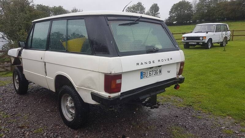

Brief from the owner is generous, convert to rhd, get it road legal, lower it from the comedy 2" lift, treat it as if it were mine....
here we are on day of arrival, one careful owner, one owner who cares and many who did not

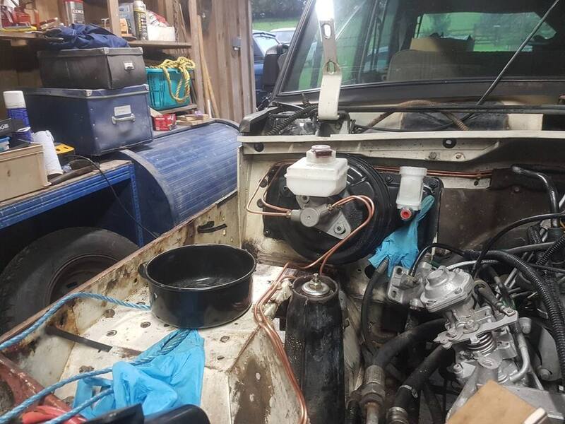

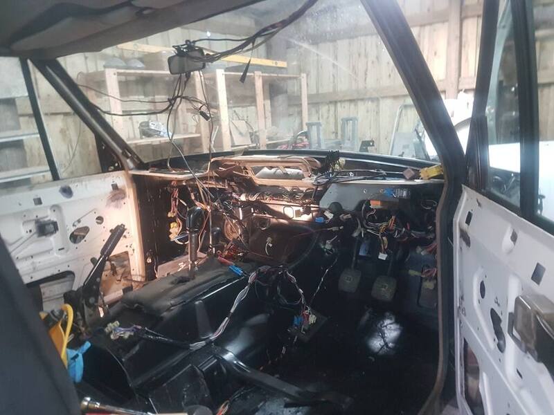

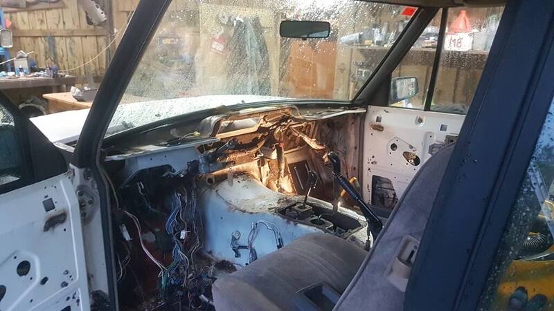

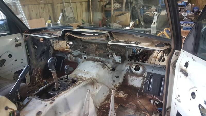

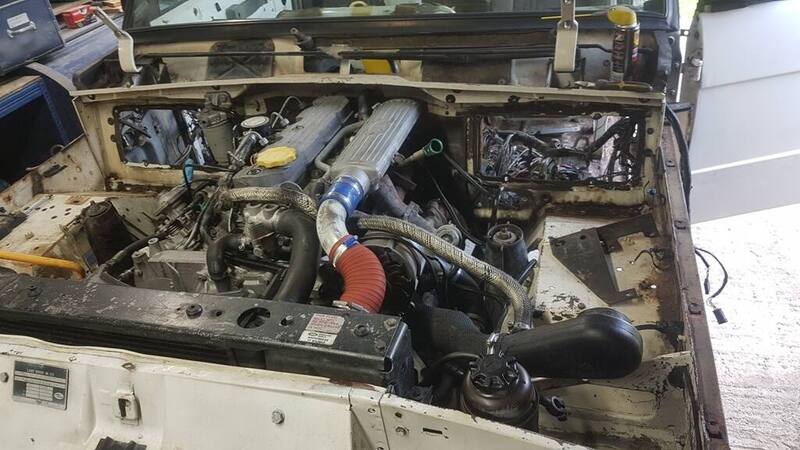

dash top heater were extracted fairly easily
as were pedal box and brake lines to the front callipers. I do tolerate a 200tdi ? though of course 8 pots is just ?
It would have been VM originally but at some point a previous owner installed a 200tdi.
next up, steering column and loom came out

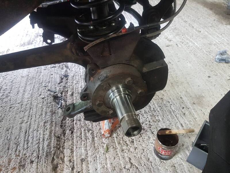

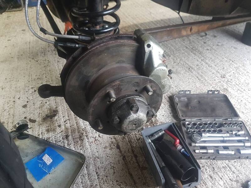

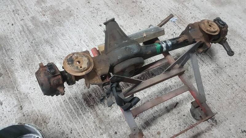

Front axle off next, not necessarily needed but brakes out, comedy 2" lift off, dead dampers out and rubber bushes replaced by blue poly made it easier

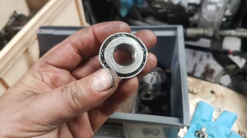

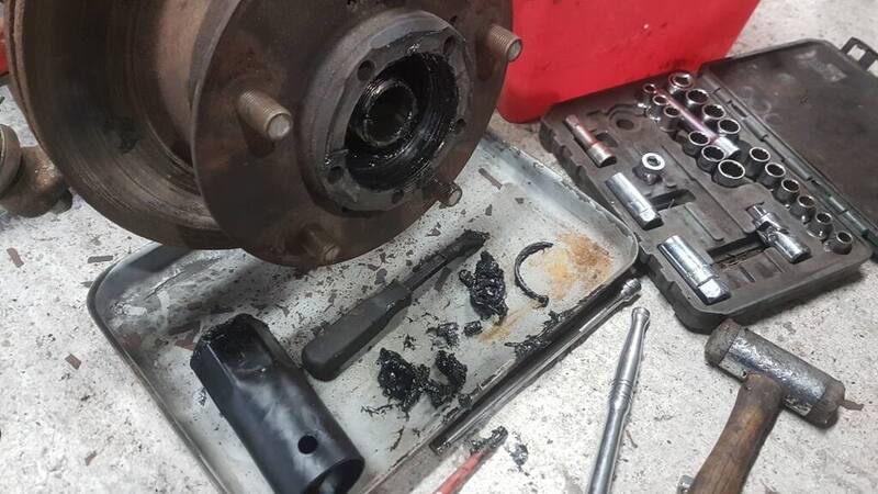

Both front hubs had significant play!!! Disappointed especially as customer paid to have the swivel balls replaced recently.
In the tray is the remains of the right side outer bearing race.... seriously! The situation improved marginally with the remaining 3 wheel bearing races on the front axle
Alas new! front swivel bearing here had damage. ..... what can a chap say?

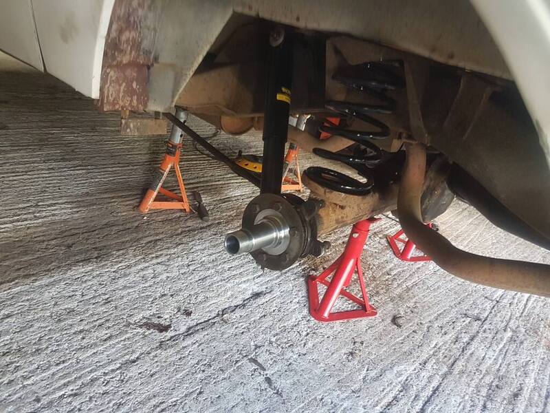

RHD swivel housings installed onto original axle

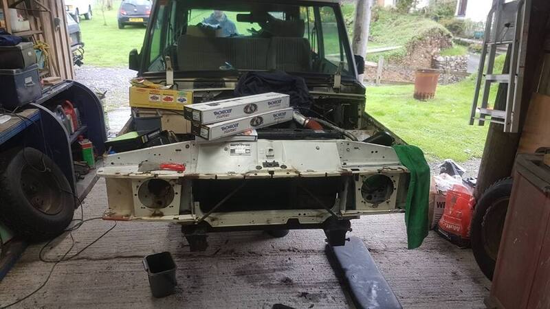

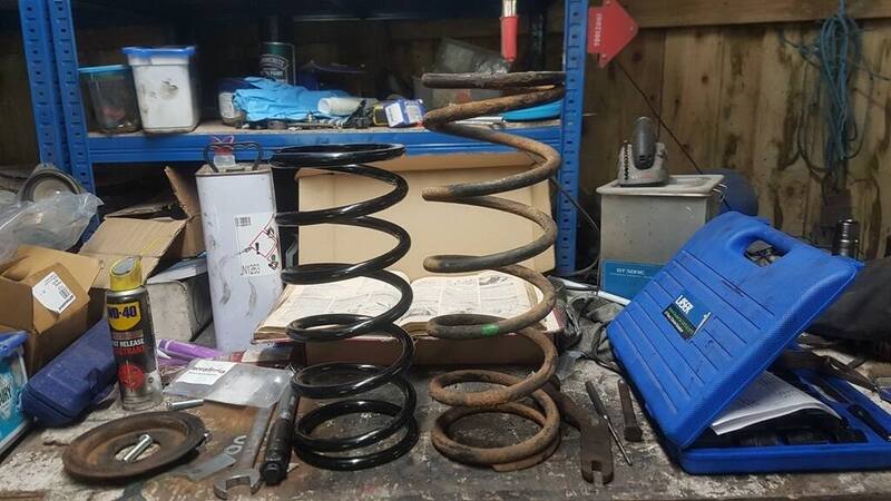

New 1" lowered spring from FamousFour standing next to 2" "comedy" ? lift springs
Axle was rebushed to blue poly and refitted with new lower springs and new monroe dampers.

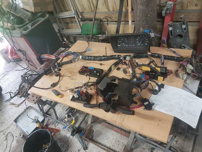

ongoing investigation on rhd loom is taking place. Yet to find an OE loom that has been removed from a 1990 GA suffix car that has not been massacred. Nor are Autosparks able to assist in the short term. BUT rest assured there will be an answer...

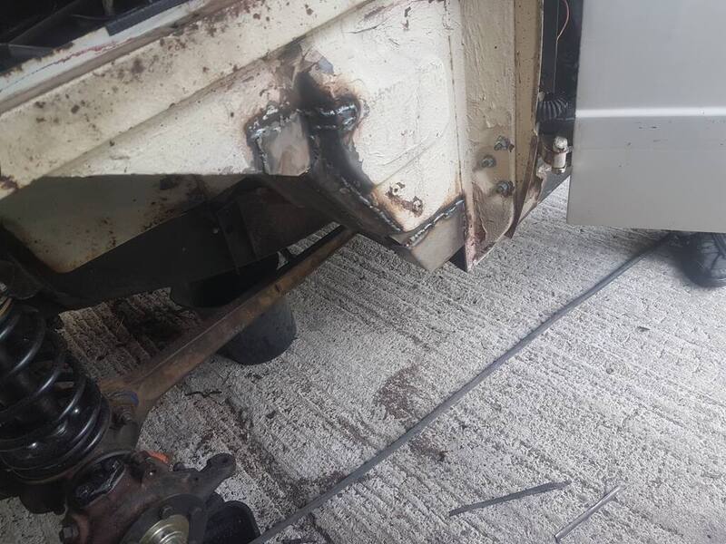

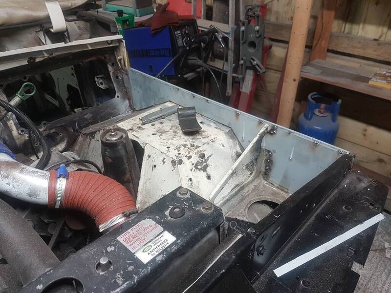

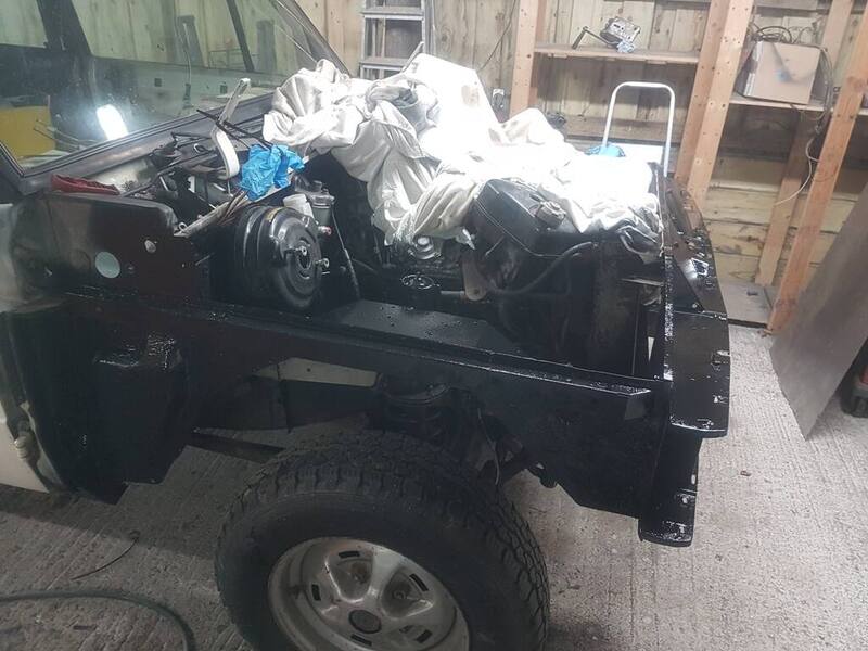

The only rust on the car after welding work instructed by the current owner, was around the LH front footwell / inner wing area. Cut all the shite and shonky bits out
Started welding is all back up again

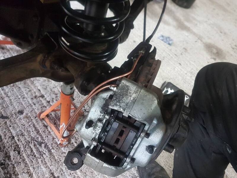

New brake lines fitted up

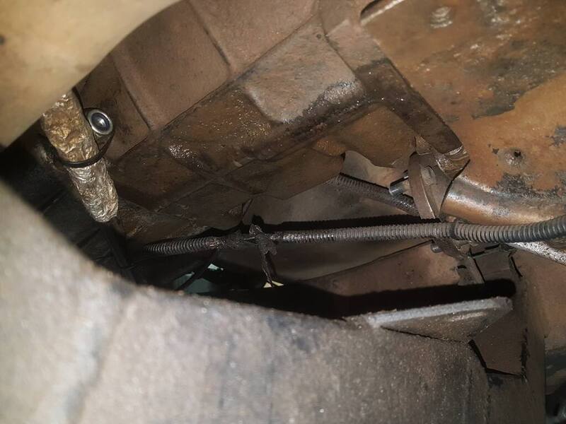

while underneath I found that the gearbox loom to be in a similar state splice as other sections of the loom. no wonder that all the smoke has leaked out.
Also a bit worried about that nyloc which isn't locked! will have a look tomorrow.
Swivel bearing preload was set as per the manual, new CV joints installed and then new stub axles fitted
then bearings and hubs fitted up, at this point I found that the spacer was missing that fits between the outer bearing and the hub lock nut
Nipped out to get a pair of them and spotted a pair of western power defenders. must be the last two in their fleet. doubt they will be investing in new defenders ?
anyway, spacers fitted, end float adjusted and hub sealed up. yay just one more side to do.
two front hubs done and steering track and drag arms fitted time to get it back on the ground. slinky low going from 2" lift to a 1" drop. Arse end is still 2" lift for now

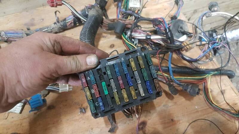

today was getting to the bottom of 1990 lhd loom, I have a spare 92 onwards loom - well most of it anyway. but to fit this to the car even with the body looms is going to be a ballsache.
This car is a 1990 GA suffix - same as the CSK 2 door, didn't make many nor for very long. Looms are hard to come by, going to have a chat with Autosparks and see if they can help with a LHD pattern toa  RHD installation

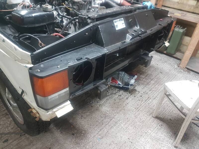

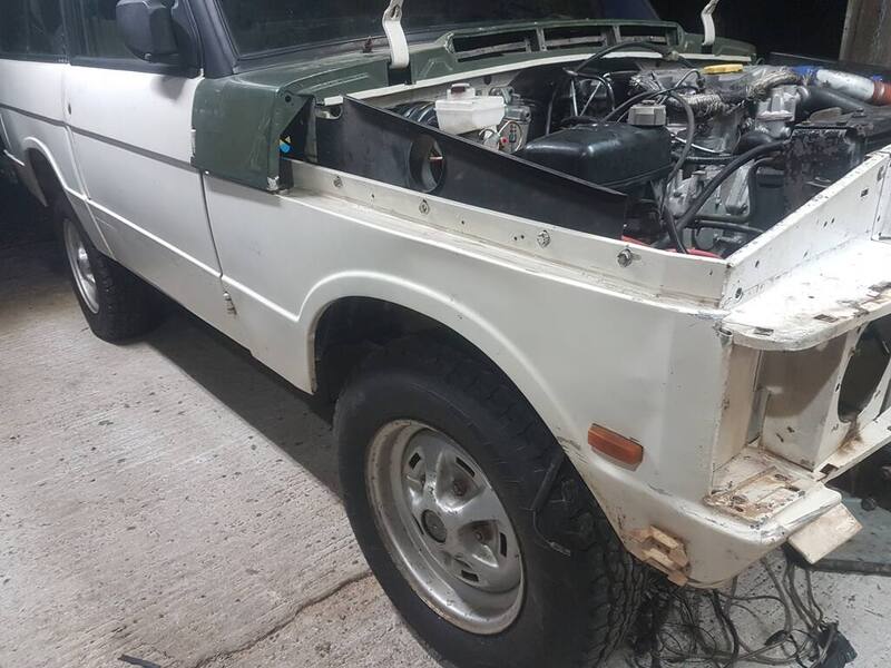

trial fitted the front wings and deck panel, may need a touch of paint. Chamonix white I think
Anyway, watch this space, loom is next week or maybe the week after

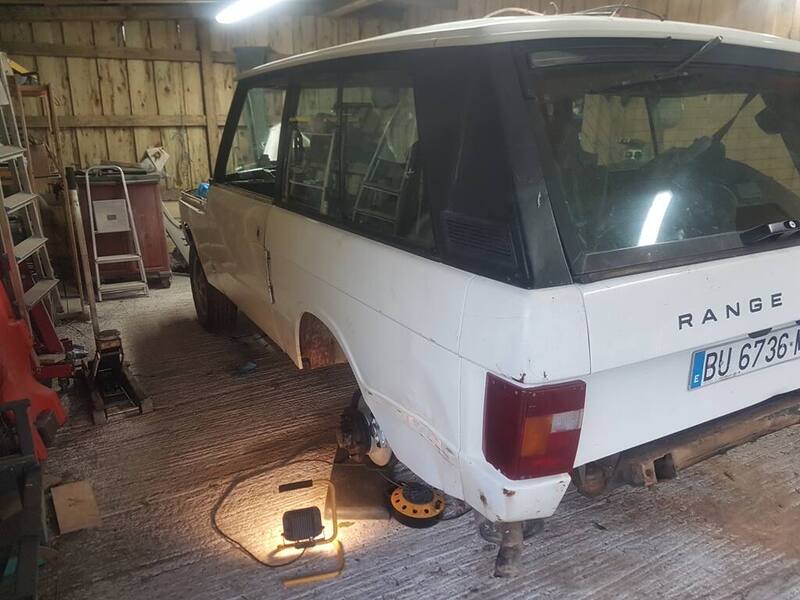

every time I knock this car another kilo of Spain drops out from underneath

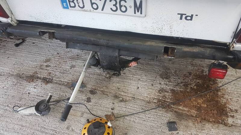

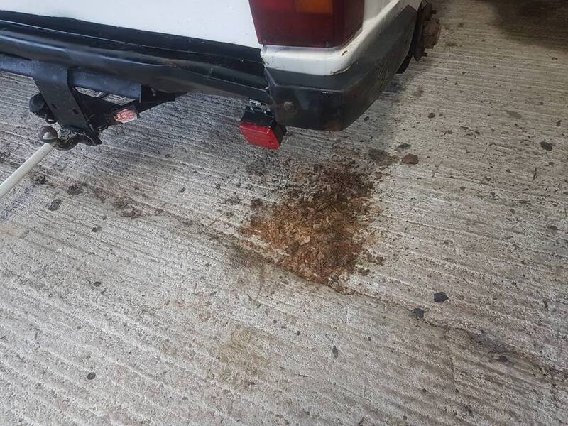

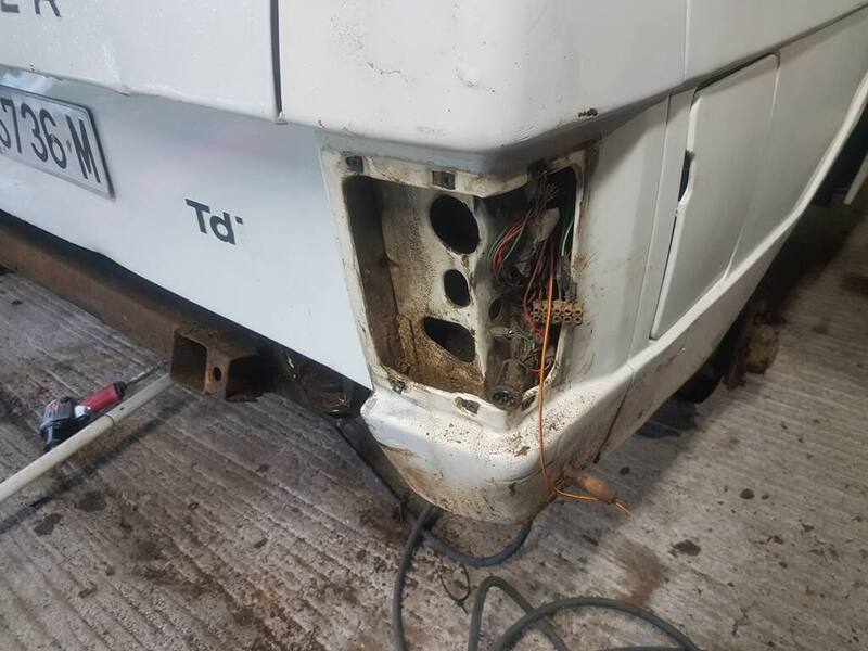

Bumper and towbar need to come off, Bumper was a bastard because of spinning or seized fixings. Cutting holes through the bent and generally fucked bumper was the only way

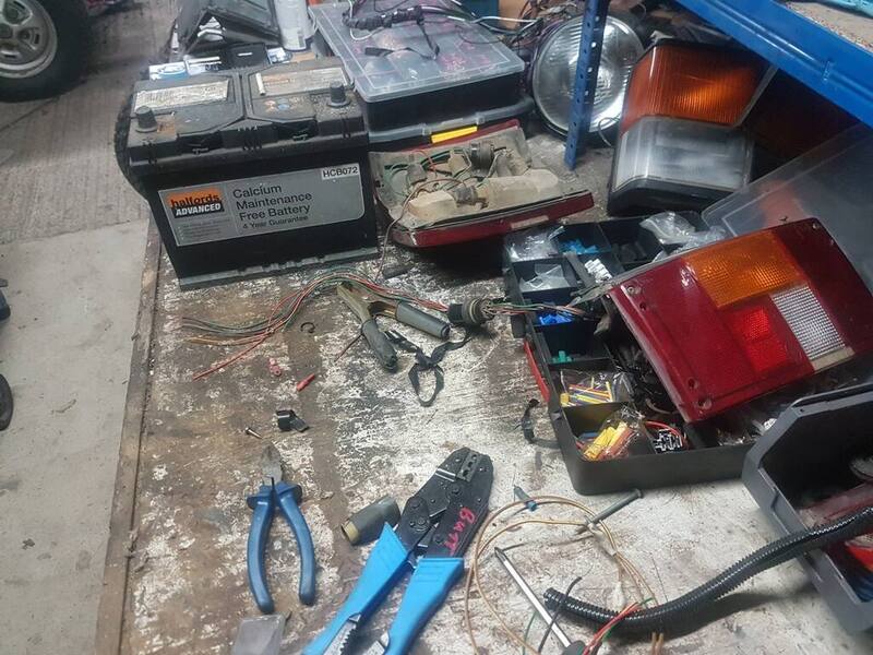

tow ball electrics were spiced in behind the rear light, love a bunch of rusted choc blocks

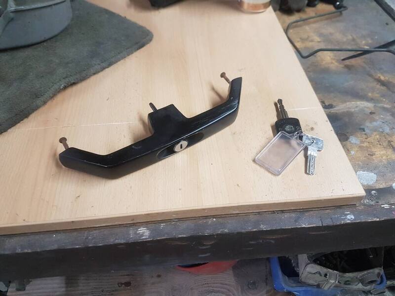

Reconfigured the tailgate lock so it uses the same key as doors and ignition

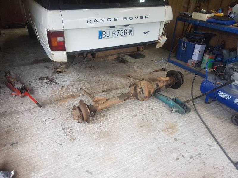

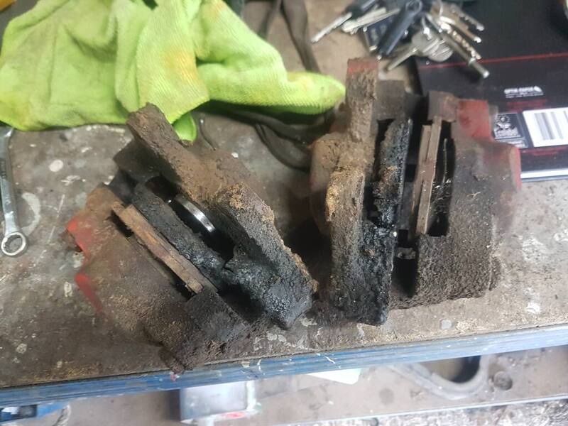

Removed rear calipers, both fucked, lots of hub and axle grease but also some brake fluid

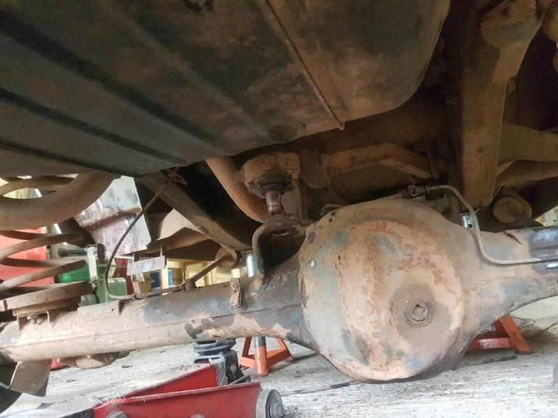

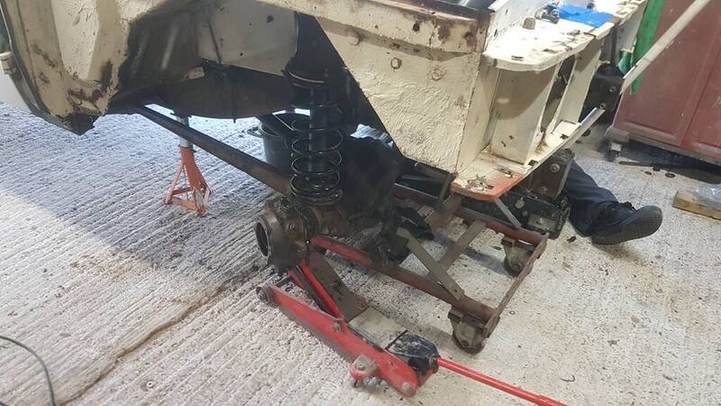

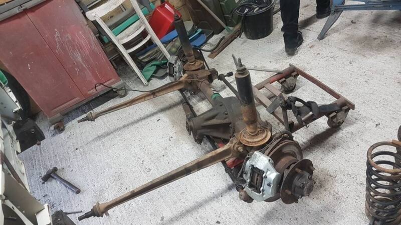

removed a-frame after a disaster smashing the axle into the floor with my pointy finger inbetween.
drop axle down was the plan but had to jack the chassis up another 6" to release tension on rear 2" lift springs

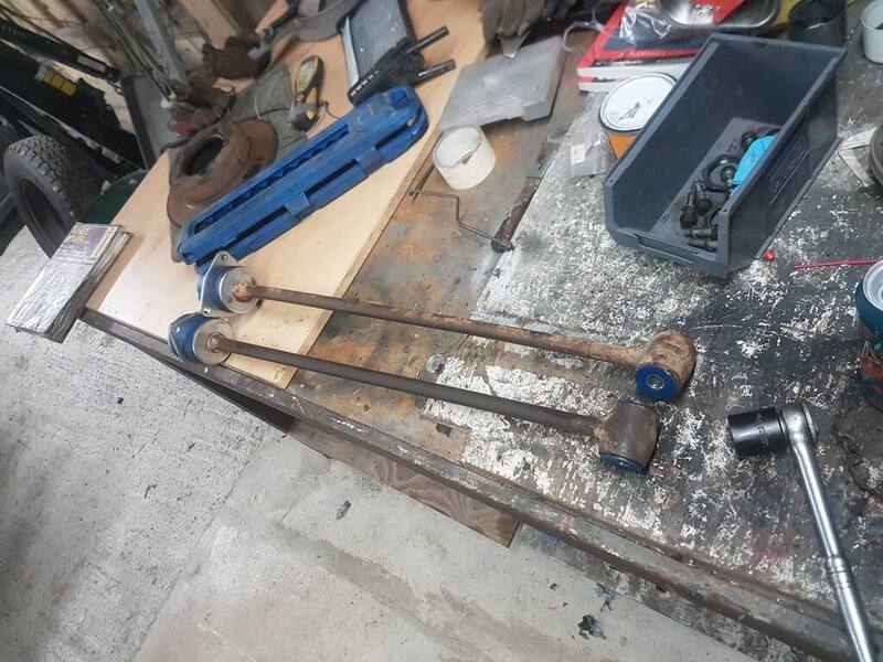

spripped down discs and hubs, removed like arms and drained oil. one rear disc was 8mm thick, against a minimum of 12mm! the other was just under 12mm

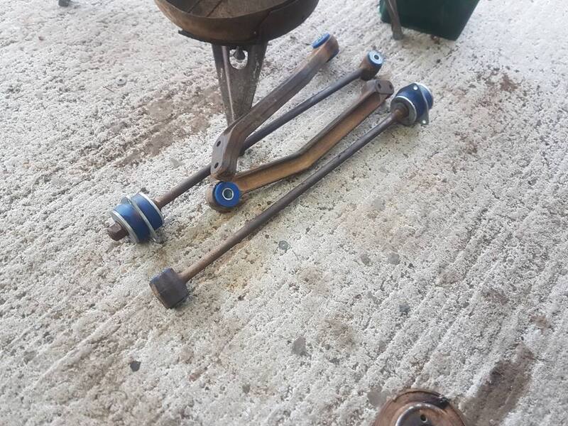

Link arms with new "comfort" polybush blue
I am a silly arse, done RR rear axle dampers so many times but misjudged the extra height needed to release tension on 2" lift springs. Traditionally I would jack the axle up, support the chassis, lower the axle with a-frame attached and the springs would be loose. On this occasion I was distracted, chatting with Fatha thestag and properly not concentrating. Was undoing the o/s/r damper and when the last thread released the axle propelled downwards under the force of the spring and bounced off the concrete floor. I was convinced that the tip of my finger was off, the gash seems to go very deep, bone is not broken, the tip of the finger burst open. 9 days on, finger is healing, shall not show images unless you have a desire to see, nail is intact and nerves on the tip are working. Completely numb on the print area though, which is utterly destroyed. Finger is still twice the width of the right hand pointy finger.

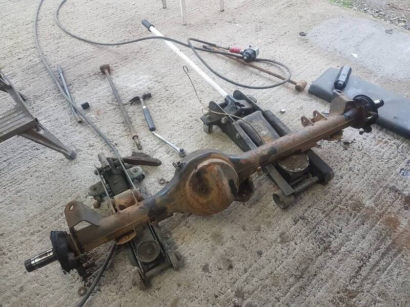

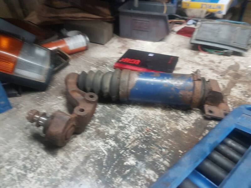

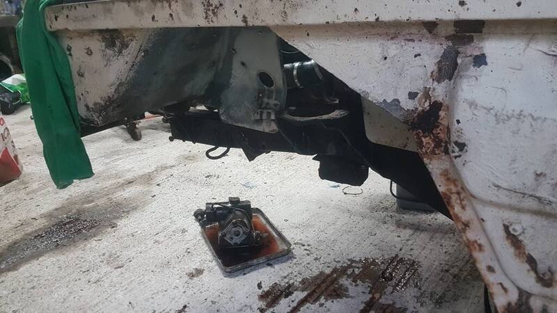

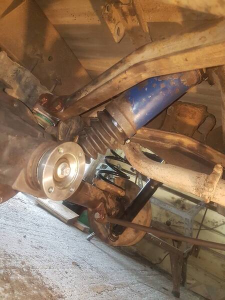

Stripping down rear axle, both rear hubs totally worn out, age and sand I think finished them off
Diff is leaking at flange seal and gasket. Breather was completely blocked
However diff itself is a peach, engineer blue shows a perfect mesh

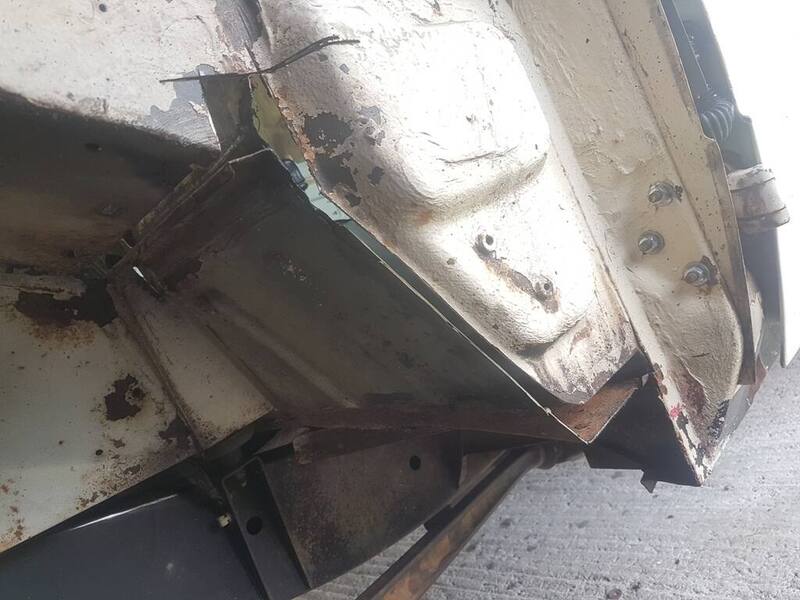

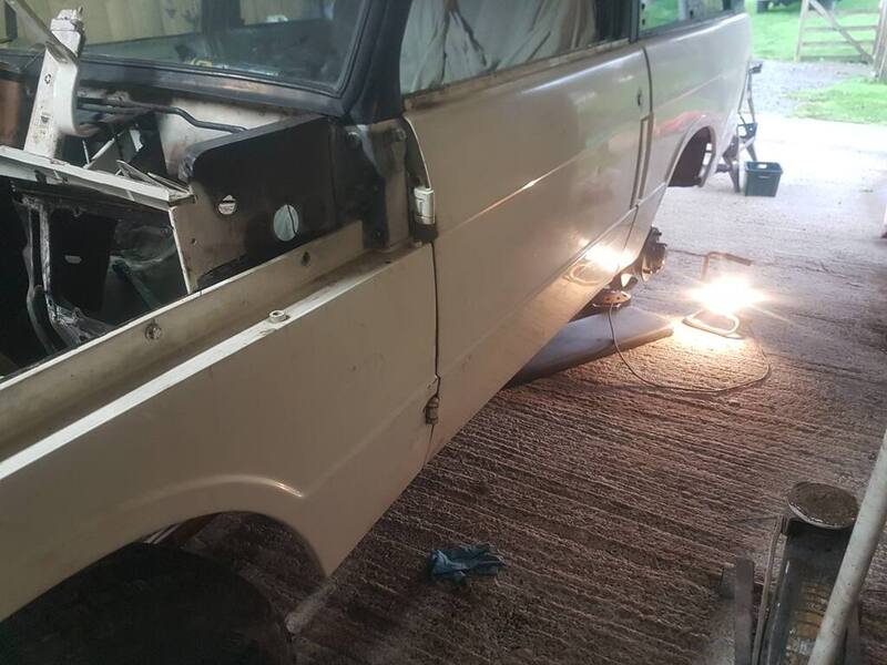

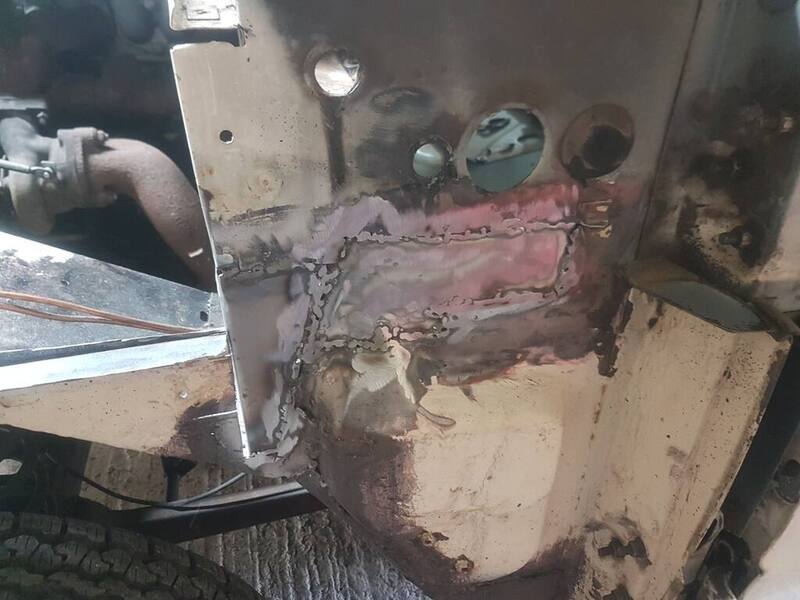

Inner wings are on the whole rust free and very good, except the top rail / box section, this had been creatively disguised with loads of wob
Both sides, inside and out gah
cutting open the box revealed reason, it was full of sand and mud, been wading mefinks, and this area doesnt get a breeze to dry it through
Welded up drivers side, need to finish this off this week
shiny bolt kit for the rear axle and a-frame
all "comfort poly bushed and ready to go
easy enough to get it back in place and on my own

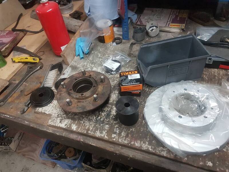

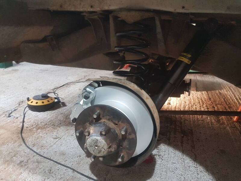

next up is to build up hubs with new discs and wheel bearings
along with new calipers, just need to make up the rigid brake lines and refit the flexi. Before then I want to install the Boge levelling strut

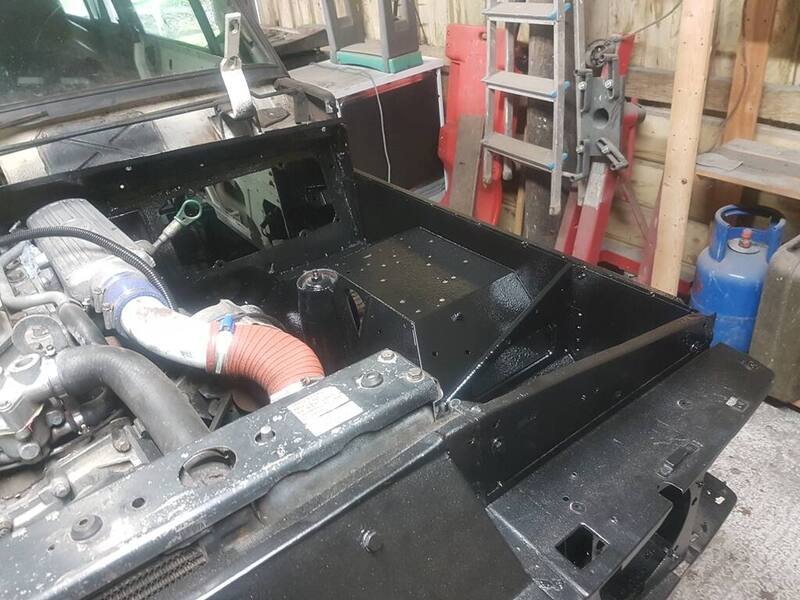

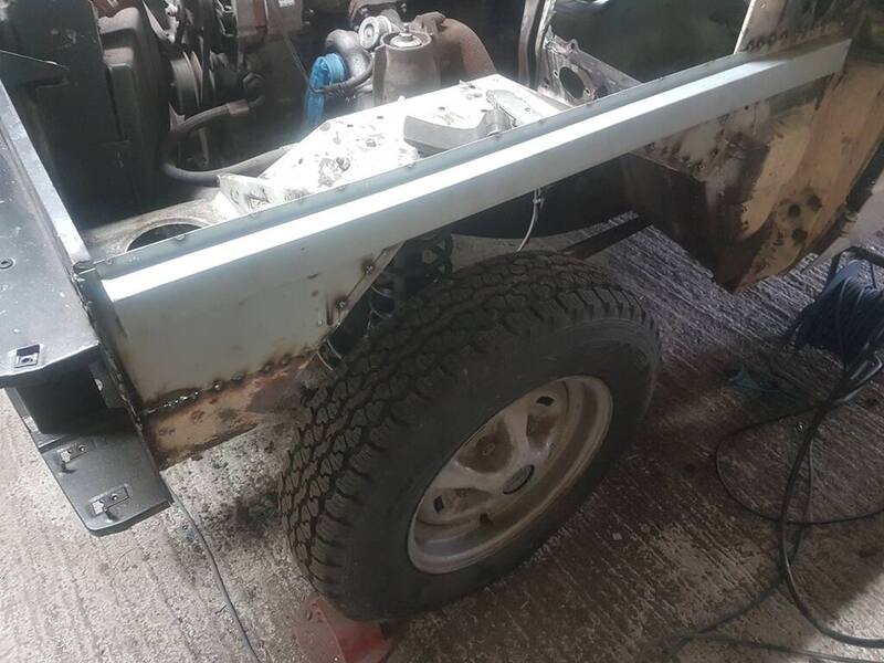

Finished patching up the top rail and side curtain of the drivers side front inner wing, kind of wish that I had just cut it all out and replaced with single chunks.  99% will never been seen with outer wing fitted and stuff under the bonnet will be further hidden by loom, battery etc
then got on with the passenger door, top hinge was royally fucked and the gaps were all over the place. Ended up removing the glass frame which was held in by 2 screws rather than the usual 7
then mindful of the inner wing issues on the drivers side I tested the steel using "hammer of testing and cut the whole sad thing out, good job too, was worse than the drivers side I just finished
along with a bog wedge of the bulkhead that was hidden behind the inner wing top rail. all rusty as fuck
remains of bulkhead and first of the repair panels
not beautiful but rust free, solid, and hidden from view
ordered parts to repair the inner wing which I will fit next week, then paint and rebuild yay

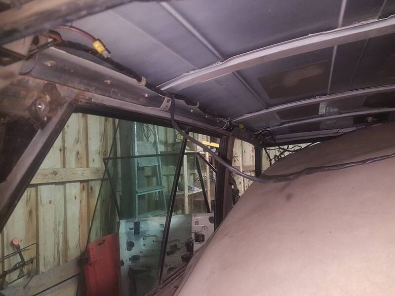

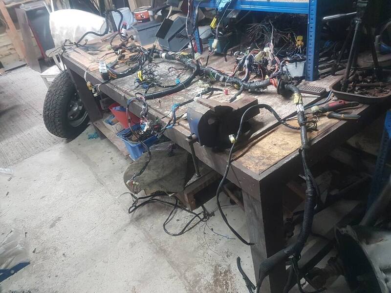

Loom is becoming a "bulls acre" Autosparks cannot help, bought a 1990s loom complete and will have to get that working most of this car is later loom anyway with exception of door looms and connectors to the rear loom.
watch this space

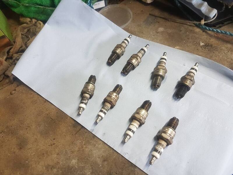

Hats off to Bosch Super 4 plugs, done over 64k miles and still have life in them

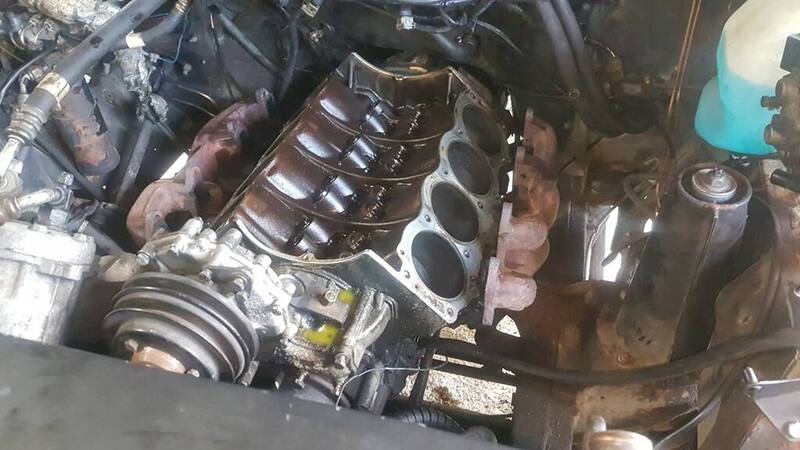

Compressions on RH Bank excellent for a Rover v8, on LH back I couldn't get the tester to screw in, fucked plug thread, remainder were not great, #3 and #7 were more than 10% off the highest compression. Didn't bother with a wet test because I knew the head gasket had failed.

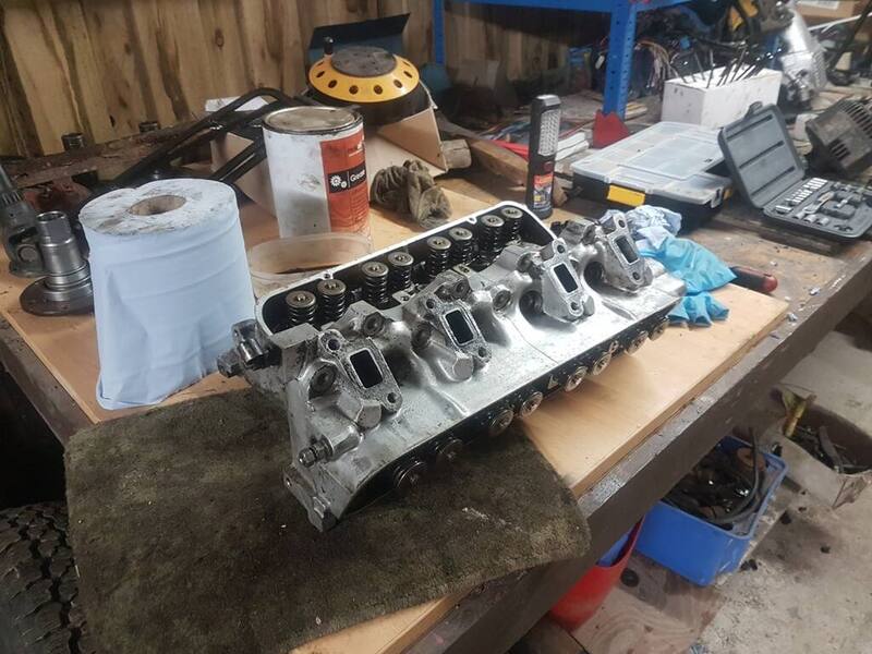

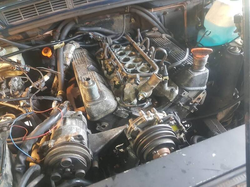

started big strip down, everythging is a bit grubby to be honest

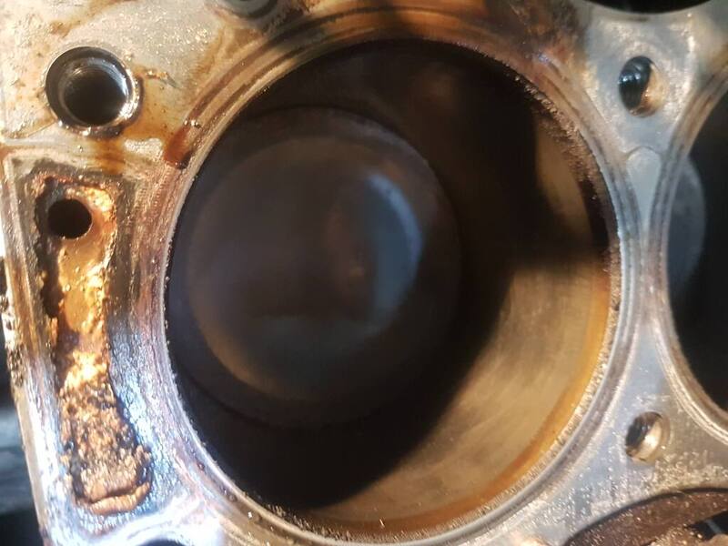

as expected LH bank head gasket had failed on 3 of 4 cylinders. Sounds horrific but ....
It is this bit that confirmed it for me. On the left is the water jacket at the front of the block. Then you can see three light rings for the head gasket fire ring imprinted onto the block face. However where it goes past the water jacket you can clearly see it has breached
The front 3 cylinders all had these breaches on the inner edge (next to the inlet manifold) again head gasket had failed almost certainly due to the infamous 3rd row of head bolts and subsequent head tipping. I am pretty sure this engine had not been apart before I bought it at 46k miles and the head gaskets were Land Rover Branded so this is the first time apart ever!
Cleaneed up the block face and checked for low points, especially where the blow had occured, seems ok
 Head on the other hand are both distorted, mainly around the ends. but will definitely need a skim
But a damned good clean up first will make the job more pleasant

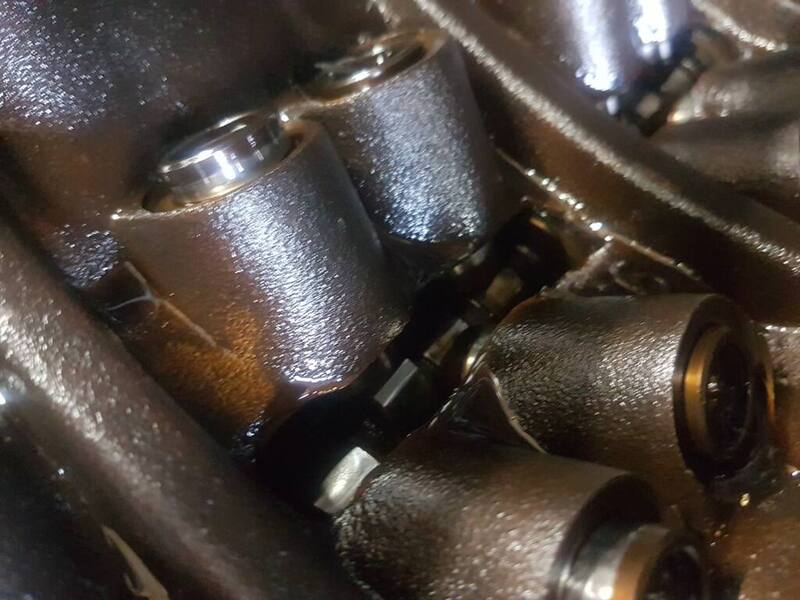

camshaft is showing signs of wear, but is not the catastrophe that many of the OLLI boys would have you believe on a 194k engine that is still running all it's original components (except timing chain and gears)

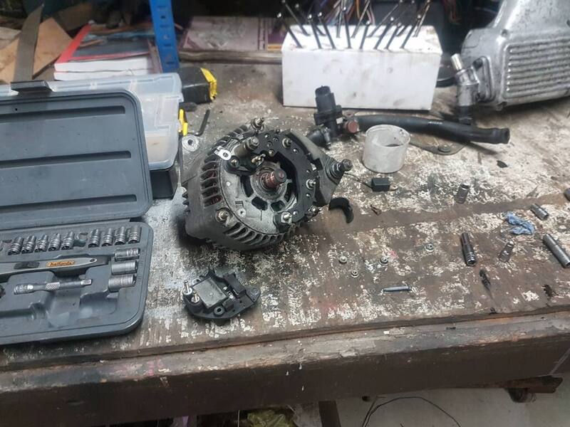

Did a check on the brushes on the alternator, which were fine. The contact rings however are almost worn out! Since the fuck when do contact rings wear faster than brushes?
Removed the cam which meant first removing the radiator and then shifting the Aircon rad out of the way also - without disturbing the pipe work
Now I have a smoll shopping list and a visit to thee machine shop with those heads. Hope to have it back up and running next week

write up on Southpaw :D
spent an age cleaning gloop off the drivers side inner wing, sticky oil, sand and mud. Used a screw driver and wire brush to loosen stuff and an air blow gun to shift it.
Then I used some eastwood spray paint prep that the owner of the car had already bought. very effective but some nasty chemicals!
The paint which is 121 chassis paint from rust.co.uk and applied with a 2mm paint gun running at 75-80psi ish. very tough but quite orange peely. exactly what the customer wanted! And I think it looks good too
Autosparks couldn't help with changing the lhd loom to rhd, shame. Gave up wasting any more time and bought a complete loom* from a 1993 200tdi Range Rover. Alas it arrived without engine/gearbox and door looms. Those were extras..... double alas they had sold the engine and gearbox looms but I managed to snaffle the door looms for an additional £50.
Repair panels for the inner wing were sourced from YRMIT.Co.uk, dirt cheap but accurate cut. Wish I had gone this way with the drivers side. Just cut the lot out and weld new in, no chasing holes
Tag welded it in as it is on the original spot weld lines and is also not structural...
prep and paint finished it off nicely
installed the bulkhead loom into place, the old body (front - back) looms are hanging off the rear view mirror
dropping the headlining one side at the time gave me the space to route the body loom through to the back end of the car
indicator units were spliced into the new loom using crimped bullets and quality sleevies
for the rear light units, I cut the prep 1991 connectors  off the original body loom and then spliced them onto the new loom. This allowed me to locate the splice inside the car rather than with the elements
2nd hand but working boge unit finally arrived. had to remove top and bottom ball joints, fit the refurbed top joint and then get it in the car
and that's it ! rear suspension complete. Just need to finish the brakes and get the propshaft on and I can drop the back end back onto the ground
Today, no pics sorry.
Fitted up the rear brake lines and pads
bled the brakes throughout.

then removed the old engine and gearbox loom and scratched me head for a while
Oh and found that the fuel line and return are protected where they cross 2cm above the exhaust by tin foil!
