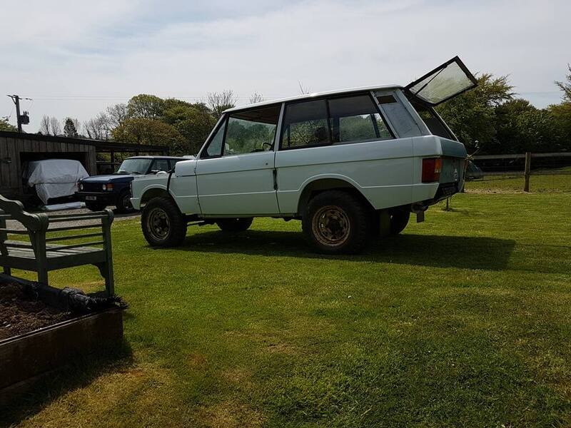

fitted bargain new old stock rear light units that I sniped on ebay 3 years ago. these really are things of beauty and wonderment.
fitted refurbed front sidelight/indicator units
then fitted up all the column controls and the heater unit, now that the gearbox surround is in place - naturally now that I have fitted it I found the original, more or less exactly where I left it. never mind eh

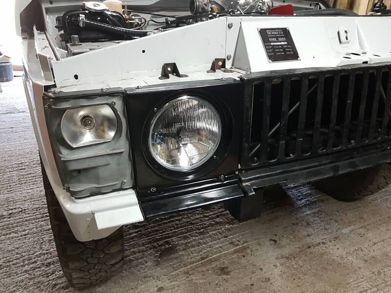

Fitted up new headlight units, original plan to use LUCAS used old stock sealed beam units was abandoned after both of them smoked out. the seal between glass and bowl must have failed. damn. Had these WIPAC units on the shelf. they have the pilot/side light installed as well which is not original but I quite like the 4 light sidelights. Plus standard 3 spade H4 halogen bulbs. Easily reversible.

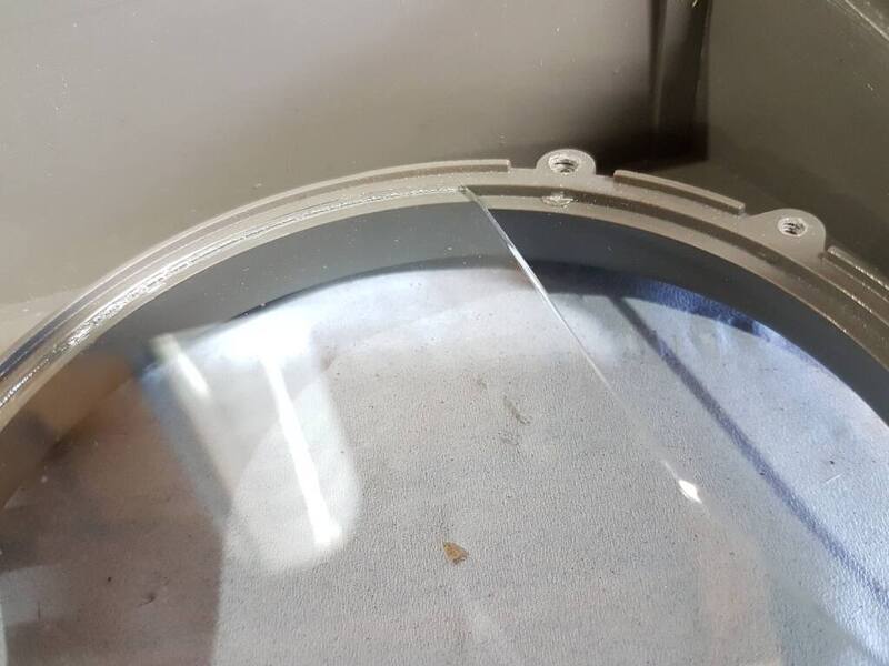

its a shame the lucas sealed beams had gone to air, I suspect that that the Sealed beams lamps failed because of air leaking in via the electrical contacts at the rear of the bulb, possibly from corrosion from sitting in a damp shed or something?
the front part of a sealed beam lamp is flame sealed/melted to the rear half of the lamp during assembly :) (it is on a proper sealed beam lamp anyway!)
you can see how they sealed the electrical connections through the glass in this drawing here :)
"Pale pink is the nitrogen argon atmosphere on the inside. Light blue is the air on the outside. Grey is the borosilicate glass bulb wall. Orange are the Iron-Nickel Cobalt alloy "cup" seals, blue is the internal lead-ins, red is the external lead-ins and dark grey is silver solder."
its the "Cup seals" that are the "weak spot" on a sealed beam lamp.
hopefully this makes sense! :)

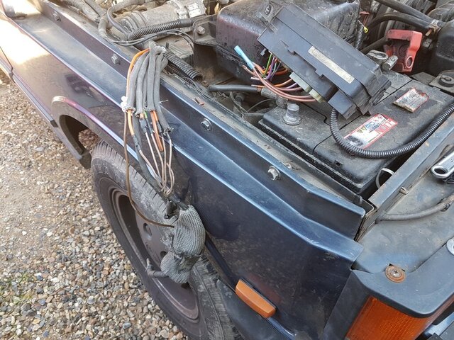

in other news the daily 1993 Vogue has been desperate for attention.
First up, back in March a number of weird electric issues manifested themselves upon making the car slightly less reliable.

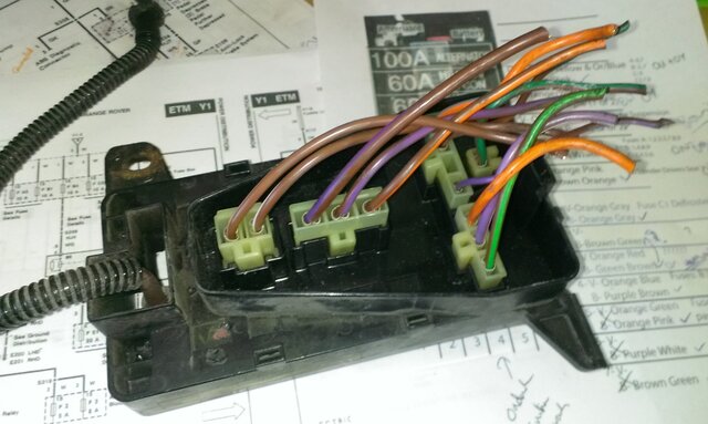

On these newer Classic Range Rovers all electric connections from the battery are on Orange wires, they all go through fusible links which are connected via crimps and then bundled up between the battery and the header tank.
Here they all are disconnected from the battery in the mesh sock

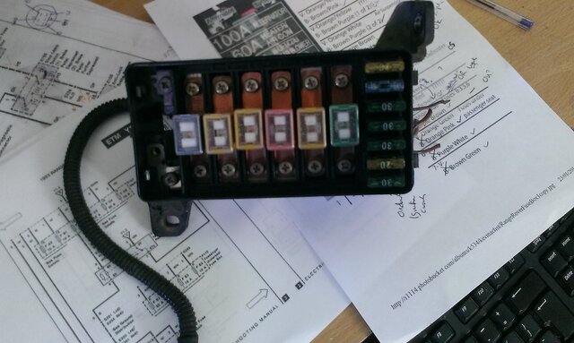

Later softdash classics and disco2 cars have a nice plastic box with screw in fusible links. so I bought one
making sure that it had the connectors and some wire for me to play with
then I cross referenced what each of the orange feeds did on my car with the new fusebox, simples eh.
Then I chomped the loom off, dumped the old fusible sock mess and spliced in the new unit. Since then the electrics have improved in reliability but I may have a sticky relay for the starter solenoid.

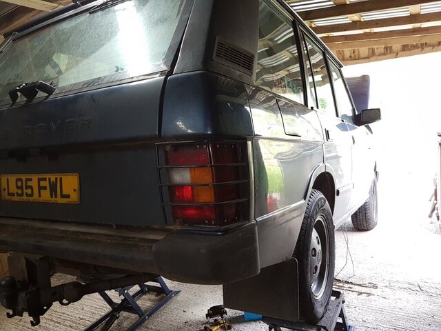

Then last Tuesday I nipped down to South Molton in Devonshite for supplies etc. one part of the trip involves a 33% hill, yep a steep un. I was descending met a car coming up and stopped without drama but it was pretty aggressive braking. Short while later the brake warning light came on, I stopped, check the fluid level which was a little low. switched off and restarted and all appeared ok. Carried on into town. on the return trip light came on again, gah followed by abs light , only had 2 miles to go and the brakes were still working so I drove to base and found the brake chassis line had burst!!!
I will do a youtube video with much expletive but end result was every steel brake line being replaced with kunifer, and three out of the four calipers being rebuilt.
CJAutos Hydraulic ramps make light work of getting 2 tons of arse end into the air.
once up access to chassis lines is dead easy, no dramas except for finding the fragility of the existing steel plastic coated brake lines, even where they showed no sign of corrosion they could be snapped with very little Yuri Geller action! hence replacing the whole lot.

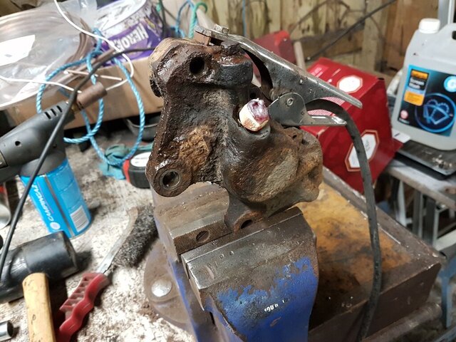

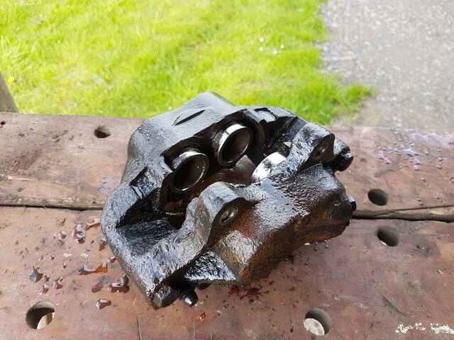

one rear caliper was fine, the other had a small challenge with the brake line ferrule

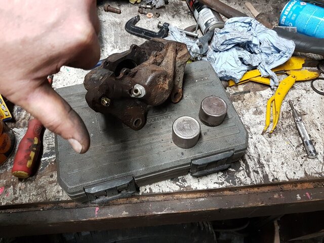

all manner of heat etc were tried to no avail, with nowt to loose it went cherry red
did come out but pistons were so badly corroded it would only need new seals and pistons
fronts were not much better
anyone who has done the fronts will know what an utter ballsache one metal dust seal is like behind the brake line feeds. (bottom left piston on the piccy below)
I made up this handy tool to make the job 1000% easier having destroyed 6 of then metal dust seal retailers on one flippin piston

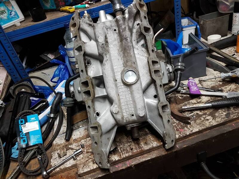

New core plug fitted to the under side of the inlet manifold. the old one wasn't too bad and a standard 38mm size iirc. the two upper plugs were a disaster zone. Looked up part number, two available, one unobtainium and one available so I ordered without checking. Delivered a couple of days later and completely the wrong size. Land Rover / BL / Austin Rover in their wisdom appear to have been recycling bastard part numbers!!!
Measured crumpled, rusty, distorted old plug and came to 1  1/4 (31.75mm) or 32mm. Found a specialist and thought I had ordered a pair of each. alas a couple of days later and maybe beer but I had only ordered 32mm which predictably was .25mm too big

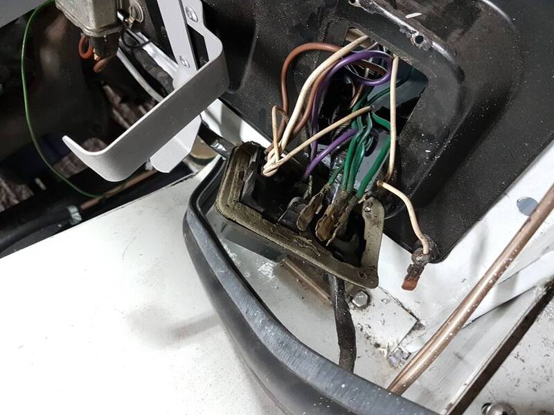

in durr kators packed up, turned out to be high resistance with a spade in the fuse box, so ripped it apart and unravelled all manner of bodgery which has been unbodged and indicator operation resumed

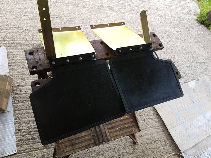

fitted rear mud flaps, which are real nice but somewhat irritatingly do not come with the bracket that secures them to the rear outer wing

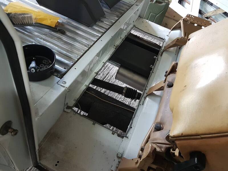

fitted rear floor section up

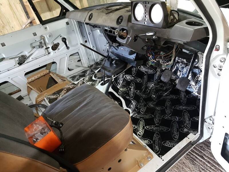

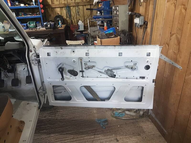

Ripped apart the drivers door to sort lock issue, looks dramatic but maybe 15 mins to remove glass n stuff. 2 hours to get locks how I feel they should be
Sorted the front drivers wing which was leaning in too far at the front edge which meant that the indicator, headlight pods squeezed the centre gorilla too much.
Must say for an out of the box brand new outer wing from Jaguar LandRover this fucking thing has required a lot of fettling
Dynamatted up the front end, if you have never used this stuff before I maybe can be persuaded to send you a square inch or so. It is amazing as it cuts out panel drumming and heat insulates, I love it

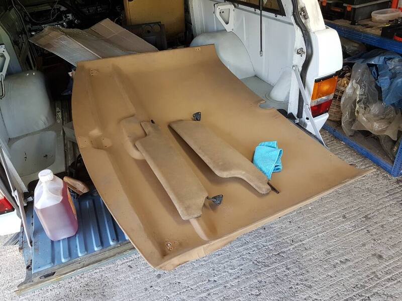

Retrieved the old OE headlining from the store, this is it pre TFR treatment
This is it installed, not perfect, especially at the back end BUT I want to reinstall some patina, history and charm back into the interior. Brand new seats are going in, a mix of new and old floor matting and all original dash. Hope I will achieve a well loved, lived in and patinated interior
Hold on, there is more.....

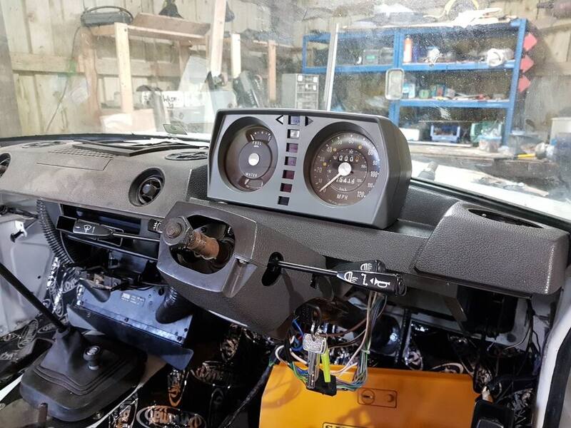

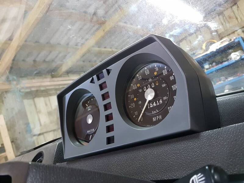

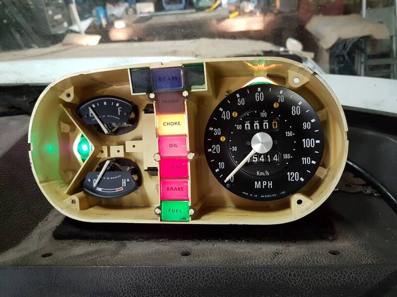

dash pod next, checked all bulbs
Fitted a new front panel around the instruments which is nice to have reproduced but fucking flaw in the moulding caused the glass to crack.
Que angry call to supplier
End result though looks fine, even though I am not entirely happy with the gap between the front and rear covers of the pod

correct 1 1/4 plugs fitted to the top of the inlet manifold, cooling system topped up and sealed so I went for a drive up and down the paddock.

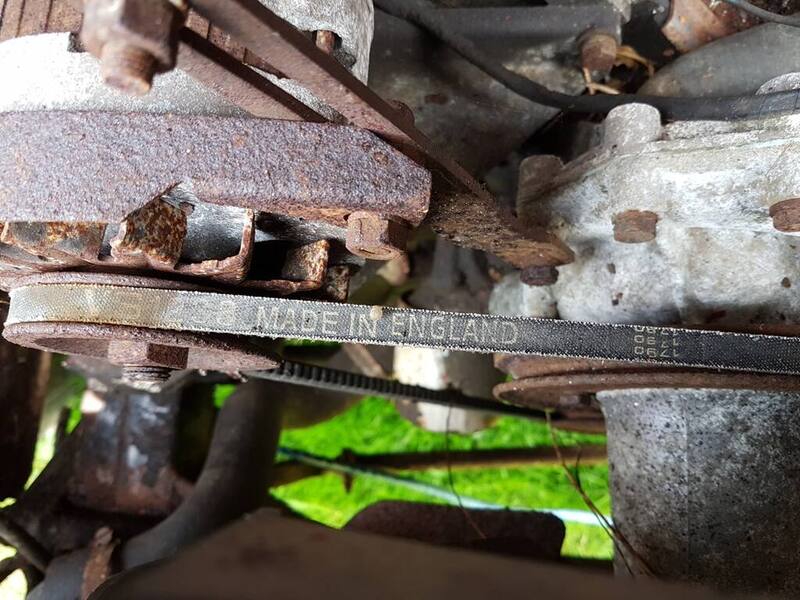

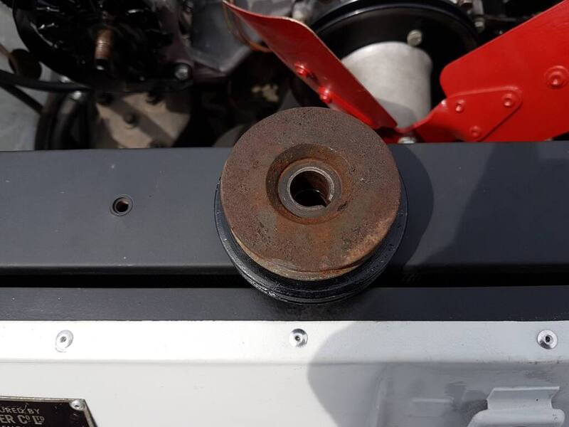

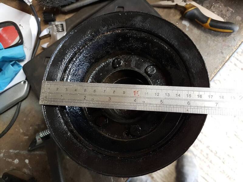

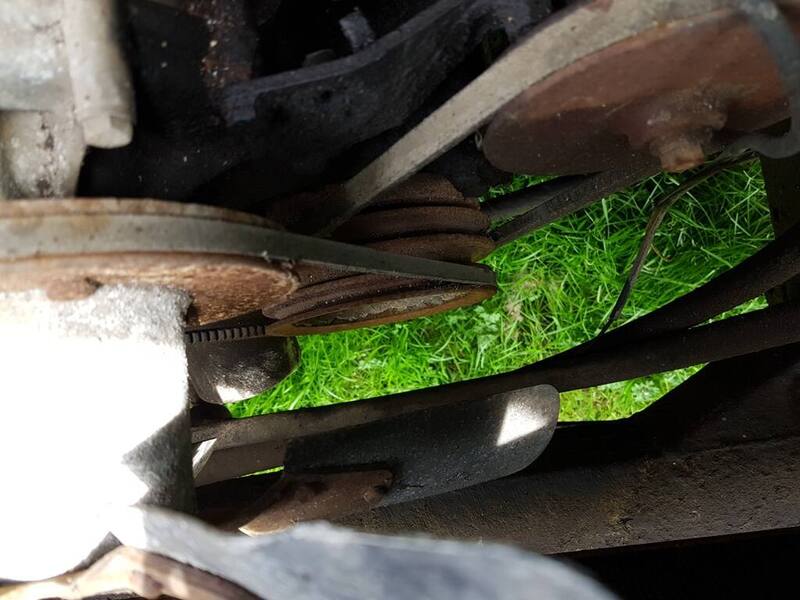

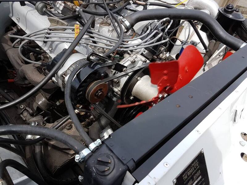

Drive accessory belts next. I have the wrong front pulley fitted to the engine. Outer pulley for waterpump is too big, inner pulley for PAS is too smoll
Tried to rob one from a car in the field, the engine turns which is great news, but does still when the car it in gear with handbrake on = destroyed clutch plate probably. so it stayed where it was.
Note outer pulley is smoller than inner pulley! on right is PAS pulley and on Left is Waterpump

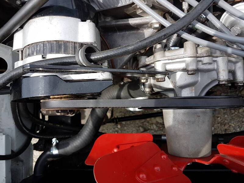

Did rob a smaller Alternator pulley which allows a standard belt to fit existing crank, waterpump and alternator
old pulley alternator is at the bottom of this stack,
fitted it and tried it out, alternator still pushes 13.7v at idle so happy days. Pulley now in queue for powder coat. Care is needed to avoid the red blurr at the front of the running engine if a bigger red blurr is to be avoided. Note there is a fan cowl that surrounds it but access to belts etc is more difficult. Elf n' Safty
Alas new pulley means that Alternator is now on the piss to the waterpump. fixed using washers etc
PAS belt is somewhat more of a challenge, this is the adjustment arm for the PAS pump, the slot needs to be 2cm longer for the standard RR belt to fit the standard RR pump and nonstandard RR crank pulley. I am currently seeking out the correct crank pulley

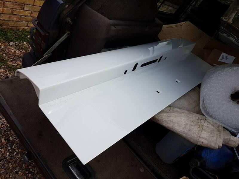

In other news, tailgate has paint! fuck yeah :D
Fitting this on Tuesday when I relocate back to Devonshite

2 hours ago, colnerov said:
 Hi, "Destroyed clutch plate?"  It might be the transfer box is in neutral.?
 Oh, and they're not washers, they're shims.?
 Colin
did check transfer box lever in high and low, unless someone has robbed the diff out of it, I didnt check that!
And yes indeed shims. Love it?
Dads car has the same bracket but with two bends on it. and shims also. I went for shims between alternator and bracket and then bracket and water pump. Looks like it should have always been like that.

Today however much ballsache. Engine now balanced and running, however blowing oil on overrun - Valve stems and ticking like a bastard 2 or so hydraulic lifters are not working.
Going to get a quality set of lifters and investigate oil stem seal which iirc this head cannot accommodate. so valve stems are too worn. gah
I do have a fresh set of heads ready to drop on, just 1/2 days work to strip down the top end, replace gaskets and reassemble.
Pics and diagnosis to follow this weekend. MoT has been pushed back to next week
