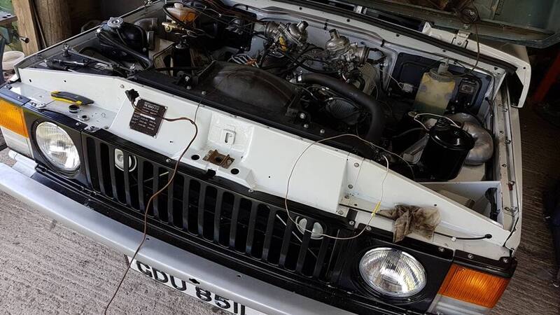

Firstly engine oil burning issues were down to a blocked breather pipe on the RH head! such a silly problem with such a massive impact. Sleeping on it helped me find the problem next day with zero dismantlage and more importantly zero expense.

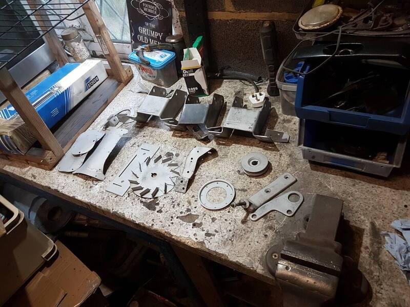

Barely a week ago I was at home, blasting stuff clean, getting busy with the wire brush on the angle grinder.
Here is why I do wear a carbon filter mask when doing this sort of shit
Results were good, next up was satin black powder coat

This is the pipe that caused me so much bother, looks fine here but when the air filter is installed it is kinked.

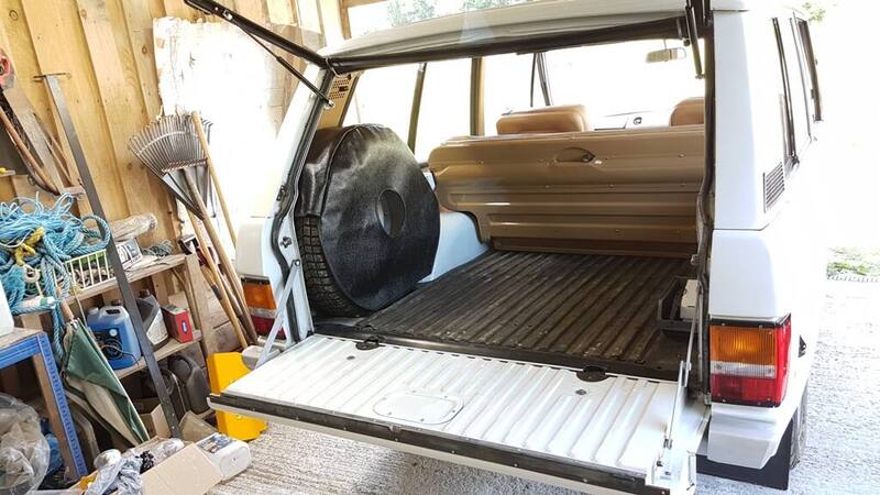

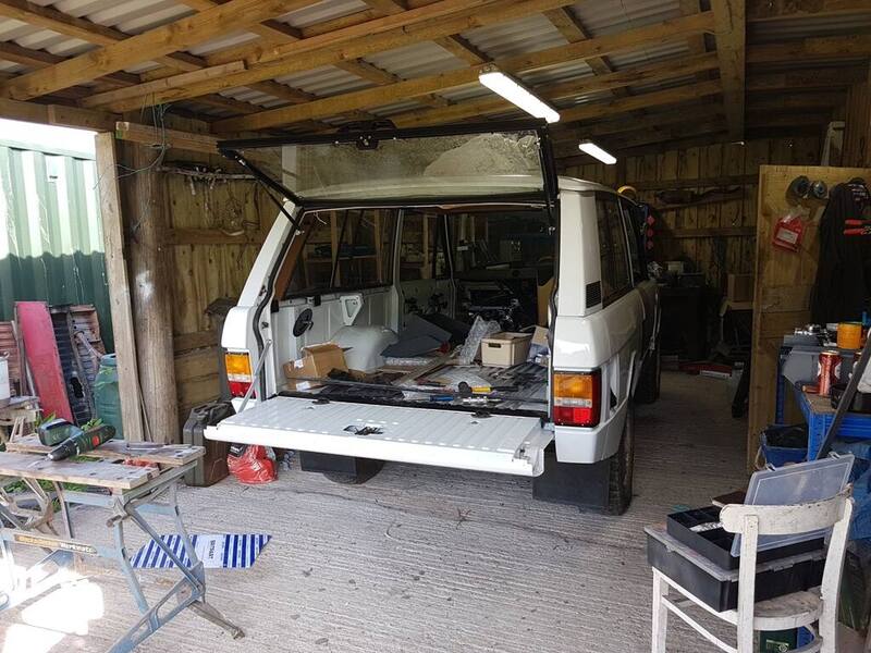

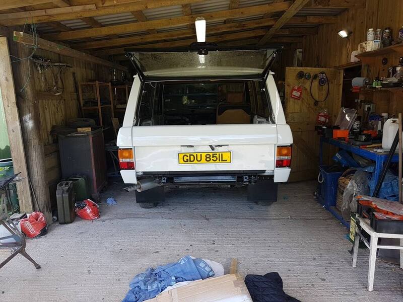

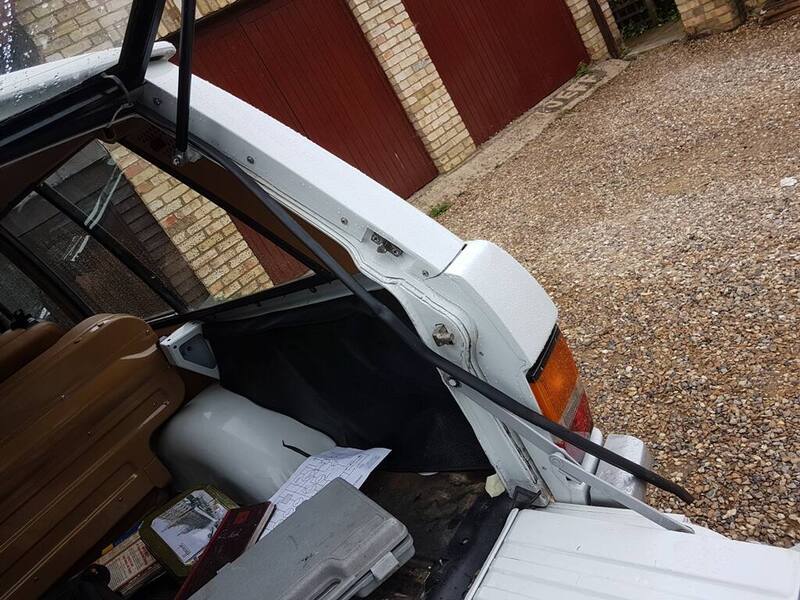

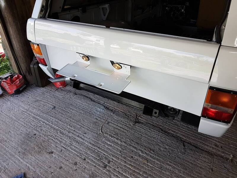

Tailgates fitted beautifully. more issues were to follow here, because the tailgates are 2mm too close

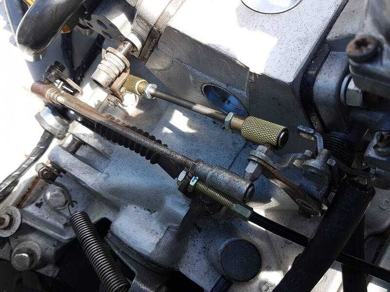

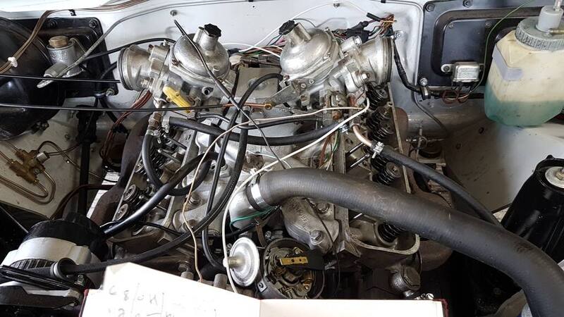

finally got the 3/16 threaded rod so I could link up the carbs correctly. Did a massive choon up and got the carbs and engine running sweet. It was at around this point that I noticed the buring oil in the exhaust

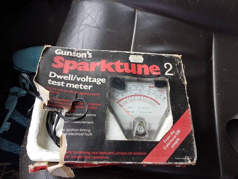

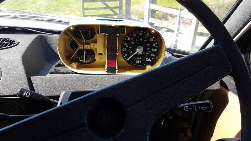

This was one I borrowed from one of the projects. electrics are good on this but the vacuum switch is fubar. made one good switch out of the two

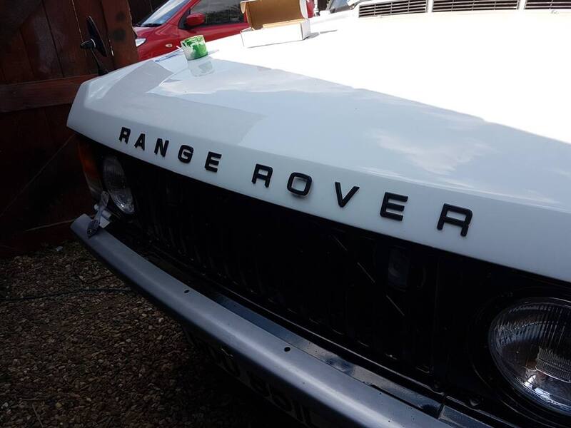

Nice 3d number plates arrived, super quick. Very pleased with these. Makes a massive change from the horrible trend of pressed aluminium plates on everything!
Wired up the number plate lights, the caps are in queue for powder coating tomorrow
I think this looks the bollocks, re powder coated bumpers are being picked up Tuesday, back end will be finished then

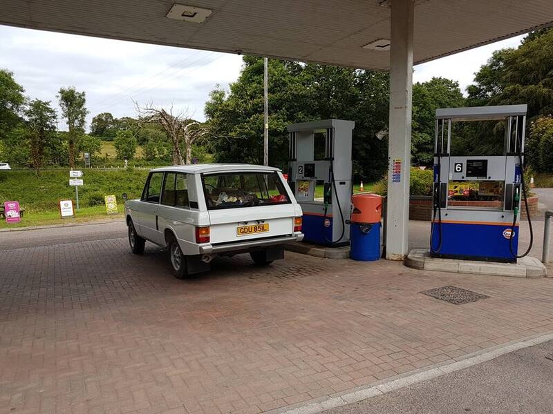

Having fixed the oil burning issue drove up and down the field but could only get into 3rd gear even with low ratio selected. Might have been for a whizz around the block. Transmission is silky for an LT95 which is agricultural at best.
Only issue really is that the tappets are tapping, maybe 2 hydraulic tappets have not settled. oil pressure is good. New quality set are on order but not due until Wednesday/thursday. Easy enough to fit but inlet manifold needs to come out again gah
Back on track for MoT next Friday

it was very interesting about balancing the carbs like that, how does it work with 2 carbs exactly? is it 1 carb for each cylinder bank?, if so how does it run when your only running on 1 carb, is there some sort of ducting or something that means the other bank of cylinders still gets air and petrol from the other carb?

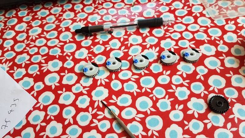

fixed rear window clips, the clips that hold the sliders in place are unobtainium but did manage to sort it using my bench shear and some brake pad antisqueel shims

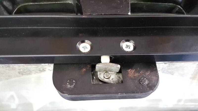

MoT needs all doors, and tailgates to open and secure properly! top tailgate was cause of much swearing until I resorted to butchery of the utterly useless brand new seal
top tailgate catch y-tho etc

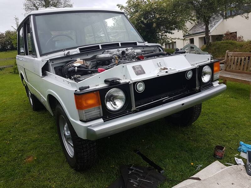

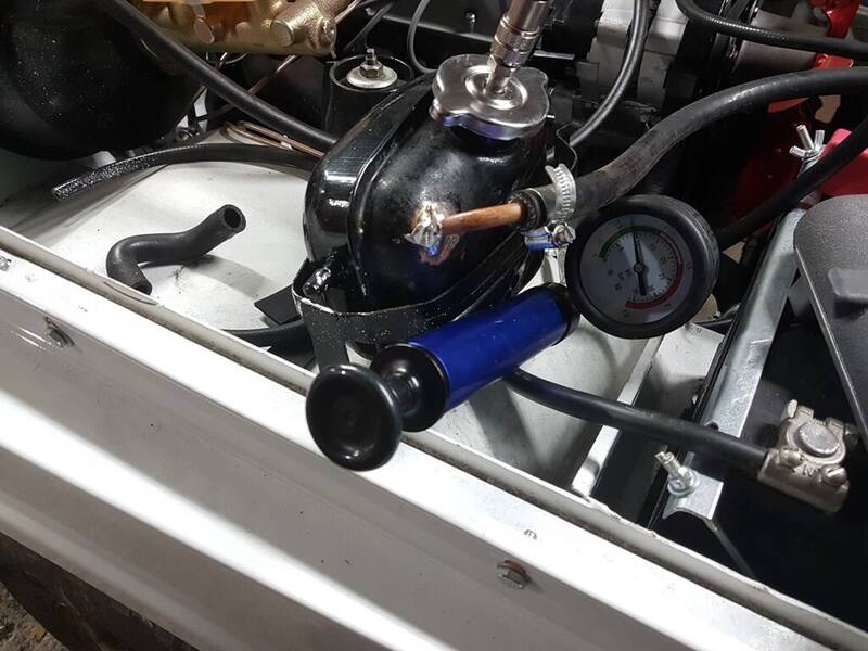

Cooling system now pressurises that I have replaced the expansion tank pipe that had worked loose. Glad I powdercoated it
Powdercoated rimz and bumbers looking smart
Pas belt arrived and the system was bled through, works and doesn't leak

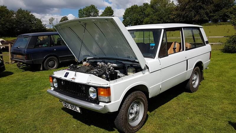

Blue bonnet refitted for trip down to garage
first drive, one tappet still resolutely clattering away, alas check over found a dozen or so issues that would stand in way of Mr MoT. So I delayed it by a couple of days

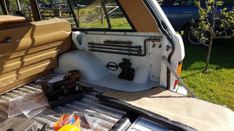

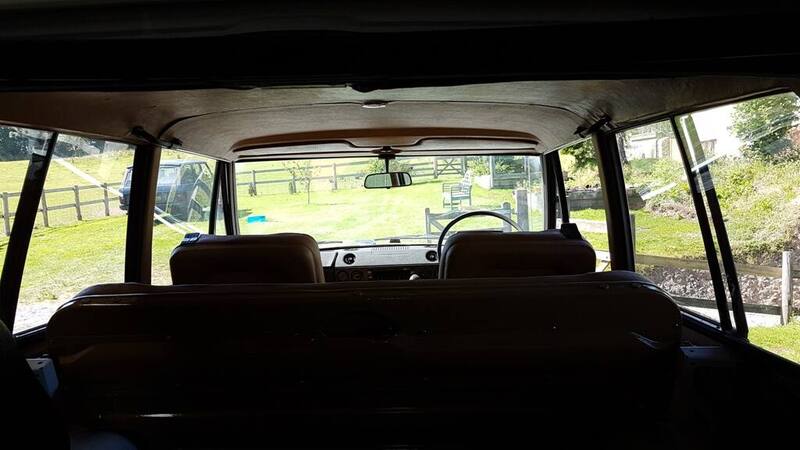

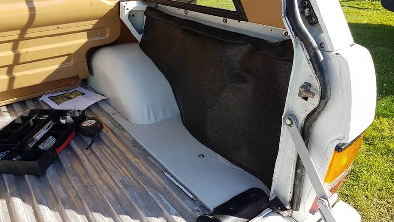

Rear seat was fitted to avoid an advisory (whatever they are called now) that no rear seat was fitted.

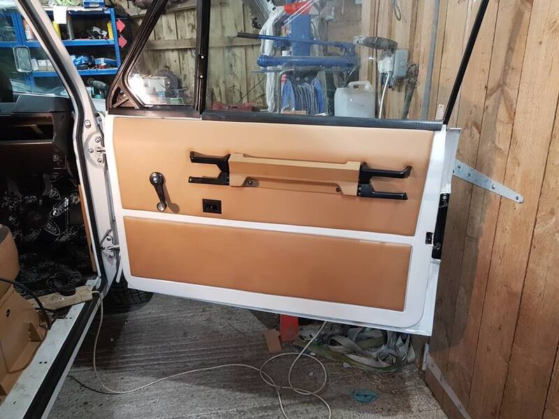

This is the retrim done by Nationwide trim. i am not happy about the metal surround on the seat back, grit blasting it has exposed way more rust pits than I anticipated. Seat fabric is fooking beautiful though
Had time to spare to trimmed up both doors which now "ker-lunk" closed

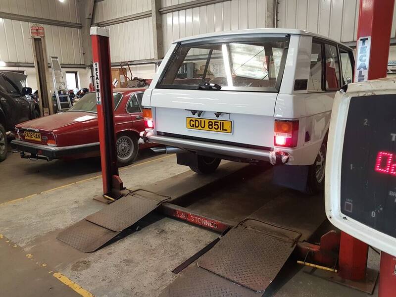

Nervously waited and MoT was issued! Fuck yeah
Interestingly I tried to take it off SORN just prior to MoT and computer said MOT was needed despite Historic status. This I think is because last MOT was 2010ish

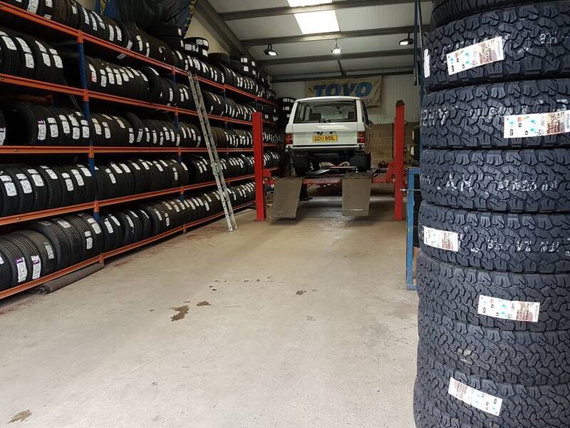

Trip up to get tracking sorted

two carbs feed into a single open void that services all 8 inlet ports. typically each carb would service 2 cylinders on each bank. at least that is how the staag works.
With only one carb connected it is running weaker than it should so would be utterly gutless on the road.
For balancing you want each carb to draw exactly the same amount of air, that is what that tool is doing for me. You need to juggle this activity with getting the mixture right on both carbs, I use a CO meter usually but lifting the damper and listening gets it close.
Whatever I had it bang on I reckon because on a 25% hill in reverse gear and low range it crawled up backwards at idle. I will do a better video on chooning two stroms, people think it is a ballsache and end up lobbing fixed jet webbers on that are not jetted right and have all manner of PCV issues associated with them

Stroms are perfect on low compression 8.13:1 v8 and I know how to make them work. If I had higher compression then yes SU HIF4/6 would be the way to go, I have two sets rebuilt and ready.

very interesting stuff on the carb front thanks for explaining it :)
so its effectively 2 carbs in parallel rather than 2 totally independent carbs?

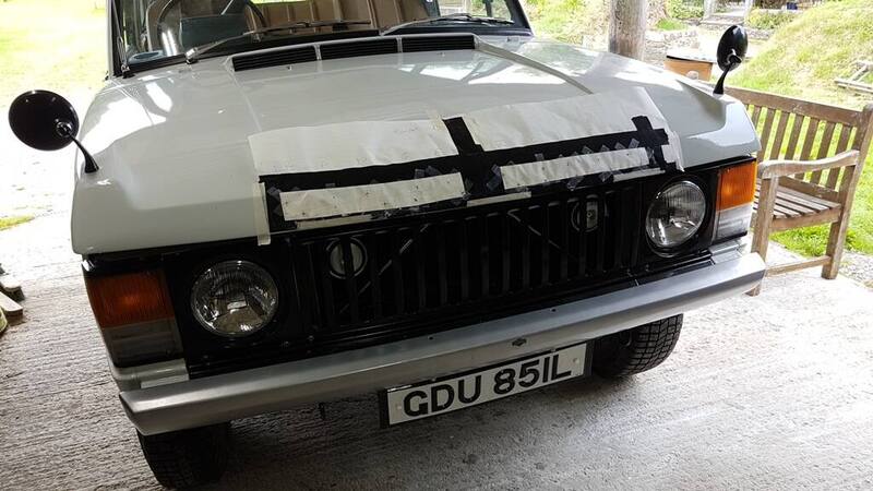

That green bonnet is next, teasingly rust free

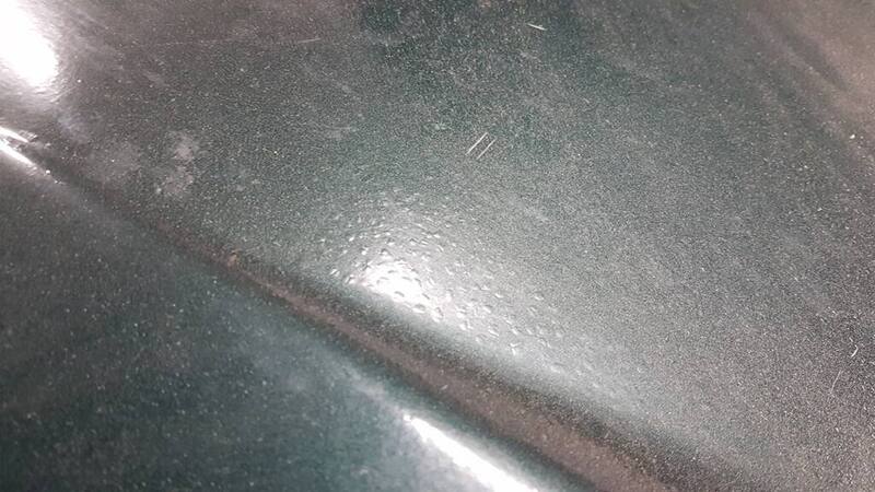

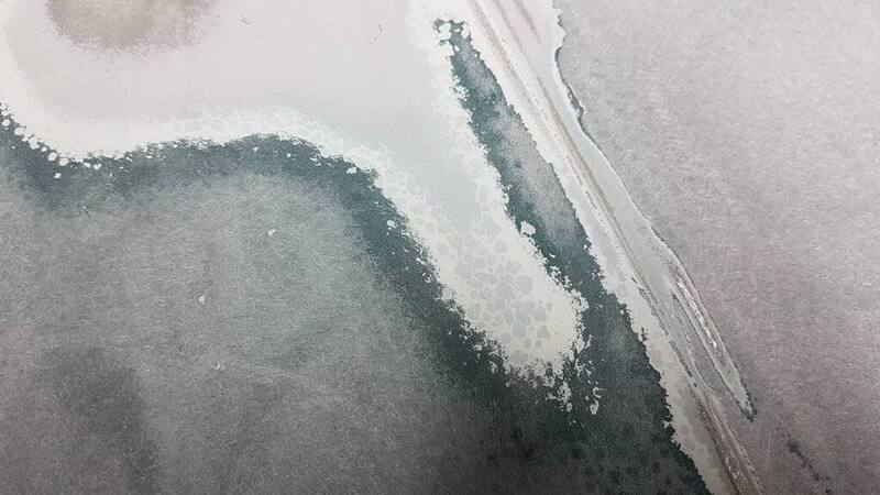

but struggling with an interesting paint issue
test sanding found that the issue went down to the primer

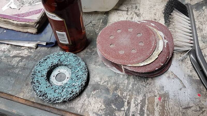

the paint was clogging the random orbital sander, so dusted off the top mm or so of paint with the prep wheel. The paint was blistering as I was doing this and I was very careful to avoid any heat in the panel
nearly 5 hours later
and some spent discs :D

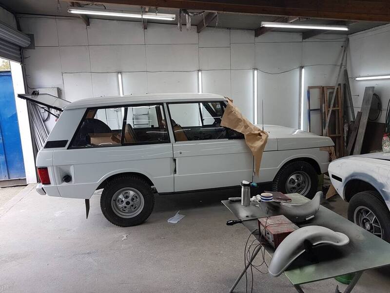

found a better back seat back than the one I have fitted. Had to weld up some self tapper holes for later carpet fit, flat it back and
prime it, then flat it back, and fill it and prime it again. Not getting it perfect, it needs some patina but not so it looks orible. And yes that is a saw bench
Painted I am very very happy with it. not bad for me, out of the gun

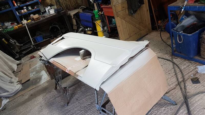

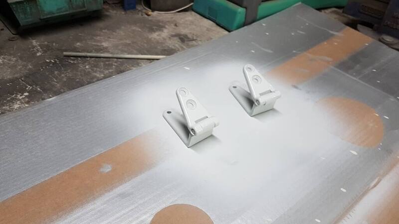

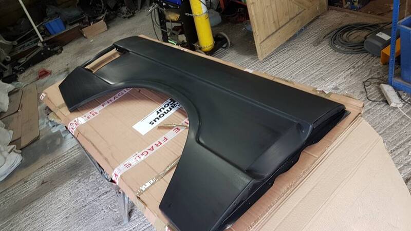

new back wing was supplied with very nice etch primer. note not all black coverings are etch! some might as well be cheese. This stuff was good
filler primer went on too phat which meant that I spent an hour flatting it back next day

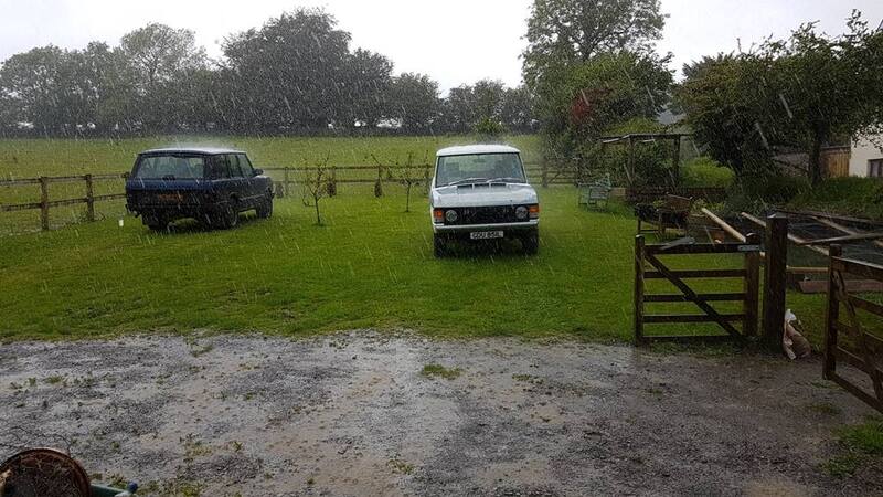

then it rained... A lot

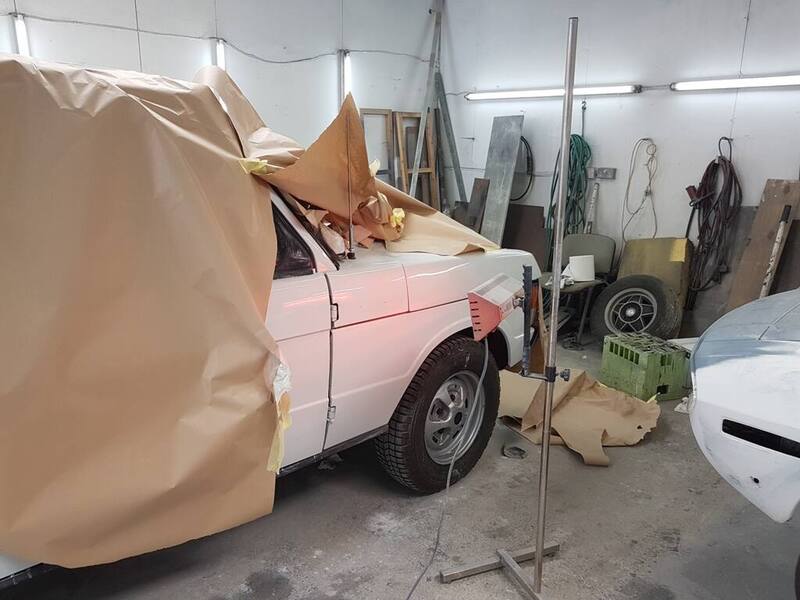

managed to find time though to lay paint on the rear wing, which is 99% but has three fish eyes. Paintjob guru chap told me not to worry, he will sort it when he polishes and details the car end of this month

Also prepped and fucked up the paint on the new drivers side rear wing, took a lot of flatting back and polishing but it is a lot closer than it was. here it is before I messed up the paint. Modesty prevents me from showing you what a bunged up air jet on a paint gun does. Now I check gun works properly with thinners and then with paint onto cardboard before going near a panel

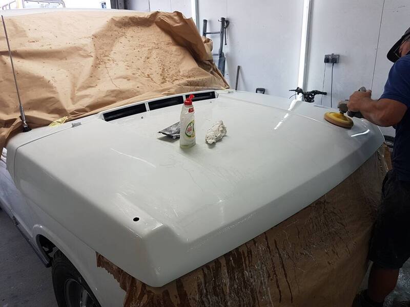

Before that ^ could happen bonnet needed painting and interior installing. Hence me chasing my arse around

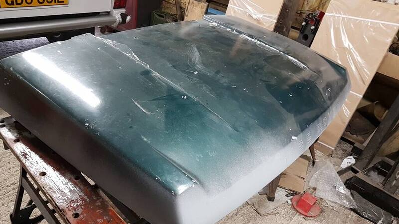

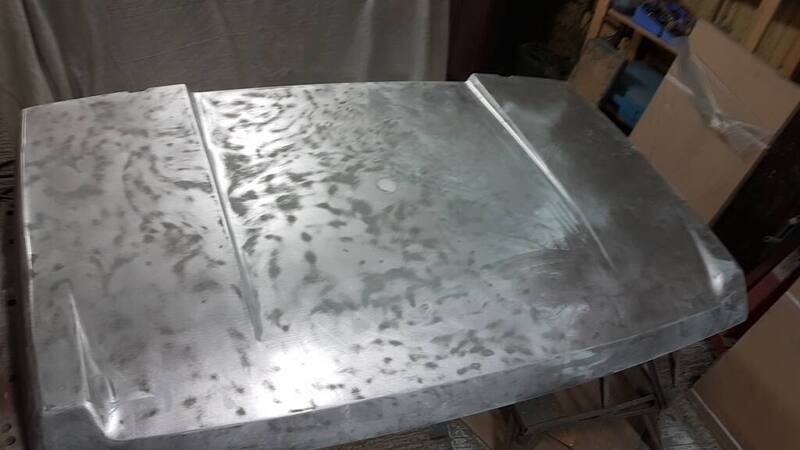

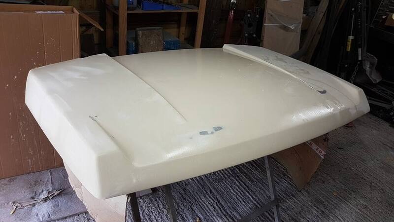

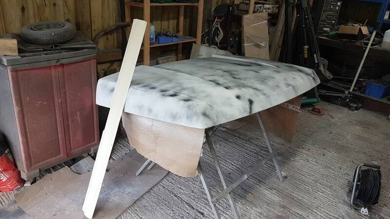

Bonnet was stripped back - you know that already

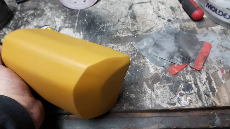

Is covered with dents, some from pressing, the only way to move forwards was to lob 1litre of 1k etch filler primer, flat it, fill it, guide coat it, flat it, fill it, flat it etc etc
guide coat was rattle can satin black, cheap n cheerful, helped me ID all the dents, filled them
Blocked them back on an evil humid arse of a morning, saturday 29 June 2 days to go!
Horrible job but got it done,let the primer set over night and it pickled in a couple of places! FUCK! Flatted those areas back to steel
Used a 2k acrylic filler primer to seal the 1k etch primer

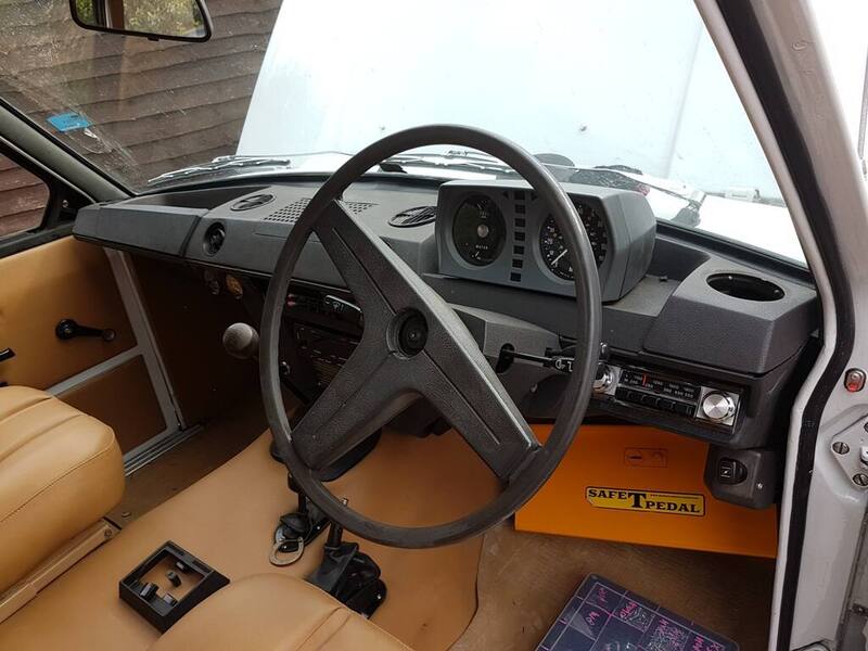

In between all this, interior is being installed
Bumper corners were painted along with other bits,

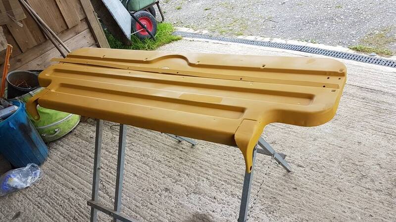

New gearbox cover was installed, from Nationwide trim, this is marvellous, fit like a glove
Seats in, small issue with the runners being a lot sticky. working on that

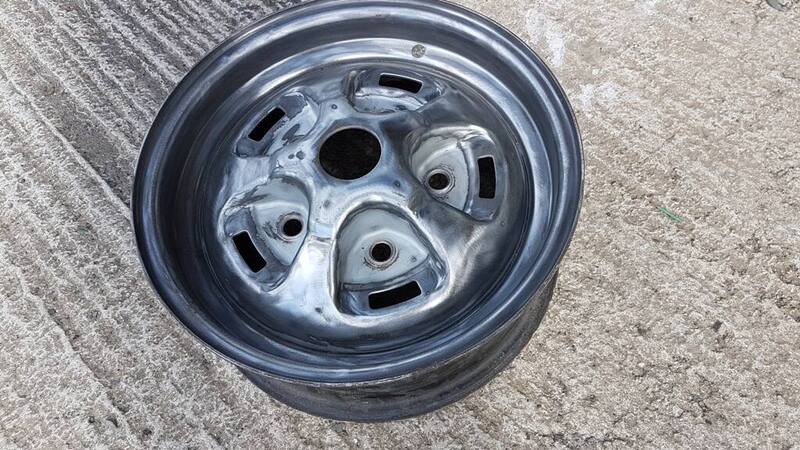

stripped the spare wheel back for paint, me ears is still ringing

Monday evening finished shovelling a 2k top coat onto the panel. big bastard flies landing on it and stuff! but fuckit ok for the photographer. still needs a world of work though
Bonnet fitted on Tuesday morning d-day. slammed it shut and couldn't open it again! after fiddling with a spanner I managed to detach the plunger from the bonnet. Removed the grill and got around to adjusting everything. Photographer arrived and I was up to my neck in bonnets. delayed by 45 mins the chap had better humour than I did.
Because of the bonnet shenanigans, I missed the chance to replace the shonky rear bumper and also install the sill covers. I am still annoyed about that but shit happens
Made it though... and breathe 2.... 3..... 4......
location was up on Exmoor past Simonsbath. Wales is in the background here

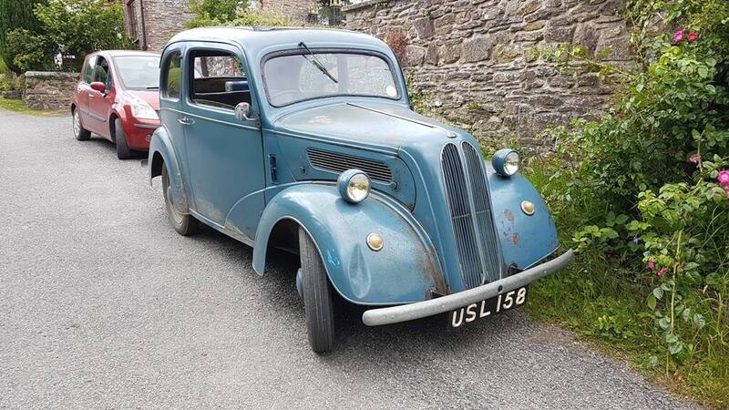

(whats the Ford about? please tell me its one of yours? :mrgreen: )

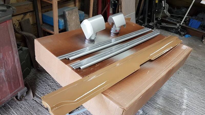

Fix up the tools, which still need paint, or cleaning, or nothing
and the cover which was a ballsache trying to work out how to install

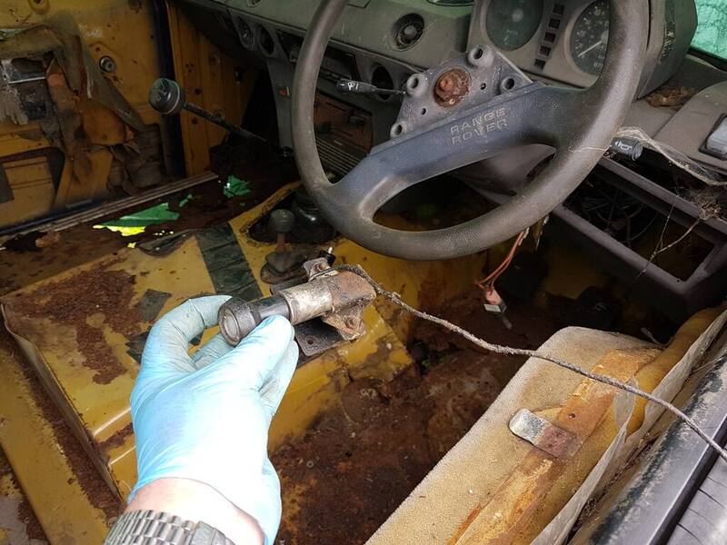

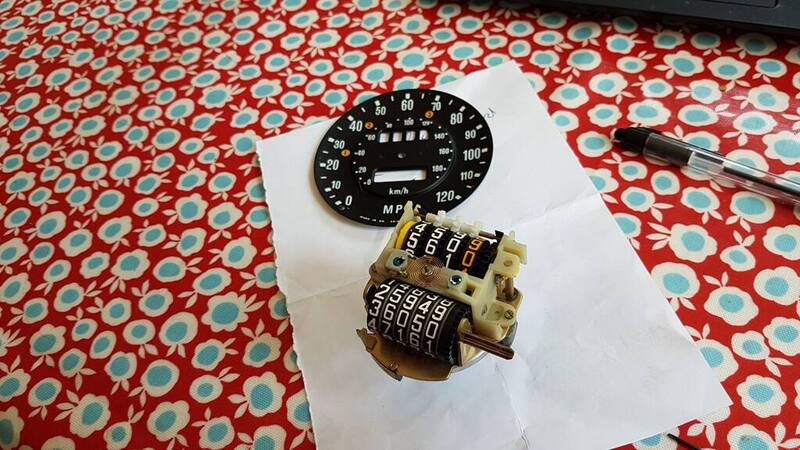

One issue that occured on the photoshoot was that the speedo started to click and read anything from 0-70mph constantly
I had another speedo head which I swapped and it worked fine. However Mileage was different on the odometer.
Oh Lord! what have I done?
Worked though and speedo is now slightly over reading up to 60 mph
spare wheel fitted up and uber rare boot floor trim installed.
marvelled at the through the car look, before I noticed that the frigging o/s/f tyre was flat!!! arghhh

I installed the wing/bonnet mirrors also, now the speedo drive has fucked itself again

190 mile trip went well
started with a fill up, just over £85
Used a litre of water, loose hoseclip, barely any oil and drove beautifully. Estimated 17-18mpg which for a steady cruise at 60mph is horrific but that is good for one of these.

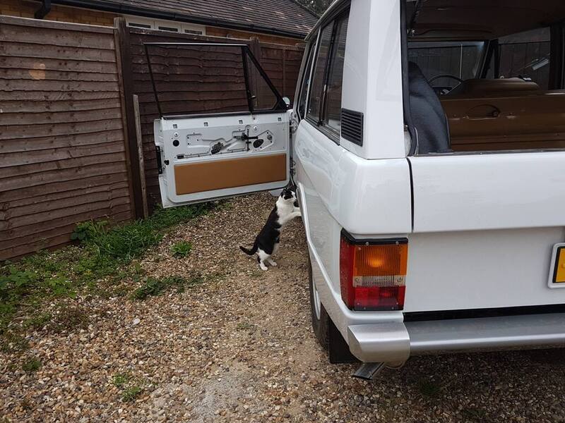

Only really issues, Mrs Thestag cannot wind the keep fit windows and both internal handles are difficult to open the doors. Oh and Prince of Darkness descended and rendered wiper park inoperative.
Replaced the bezels on the centre console instruments. BUT the clock surround is larger, stripped and powder coated it. The flippin clock works too
Then continued with door catch and window winder fixes. Passenger side was easy, the cat even came to have a nosey
Drivers side needed the door catch out of the door, there was a rod bent which once straightened out allowed the catch to work perfectly
Test drive for rattles etc found the indicators had now packed up.
Long story short the same green feed wire from the fuseboard runs to both wiper park and indicator circuits. took me an hour and a half to unravel it all and yank the old wire out of the loom.
Thursday and nearly 500miles test drive was bodyshop day to cut back the paint for polish, the bonnet that I painted came up really well
However it is a tiny shade different from the scuttle/deck panel! that'll teach me to buy paint from two suppliers
Quick bit of expertise from Steve and it is blended in and looks perfect
Cut back and polish done

Did all the welding and stuff, there were a few holes to deal with, and a pair of loose front wheel bearings and it passed
see next post...
I did have a monster clearout of container, shifted shit around and installed another rack
Back home again on Monday this week, first job up was brave trousers on and drill holes for bonnet badges. this is half way through and I know the last R is wonky, isn't any more :D

Pissed  off with the terrible quality of the boot seal and unable to find the original! I never throw anything away - so I have just not found it yet. I did find that old door seals could be trimmed to fit. After cleaning and conditioning they are on and the tailgate closes easily now. and is still water tight.
Badges are now finished on the front, looks great
