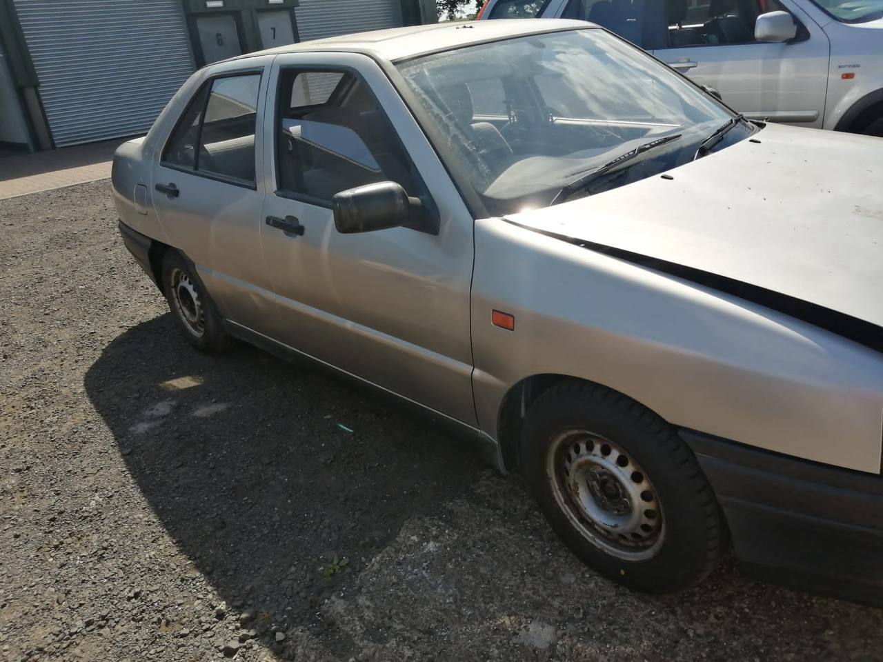

Whilst bimbling* about the Scottish countryside, the exhaust started rattling like fuck.
Great.
Got it up in the air, wheel off, and the issue was clear to see.
Both of the front mounts for the backbox were cuntfuckulated.
So much so, that the back box had been rattling off the damper. You can see the damage below..
Bit of electrical flex wrapped round so when the outer melts it'll stay held up to get you home?

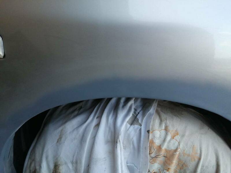

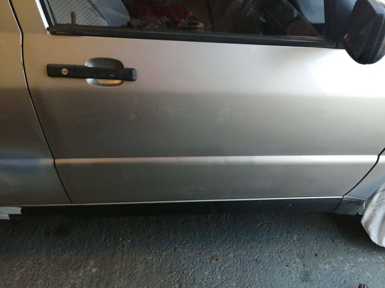

After a short* period in primer, it was decided that some actual colour should be applied to the damaged flanks of the Toledo..
Today was the day.
Initial prep was simple enough- mainly loads of sanding.
I used a 2 step process
Firstly, 240 grit on a power sander
Then followed up by 400 grit wet and dry.
Then deploy panel wipe - using an old t-shirt
IMG-20210717-WA0011.thumb.jpg.1bc956ede3f14bfab53bde2f03cf380d.jpgIMG-20210717-WA0013.thumb.jpg.c1eefaaae4ec40c1e76830bf8e27712f.jpg
this gives you a reasonable key for the first coat of primer.
IMG-20210717-WA0022.thumb.jpg.e5e53d54a070d1492f53faf407459bb8.jpgIMG-20210717-WA0023.thumb.jpg.af54d8792b66f540b77b1eaa4b093c3e.jpg
a couple of places needed a very thin skin of filler to sort out some pitting
once dried it was time for another pass with the sandpaper, panel wipe and primer
after tacking up, it was time to shoot some colour. @GingerNuttz should look away now..
First pass wasn't the greatest - trying to get used to the can and the spray pattern
It was decided that the second coat should basically they to paint the panels and blend it into the original paint.
This approach worked much more effectively
IMG-20210717-WA0030.thumb.jpg.aad6708f893feb6479f58a6fd3b1793a.jpgIMG-20210717-WA0033.thumb.jpg.2e153bf23e0b740c4c9b15f43f6676da.jpg
it still need clear coat, but it looks much better than it was previously...

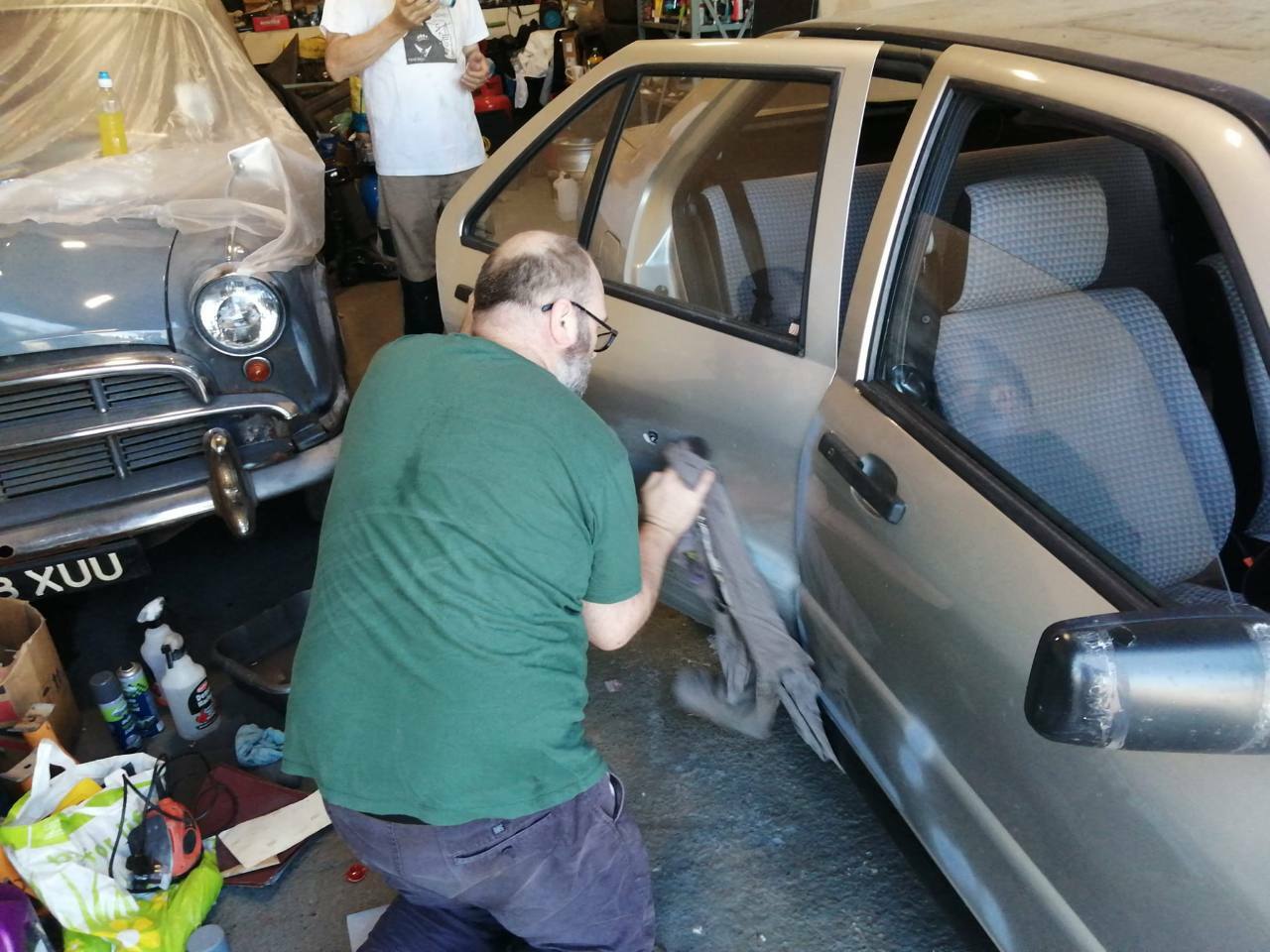

As a reward, I stripped the passenger door, removed the green mirror and gave it some body coloured paint.
Apologies for the pics, my camera ain't been the same since I welded it..

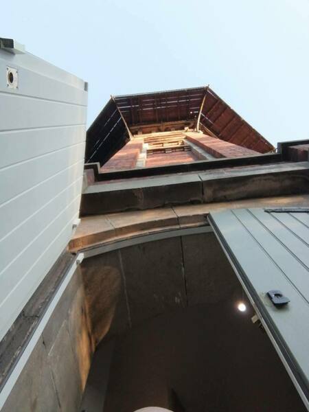

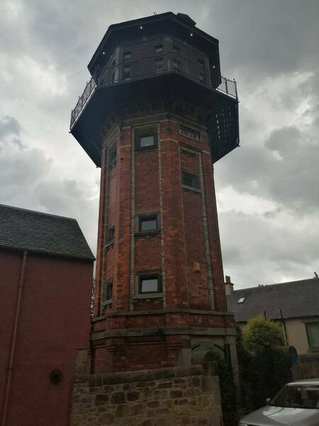

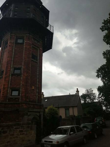

the water tower was pretty damn cool -spread over 5 storeys and with a verandah at the top floor affording tremendous views.

That water tower makes my knees ache just looking at it.
Thankfully there's a pisser on the ground floor, one in the bedroom on the 1st floor, one in the bedroom on the 2nd floor and one in the main bog on the 4th floor.
But aye, we did about 8 miles walking yesterday and still had to climb 5floors to get to the sofa..
