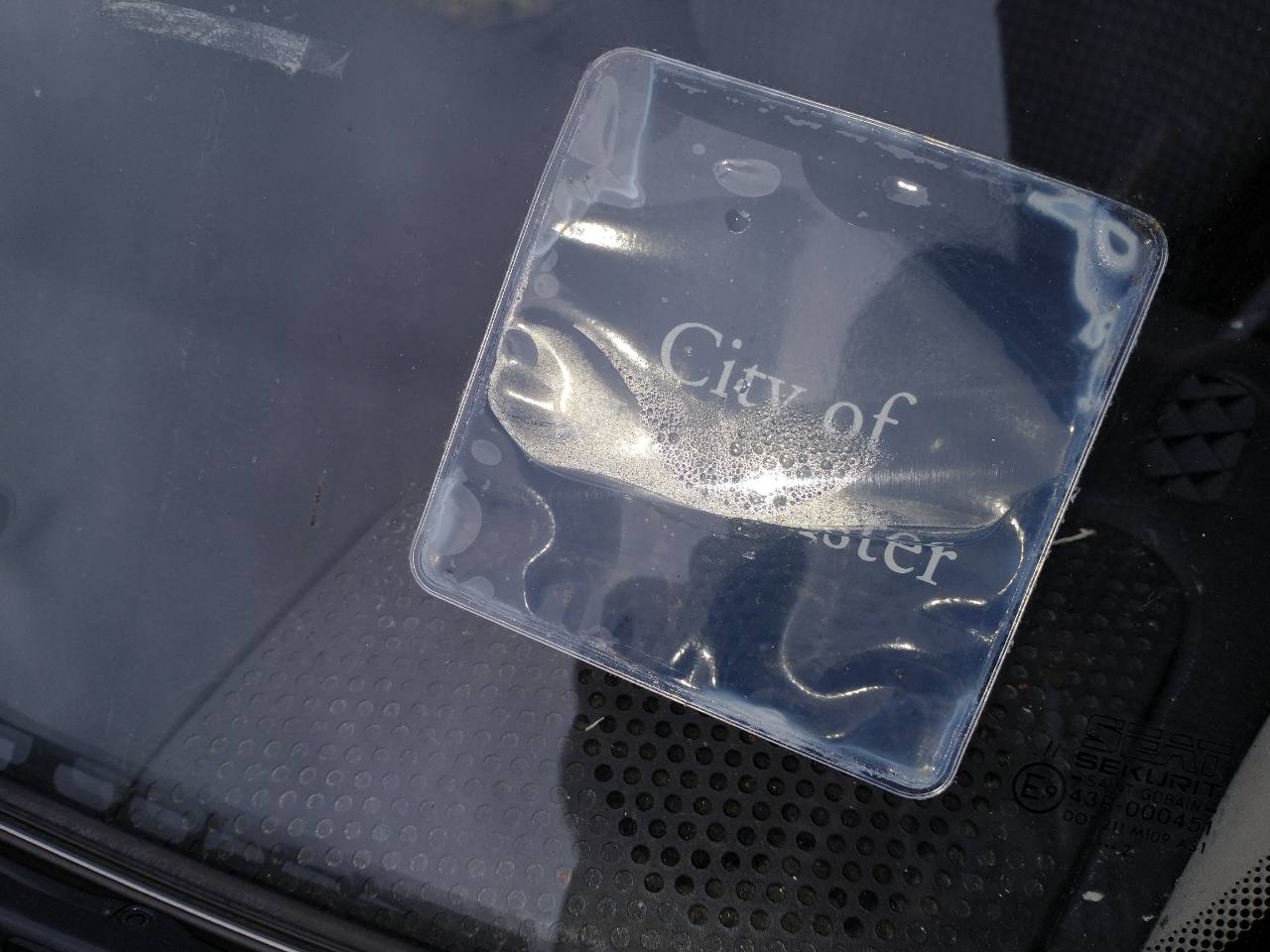

This is the old tax disc holder - plenty moisture there.

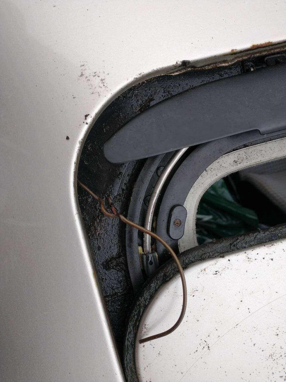

First step was to open the sunroof and check the sunroof drains were clear
The coathanger went in well, and no obvious blockages.
A pour test was conducted
IMG_20210206_135113494.thumb.jpg.79fe77bc3cc8df2d7334ec653fb6a64c.jpgIMG_20210206_135127911.thumb.jpg.501564c9a88586453853c9313939290b.jpg
both flowing freely.

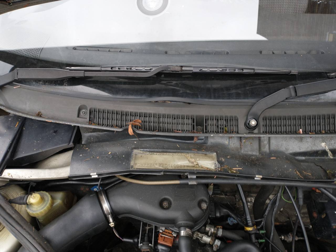

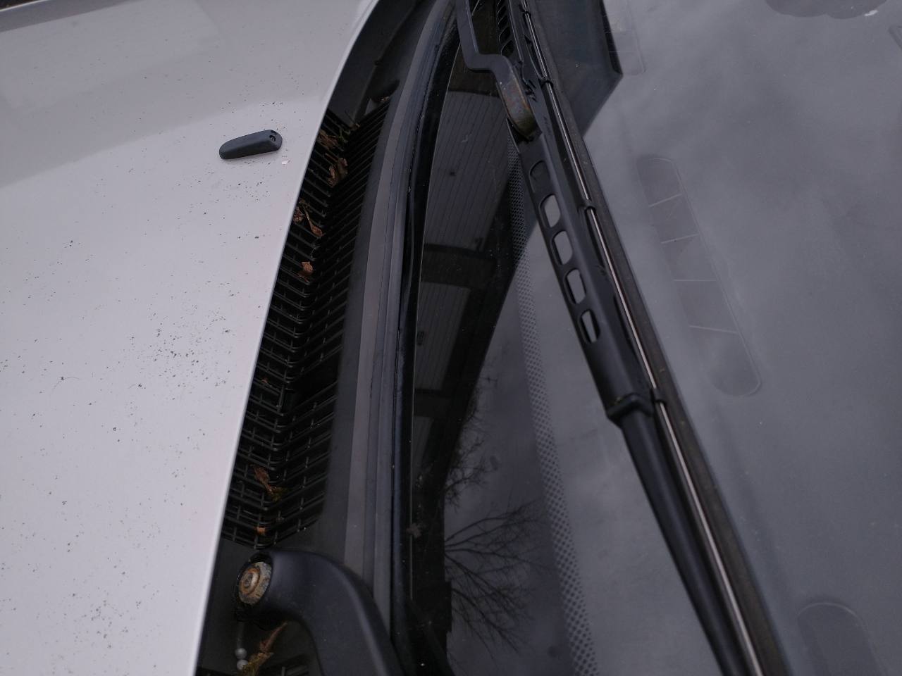

Next was a thorough cleaning of the scuttle area.
Wipers had to come off, and the world's worst plastic liner was removed. Seriously, biscuit selection box plastic would be an upgrade. It belies it's #heritage as it's a very similar panel on the MK1 golf cab we have.
I even took off the wipers - meaning the hard plastic scuttle trim could come off too.IMG_20210206_133747627.thumb.jpg.72b809a9ad4b6723de989484f2ea4b50.jpgIMG_20210206_133750998.thumb.jpg.e0e3d0c0259c485d1b5240705d4c17f0.jpg
There was a fair amount of detritus under the covers, which the wet vac made light work of
then installation was the reverse of removal. Unfortunately, the hard trim is snapped, and therefore doesn't sit correctly.
Although this may look like an issue, the screen is bonded in, so any water will just run down into the scuttle. I will attempt to solve it properly at some point.

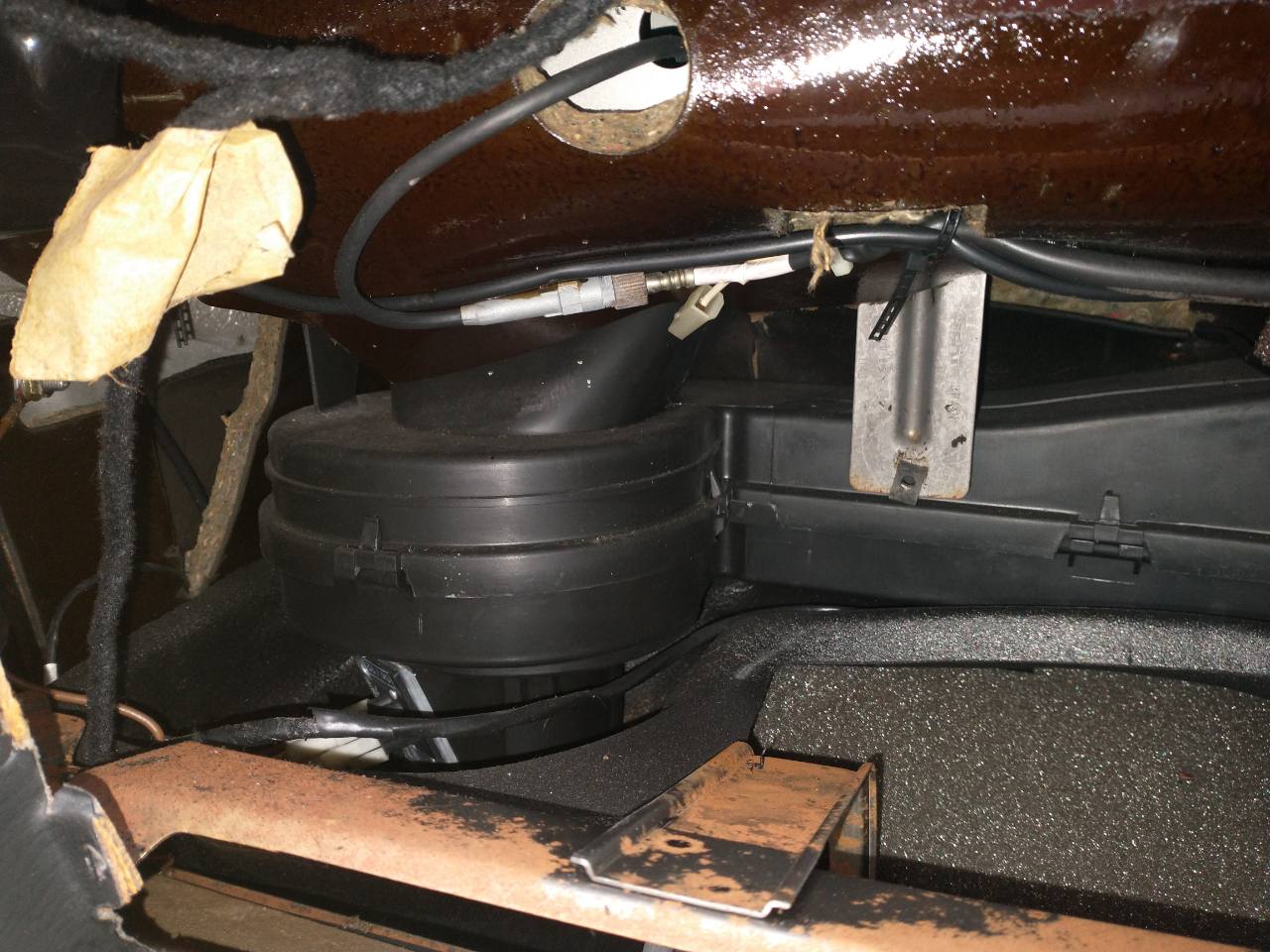

The penultimate thing to do was to have a look at the blower motor - it sometimes screams like mad, so I had hoped to try and get into it to apply some lube to the spindle..
Yeah, nah. That's not happening today.

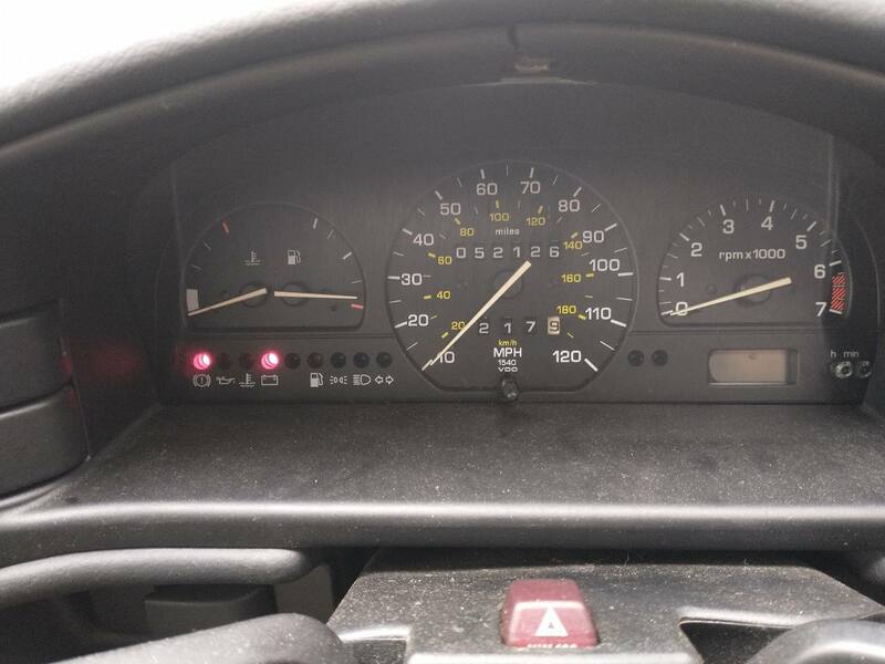

Bored today in the house so decided to solve the biggest ever issue on the car.. a non functional temp gauge..

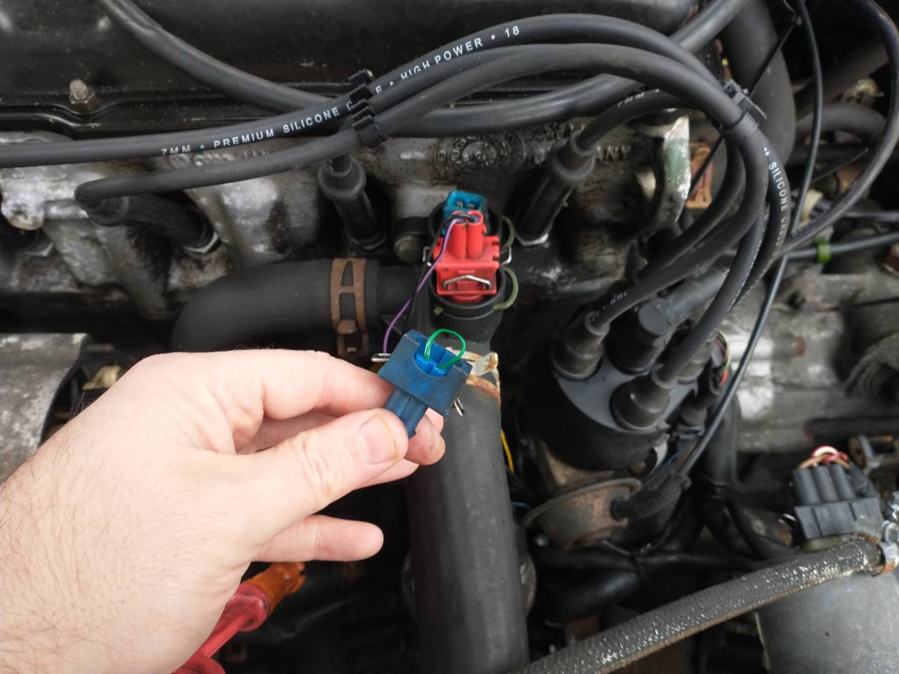

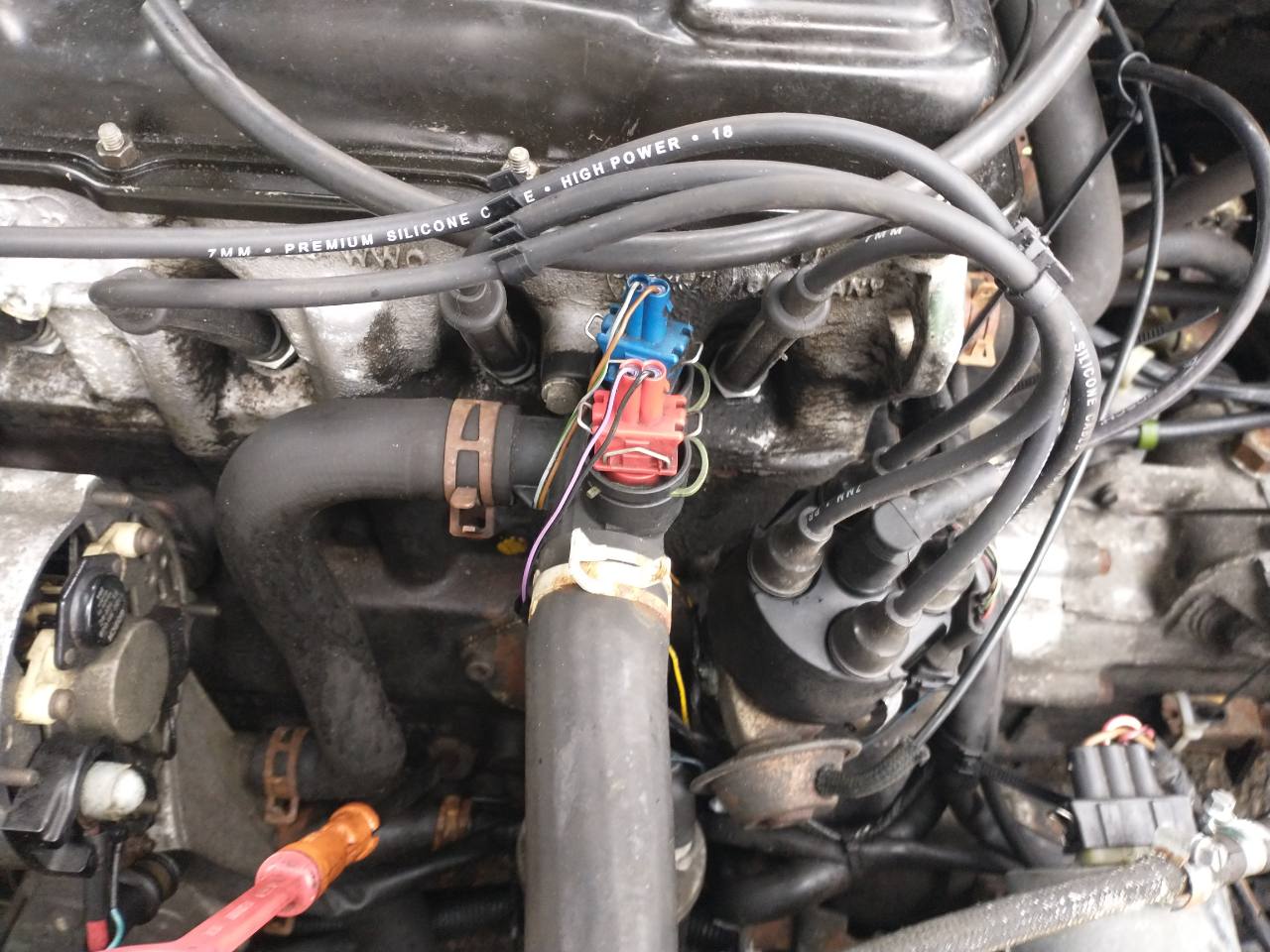

First up I located the temp senders - nice and easy to get to.
Googling and assistance from @jaypee and @blackboilersuit determined that the blue sensor was for the ECU, and the red one drove the gauge.

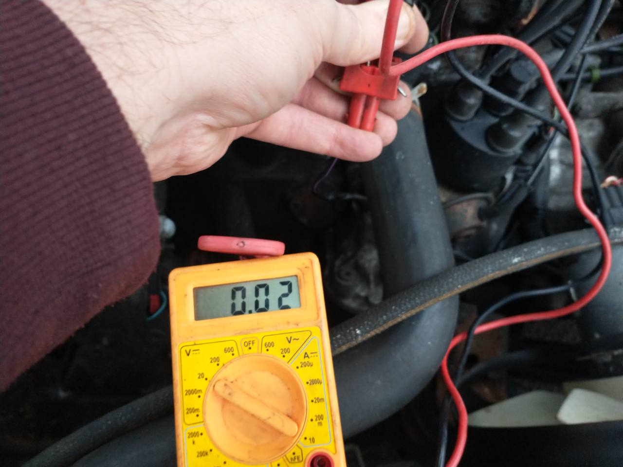

Bridging either did nothing:

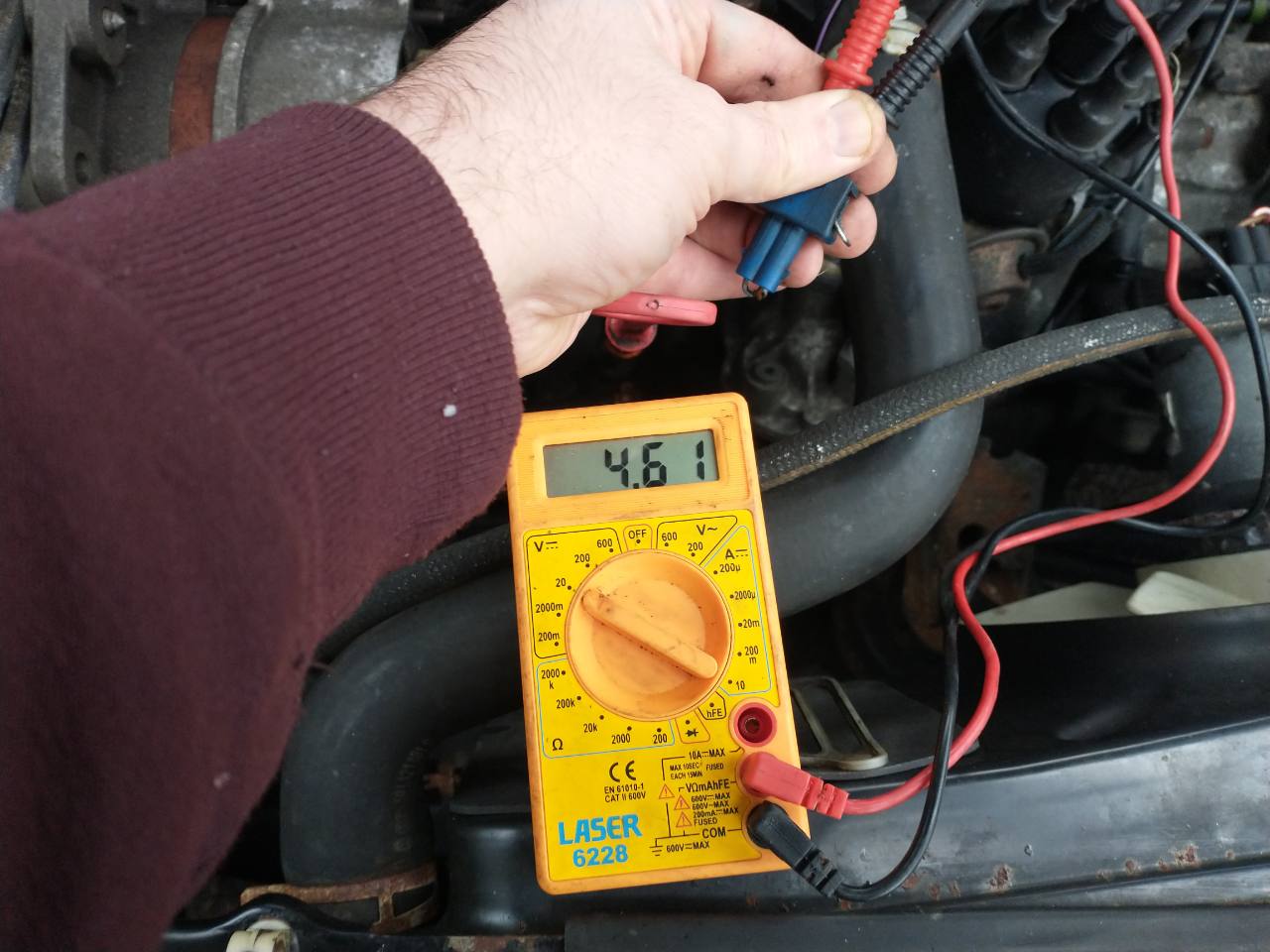

I then tested the plugs to see if they were getting power.
With the ignition on, the blue plug was providing some VoltsIMG_20210207_145005175.thumb.jpg.737fb08cf58cd2e3ff6b774733cc29cf.jpg
The red one not so much
This seems odd.
Either way, all I got was
All the dash gauges seem to be on the one fuse, so that ruled out any power supply issue. Could be a dead gauge - I'm leaving removing the cluster to last resort. If anything happens to it, I'd likely struggle to find a new facia panel. It's one whole surround down to the radio☹️

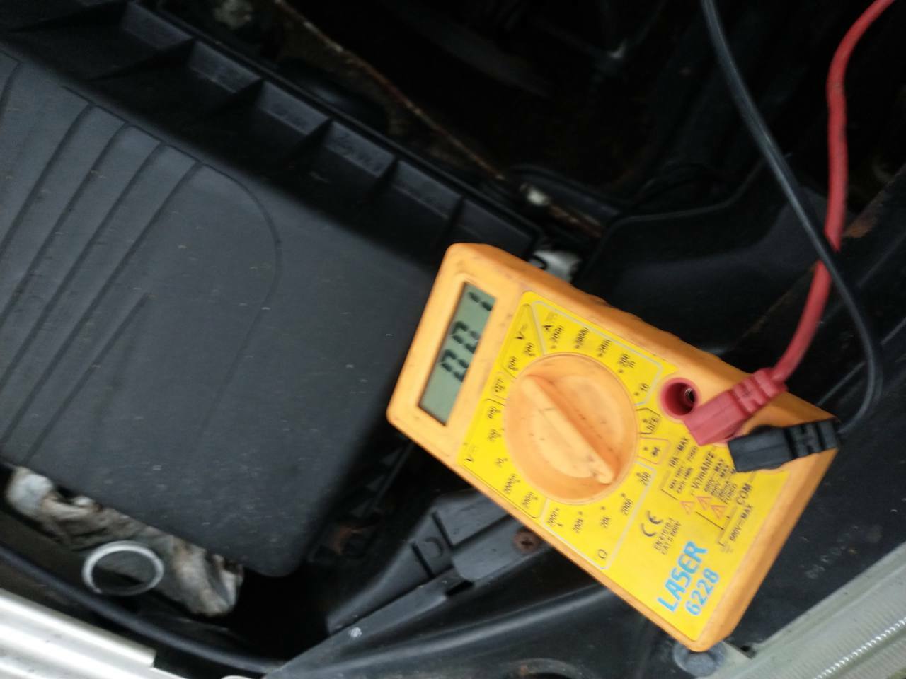

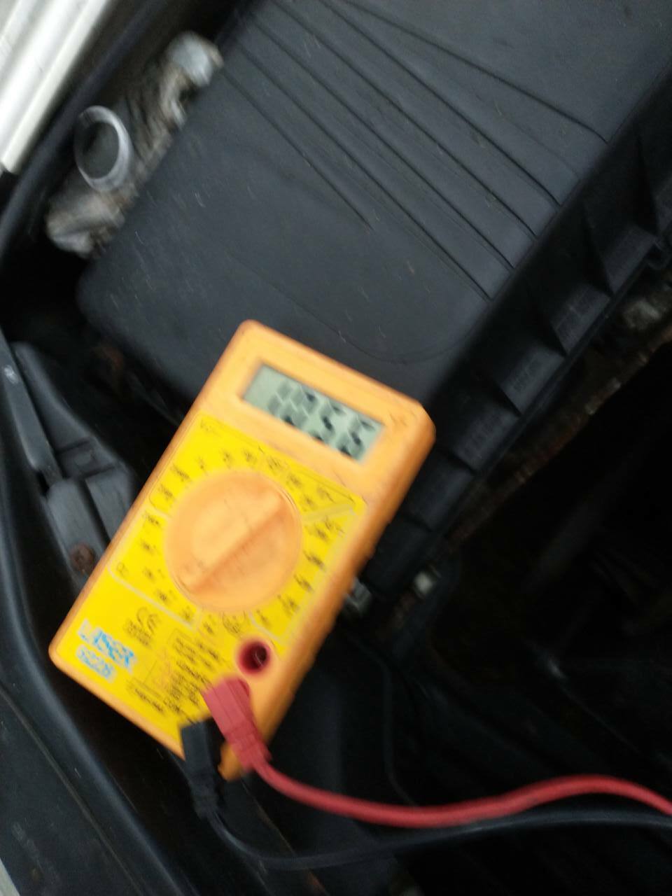

Next up, do a resistance test on the sensors. With the car running, the blue one was putting out a reasonable ( and reducing) value
The red one was rubbish.
I think a new red sender may be the initial order of the day.

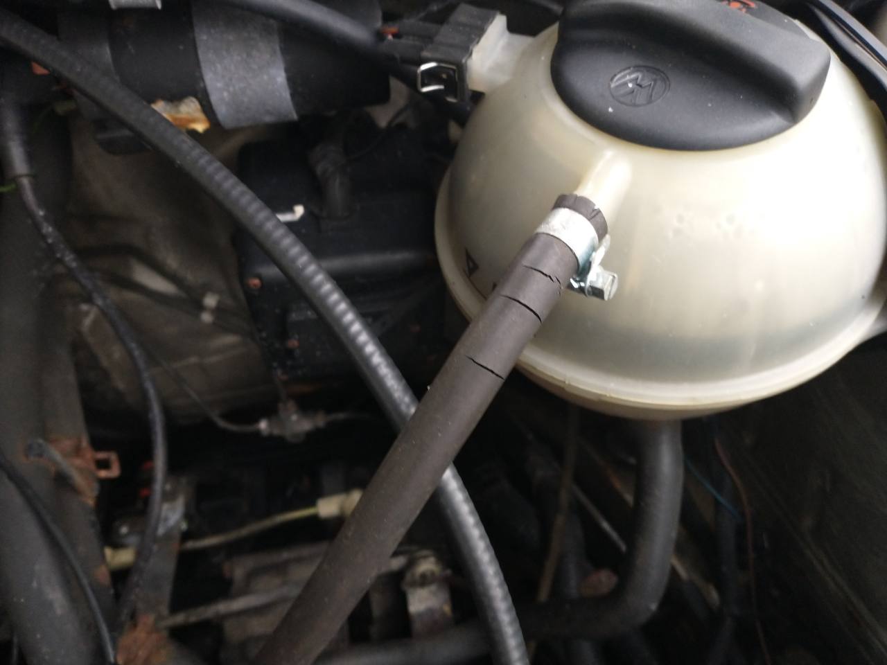

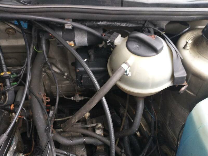

Whilst under the bonnet I spied some damage to the overflow pipe to the coolant tank.
A quick snip and refashion later,
Better.
"Why not replace the whole pipe?" I hear you ask. Simple
1. I didn't have any pipe in stock
2. The other end of it goes into the radiator under the slam panel
If I am going to that trouble may as well do the coolant change at the same time so I can take the rad out for a flush. It's basically the exact same setup as the MK1 golf was, so shouldn't be difficult.
A new rad is about £35 posted so not too bad if needed.
