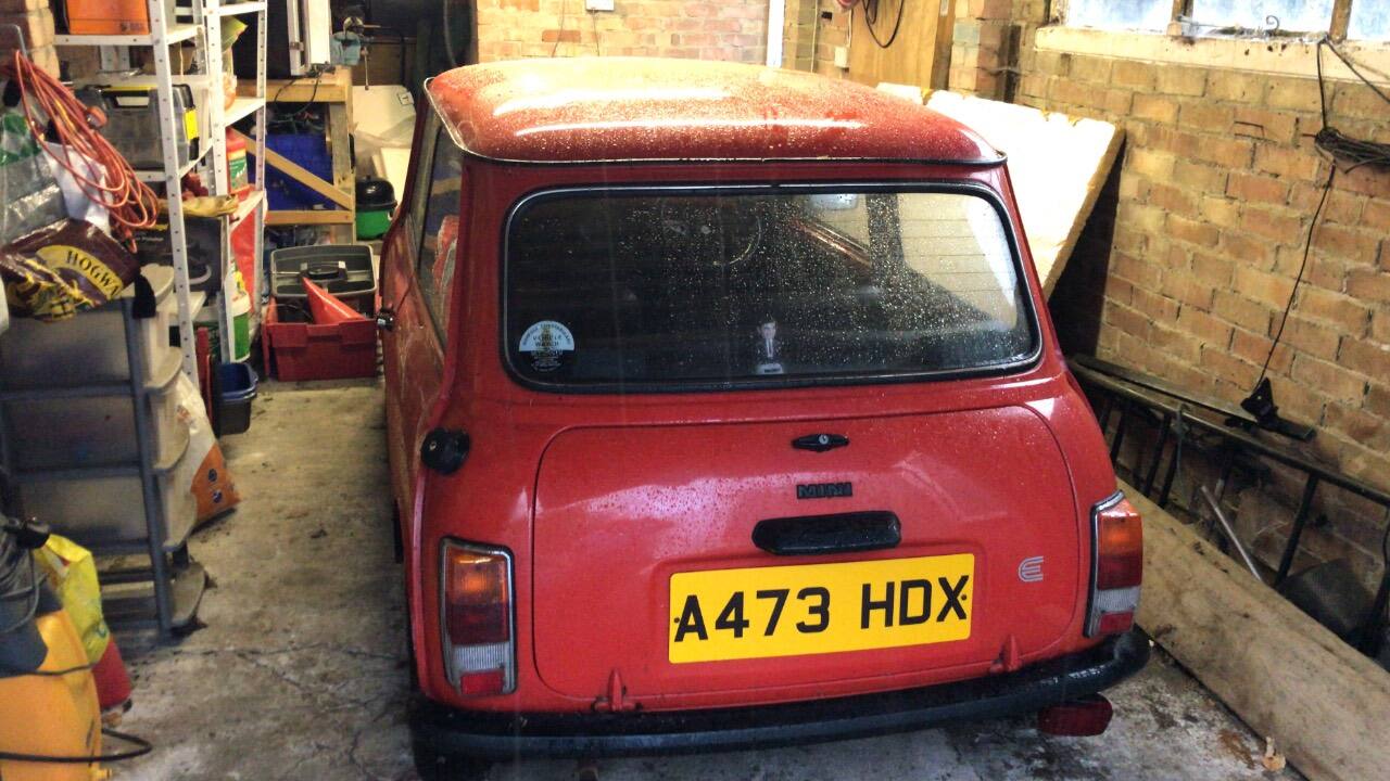

Here it is, having just been rained on for the first time in two years.

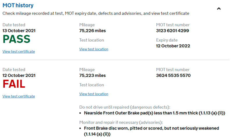

Yesterday I stuck it in for an MOT, worrying about what it would reveal! (I paid £180 and didn't even check the oil before driving home, never mind underneath!)
I call this a result.  It only needed brake pad, but am going to do discs and pads up front so we get a clean sweep.

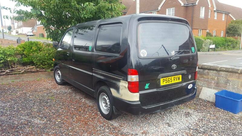

My weary old Hiace strolled through another Mot yesterday too without me even bothering to check the lights.

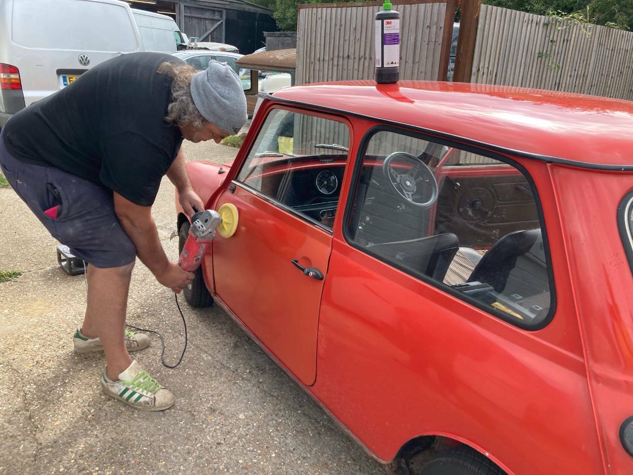

Ken looks like a knowledgeable guy too he's using 3M green top cutting compound that's £35 a litre and quality stuff.

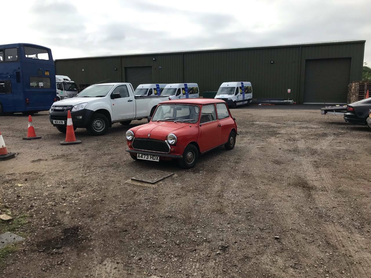

So I had two MOTs booked for this week. The original plan was to send the Mini in first but, seeing as it’s not used at all atm, common sense prevailed and the Yaris took precedence. A clean pass following a set of discs and pads and I’m delighted with the £180 purchase of late summer. It’s a great buzzy little thing that feels like it’ll just keep on keeping on.
To the Mini then. It’s a funny old thing sending a car in knowing it’ll fail, but it was the preferred method for the welder and it gives me a rigid shopping list and the promise of a nice clean sweep. All told, not a bad result. It wasn’t a horror story at all, and told me all the things I already knew - and one or two surprises like the rear brakes (all new) and the engine mount.
Going back to the Welder next week to form a plan. Parts bill will be expensive as I’m likely to bite the bullet and swap that subframe at the same stage. He’s going to smarten the front right up, polish the whole thing, and then we’ll be good to go. Plan going forward is ongoing titivating and a Charles Ware style rolling maintenance programme.

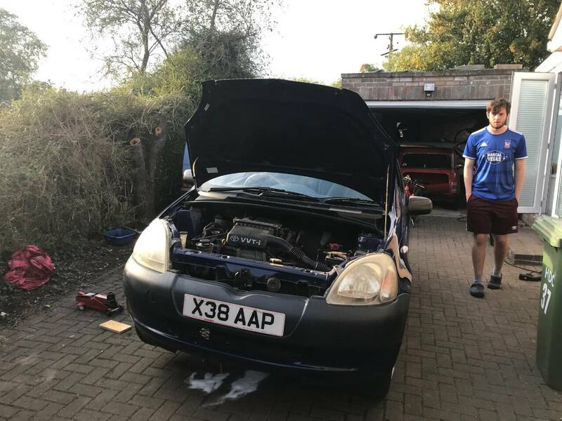

Spent this afternoon servicing the little Yaris. Whilst it’d had an oil service annually, there was little evidence of anything more than that. The plugs were fucking welded in, and the air filter was completed. It’s always more satisfying doing a service like this, rather than the maintenance stuff that’s kept the Avensis going at 268k.
I had to spunk out on a can of PlusGas as the plugs really were stuck, and borrowed a proper deep socket from my neighbour as my plug tool just wasn’t man enough.
Toyota sump plugs seem to be infinitely reusable, so I just bought two filters, four plugs and 5 litres of oil for £50. Value.
Unusually, the oil filter hadn’t been put on by a gorilla and there’s a handy gap through where the grille would be to unwind it.
Even for a knob like me it took an hour and nothing went horribly wrong. On first start up there was an incredible cloud of blue smoke which I can only imagine was all the oil that went down the spark plug holes or something. It cleared immediately and runs like a little sewing machine.

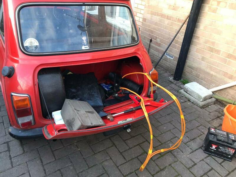

It did do this trick a few weeks ago when @alf892came over to free the clutch off.  So I wiggled the starter solenoid again but no dice.  We stuck a booster pack on and it went.  Fucking weird.  I thanked the man, paid the money, and drove home with max choke so as not to stall and strand myself.
So yesterday I took the solenoid off, thinking it might be an earth issue.  Nothing like trying to get rusty screws out of rusty metal eh?  It looked all good but I have it a proper good clean up, cleaned all the connectors, quick blast of contact cleaner, put it all back together again?
Nuffink.  Swore a bit (this is my most effective means of attack usually) and still nothing.  Then, just by walking from the front of the car to the back of the car all the dash lights came on as if by magic.  Turned the key - click click - then dead again.  Farted.  Lights all went off.  Laughed.  Put meter across battery - 12.5v.  Voltage OK but could still be battery I guess - after all the thing started with a booster.
Called Alf.  Spoke about battery - his suspicions were at that end as I said the negative cable is loose (it's one of those where the terminal just sits over the battery post).  I gave it a wiggle and nothing.  Hung up the phone for some more professional swearing and then...

I guess it's just broken down over the years.  New one ordered for the princely sum of £6.50 and I'll get that on later this week.  I was quite glad to clean up all those contacts on the solenoid anyway, one less thing to panic about going forward.

There's something satisfying about simple cars.  How a non starter can be fixed with nothing more than a battery meter, a probe on a wire and a jump lead.  After 15 minutes of dismantling the starter solenoid, we decided that it was the battery to blame - and that broken earth cable certainly looked like a potential candidate.

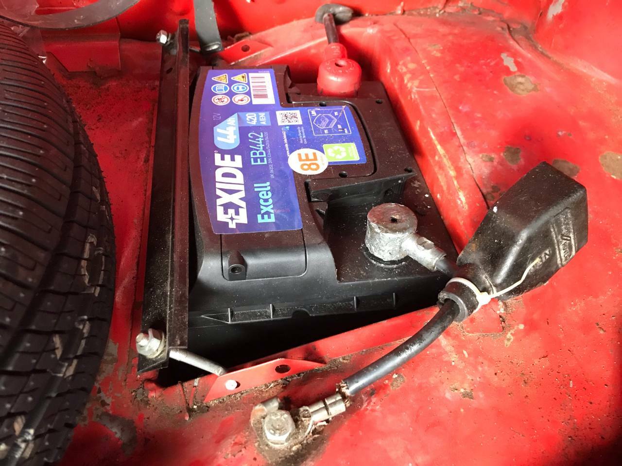

I ordered up a £6.50 battery earth strap from a Mini specialist on eBay and it arrived 24 hours later.  Phenomenal.  It's braided as well which means that it looks fancy and will hopefully withstand another 40 years of earthing duties.
As you can see, the old one was just push fit which wasn't very secure.  Also, the battery terminals seem to be smaller on this too - so it was never tight.  I think this battery is actually for a Peugeot 306, but fits the hole beautifully with the terminals the right way around.  It also has a lot more grunt than something like this will ever require.
The new cable went on really easily.  For a moment I didn't think it would tighten sufficiently, but that red ring in the middle sort of squashes - so after I turned it a lot more than I thought I ought to, it's on tight.
Bingo
Slightly soiled battery cover back on, securing strap down and boom.

Nice work.  The original earth terminal would have been secured to the battery with a self tapping screw, as standard.
Boot floor looks clean btw!
Worth putting a battery vent tube in for keeping that boot floor looking rust free.
Batteries vent small amounts of acid when charging/starting. This settles and causes rust over time. See MX5s that don't get the correct sealed battery put in.
Mega helpful. Thank you.

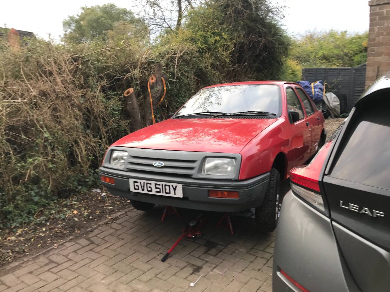

Spent a couple of hours titivating the Sierra. I nearly sold the bastard earlier in the summer - but it was a wobble. My friend, Emma, who helped me collect it is now likely in the winter of life - and on another round of chemo - and it all felt wrong. Apologies to those who felt I was dicking about, it was such a difficult thing. It’s a difficult time.
That said - anyone who wants to take the piss is welcome to do so. It’s a free world.

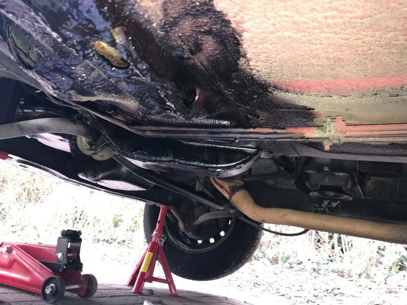

One thing we noticed when doing the clutch was a crispy end to the front subframe. Before winter bites, I did as dear Alfred instructed and attacked it with rust killer and some UB40 or whatever it’s called.
Truth be told, it’s a tiny bit soft. It may need a tickle come the next MOT. Let’s see.
The boot? Well that hole got a whole lot fucking bigger.
I sat and thought about life and the universe for a while. If I’m guilty of getting anything wrong, it was that I thought I could and should renovate this car. Truth is, it will need deep pockets - and at that stage it stops being this remarkable little car that’s survived everything.
Bollocks to it. Its role on the fleet henceforth is as a van. Purely practical. The role it played so well for so many years. So I stuck some plop in the hole, covered it in Hammerite and called it “job’s a goodun” (which is a beautiful Suffolkism for “fuck it - that’ll be fine - I’ll forget about it soon enough”)
I’ve stuck some paint on since and it looks better.
As the man at the garage said. It’ll never be worth anything. Let’s just keep those wheels turning.
