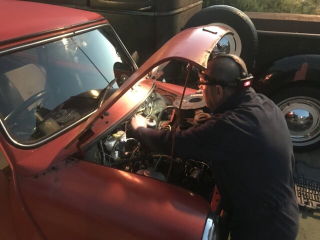

I didn’t think the car even HAD reverse lights, never mind twin ones! A few minutes were spent trying to make the offside one as bright as everything else. Having checked the earth and cleaned the bulb holder with a Dremel - closer inspection revealed a 24v bulb. Rather than adding a second battery to the car we compromised on a 12v bulb.
The near side headlight has never been right. So much rust around the wing rendered the bowl almost unattached. Fortunately, Alf had a Rivet gun and had been frothing at the mouth like a rabid dog at the thought of using it.
Job’s a goodun.

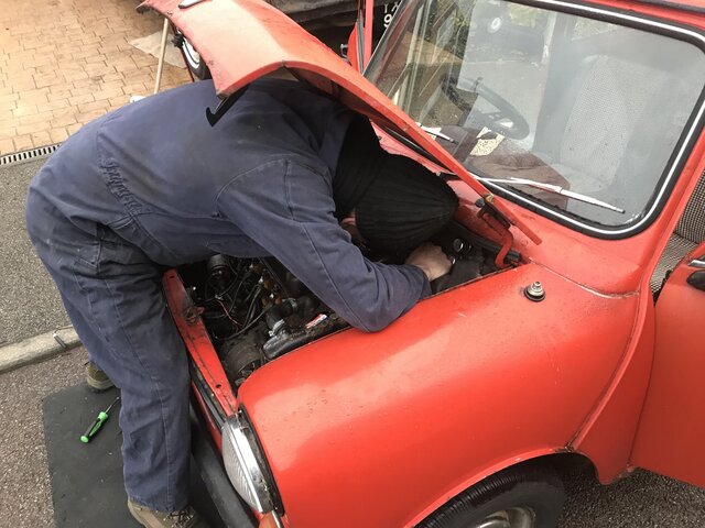

Verdict? Shit from tank. Once the car was given the chance to chill, it started up fine. Hopefully this can all be resolved with an inline filter and a bit of luck. We also tidied up wiring from the coil and inspected the rotor arm which will get replaced.

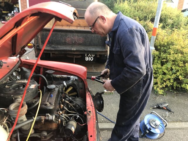

Any other suggestions welcome, but I’mma be grabbing a new fuel pump and the like too!
Illumination. Not something you necessarily associate with Minis - especially those with sealed beam units. The nearside unit was fine, despite appearing to be the original Lucas unit. Offside was on strike, but fortunately Alf’s chum had one in his collection*
Once fitted it worked perfectly. For all of 5 minutes. Again, it’s hard to complain when you’re asking stuff to perform flawlessly when 5 minutes ago it was retired. The returns policy, being a 30 year old lamp, is debatable - so I’ve bitten the bullet and added an H4 modified set. They mostly just screw on, other than I needed to make a small adjustment with an angle grinder to simplify sidelight bulb changing.

New fuel pump now fitted. Alf loved** this. Look at him practically humping the car!

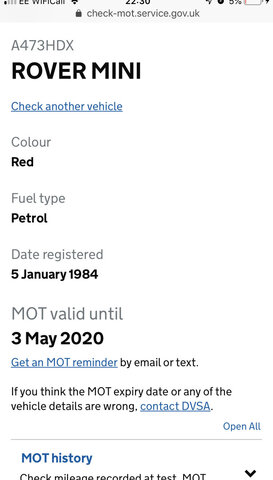

Now it’s just the small matter of presenting it for a test, which will happen when I find time. Having had 4 nights and a morning on this during this week alone, I probably need to give other things a bit of attention.

Get in - you must be well chuffed with that.
Great result, a hard fought ticket that
Well done! Must be so satisfying the o get the ticket and the little thing back on the road.

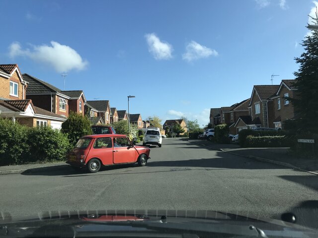

I'd had word that this little thing might be attending today, it was great to see it pull onto the park at Ipswich just after we arrived.
Impressive enough that it could manage the drive along the A14 after so many years laid-up, but the drive down to Felixstowe is 15-odd miles of mostly stop-start crawl, quite a test. It was pleasing to see it in the queue behind us every so often and not making use of the rather massive breakdown truck that was bringing up the rear.
We both ended up at the same end of the prom at Felixstowe, and it was great to see it there.
People obviously loved the story behind it, there always seemed to be people reading the notices.
