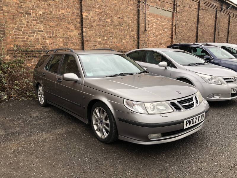

Last March I won a BINI Cooper on here, (thanks @Tickman) had a lot of fun with it before swapping it with @GeordieInExile for this, a Saab 9-5 Aero estate. With 3 kids this suited the family better, and it has addictive acceleration. Basically been a toy/back up to our i800. Helpfully my wife really likes it, which always makes things easier! We both walk to work so the mpg isn’t such a concern, low/mid 20s in town...

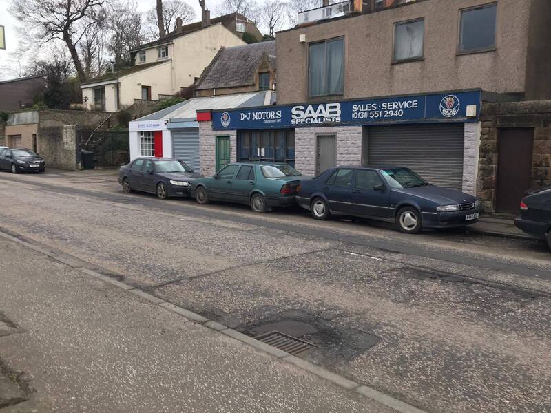

It threw up an abs light which ignored for a bit, Neil had mentioned it had an advisory for an abs ring when I bought it. Started to run a bit rough as well so booked it in to a Saab specialist I’ve driven passed for years but didn’t know much about. He was great, fixed the abs ring, found an oil leak from the oil pressure switch and repaired, then gave it an oil and filter change. He road tested it and was very complimentary about it. Said to give it a month or 2 and if the fault lights/rough running don’t return, book it in for a full service. The car is much better, took it down to my mums in Lincolnshire a couple of weeks ago and it drove really well, with cruise on at 70 it was getting almost 34mpg, a record for my cars!
I thought I recognised that Saab place from the picture and it has looked that shabby for at least 25 years, used to drive passed it a lot!

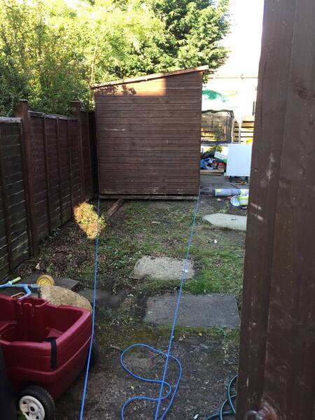

So enforced “later” is here, after reading the phrase “awful automatic Volvo” on another thread gave me the final push to get on with it. Step one of course was knock down my hut. My wife has been on at me for about 5 years to remove this eyesore, it was half rotten when we moved in 8 years ago! I dragged it down the garden 4 years ago with said Volvo to put a trampoline in its place, but now it was in my potential tinkering area, and had to go. 8072A321-EB8A-4AC0-8AC2-B4E8BBA20DEA.thumb.jpeg.007235c52c1a348fba5aeea350887354.jpegD0673824-4D7B-4C07-AFAF-BC27CEE3EA24.thumb.jpeg.bc2ab4e865d88f102c826d9dad0bd972.jpeg

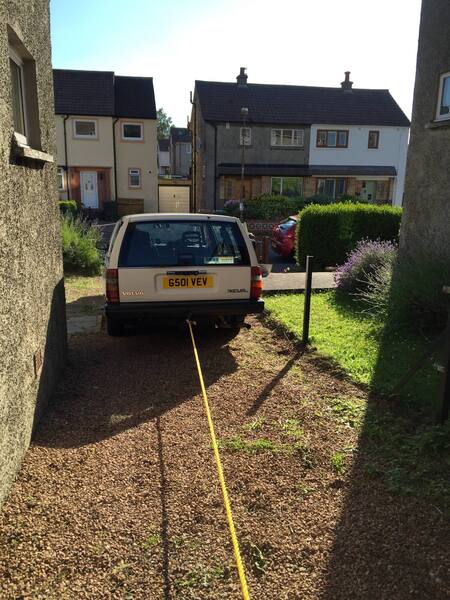

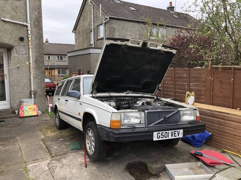

So with hut demolished and a crude box/chest made to put tools and junk in, a driveway Hokey Cokey ensued and the Volvo was started and under its own steam turned round and moved to its new resting place 6C092788-811F-4DB8-8F81-3BEFAA4C25B1.thumb.jpeg.e2f43530669e8e63ace235d665e20cb7.jpeg
754E32D6-3E42-4F8D-83BD-C1ECBDEA6966.thumb.jpeg.ebb6da8e988d80a5480c02d03b287aeb.jpegOne shed replaces another...
So first I drained the atf and topped it up with ATF I had lying (I’ve got the correct stuff from ECP but I’m keeping that for now, I didn’t lie about being a key worker honest) and the old stuff looked like this...4397F0C1-BA27-463F-97FC-BF0D9CB4BB67.thumb.jpeg.ed073bbaeb94591d15c888e22280e776.jpeg
Black! Not looking good... next I tried bypassing the oil cooler with fuel hose as mentioned above but I made a James Hunt of it... had the clips tight but it still pished out! Put it back together and left it. This morning though I’ve ordered a new rad from eBay, due next Tuesday. Will try again when this arrives, and then flush the atf and see how it goes.
