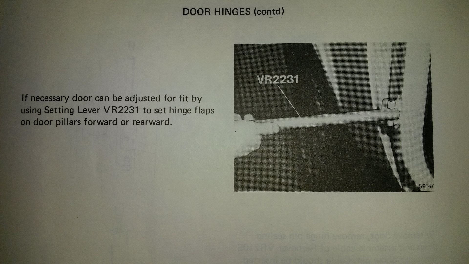

Noel Tidybeard Posted May 1, 2016 Posted May 1, 2016 fnar, fnar, fnar it says FLAPS arf, arf, arf purplebargeken and 4wheeledstool 2
