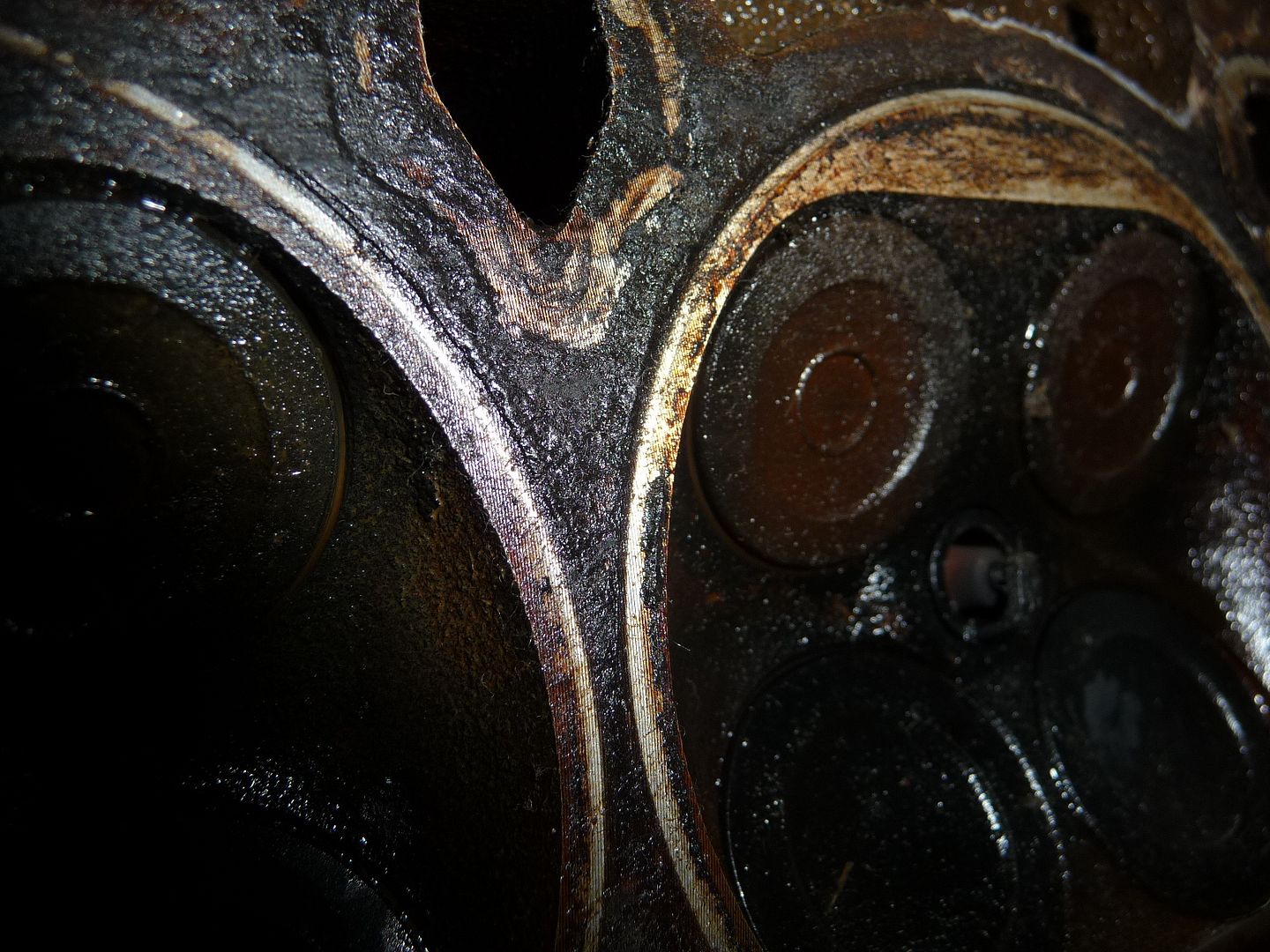

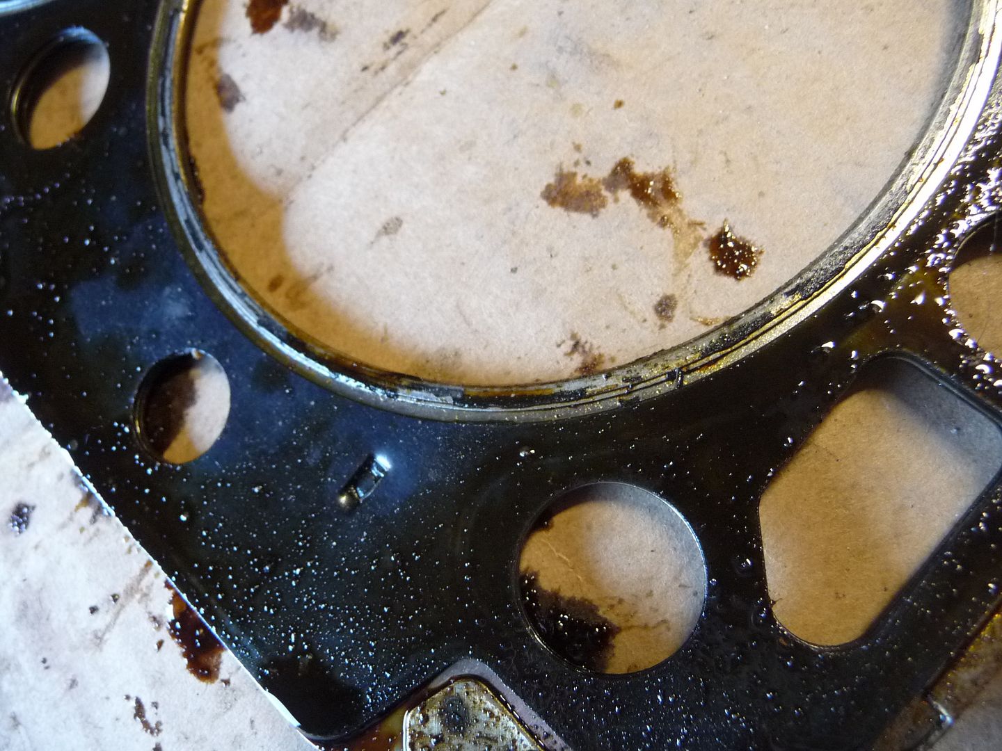

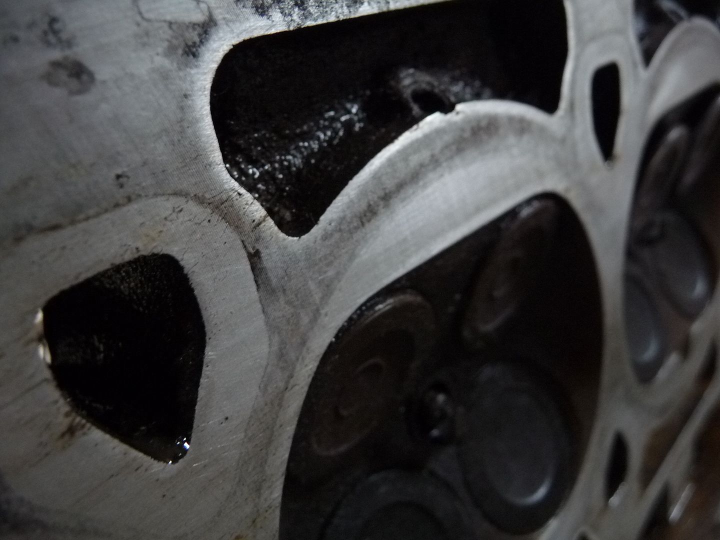

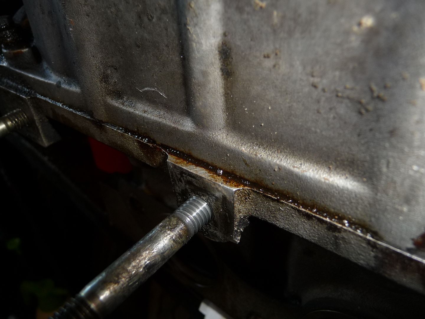

Mr_Bo11ox Posted January 1, 2014 Author Posted January 1, 2014 Well, I;ve had the head off this thing. At first i thought it was suffering a bit of fire ring damage: Bit after a proper good clean up I was chuffed to find that actually the head surface was totally mint. I ummed and ahhed about buying a payen gasket as my feeling is that would probably be a better solution overall. Plus, I realised that the 2 months tax still in the window was still valid so i sent it off for a cash-in, which will liberate £40 or so and cover the cost of a new gasket. But in the end i decided f**k it, mainly for the reason that I had the MLS gasket sat there and waiting for a new one to arrive would probably end up in a 2-week delay to this thing running again. So this evening I have braved some proper shitty weather and chucked the cylinder head back on, torqued it up carefully (in 4 stages rather than the usual 2), timed it up and put the belts back on. Like a fat-knuckled cretin I slightly damaged one corner of the new HG (just above the watre pump) while manhandling the head into place so I stooped to a new low and put a bit of instant gasket on the damaged bit of the head gask, no doubt it will piss coolant out of there or something but we'll see. With a bit of luck, if I get a quiet evening tomorrow or Friday I might have it running again which would be nice!!!!! The Moog, saucedoctor, M'coli and 8 others 11

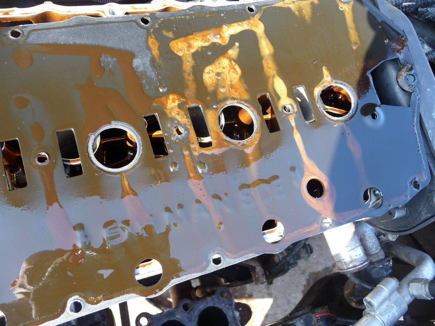

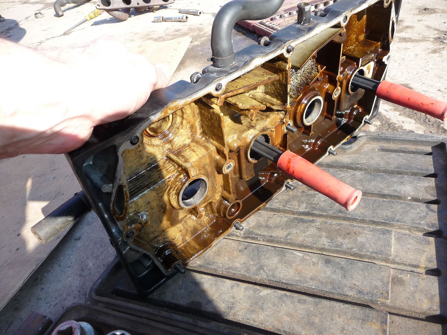

Mr_Bo11ox Posted January 12, 2014 Author Posted January 12, 2014 CAN I GET A REEEE_WIND Got this honk of shit back together this weekend after a bit of faffing about. Didn't take many photos as who wants to see an inlet manifold getting lashed on? Anyway I reassembled pretty much all the bits onto the engine and trned the key. To my astonishment it fired straight up and settled down to an OK tickover. I tipped some badass french wasing soda stuff in the Xpansion bottle: Then let it run for a while to see what happened. What happened, was that although it didn't boil up, its still not happy. Although i ran it for ages with the expansion cap off, and it settled at a steady mid-point on the temp gauge I could not get any heat out of the heater, despite being able to see the heater control valve doing the biz in the engine bay. if i put the lid on the expansion bottle it very quickly started burping and farting bubbles through the cooling system, pumping the top hose up to 800PSi pressure and generally getting itself in a right tiz. I think the coolant must not be circulating properly, to be fair there is still a lot of oily shiz in the water circuit and it wouldnt surprise me if that had bunged something up. I read about a 'jiggle valve' in the inlet manifold that sounds like a prime candidate for jamming itself up. I think I'm going to try and flush it through with a hosepipe to get rid of some of the muck. Also I think there are probably much better ways to bleed the system than the one I employed. Any tips? I suppose I had it ticking over for an hour without it boiling up and the rad fan kicks in and out OK (no misfiring either) so thats encouraging, but i don't think i'm out the woods yet with it. On the upside it sounds happy enough and I haven't buggered up the cam timing or made some other schoolboy balls-up.

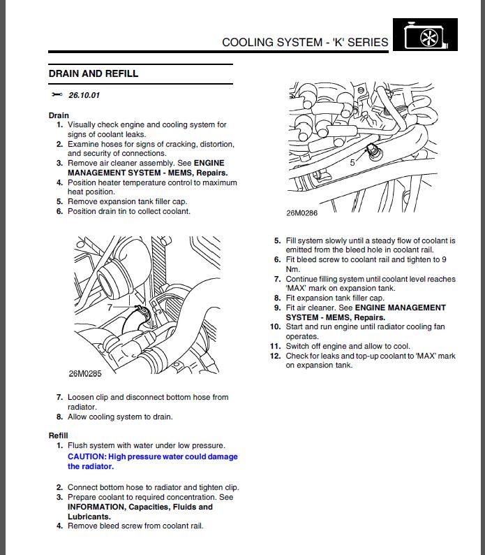

saucedoctor Posted January 13, 2014 Posted January 13, 2014 On 12/01/2014 at 22:51, Mr_Bo11ox said: Also I think there are probably much better ways to bleed the system than the one I employed. Any tips?I assume you've used the bleed screw in the metal coolant pipe that runs for'ard to aft, above the gearbox? 8mm head. Good call on the jiggle valve too, btw - they jam up for fun under the best of circs. Barry Cade 1
Lankytim Posted January 13, 2014 Posted January 13, 2014 I think that jiggle valve thing in the inlet manifold can be removed, it's well known to cause airlocks and when it's out it reduces the chance of thermal shock to the cylinder head when the thermostat opens and lets cold water circulate from the radiator
Barry Cade Posted January 13, 2014 Posted January 13, 2014 Punch it out with a long screwdriver- they never work anyway,and especially after being gunked up.Are you getting a constant flow of coolant back into the expansion tank when it's warm? They're not bled properly until they do this.
saucedoctor Posted January 13, 2014 Posted January 13, 2014 While I'm not disagreeing with LankyTim or Tiff, RAVE says "'a jiggle valve fitted at the start of the bleedline (to expansion tank) prevents pressure build-up in the expansion tank by regulating the amount of returning fluid'" But yeah, they do stick. Not sure if I'd sack it off altogether, though. garethj 1
Mr_Bo11ox Posted January 13, 2014 Author Posted January 13, 2014 yeah i didnt get a steady return flow into the expansion bottle. I got a very unsteady one! After arsing about for an hour I drained the water (thought it might freeze overnight) but will try again maybe tonight. I didnt use that bleed nipple properly either, i should have taken that out while filling it right? Only read that afterwards! 5/10 MUST TRY HARDER
saucedoctor Posted January 13, 2014 Posted January 13, 2014 On 13/01/2014 at 12:21, Mr_Bo11ox said: yeah i didnt get a steady return flow into the expansion bottle. I got a very unsteady one! After arsing about for an hour I drained the water (thought it might freeze overnight) but will try again maybe tonight. I didnt use that bleed nipple properly either, i should have taken that out while filling it right? Only read that afterwards! 5/10 MUST TRY HARDER Aye.

Barry Cade Posted January 19, 2014 Posted January 19, 2014 On 13/01/2014 at 11:11, saucedoctor said: While I'm not disagreeing with LankyTim or Tiff, RAVE says "'a jiggle valve fitted at the start of the bleedline (to expansion tank) prevents pressure build-up in the expansion tank by regulating the amount of returning fluid'" But yeah, they do stick. Not sure if I'd sack it off altogether, though.Sometimes the guys who wrote RAVE spent their evenings in a warehouse, wearing paper suits listening to loud repetitive music. Not all K's have a jiggle- but its daft and causes more issues than it solves. It's a plastic ball in a pipe..probably designed by the guy who put the thermostat in the wrong place. I poke 'em oot and live without. "The original design for the Rover cooling system (before production) did not use jiggle valves. These were introduced in order to take the header tank out of the coolant circuit during warm up. Fast warm up times were considered to be a critical requirement at the time" "In addition to the three manually opened bleed points on the cooling system (water rail, heater and radiator) I think a timely reminder is of use to introduce a periodic test by owners to ensure the little jiggle valve in the inlet manifold of all MGF engines remains free and so allows air circulated up in the engine to automatically escape to the header tank.Both plastic and alloy manifolds have a small bore hose that connects to a stub at the cam belt end of the manifold flange. This valve consists of nothing more than a plastic ball which is heavier than air and lighter than water. When the cooling system has no air this ball is held on a seat and so closes the path for coolant to the header tank from this direction. If any air percolates to the top of the engine, which it will if any is there, then the ball falls away from the seat and the air escapes to the header tank. As soon as coolant arrives the ball reseats.It has become more and more apparent as cars age that this valve sticks on it's seat and so any air remains trapped in the upper part of the engine. This as we all know can cause spot overheating and even cause interuption to coolant flow and the results can be ....... unpleasant and costly!!!A simple check periodically can ensure that the valve remains working properly.This involves removing the existing hose and I suggest it be squeezed with a brake pipe clamp or other similar device to prevent unnecessary coolant loss. Then have to hand a length of the same bore hose that can be simply pushed onto the manifold stub and long enough for you to be able to blow into it.If the valve is free then you will be able to blow past the valve. If it is stuck then you won't be able to blow into the system. Loosening the valve involves removing you blow hose and poking a blunt probe down the manifold stub to dislodge the ball. Check again by blowing down to confirm it is now clear. Remember that the valve will stop any coolant loss so you only have to worry about the hose from the header tank." saucedoctor 1

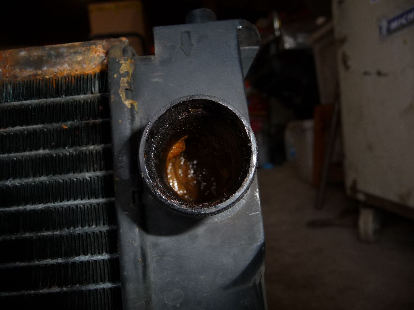

Mr_Bo11ox Posted March 2, 2014 Author Posted March 2, 2014 Hey i'm slowly getting my shit together so lets have a news update on this POS So last time this thing was up and running but the coolant was not circulating properly for some reason. I changed the thermostat and water pump but that made no odds to anything. Decided the radiator was blocked solid, so I towed it down the garage and chucked MORE MONEY at a new radiator: Got the new rad off the bay for £43 delivered. It was a bit of a faff to fit but not too bad. The old rad weighed at least twice what the new one did and was visibly full of crap so it seemed like a worthwhile swap. Filled it up with water and started the engine. Now I found that the coolant circulates to some extent as the bottom hose now gets hot which it didn't previously. So that seems like an improvement. However, its still not right. I bled the system as best i could but when it gets hot with the cap on, the system pressurises itself excessively - the top hose is pumped up to 500PSi still and the pressure is such that you can see water weeping out of the head-block joint!!!!! Goodness knows what the pressure is in there for that to happen but its only supposed to be a few Psi I think. I have just bought a new cap as i think the cap is supposed to stop the pressure going beyond a certain value and that does not seem to be happening. With the cap off it does not over pressurise obviously and it generally seems happy enough, except that eventually there is a massive slow gulp that chucks half the water out of the expansion bottle. The head gasket might still be playing up and pressurising the cooling system, although when you run it with the cap off there is no tell-tale trail of bubbles popping up in the expansion bottle every so often so I'm not certain yet. This weekend I am gonna try again to bleed the cooling system with an upturned, sawn-off pop bottle to raise the water head on the expansion bottle and chuck a bottle of speed flush in as theres still a load of muck floating around the water system. also I'll put the new cap on. By then i will have replaced ALL POSSIBLE replaceable elements of the cooling system!!!! It has better start flaming working soon or something drastic is gonna happen which I doubt it will enjoy. Annoying, as I think this would be such a brilliant little machine if I could get it running reliably. Coprolalia, beko1987, scruff and 1 other 4

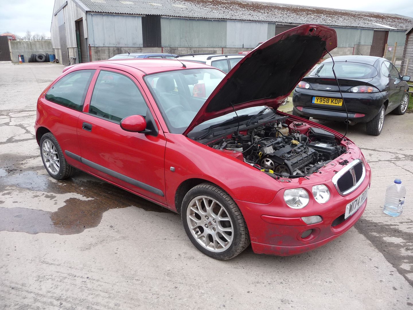

Mr_Bo11ox Posted March 9, 2014 Author Posted March 9, 2014 Yo Bludz! Check yo bad self one time. Safe! Been back on this UNGRATEFUL SHITHEAP today. The sun was shining and I had high hopes. Set off up the garage with some K-series essentials: A funnel to ram in the expansion tank, a bottle of SPEEDflush (caps courtesy of serial MGR mental case MGJohn) and a new expansion tank lid. Plan was to just let it run till it coughed all the air out, with the funnel letting it cough the air out without coughing the water out at the same time. Unfortunately: As the engine warmed up the level in the juice bottle just continued to rise and rise till eventually it just started chucking it out with the usual coffee percolator soundtrack from the expansion bottle. When the water level got quite high it got into a routine of popping a steady stream of little bubbles up from the expansion bottle. I had to face facts - the bastard was still pressurising the cooling system despite the new head gasket, inlet manifold gasket etc etc. So fat I have replaced the head gasket, bolts, thermostat, water pump, radiator, IM gasket and various other gaskets. I inspected the head surface and it seemed smooth, uncoroded and free from warpage and checked the liner heights and they seemed OK too. I reassembled it with a new MLS gasket and head saver shim, torqued it all up carefully and the bastard is still pressurising the system and chucking its coolant out without ever having run properly. What to do? I could weigh it in but that would mean it had defeated me, and the odds would be against me if I ever took on another K-series HG, which id a task I would like to not be afraid of in future. Another gasket is a further £40 spend (plus no doubt other gaskets will need changing once I take it all apart again) and TBH whats the point in chucking another gasket on without fully understanding why this one hasn't worked? I decided to rip it all to bits again. Had a massive war getting the crank pulley off, despite the fact I'd only put on a month or so beforehand and had not gone mental with it. The flipping impact gun wouldn't touch it. Had to put it in gear, jam both brake discs and yark on at it with my big breaker bar. Give me a break FFS!!! Everything else was pretty straightforward, much easier with the 1/4" drive socket set that I bought since the last time I dismantled this thing. Yeah that looks good. To be fair that could be from the previous HG failure. Drips of water running off this thing FFS. Shortly: Lets have a look at the head. One thing I noticed was that this 'head saver shim' appeared to achieve piss all except flake off most of its surface coating all over the head surface. I struggle to imagine that could be the root cause of the problem but having this stuff flaking off in the key sealing areas round the fire rings can't help can it. Looks like its been pretty much washed off by the hot oil. very poor. The head surface cleaned up nicely with a wipe of a cloth! I re-measured the liner heights as well. The thinnest feeler gauge I had was an 0.05mm (0.002") and along the rear side of the block i could get this in OK. Along the front side i struggled meaning that the liner height is less than 0.002 although i would say it is not under flush according to my calibrated fingertips. Spec is 0-0.005 although I suspect '0' is undesirable. While I was looking at the head I wondered about the cam 'rack' which has a few oil leaks, which I could not be arsed fixing the first time round. The more effort I tip into the is thing the less acceptable a leaky cam box is, if I have spent so much time and effort on it and it still drips oil out its a poor effort innit. If I am going to have another crack at the gasket I ought to tackle these as well. Only problem with that is, to separate the cam rack from the head you have to remove these VVC actuators (which also leak a bit of oil actually, they need new gaskets). I took one off and immediately shat myself as I thought I had screwed up the synchronisation of the two VVC units. I might well have done actually, and need to check it carefully if/when this thing gets put back together. Got to do a bit more research on that, seemingly its not totally impossible to remove and refit these things at home but you need to know how to set them up afterwards which looks reasonably involved. So what to do? I could follow Tiff's advice, jettison the MLS gasket and the shitty head saver shim and fit a Payen elastomer gasket which is seemingly a bit more tolerant of low/uneven liner heights. Thats £35 (assuming I re-use the bolts, which is dicey) plus I will need to get some VVC unit seals (£8 each) and some pukka cam box sealant, another tenner. I have already tipped quite a wad into this which of course I will never see again. Or I could just remove the new rad and water pump (They're bound to come in useful!!!) and weigh the damn thing in for £100. What does everyone think?
