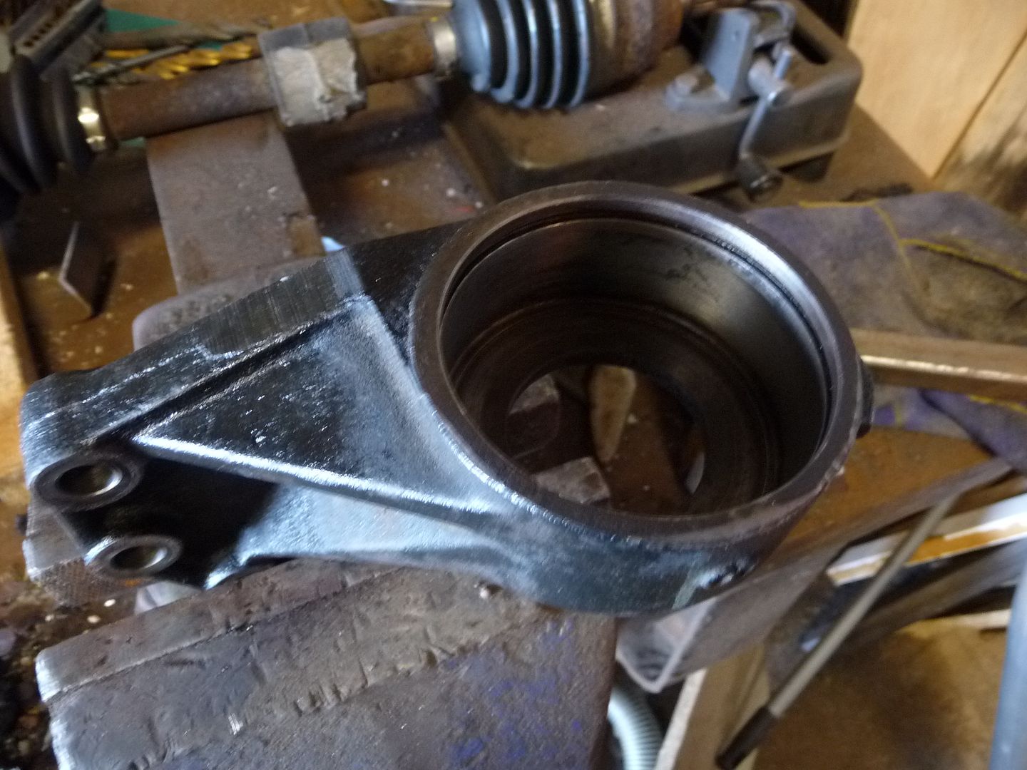

Heated up this collar with the blowtorch, which expanded it and made it easy to tap off the driveshaft
That made it possible to tap the bearing and hoising down the shaft & remove them. Then look what I found!!
The flippin inner race of the bearing has cracked!!!!! No wonder it all fell apart. Because of the crack, the bearing does not have a proper tight hold on the driveshaft any more. I am not sure exactly why this has cracked but presumably the bearing had got tired then either some odd vibration was set up or the inner race started to wear, thinning the section and weakening it. Or some combination of the two. Anyway at least I have found an actual problem thank goodness so I can be reasonably sure of the fix.
Managed to press the old bearing out of its housing:
Well knackered
Cleaned up the housing
IN with the new bearing, slotted in a treat

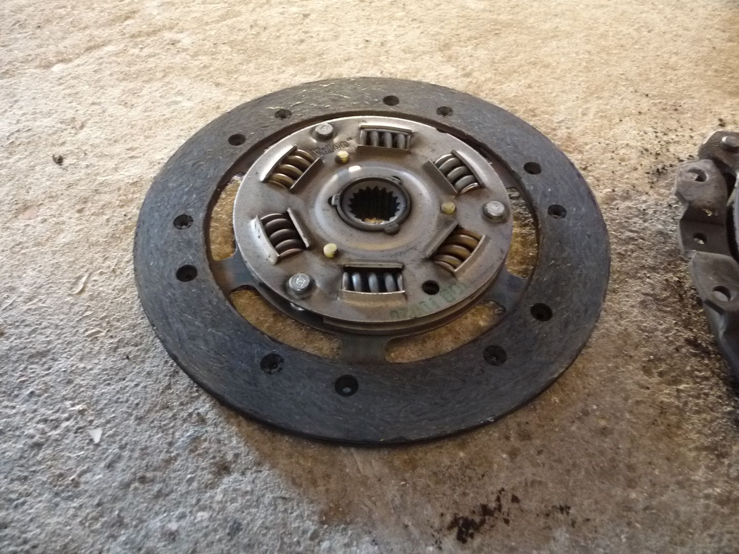

The old clutch didnt look that bad to be honest
Still, i was hardly going to put it back together with the old clutch in, as here is a new one:

It genuinely seems like the clutch is burned right out, but obv there is some other problem. I didnt think there was owt wrong with the gearbox because it changes gear OK, doesnt make any daft noises or other obvious problems. Both driveshafts are properly engaged. In reverse it feels like it wants to move, but in all the forward gears you really get pretty much NOWT. FUCKING BASTARDS
