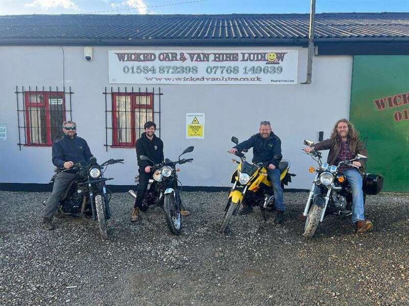

After riding the Keeway up the hill from Cleobury I was left wondering if I could sneak a 250 engine into it as it was so much slower than the other bikes (I got overtaken by a Land Rover).
A bit of thinking today and I checked the front brakes in town.  Really stuck on, hard to turn the wheel.  Gave them a tap and rode home using only the back brake.  Much improved :)
Suppose I'd best take them apart again before the run as we're setting off at 8am on Saturday.
More pictures are unfortunately in Facebook
https://m.facebook.com/100033143781078/
If you'd like to sponsor us link is here
https://www.justgiving.com/fundraising/Wicked-Removals?utm_source=copyLink&utm_medium=fundraising&utm_content=Wicked-Removals&utm_campaign=pfp-share&utm_term=4a4421ccbf51414e9a2c6988de95d9f2
