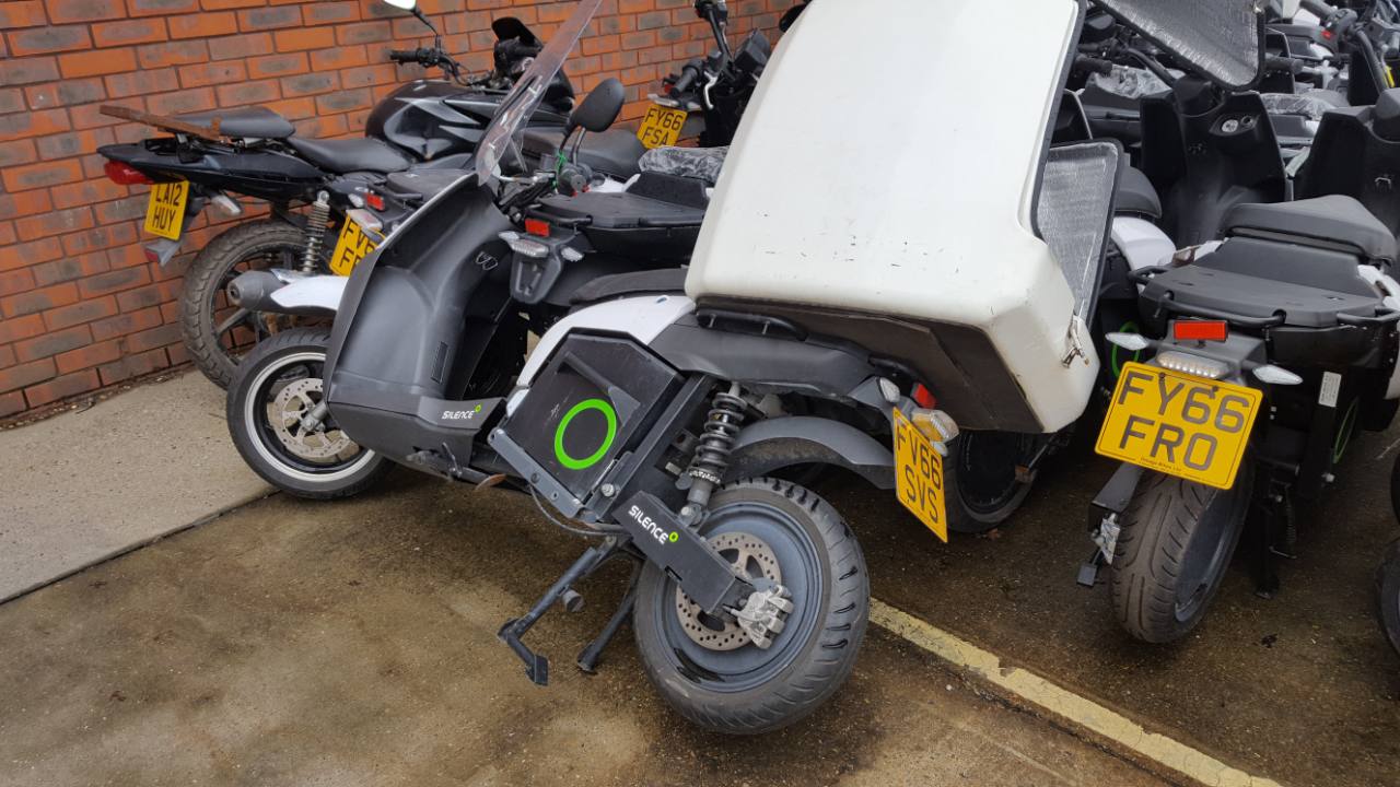

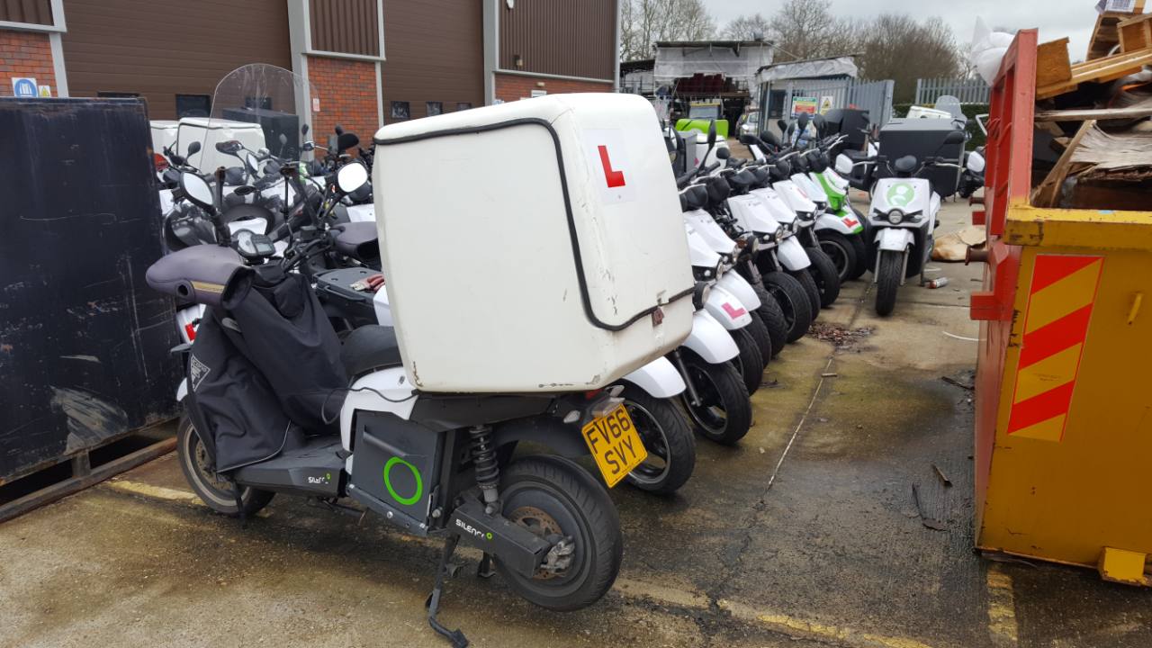

Ever wondered where all the old "leccy" scooters go to after their lease is up ?
East Grinstead.
I thought it was silicon heaven......along with all the calculators.....
Fucking hell, what a waste.  Are all those leccy scooters knackered?
That does seem a big waste, are they really not economically worth putting into use./ saving.

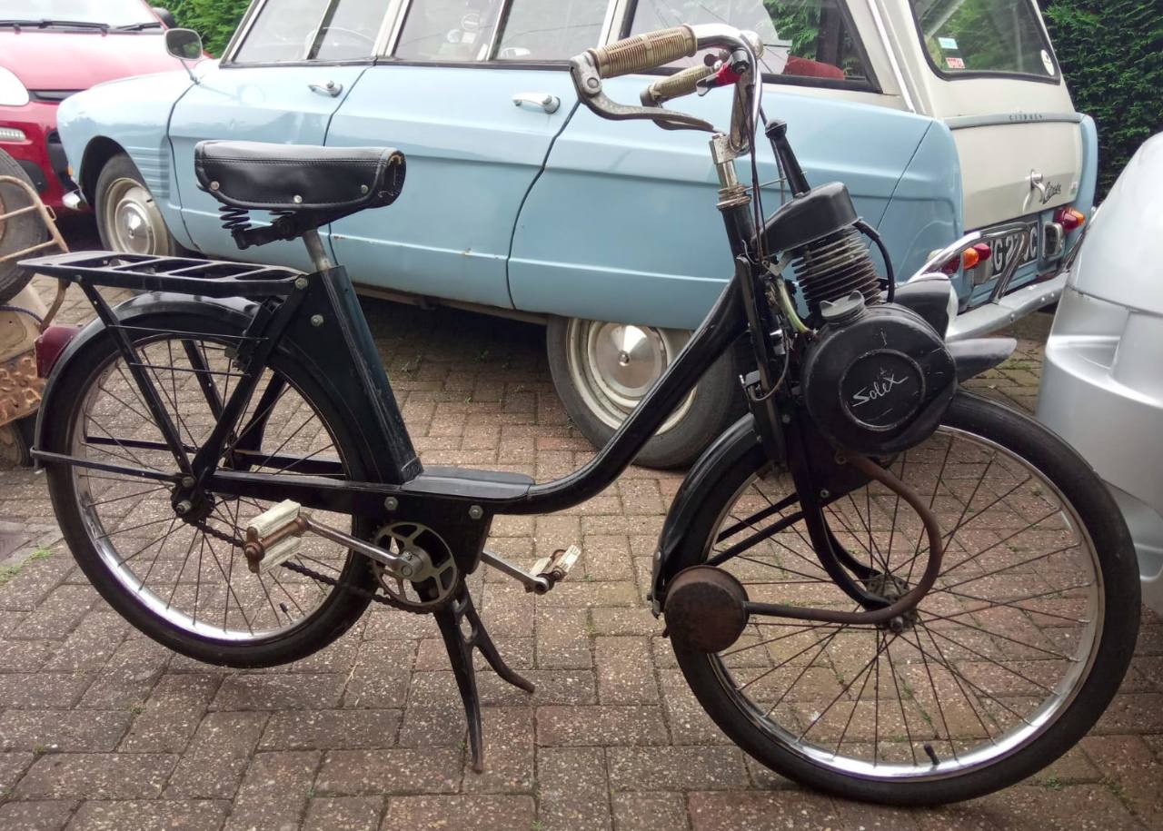

@UltraWomble here's my Velosolex, it's a 1964 2200 model. Original paint and everything!
52171126_WhatsAppImage2020-08-15at12_30_25.thumb.jpeg.d0d0ea6093756400b7e657d910130305.jpeg
That looks like enormous fun to wobble home from the pub* approved non alcoholic beverage serving social venue, on

I'll echo the sentiments - seems like a waste. Im assuming the lease company at some point will dispose of them en mass via the auctions or some such?

I'm guessing some will be bolloxed, others maybe still OK and they'll all get punted through the local auction house for not much dosh... I could spend a happy hour or two in there with some spanners trying to make one good one out of the wreckage!

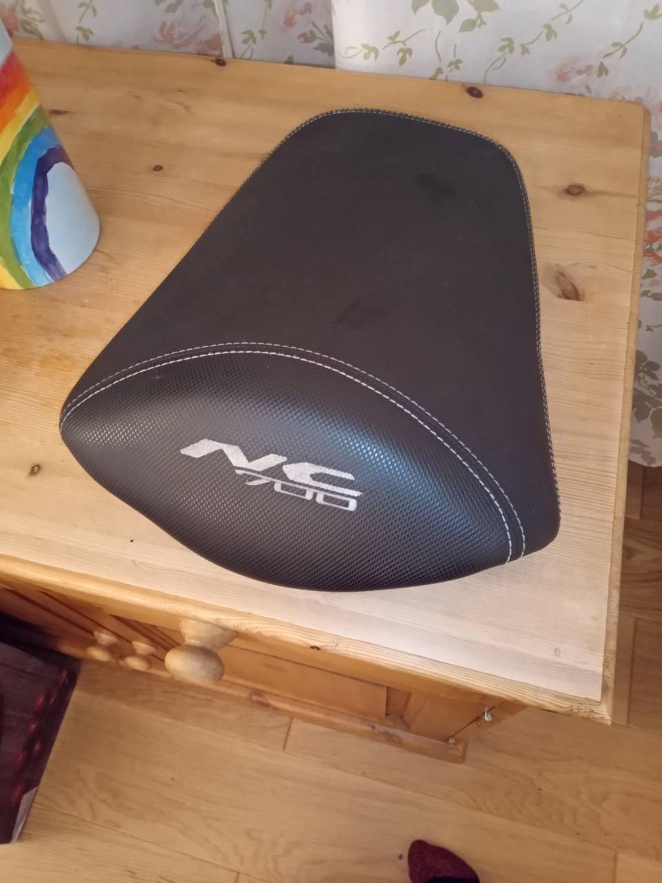

for sale
nc700x pillion seat  - chap i bought from said he had it on nc750x
shad gel version
i dont carry pillions and i bought this with the front which is the only bit i want
it also has nc700 embroidered  into it so im def not fitting it :D

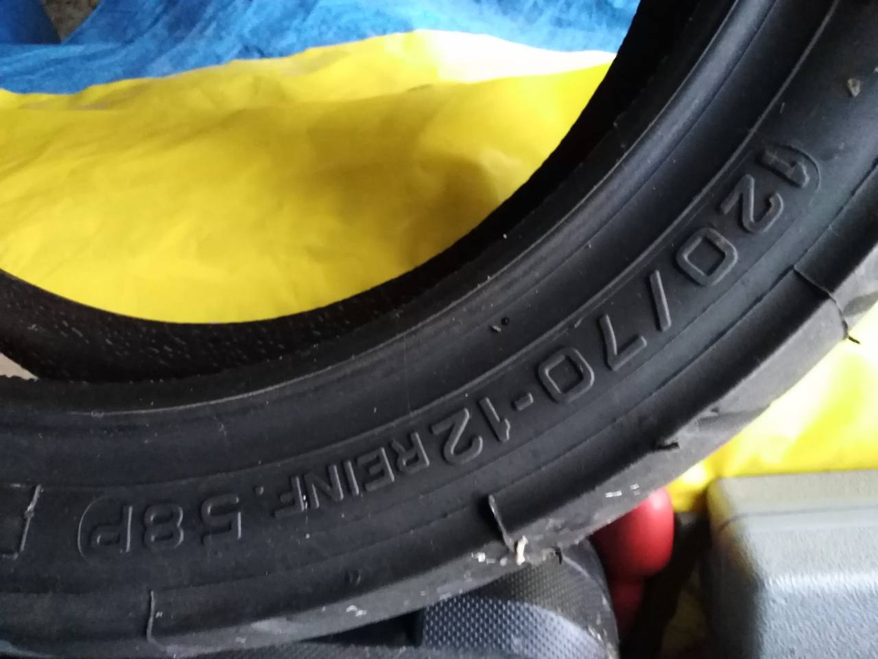

Are any of you lot tight enough to change your own tyres, and if so do you balance them?
Have got a 12" tyre here for the rear of my new scooter, was going to get the levers out and do it myself as I had read that you don't really need to bother with bike tyres. But it has quite a few weights on the old wheel?

Right the tyre is on at least.
It was quite hard work so I can see how a 10" wheel would be almost impossible.
I've left the weights on it as they were opposite the valve so maybe they are balancing the wheel more than the tyre? It's a Michelin POWAH pure SC which didn't have a spot on for the light bit, some reading suggests that Michelin don't put dots on any more, maybe tyres come better balanced than they used to?
Anyway one thing I did learn is you can't seat a tyre like this with a footpump, no matter how hard you pump.

Inspired by these words I had another go but it's nowhere near, the most I can manhandle the tyre onto the bead is about 60% of one side and I just think the air is leaking out as fast as I can put it in, the tyre is quite small and stiff. Needs a big burst of air at once to get it over the line I think.
Top tip, take the valve core out when you reinflate, kneel on the tyre top and use a lot of neat washing up liquid, it'll go even with a footpump.

Ratchet strap around the circumference if you have one or some rope and a stick to tighten it.
Also pull the centre of the valve out if you haven’t already otherwise you’ll never get the air in fast enough. Then pop the centre back and jobs jobbed.
Valve was out, I wasn't using a ratchet strap, I don't have a compressor any more (did have until recently but sold as it was in the shed never used.)
I was thinking about going out and buying a compressor earlier but instead scored some free fire extinguishers, emptied out this one and bodged a valve in the hose.
80psi with my track pump in the fire extinguisher and on she popped.
Still a lot of work to pump the bastard up to pressure so will be keeping an eye out for a compressor in the long term I think.
