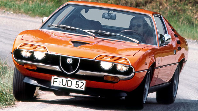

Captain Slow Posted October 7, 2016 Posted October 7, 2016 MoT fail. You're only allowed one dipped beam per side. You can have multiple high beams so long as they are symmetrical. Phil Surprised given that kits are actively marketed to do this to cars like the Stag - mine has the kit fitted and has never failed on it.
captain_70s Posted October 7, 2016 Posted October 7, 2016 There are some Doloshites running around with a quad light set-up but it's been discussed on the TDC forum and decided to be illegal. Having said that my Dolly 1300 has been passing MOTs despite the fact the dipped beams come on with the sidelights when they shouldn't for years.
worldofceri Posted October 7, 2016 Posted October 7, 2016 I passed a (modern) bus the other day that appeared to have quad dipped beam. Could have been driving on high beam I suppose, but I don't think so. My Renner 5 had dim-dip fitted (low intensity dipped beam comes on with sidelights) so lack of sidelight-only capability can't be an mot fail. Back on topic: Have you considered mounting just one foglight, centrally? anonymous user and tooSavvy 2

PhilA Posted October 7, 2016 Posted October 7, 2016 Hm. Sure I read it somewhere, but just perused the mot and construction and use and both only specify a minimum of 2 headlights mounted as a matched pair. Dim dip may not bring on sidelights but sidelights must be available on the front Lots of legislation nonsense. Most of it Junkman titled "1986". Phil RoadworkUK and Eddie Honda 2
Eddie Honda Posted October 7, 2016 Posted October 7, 2016 You can have a pair of obligatory dipped headlamps + a pair of optional dipped headlamps if pre 1991. (Unless they've done some mad amendments to the RVLR 1989) See schedules:http://www.legislation.gov.uk/uksi/1989/1796/contents/made
