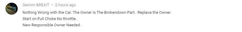

captain_70s Posted November 29, 2019 Posted November 29, 2019 2 hours ago, vulgalour said: Obviously, I'm pretty narked about the whole thing and feel monumentally daft for not knowing that a paper gasket had to be a paper gasket for engineering purposes. I'd never had considered it, to be fair. The clearance must be minuscule, surely you could achieve the same effect by tightening the bolts too much? Sounds like a shit bit of design to me... If it makes you feel better I got this gem of a YouTube comment today: vulgalour, Split_Pin and GrumpiusMaximus 1 2

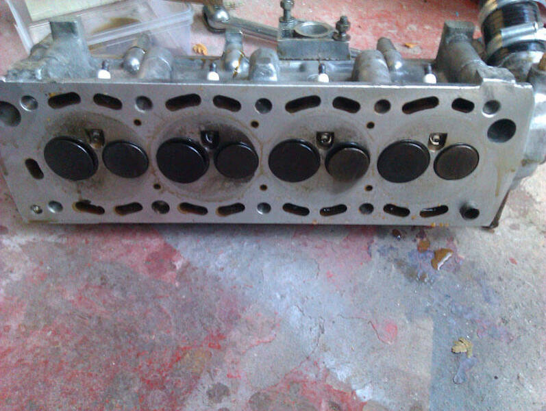

vulgalour Posted November 30, 2019 Author Posted November 30, 2019 TL:DR Engine running, oil leak appears on end plate corner. Tighten bolt, thread stripped out of head. Helicoil stripped thread, find end plate paper gasket is torn, use sealant instead since I haven't a gasket and didn't realise it was critical as a shim Try to start engine, several times, everything is turning together but the initial start must have jumped the belt and caused the problem. No compression. On inspection today, some of the teeth on the belt have rounded off edges which they didn't when installed, so new belt is definitely required. With all the above in mind, I can pinpoint the cause of this to my own ignorance with that gasket. Camshaft bound up against the end plate, timing belt jumped a few teeth, parts met other parts they shouldn't, compression gone. I've already got the head stripped down to a point it can be removed, I'm just waiting on the fluids draining out as fully as possible before I lift it and inspect more properly, and having some lunch, since this isn't the sort of job to be doing on an empty stomach. beko1987, mrbenn, JeeExEll and 9 others 11 1

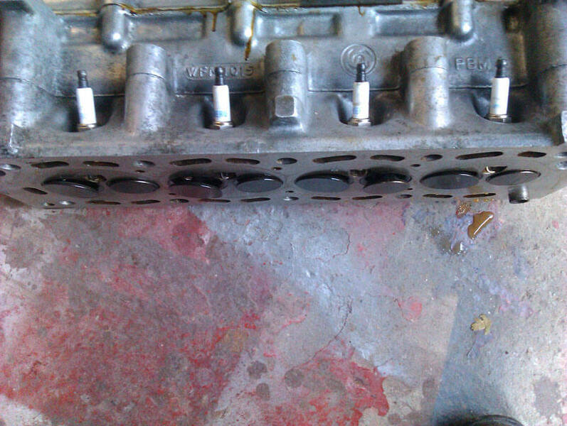

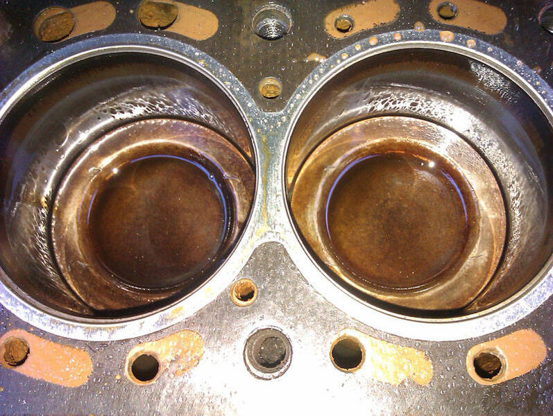

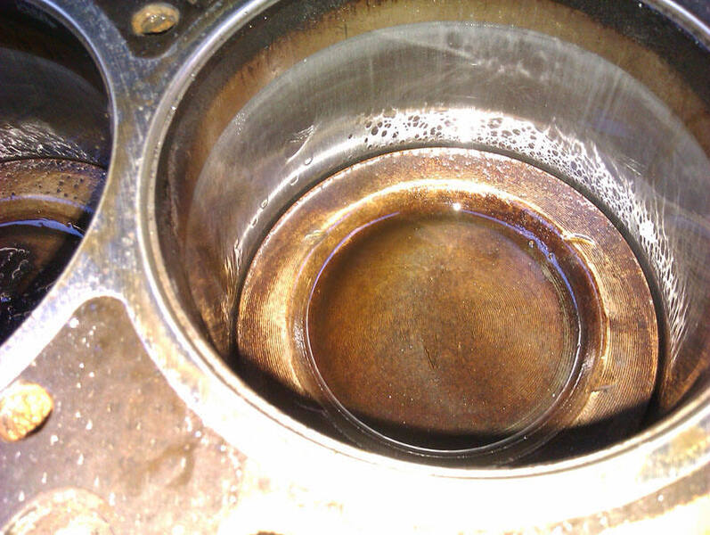

vulgalour Posted November 30, 2019 Author Posted November 30, 2019 The results are in. I've had the head off and already reassembled everything loosely so I don't lose any parts. That looks to me like eight bent valves. There's only one mark per valve location on the piston crowns so it looks like the one smacked into the other and the valves got bent out of the way. Usefully that's prevented further damage and hopefully the parts in my other head will sort this head out. Not this year though. Princess is now on SORN and will remain so probably for a few months until I'm in a better position to sort this. We've overcome bigger obstacles than this, so it'll get sorted. When I'm in the new house, I'll take this apart more fully to figure out what's needed exactly. To add to the irritation, two of the new hose clamps I fitted fell apart and had already gone rusty, and the replacement cold air duct hose I ordered was the wrong size, as in I ordered a hose that was specifically listed as 60mm inner diameter, which is what I need, and it's actually 55mm, so doesn't fit, even the external diameter isn't 60mm, being 63mm. You can't stretch the hose because it's a metal spiralised cardboard thing, so the only way to get it to fit was slot one end and put it inside the air box connection. It also doesn't clamp properly in the inner wing clamp that stops it flopping around, so that's another waste of money on an item I couldn't find in a shop and had to order online. This whole saga started with replacing one heater hose that had an age related pinhole in it, after which the head gasket blew, I then got messed around with a custom part for 2 months that, when made, was wrong, and have had a string of incorrect parts and faff because I've had to order stuff online and hope what I'm getting is what's actually being sold. There have been times I've been so frustrated I want to give up and this last mistake hasn't helped with that. At this point the only reason I'm persisting is, I think, stubborness. I'm certainly not doing any of this for the joy of old car ownership, right now there is no joy. mat_the_cat, HillmanImp, Mrs6C and 4 others 7

Parky Posted November 30, 2019 Posted November 30, 2019 Looks a straightforward enough fix though, even if you don’ t feel particularly motivated right now. I had read about a method to hammer valves straight again... richardthestag and stonedagain 2
junkyarddog Posted November 30, 2019 Posted November 30, 2019 You're showing an amazing amount of restraint! If it was mine I'd have bludgeoned it to death with a sledgehammer !! BorniteIdentity 1
richardthestag Posted November 30, 2019 Posted November 30, 2019 4 hours ago, vulgalour said: The results are in. I've had the head off and already reassembled everything loosely so I don't lose any parts. That looks to me like eight bent valves. There's only one mark per valve location on the piston crowns so it looks like the one smacked into the other and the valves got bent out of the way. Usefully that's prevented further damage and hopefully the parts in my other head will sort this head out. Not this year though. Princess is now on SORN and will remain so probably for a few months until I'm in a better position to sort this. We've overcome bigger obstacles than this, so it'll get sorted. When I'm in the new house, I'll take this apart more fully to figure out what's needed exactly. To add to the irritation, two of the new hose clamps I fitted fell apart and had already gone rusty, and the replacement cold air duct hose I ordered was the wrong size, as in I ordered a hose that was specifically listed as 60mm inner diameter, which is what I need, and it's actually 55mm, so doesn't fit, even the external diameter isn't 60mm, being 63mm. You can't stretch the hose because it's a metal spiralised cardboard thing, so the only way to get it to fit was slot one end and put it inside the air box connection. It also doesn't clamp properly in the inner wing clamp that stops it flopping around, so that's another waste of money on an item I couldn't find in a shop and had to order online. This whole saga started with replacing one heater hose that had an age related pinhole in it, after which the head gasket blew, I then got messed around with a custom part for 2 months that, when made, was wrong, and have had a string of incorrect parts and faff because I've had to order stuff online and hope what I'm getting is what's actually being sold. There have been times I've been so frustrated I want to give up and this last mistake hasn't helped with that. At this point the only reason I'm persisting is, I think, stubborness. I'm certainly not doing any of this for the joy of old car ownership, right now there is no joy. fuck sticks! I feel for you mon brave - but it is fixable for the cost of a set of valves and some lapping in. make sure that all pistons crown - i.e. right to the top of the bore Good luck with house move vulgalour 1

MikeKnight Posted November 30, 2019 Posted November 30, 2019 2 hours ago, richardthestag said: make sure that all pistons crown - i.e. right to the top of the bore That's a damn good point. Making sure there isn't any damage to the conrods. Are these wet liner engines? I forget. If it's just a solid block then you don't have to worry about any liners moving.
Mr_Bo11ox Posted November 30, 2019 Posted November 30, 2019 dont think theres any liners on these old shonkers, the bores are just machined straight into the block
vulgalour Posted December 1, 2019 Author Posted December 1, 2019 No liners, happily. Lower mileage O series lumps do come up for sale now and then because nobody wants them so I'll be keeping an eye out for one of those too, just in case. Should've given the crankshaft a twizzle when everything was apart, didn't think to. Ah well, I'll do it post house move.

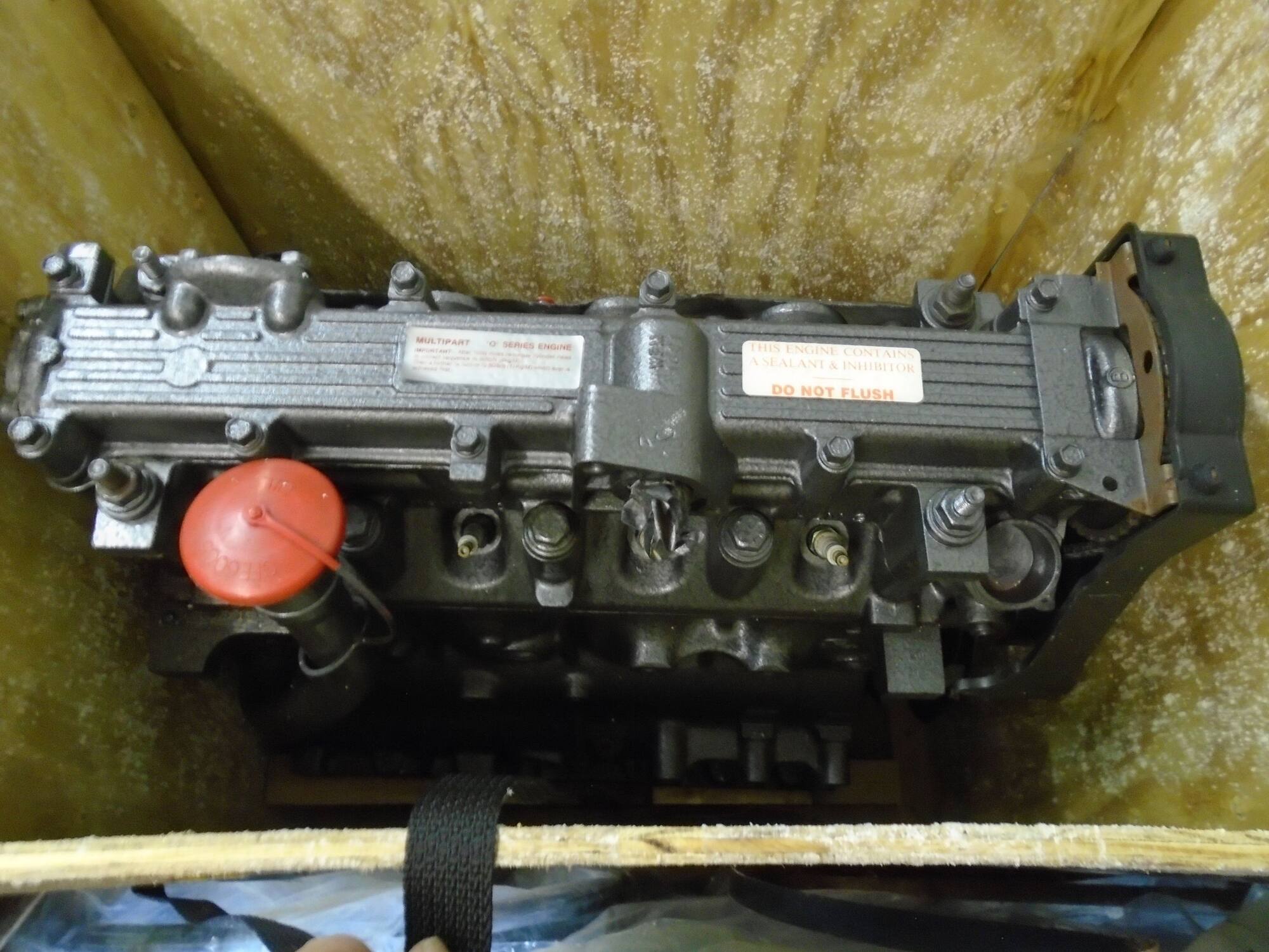

Asimo Posted December 1, 2019 Posted December 1, 2019 New engines still available...... https://cabmasters.com/vans/van-engines/bl-o-series-engine Mrs6C, stonedagain, steveo3002 and 4 others 7

vulgalour Posted December 1, 2019 Author Posted December 1, 2019 Looks like they did a mod on the old waxstat housing similar to what I've done. Also, their information that the 1.7 isn't unleaded friendly but the 2.0 is contradicts the information I was given and the fact I've been running my 1.7 on unleaded with no bother on that front for a few years now. I also hate that the whole thing is painted in hammerite... THAT SAID, it's a useful resource to bookmark for the future, so thanks for the tip off!
somewhatfoolish Posted December 2, 2019 Posted December 2, 2019 Given the 1.7 and 2.0 share the same head the claim one can use unleaded and one can't is baffling. stonedagain 1
