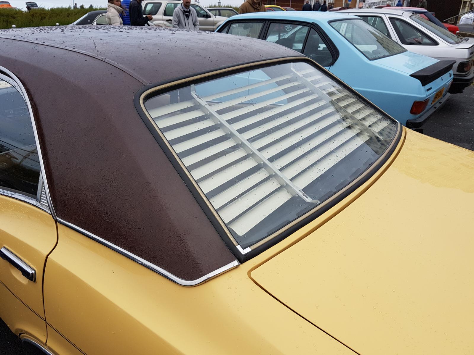

fordperv Posted September 30, 2018 Posted September 30, 2018 Those lights look the business! Really suit the look.What about an E-Type fantail exhaust?And internal louvres?You can still get them custom made here in Australia, I’ve been tempted to get some for the Jag.http://www.autoshades.com.au/Internal louvres do look cool but can't help to think they look like venetian blinds, this is on a South African mk3 cortina I saw a couple of weeks back MorrisItalSLX and oldcars 2
plasticvandan Posted September 30, 2018 Posted September 30, 2018 Been following the princess for some time,mostly with a " what the fuck is he doing" expression as we've gone through lights,bumpers,trim,colour changes.now I see why.I commend you for having a vision in your head and the patience of a saint to keep going until it was realized The Reverend Bluejeans and mercedade 2
MorrisItalSLX Posted September 30, 2018 Posted September 30, 2018 Internal louvres do look cool but can't help to think they look like venetian blindsYou say that like it’s a bad thing? bolognasal spray 1

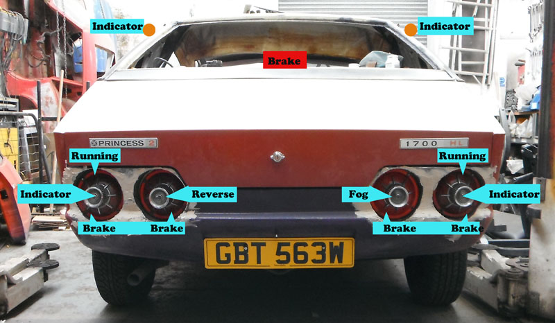

vulgalour Posted September 30, 2018 Author Posted September 30, 2018 Also, for those wondering, here's a handy diagram. coalnotdole, GrumpiusMaximus, oldcars and 14 others 17

vulgalour Posted October 1, 2018 Author Posted October 1, 2018 Noel: it's safety I'm thinking of by only have 2 running lights because then it makes the FIVE brake lights more visible by contrast.
