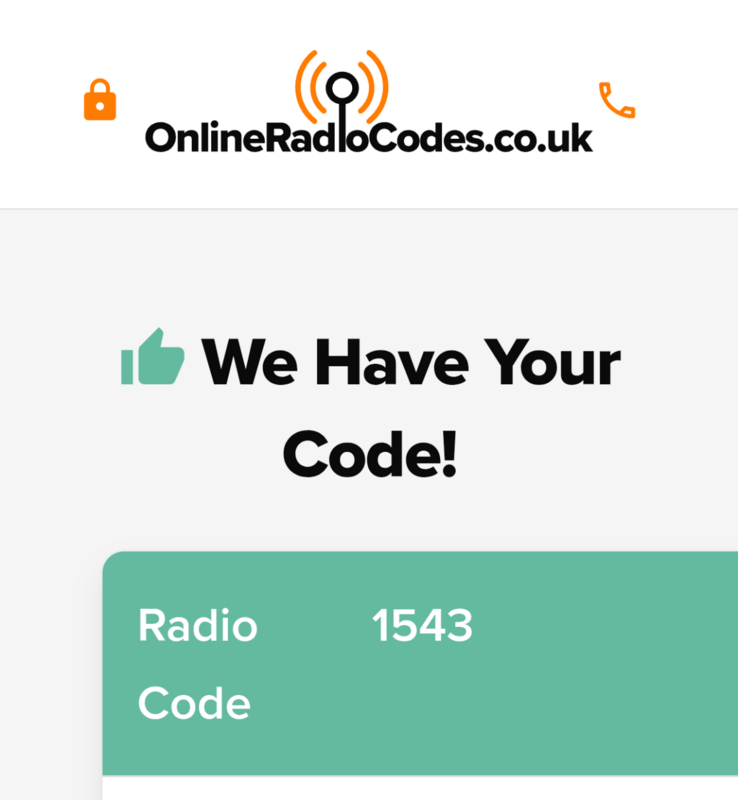

Frustrating day yesterday. I wanted to get on with wiring new speakers in but couldn't get in to the car. The remote fob wasn't doing anything and although the ignition key went into the door lock it wouldn't turn. Once I'd got the fob apart I found it takes two CR2016's so the CR2032's I had wouldn't do. Next door neighbour gave me a lift into town to get new batteries and once fitted I could access the car again.
Strange that the key won't unlock it - not sure if something's broken or if it's had a new ignition barrel or door lock at some stage.

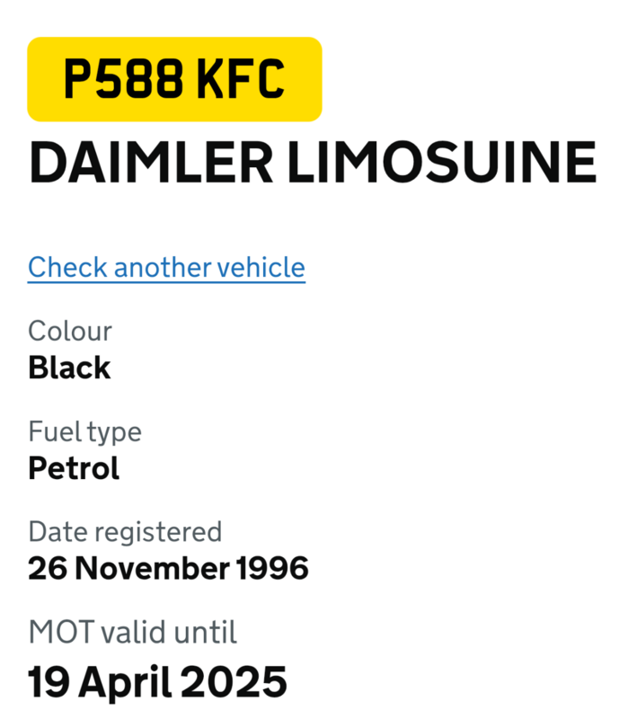

When I checked the MOT date I discovered the DVLA checker has it as a "Limosuine" - paging @LightBulbFun.

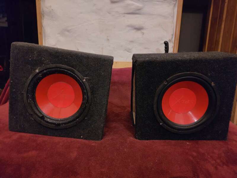

Converting the Daimler to a hearse removed the rear speakers along with the rest of the back of the car. The standard stereo is only going to the tweeters on the dash and the speakers in the front doors. I'm hoping the rear speaker wiring is still present behind the stereo and it's a relatively easy job to wire them in. If the stereo isn't powerful enough to drive them I might consider an amp as this car needs bass.
I've got a Bose amp and Alpine sub in the garage if you're after BASS Jim 😂

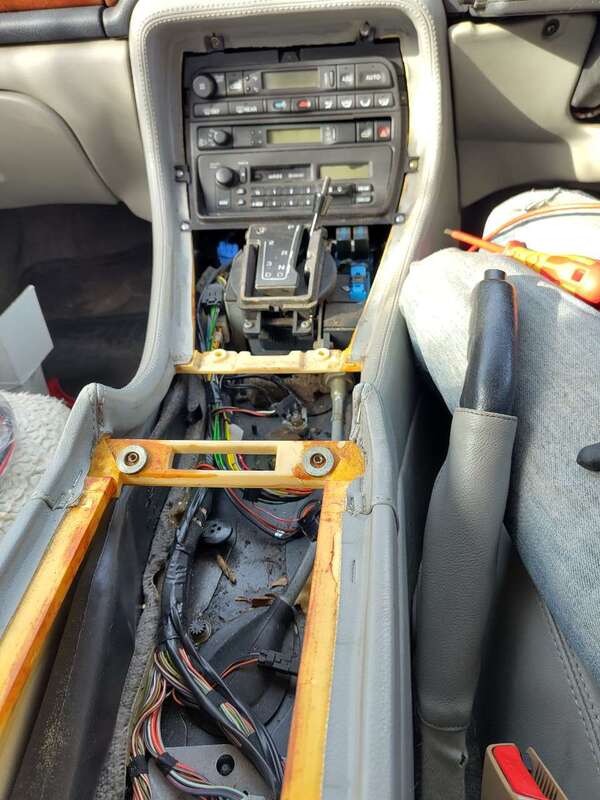

Then it was on to fitting some extra speakers to expand the bass quotient. I thought it would be a quick job to pull the stereo out to access the loom - Jaguar had other ideas. Fortunately I have a workshop manual so set about the correct process.

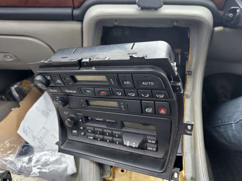

Bit of a ball ache, all this has to come out to access the stereo. Looks like whoever's been in here before wasn't too careful - 4 out of the 6 tabs that hold the unit in place were bust.
And finally out it came.
I didn't have the tool to re-pin the multi plug so opted for wagos to join the new speaker cables.
I was able to run the cables through the ski slope as I had it all open - they now emerge under the vents at the back of the centre console. Dropped a couple of bass bins in the rear footwell and wired them in.
It's not my first rodeo so I opted to test before putting everything back together. Switched on the stereo to be greeted by silence and 'CODE' flashing on the display. Shit! What's the code? I'd unplugged the multi plug on the back of the stereo while I was working. It wasn't written on the stereo and I have no paperwork with the car - fuck! Thanks Google:
Done the next person a favour:

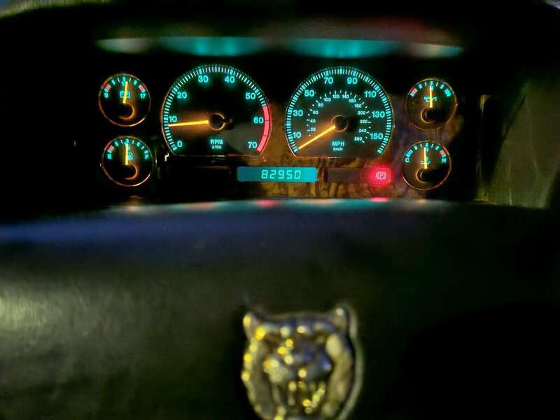

IMG_20250202_101305.thumb.jpg.5bde42a1ce755ab939343a5803d98486.jpgFinally switched it on to be met with farty, crackling hiss.
That'll be why then - looks like they've not survived spending the last decade in my shed. Fortunately I had another box with two 10"s in that do work so they'll have to do.

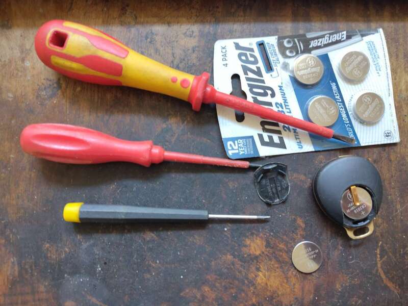

I then set about putting it all back together. It was only when I switched the ignition on that I realised I'd forgotten to plug in the unit with the clock, hazards and a bunch of other stuff. I then realised I'd been at it six hours faffing about with codes and testing duff speakers working one handed and hadn't stopped for anything to eat or drink so called it a day.
Got back on it this morning, pulled the centre console apart again, plugged in the clock and then put it all back together again. (I'm getting good at it now). Took the opportunity to run a phone cable behind the wood veneer. I'm using one of those transmitters powered off the cigar lighter to get tunes off my phone. Success!

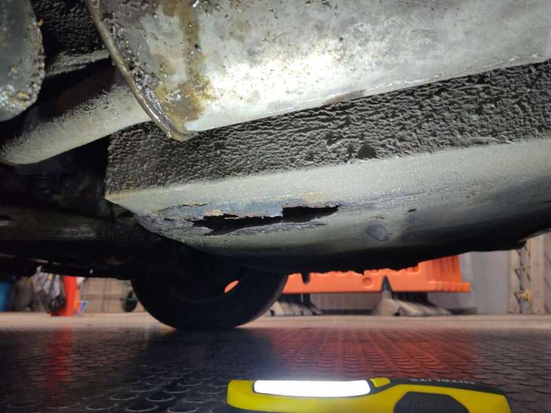

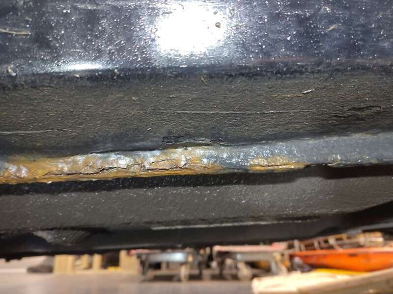

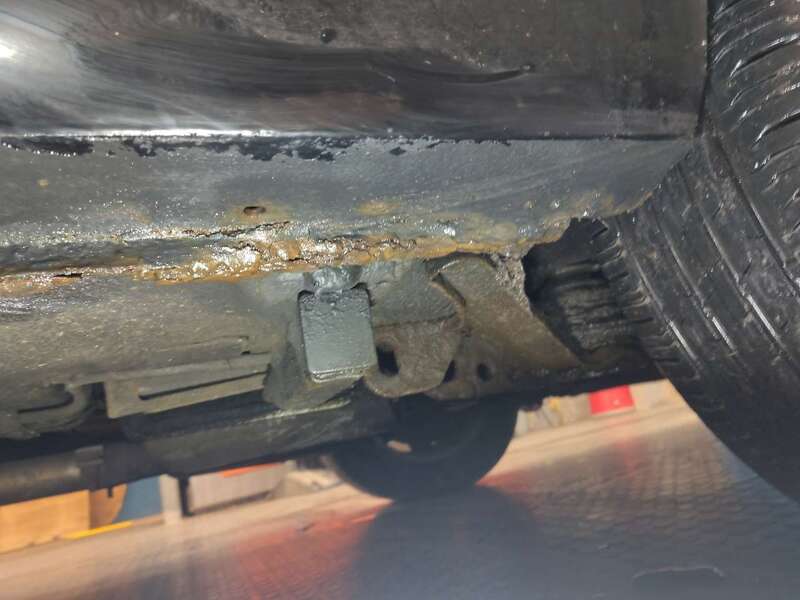

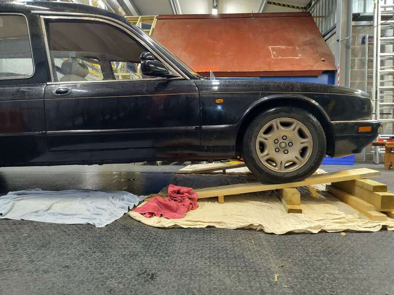

Finally got a chance to get this up on some ramps and have a look underneath today.
O/S sill
Flakey but hopefully saveable here but it gets worse further back where it looks like previous patches have gone again and there's a couple of holes in the driver's floorpan.
The boot floor has gone both sides too.
N/S sill is simarly crusty but no holes that I can spot.

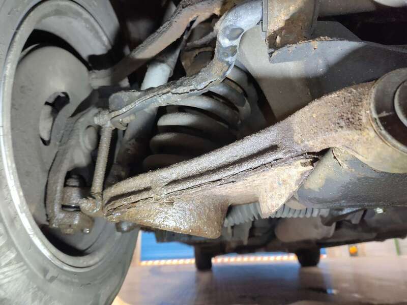

Both spring pans aren't looking too clever and neither is the anti roll bar.
The question is whether those sills can be repaired when they're in such close proximity to the fibreglass body? I'll see what the welder says on Thursday.

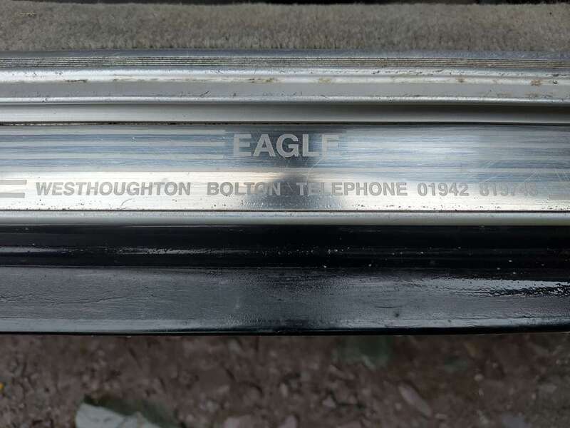

I'd been wondering who'd done the conversion but hadn't spotted a maker's plate anywhere. It was only when I was prodding at the sills today with my glasses on that I spotted the sill cover.
Eagle Special Vehicles still exist although they've moved site now. I'll fire them off an email and see if they'll give me any info or drawings of the conversion.

Just sent an email to Wilcox Limousines, the funeral vehicles side of Eagle Specialist Vehicles who did the conversion to see if they can send me any info. Perhaps a bit of a long shot after nearly 30 years so I tried to adopt a suitably polite and funereal tone:
Dear Sirs,
I am the present owner of a Daimler 6 Hearse registration P588KFC, chassis no. SAJJFALD3BJ785071 which was converted by Eagle in 1996. It's a lovely vehicle and a testament to your work but will unfortunately require some welding repairs to the sills before its next MOT in April.
I realise it was nearly thirty years ago but I was wondering if you might be able to furnish me with any details of how the vehicle was converted including any photos or drawings so I will better know how to carry out the repairs. I hope to be able to keep this part of our motoring and funeral services heritage in a serviceable condition for many years to come.
Many thanks, Jim

Dropped the hearse off for Roy the welder to assess today. North Wales doesn't have much in the way of railway arches, his place was a shed on the site of an old quarry. I went to pick it up this afternoon and Roy  greeted me with, "Bad news, I can't do it." Shit I thought as my brain started going into catastrophising mode. Roy paused a couple of beats and then said, "I'd like to do it and it's definitely saveable but it's too long for my lift and I'm too old to roll around on the floor outside doing it."
Ok, down but not out. He'd said he'd phoned a mate at another garage with a long enough lift whose boss would let him do it for cash out of hours. Initially I thought this sounded a bit sketchy but it turned out it's the garage who I get to service and MOT the minibuses at work. I know the owner and the mechanic who'll do the welding - I hadn't even considered them for the work given their usual hourly rate.
I popped into see them this evening and they put it on their lift. Most of the length of both sills just need the flaking underseal wire brushing to tidy them up but the front of both sills will need rebuilding. Then there's two patches to the driver's footwell and the boot floor sorting.
If I do the removal of carpet and trim and remove the underseal around any areas he had to work on I'm looking at a ball park figure of £350 which doesn't seem too bad. I've seen the guy's work and it's good, not just crudely tacked patches to get something through an MOT.
So it'll live! Once the welding's sorted I can get back to the fun stuff of the camper conversion. Came out of the local Co-op the other day and saw a bloke admiring (oh all right, looking at) the hearse. Turned out to be a fella I used to know years back who's now a cabinet maker. He's happy to saw the veneered wood for me, something I'd be worried about cocking up.

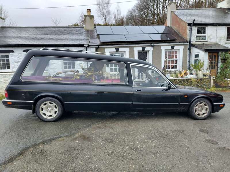

Spotted!
Must say it's a big thing but it doesn't hang about. Struggled to keep up in the berlingo (to be fair, that's not exactly news, I struggle to keep up with pedestrians sometimes)
