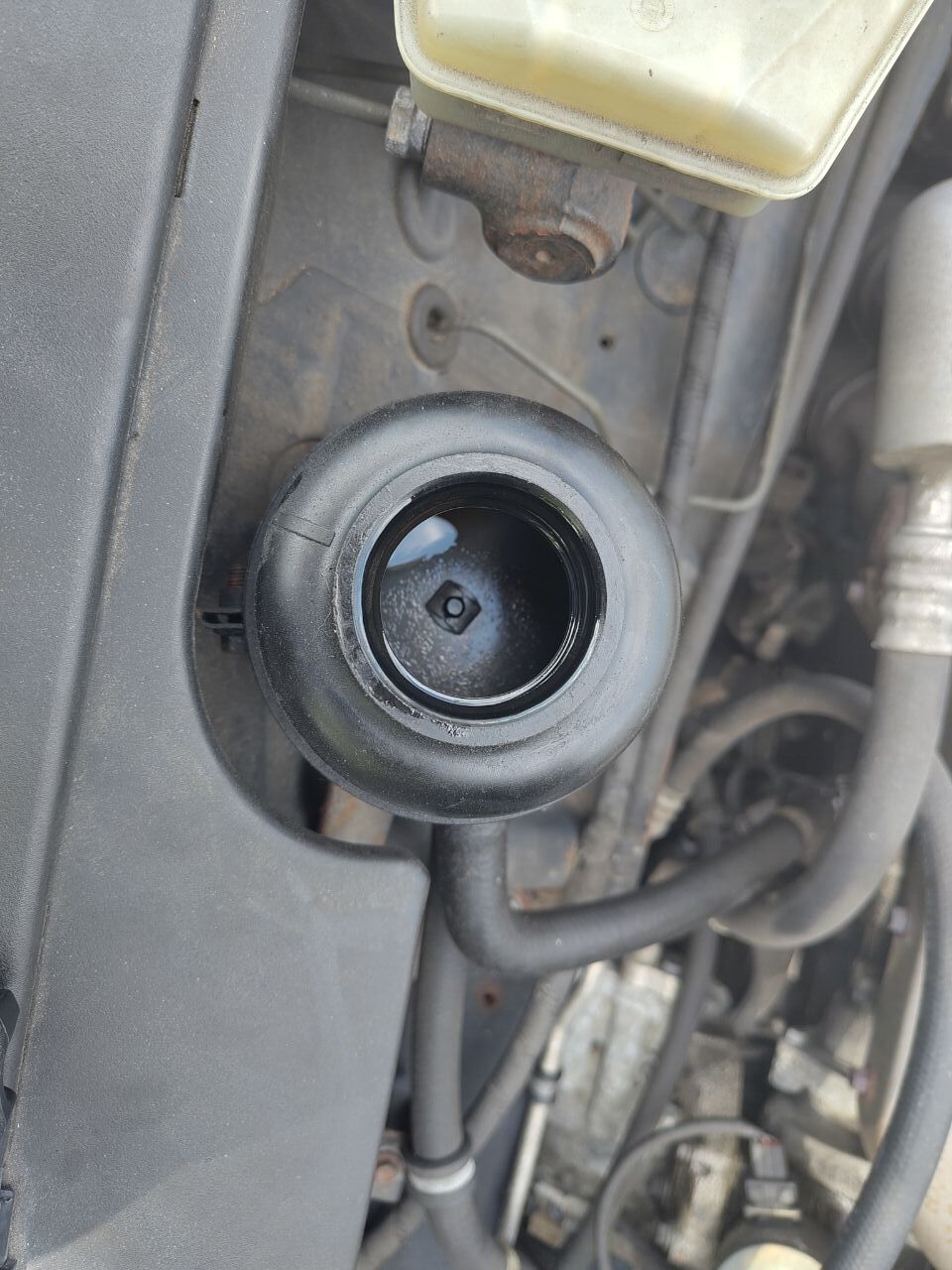

Seeing as the hearse is being pressed back into use whilst I get the spring on the C15 sorted I decided I should address some of the bits that need sorting on it. It kept losing coolant but never overheating or leaving a puddle when parked at Twixfest which had me stumped. @Talbot spotted that the coolant level sensor had popped out of the bottom of the expansion tank which explained why the low level light was staying on even after I'd topped up the expansion tank. He pushed it back in and it seemed to locate with a reassuring click. However half an hour down the M6 on the way home once the system was fully up to temp and pressurised it popped out again. Being a fully unqualified bodgineer I artfully applied some cable ties to hold the level sensor in place.
That got me home but I'd only slowed the leak rather than completely curing it as the low coolant level light came on again on Monday morning. £30 got me a tested s/h tank and a new sensor so as it was still light when I got in this evening I decided to get at it.
Old one out with only a few drops of coolant spilt and new one in.
Fortunately there's no shortage of hills round here to aid the bleeding process.

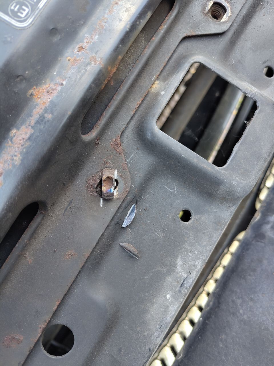

Made a start this afternoon. Unfortunately managed to strip three of the torx fixings.
Fortunately got them loose enough that I could move the bracket enough to get the radiator out.

Armed with new bushes I finally got round to fitting the new radiator this weekend.
When I was removing the old one I managed to mangle three of the torx bolts the held the top bracket in place. I left this as a problem for future me as I could still remove the old rad with them in place. The problem caught up with the future me yesterday when I discovered that with the new bushes in place the new rad couldn't be fitted with the top bracket in place.
The bonnet wouldn't open wide enough for me to comfortably get a grinder in to chop the bolts. Fortunately as I was at work I could grab a couple of adjustable lanyards which allowed me to pop the bonnet off its stays and tilt it to an optimal angle.
Whizz, whizz chop, chop.
With the bracket removed is was relatively simple from there on in and it didn't take me long to get everything buttoned up. The power steering circuit goes through the radiator and as I wasn't sure how much fluid I'd lost I'm glad I remembered to check the reservoir before starting up.
The internet told me I needed as fully synthetic atf. As it was after midday on a Saturday in North Wales there was nowhere open that might have any. I didn't want to chance damaging the pump if I started the engine. Toolstation could get me some by Sunday morning so I called it a day.
Collected the precious fluid this morning and topped it up.
Started first time and came up to temp with no leaks or drips (visible anyway!).
