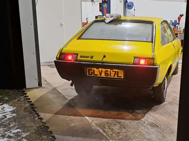

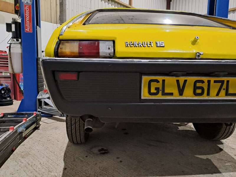

Proper back box went back on today.
Sounds a bit less like it has a big hole in it now.👍

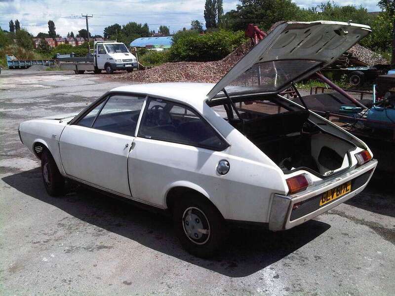

A pic of the car in 2010 was posted on the blue forum.
Just this one image gives some idea of how its been fucked up over the last 14 years. 🤨

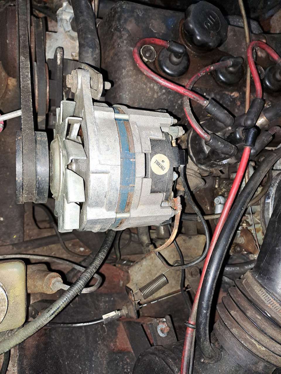

Looking at replacement alternators, I can source one in Germany at considerable expense. Does anyone have any recommendations for a place that can refurbish obsolete French electrical equipment?

It's only a basic alternator, there must be loads that would fit, surely?
I could cobble something together for sure, but as I intend to restore it, I want to use original mounting tackle and components so it looks right. (I'm a bit sad like that) 😀

Replacement diode pack, or get it overhauled? Any auto motor fettler should be able.

Alternator is away being looked at by a bloke that used to work on this sort of thing when they were current.

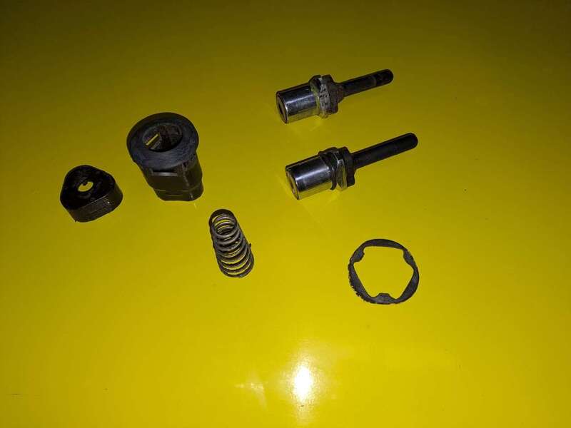

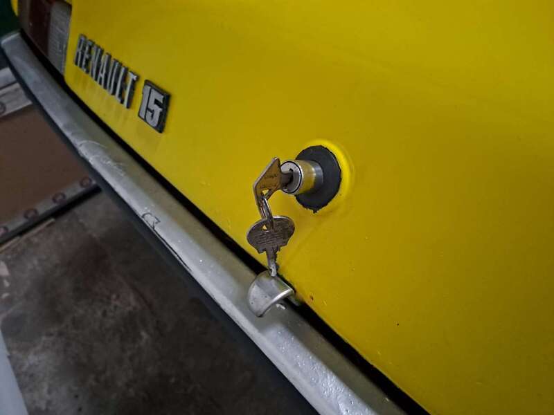

When rooting through the boxes of junk the other day, I found what must be the original boot lock. (It takes the same key as the locks on the doors)
After working out how to remove the old one, it was pretty straightforward a job.
It all went back together nicely, so now we have a matching set.
Another small job ticked off a huge list.👍

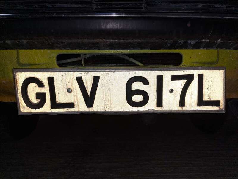

Sadly, front and rear don't match. The G is a "rounder" font on the front.
They're both proper 70's plates though. 👍

its all part of that proper period look :) that is sadly often lost when a car is restored. Funnily enough my good friend Stuart who is an even bigger number plate nerd then I am noticed the difference and had this to say on it
Quote
btw, that reggiy 15 on as, rear plate is ace, front is I reckon one of those almost sandalloy but not, nor NPC plates as yet unidentifiable
if you get a close up of the front perhaps it might be identifiable? :)
I'll get one tomorrow chief.👍

Alternator bloke was unable to find any parts for the non functional original one. I did manage to find a like for like replacement in Germany though.
Now it shows 15.5V at the battery when running - I probably need to find a new voltage regulator too. 🤔

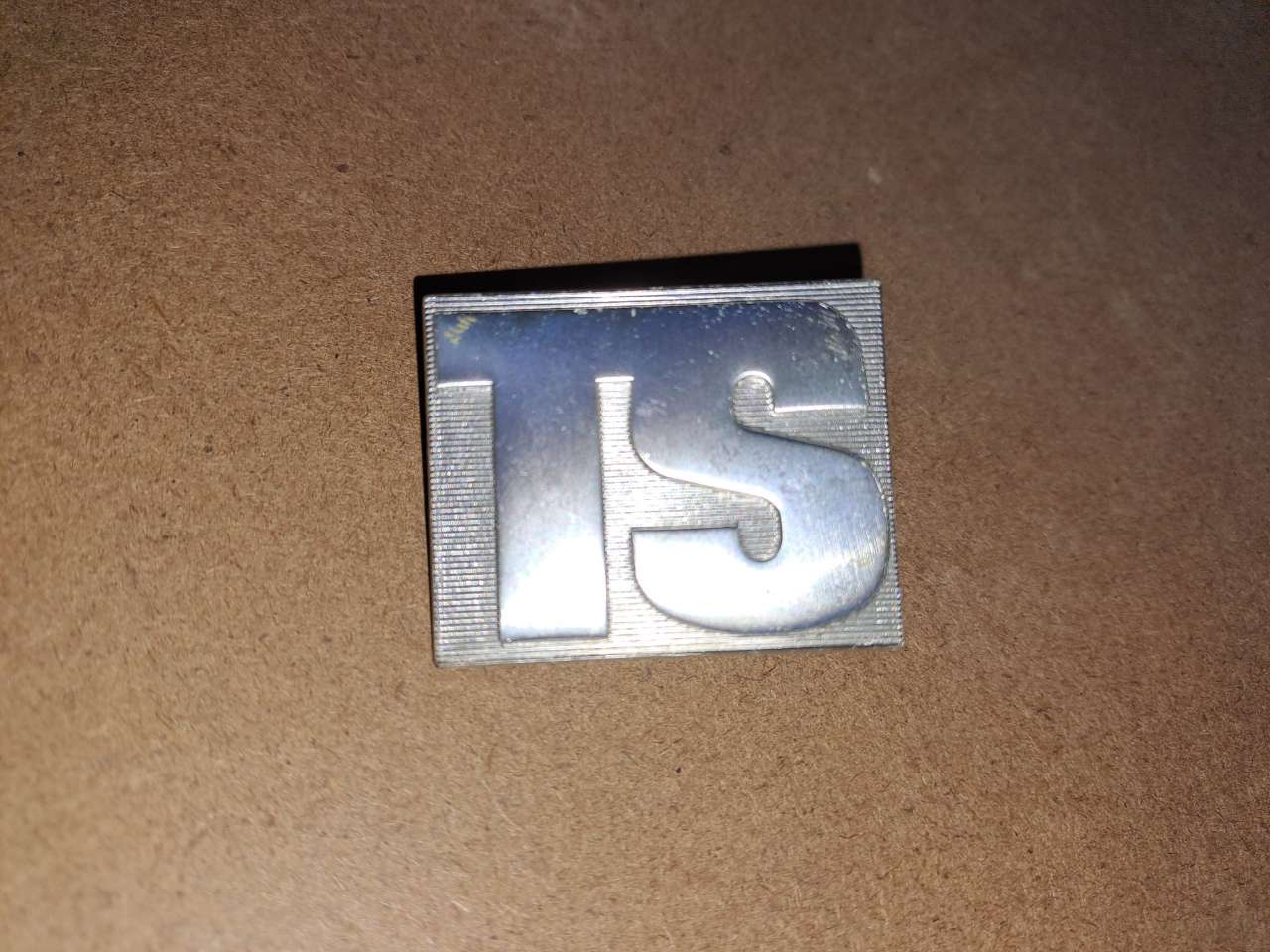

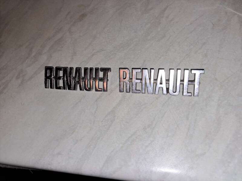

In other yellow French shitbox news, my missing TS badge turned up via ebay.
No more badges required. 👍

A kind bloke on a French forum helpfully explained how my voltage regulator can be adjusted.
I just turn the wheel a little until the desired voltage at the battery is read. Every day is a school day. 😀
2 hours ago, 4wheeledstool said:
1600. 👍
So they realised that a component might wear out over time and built in some adjustment, how wonderful!
Nowadays you're likely buying a new alternator.
From personal experience of French, do check the voltage regulator has a properly good earth or they can do strange things.
