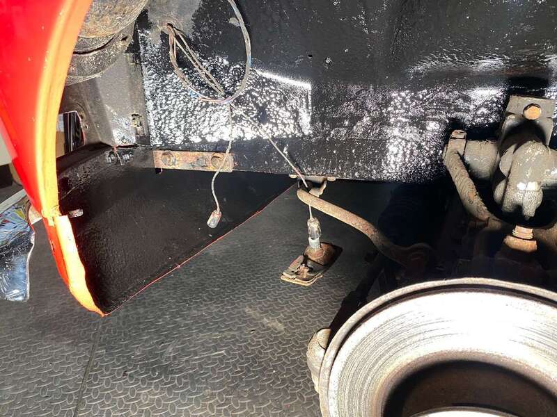

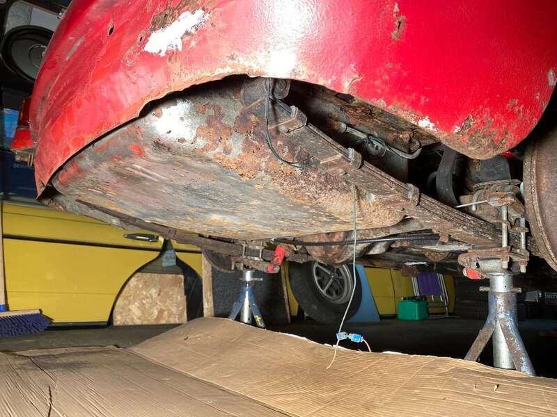

I've made a fair bit of progress with the MGB over the weekend.
As proposed, I have covered up corrosion with metal patches secured with adhesive and rivets. I spread the adhesive that squished out from the sides over the edges of the repair patches to seal the joints. I have overcoated all patches with Rust-Oleum paint. None of the patches are anywhere close to a suspension mount, jacking point, seatbelt mount or a major structural element (like a chassis leg, for example). The outer sills are 100% solid. The bottom edges of the sills are nice and straight, there is no evidence of any rust or previous repairs. The inner sills and floorpans have been coated with underseal in the past, which is rock hard. It would take days to hack off the old underseal, so I've left it alone. Poking the underseal did not reveal any crispy metal. Where the underseal had debonded from the metal, I have found plenty of surface corrosion but no rot.
Whilst cleaning and preparing the underside for overcoating, I discovered previous welding around the rear spring hangers, back of the rear arches and along the bottoms of the front bulkhead, on both sides. Some of the welding isn't amazing but everything looks solid.
Along the front, I have painted the front valance and tidied up a few areas where the paint had weathered.
Before painting:
After painting:
Chrome reinstated.
I did the same around the back. I straightened the damaged valance and filled a couple of small rust holes.
Before painting.
After painting with the bumper reinstated.
The fuel tank was affected by surface corrosion and horrible red overspray.
I cleaned up the corrosion and painted the fuel tank silver, to match the original colour.
Front arches.
Front valance, which I suspect is a replacement panel as it is immaculate (no rust).
Rear arches.
Floorpan and sills.
Whilst looking underneath the MGB, I noticed that the rear leaf springs are relatively new, as are some of the front suspension bushes. The fuel pump also looks brand new. The offside rear brake cylinder nipple is shiny and fresh and the clutch master cylinder is new. For a car that (presumably) has spent a long time in storage, it benefits from numerous new parts. Nice.
More soon.

I've fitted new front side light / indicator units and plumbed them into the loom.
