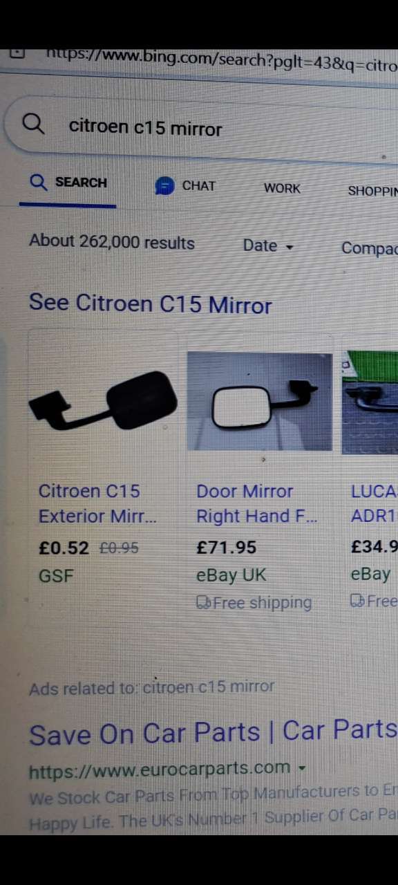

Fun fact: the C15 mirror is the same on both sides. The mirror head is just rotated to suit whichever way its arm needs to point.
I think that you eventually get used to the view in the mirrors but it's a few years since I drove ours. I certainly agree about the rot and Dean can no doubt testify after finding loads of my bodges, fixes etc.etc..
Box profile in the wing mirror has never bothered me before now. Maybe now you've drawn my attention to it will - a bit like the time @wuvvum mentioned seeing the wires in a Ford heated windscreen - never noticed them before but next day driving the Puma there they were, once seen can't be unseen.
Fun fact: the C15 mirror is (was) very cheap at GSF
Yes. I did buy one to make sure it wasn't a mistake.

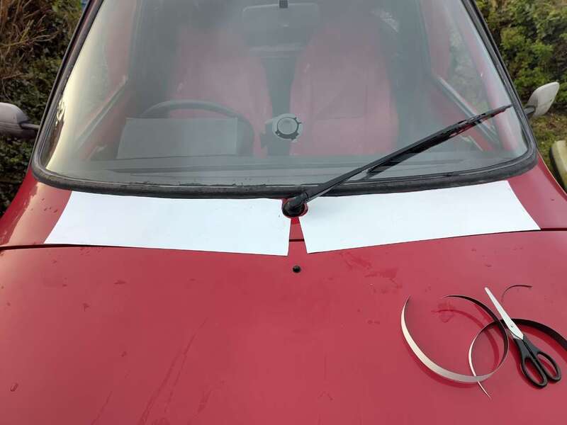

I was hoping for a more satisfactory result. Removed the panel as per Dean and Mrs6C's instructions and it was actually pretty clean in there and no sign of a blockage. I rodded the drain tube with a piece of cable and it didn't feel like there was any obstruction so I poured water through the grille and it drained away fine.
I'm at a bit of a loss as to why it should have leaked as there's no sign of a blockage and the drain is still at the lowest point in spite of the slight angle the van's parked at. I've left the carpet up for now and I'll see what happens after the rain we're forecast for tomorrow. Perhaps the solution is to try and level my driveway?

Water - it may just have been more rain coming in than going out. I'd just cover it when you park.
The only other thing I can think is the door seal - the doors drop because the crude pegs in the hinges either wear or move - take a look and wack them back in with a blunt instrument. 🤣
Thanks @lesapandre but the rumbling pitch and volume is definitely road speed rather than engine speed dependent. I'd ruled out the door seal as the water ingress stopped when I covered up the grille so I'm fairly certain that's where it was getting in.
Even by North Wales standards we've had some particularly heavy showers this month. Possible solution is a 30 x 100cm magnetic strip off Amazon for not too much - be easier and quicker than the tape I've been using.

£7.50 magnetic strip from Amazon hand-crafted* into shape will hopefully sort the water inundation problem.
