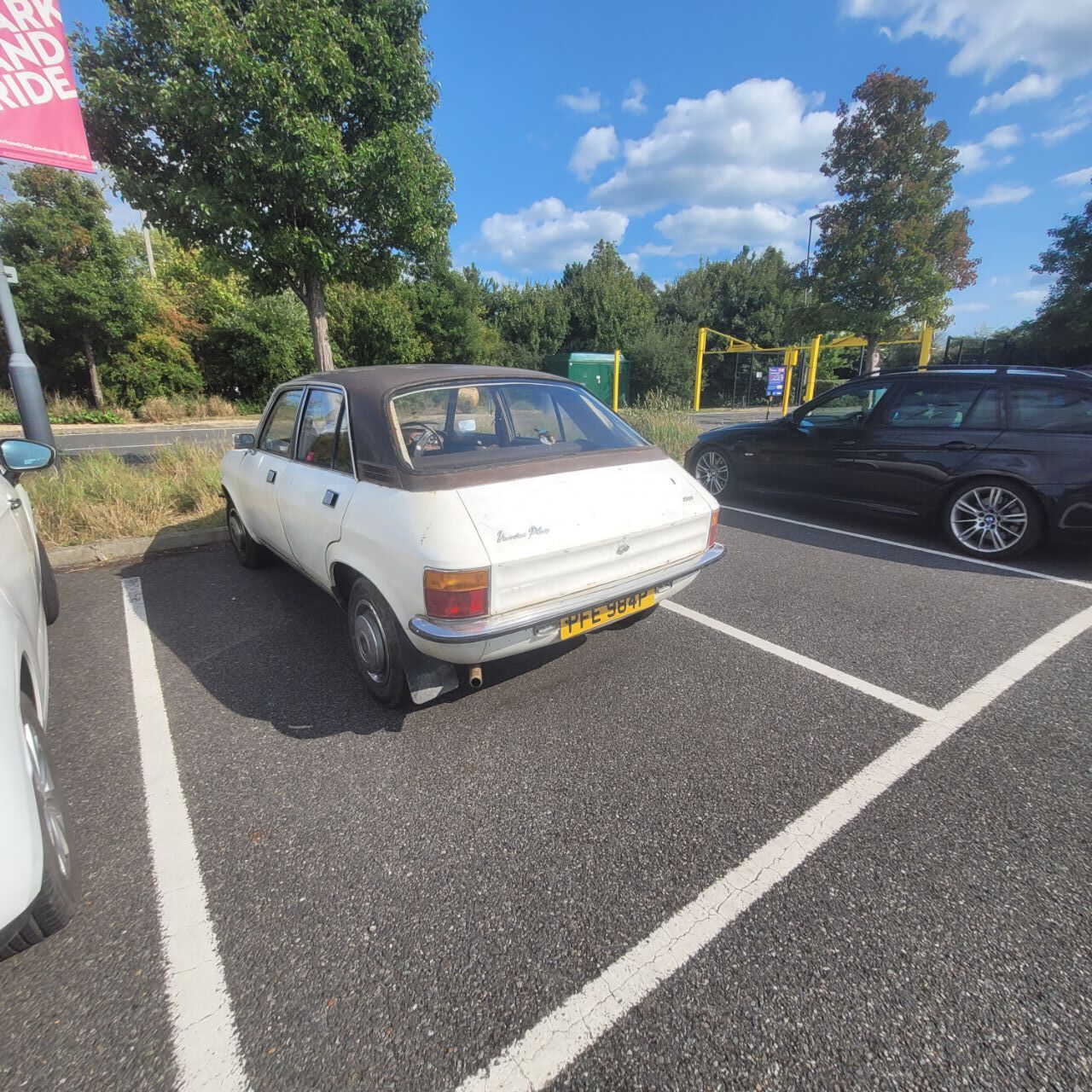

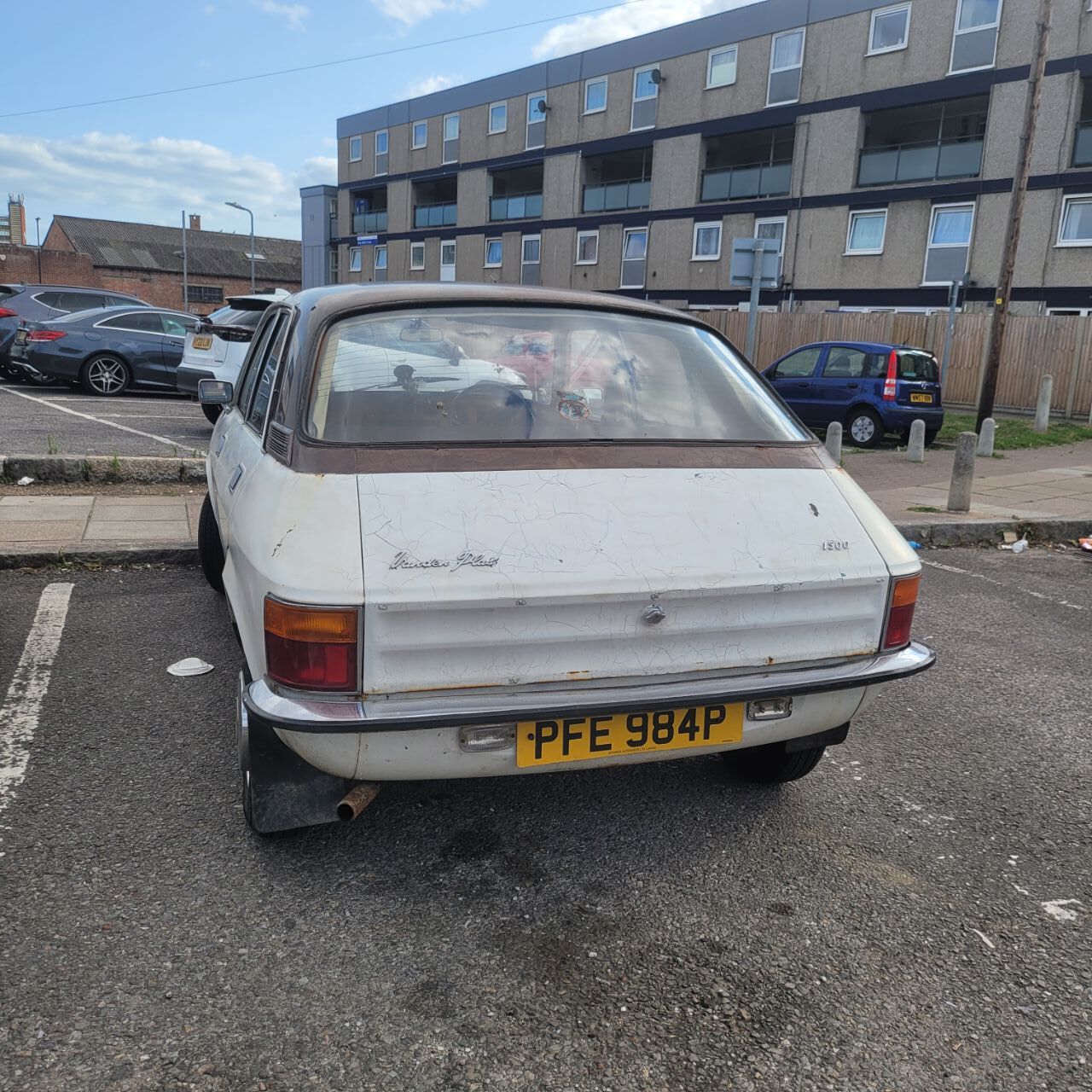

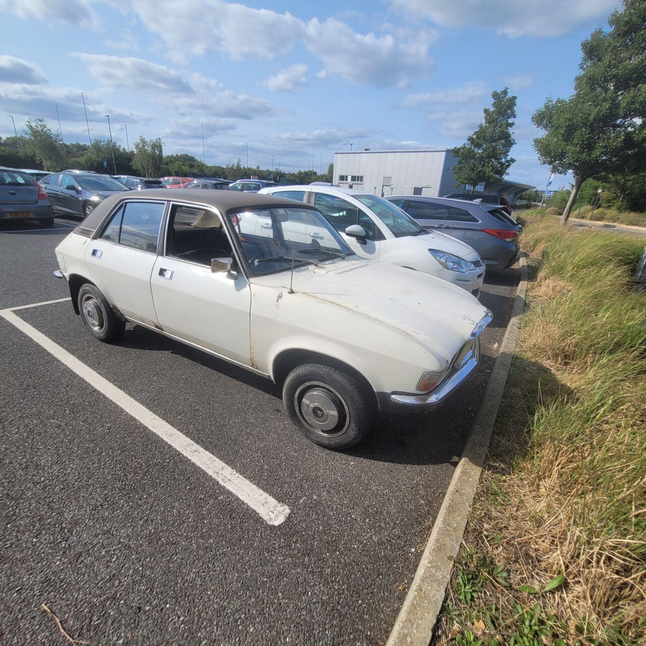

On 05/08/2025 at 17:33, Weird Car said:
Collecteded an Allegro well technically VP 1500, it was pretty obvious with my dribbling on @HMC' s thread when he bought it that I'd eventually own it, speaking of, thanks @HMC for letting me have first refusal and letting me have it for just £450, honestly a steal
I'll start of with the collection, it made it back to Portsmouth from Tavistock which is good, not entirely without fault though I might add, we got to the M275 into portsmouth when the belt snapped and we very nearly overheated, that being said its been very hot today and the temp gauge had stayed just below middle for the entire drive up to that point so that's got to be worthy of a congratulations if anything
Okay now the big bit, impressions...
I don't like it
I know I know, boo hiss and all that, but it's true, I feel like I've let the side down as being a big BL and BMC nut  I really thought I would like it, I've always wanted one but I just honestly don't like the way it drives, so it definitely won't be a long term keeper unfortunately, i feel like because i wanted one for so long i built up a false assumption it would be better than it is but I guess we never know until we try aye? So after some fettling and minor improvement it'll be back up for sale i reckon

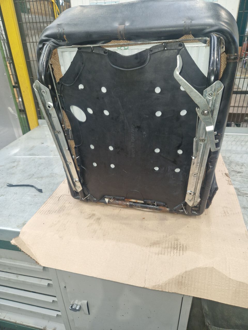

Surprised about uncomfortable seats, but they could have burst straps/diaphragms. Not familiar with their internal construction.
Shoving some foam blocks under the diaphragm can firm a sagging bottom and stiffen things up.
Basically the same approach Si is suggesting. These are the Midget 1500 seats i put in mine. The foams are knackered as were the diaphrams. New diaprhams from memory were abou5 £25 the pair delivered. The corrugated plastic sheet ive shoved inder was a bit of a bodge but its really shores both seats up until i get round to springing for new base foams.20250205_124700.jpg.0d4030afc2ffefac8b1455b71408faf8.jpg
@Andyrew shoved an old numberplate under one of the old VP seats. Worked quite well as the plastic still have a certain amount of springiness.
