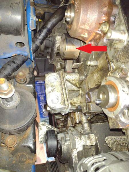

The MG is my wife's car, we have only had this one a year and it has been a lot better than I expected in fairness. It runs really well and is quick when you push it. There's a bit of rust starting around wheel arches but the floor and structure are totally solid, so fingers crossed I can keep on top of that! The main issue I have right now is a huge oil leak, which turned out to be the crankshaft seal. Given where it is, and the fact I have very little history I decided to change the timing bet and water pump at the same time. And that is where the fun started...

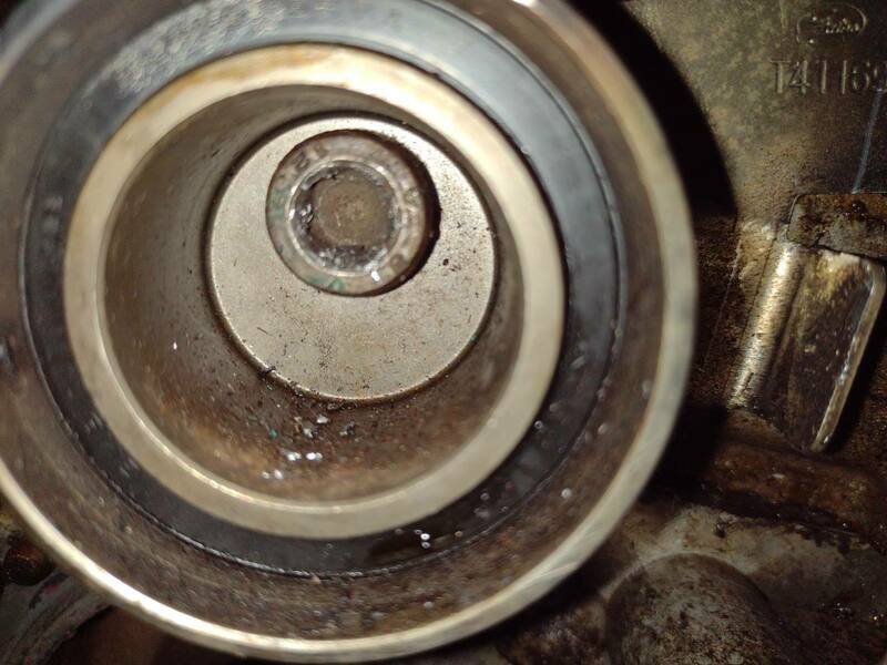

The tensioner bolt is completely seized in the block... and in my cack handed efforts to remove it I have rounded it out. It was an 8mm hex but its now an 8mm round hole 😕 does anyone have any ideas how to get this out? So far I have tried hammering a torx bit in, hammering a 12 point socket over it, lots and lots of penetrating oil and heating it with a blowtorch. Nothing seems to move it, not even a bit :-( Part of the issue is that there's no room to hit it with a hammer of get anything round the outside of it. In the pictures you can see how little room there is. Ideas are welcome!
You’d probably have more chance hammering in a slightly oversized spline bit rather than a torx, assuming you can jack up the engine far enough to get a swing on the hammer.
If not, perhaps an Irwin socket if it’s not too thick a wall to fit between the inner pulley wall and the head of the bolt. If it is, grinder time?
Can a socket for damaged bolt heads be used? like the one in the picture below. I have used these before on regular bolts and they have teeth that allow them to grip the rounded bolt head and make it possible to loosen them.
Perhaps, I do have a set but the head of the stuck bolt is in between sizes, so its either too loose or there's no way it will hammer on. Maybe I need to buy another socket that's in between...
Wondering if you could sacrifice the tensioner with a cutting disc (if indeed there is room) leaving the bolt intact for better application of penetration fluid.
Halfrauds have for around a tenner a set of allen head extractors. Worth the investment?
I had seen those but they only go up to 6mm and this is 8mm 😕 however googleing has led me to a set which goes up to  10mm on ebay, So I think that's my answer! Thank you! 🙂
I don't mind cutting the tensioner as I have a new one already, I just don't have any tools that can fit into the gap at the side of the engine.

Can you get any heat onto the bolt, I'm wondering if it has thread lock applied.
And try an imperial Allen key - Might just find one that fits good enough
I have tried these already ☹️It's hard to get a lot of heat on it because of the access, I think the pulley soaked up most of the heat to be honest because now it doesn't spin very freely! Another reason I now have to get this bolt out lol!

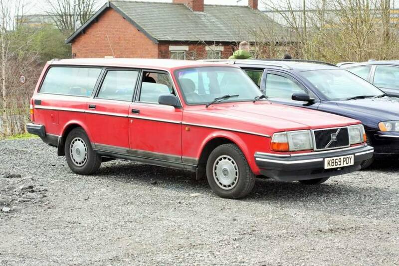

Small update to the stuck bolt saga. After trying various ideas and techniques the bolt was still stuck and the hole was getting rounder and rounder. I realised that it was bolted into the head, so I have now removed the head so I can drill it out properly and get on with the job. Slightly extreme but needs must! And looking at the MGR forums I'm not the first person who's had to do a head gasket just to remove the tensioner on a k series VVC - they are different to a non VVC tensioner. Given it is a k series lets just call it a pre-emptive OMGHGF change 😁
MicrosoftTeams-image.thumb.png.23ffd9bb28861ec3bc6dbd017b7dd4cb.pngMicrosoftTeams-image2.thumb.png.75f0d7c24950cadbeb45ae1958e307f8.png7
Hopefully tonight I will finally drill this thing out. This job was meant to take a weekend, that was 3 weeks ago 😒
Great success! Now onto the rebuilding job 😁IMG_20220328_140532202.thumb.jpg.2451741d28af409d68352a9b041a49a6.jpg

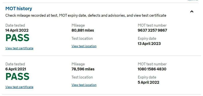

MG MOT has been achieved last week, but forgot to update the thread. Had to replace both rear calipers unfortunately, not quite sure what was wrong with them but one didn't work on the handbrake, and the other didn't work on the footbrake!
Anyway, with those replaced it passed with no advisories, which isnt bad for a 19 year old mg! Also very satisfying after putting in so mich work to fix all the silly issues over the last few weeks!
