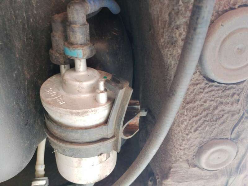

In today’s instalment, I attempt to change a fuel filter on the Fabia. After  all that messing about with various sensors, valves, and goodness knows what else with absolutely no success and a parasitic drain on my finances. It has come to light that instead of having the 4 Bar (units of pressure, not pubs) fuel filter, I instead have the 3 Bar one from the other version of this 1.2 12v engine. The other version being the AZQ code, mine is BME, which has minor differences that make major differences when it comes to buying parts. So although the two filters are physically identical externally, inside it seems they are rather different. As a result, it seems that the 3 Bar sensor has been restricting fuel flow, and messing with the ECU in order for it exhibit such strange behaviour.
Jumping back into changing the filter. I did not succeed on Saturday (15.04), being defeated by a Phillips head screw that had seen sixteen Scottish winters. Although even after one year it was probably rotten through, much like almost any car in Ayrshire. Instead, it resulted in it being tighter than two coats of paint (or me towards the end of the month). After three hours of inventing new swear words whilst hanging upside down trying to fit many things into the hole (ooooo errrrr missus etc) I decided to call it a day. Below is an image of the housing and screw from the grimy pits of hell, delivered by Satan himself. They must have had him in a design consultation job at VAG during the 2000s.

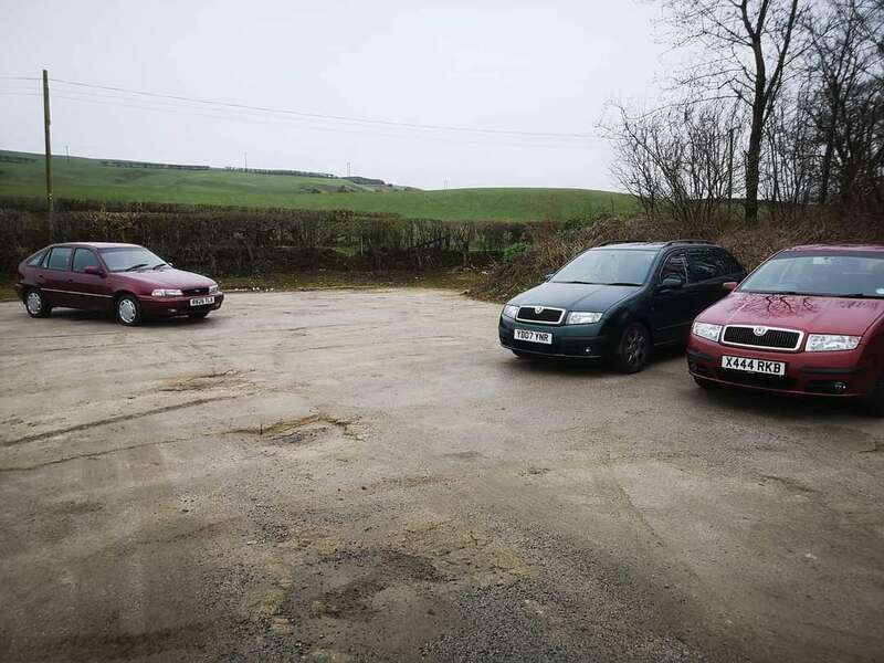

Also got some sort of 2000s car park thing going on, almost.
The 'woo looked good on it's own too.
Definitely has a look of "I want to be included, guys", however. :lol:

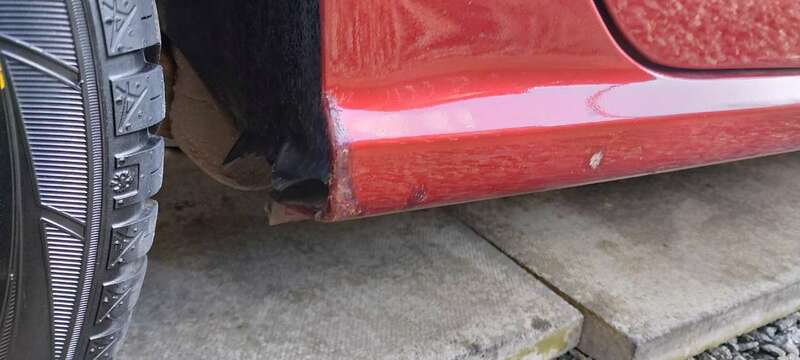

First things first, check the sills. Solid. Surface rust making them look scabby, but it hasn't compromised the metal there yet.
The doors? A little bit brown, but not terrible yet.

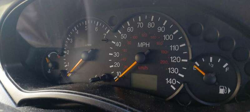

So far:
Suspected that the fuel pump is kaput.
Crunchy front wings.
Door lock doesn't unlock by the key on the driver's side.

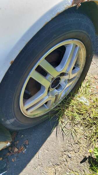

Flat tyres (has been like this for a while... doubt they'll hold air but we'll see).
Rear brakes seized on (hammer will do the job)
No ticket on it since 2020.
All easy jobs, like... :D It appears solid otherwise, so that's half the battle sorted.

Interesting see the fuel filter on a petrol. So the 1.2's must be a deadhead/return less fuel system?
The sun strip turned out better than I thought too.
Seems so, has a pressure regulator and that on it, which is why it had so many issues.

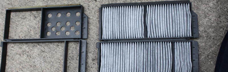

Furthermore, in this process, I could replace the pollen filter with greater ease since the glovebox was coming out anyway.
For such an insignificant job, you'd think it hadn't taken me two years of "I'll get round to it" to actually do it. Doesn't smell like death when you first turn the blower on now. Result.

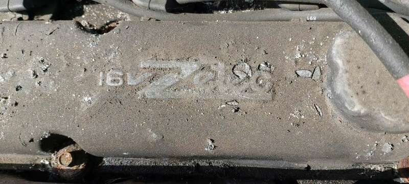

However, what I did fit was a stereo fur me bangin' choonz, which came from a scrap Avensis. I'm expecting a Nobel Peace Prize in Services to Recycling now.
Also managed to get a hold of a centre cap for the Zetec alloy that was missing one, so those are now complete.
(Again, please ignore the rust from the front wing it's fine I promise)
And finally, some discoveries...
Cambelt's been done mate. 10ish thousand miles ago, and about coming up on four years now... well in three days.
Oh yeah, and also I've made a profit(1) already.
£1.05, in a free car. Winner*.
(1) this is, of course, if we don't count the money spent on the car.

26 minutes ago, AnnoyingPentium said:
I don't even know where it is on the Mk1, I probably won't do it, as every penny is a prisoner with that car (Scottish stereotypes to apply here)...
It's under a little panel in the scuttle and is actually piss easy!
35 minutes ago, GrumpiusMaximus said:
We had a 2006 Mk2 Focus Studio (1.4.  75BHP of performance.  Yes) that now belongs to my FiL.  For some stupid reason, Ford saw fit to locate the filter behind the centre console at the bottom, so the only access is via the passenger footwell.
I'm 6'2" and of manly* proportion.  Changing it involved unplugging a whole load of shit under the glovebox, removing parts of said glovebox and then removing the housing for the filter whilst upside-down in the footwell, with my feet on the headrest of the seat and blood rushing to my head.
Getting out was even more* dignified.  Never again will I change the cabin filter on a Mk2 Focus.
Try doing it on a Mazda 3. It's a Focus in a frock so everything is laid out precisely the same except the filter is in 2 parts with plastic tabs which are supposed to clip together.
Do they fuck.
I definitely* don't just grind the tabs off and just ram the filters in 🤣
I don't know why they designed it like that, when the paper Focus one can easily be shoved in blindly
  • Haha 4
Do they fuck.
Soz more off topic, but in our old 323 it was in 3 similar parts for some reason that was baffling.

Well yes, it's the 4th of June. And the Skoda Owners Club of Great Britain are having their annual 'Skodafest'. I, of course, said I was going, without considering the distance between my house in the valley that time went for milk and never came back from, and some deer park in Shropshire. Planned route? Go darn sarf m9.
It's not quite a klekshun mishun but there are aspects I'll take for this...
First (and hopefully only) motorised conveyance of choice?
I'll show you this image that I prepared earlier.
Yeah. 600 miles with barely any air con and windows I don't trust fully. This'll be fun*.
Breakfast?
Fookin lol. I have slightly over the best before jam doughnuts from my work tho!
Anyhoo, lunch has been packed for co-pilot and I. We also have a second coolbox for drinks and that. :)
So, plan is to meet @JMotor'JMotor's Fabia mate at Castle Douglas and work from there.
Frankly, I'll need all the bloody luck I can get 😂
Castle Douglas? Completed it, m9.
Shitters were shut. So that's fun.
Still, it looks okay for now.
