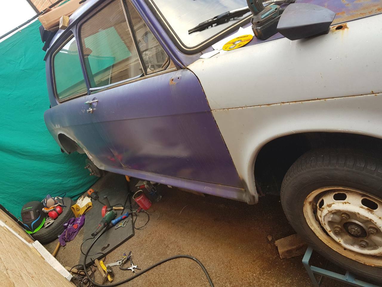

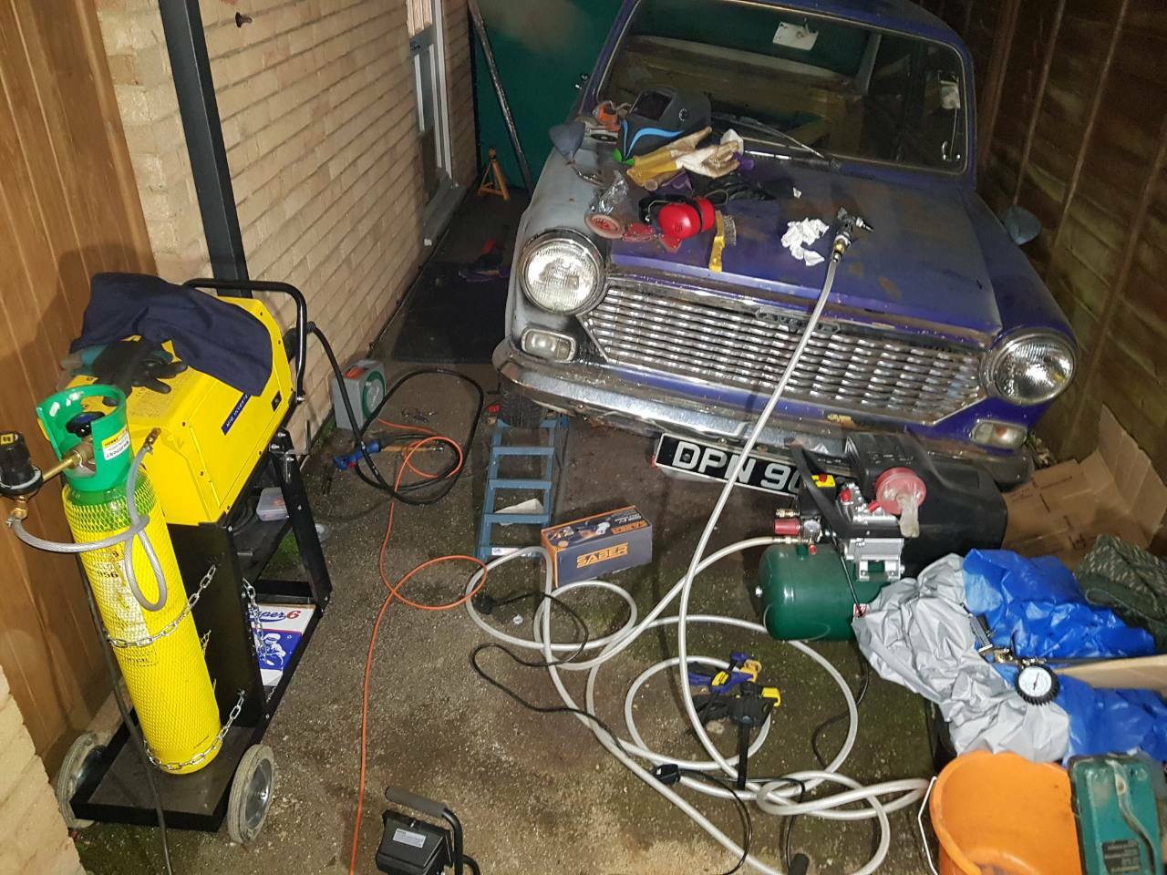

Anyone who's followed any of my threads will have seen I weld outside and may have noticed the green curtain. I always put my big green welding curtain up to protect against passersby. My old place had the garage and work area down the side of the house. Hence our private "alley" was blocked off at the end with the curtain. There was no angle that anyone could see the arc. Also we lived in a cul-de-sac and never got anyone down apart from neighbours.
In my current place I'm lucky enough to have a garage big enough to work in. Unfortunately the Dolomite is a big work in progress project and the Moggie had crusty bits. My neighbours that our drive is next to was away thankfully. So having the curtain up was sufficient to block light from any parsers by.
