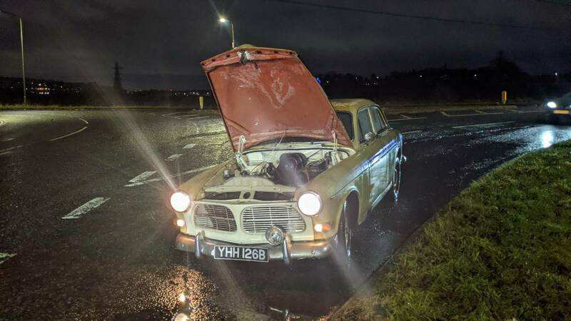

We were out for a drive yesterday and I was having quite a lot of fun with it, in other words it was getting chucked around every corner.

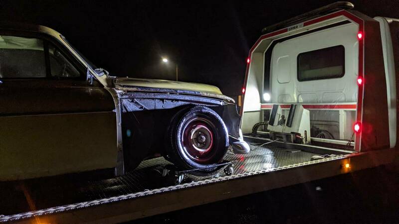

Rolled up to a roundabout near Bathgate, saw it was clear and floored it, only to hear a massive bang and what felt like the car bottoming out on the road. Thankfully still had a small amount of control and managed to get it close to the kerb although I was blocking a lane of the roundabout.
At first I thought the spring had snapped, but when trying to winch it onto the truck, the wheels splayed out. Fuck.
I had to take the wing off to prevent it being chewed up by the wheel, at which point I noticed the brand new bottom ball joint was no longer being a bottom ball joint.
Thankfully we're fine, just very rattled. Also massive credit to Autoaid, the service was top notch. Picked up in less than half an hour, and in that time I'd had many calls from them just to check up on us.

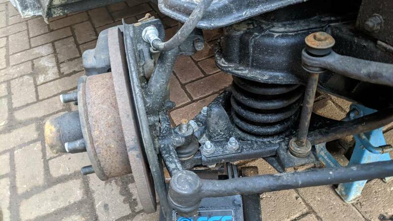

Took me a while to get over myself and have a look at this.
I don't really have a conclusive idea as to how this happened, which is worrying me.
The cause of seperation itself was easily found. The nut was missing completely. How a Nylock nut became loose and unwound without any warning sign is a concern.
Those who know me will hopefully back me up when I say I'm the most fastidious person when it comes to torquing and checking everything I've touched. At first I doubted myself but no, I definitely, without question had this torqued to spec. I've been driving a car when the suspension collapsed before (corrosion) and believe me it's enough motivation to never want it to happen again.
Regardless, I checked this on Friday and again on Saturday afternoon after hearing a (completely unrelated) noise. It was there, and it was done up tight.
Anyway, I have to just get over it and sort the problem and do what I can to make sure it doesn't happen again.

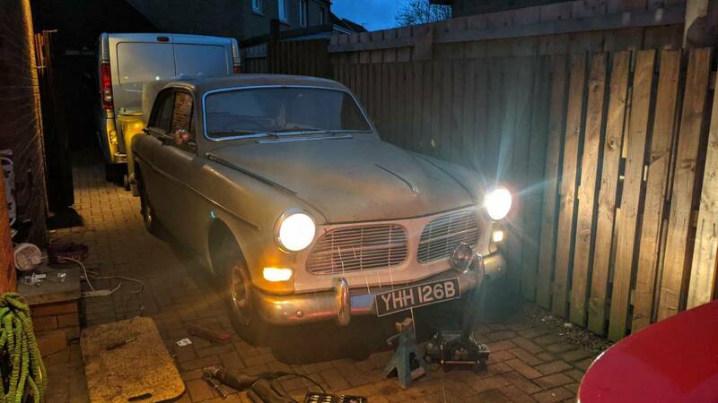

It's easy enough to pop it back together with a jack.
This time round I'm not taking any chances. I drilled the stud and used a castle nut and split pin as per the original factory set up.
Then I put the panels back on.
I'm going to speculate as to what happened. I think using a nylock on the bottom ball joint is unsafe because the design of the suspension means that the ball joint is always being pushed out of the hub rather than into it.  If the very mild taper on the hub hasn't quite bedded in and isn't stopping rotation of the top part of the joint, then steering inputs could probably unwind the nut.  Since it's always under tension as I said, it will keep unwinding the nut as you steer and might not give any warning clunks before it eventually reaches the end of the threads and pops off.
I really think that bottom ball joint should have been supplied with a castle nut and split pin as per the factory setup.
