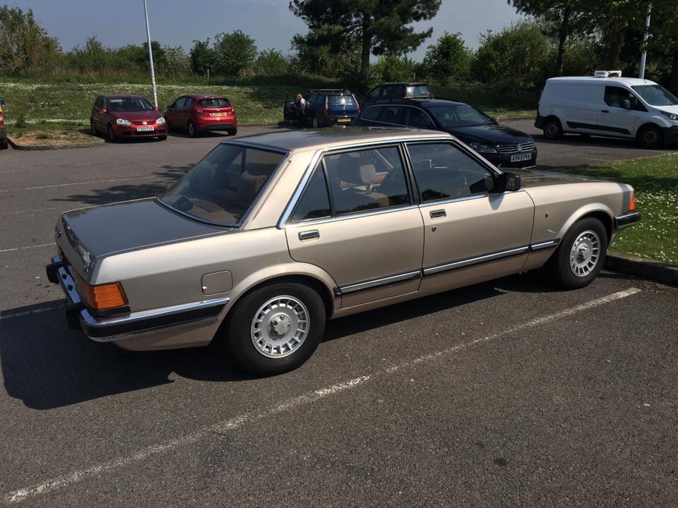

I actually have surprisingly few pics of it, but here you go, this was the day I picked it up a couple of years ago
